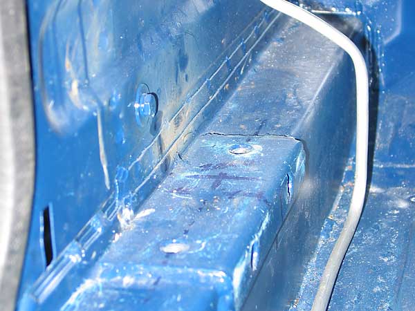

| Note: | This car was built to demonstrate Heritage's new "Competition Bodyshell" product range. Heritage Competition Bodyshells are available in several model and series specifications. This one is nominally a 1964 ("3 synchro") MGB, although the body was built in 2007 using original MG tools. The Competition Bodyshells feature extensive seam welding along the main chassis rails and in other key areas, plus a reinforced rear bulkhead for seatbelt mounting, roll-cage mounting plates, tow points, etc. Other newly-available Heritage performance components and options are also demonstrated. |

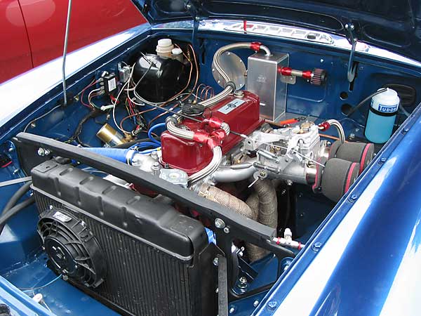

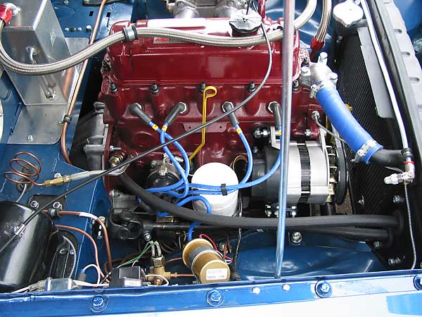

| Engine: | 1950cc 4 cylinder B-series. The engine has been bored-out to a larger capacity than
normally allowed under FIA regulations due to the specific series it will be racing
in. For FIA events, an engine of displacement no more than 1840cc is permitted.
| Induction: | Single Weber 48 DCOE carburetor. |
| Ignition: | NGK spark plugs. Lucas "Sports" coil. |
| Cooling: | 19-row oil cooler and high flow radiator. Manually controlled electric fan for when
the car is either in traffic or waiting on the grid. |
| Exhaust: | Maniflow 3-into-1 header. Single box exhaust system. Exhaust wrap on header to help
prevent heat soak into the carbs. |

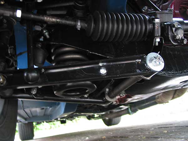

| F. Suspension: | "Negative-camber" lower control arms. Nylatron bushings. 3/4" anti-roll bar.
Uprated and lowered coil springs. Lever-arm dampers with heavy oil and competition
valves. Note: the rules specify that the suspension must be of original design,
so it's not permissable to use telescopic shock absorbers, etc. |

| Electrical (and Instruments): | 1971 wiring loom as this allows the alternator to be wired in easily.
Rev counter replaced with one capable of reving to 8000rpm. Shift light installed
to help prevent going over the 7000rpm rev limit. GPS data collection system
fitted for performance analysis.

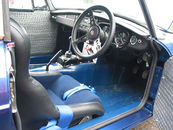

| Other: | Stripped out interior for maximum weight saving. Aluminum door panels.

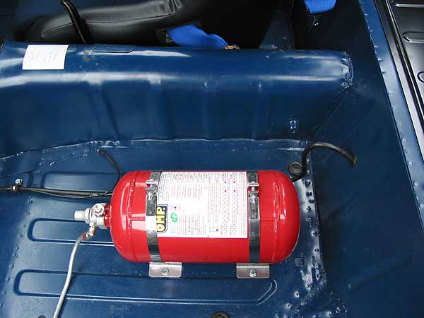

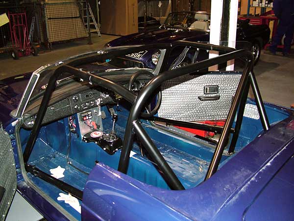

Full 6-point roll cage built to FIA regulations. Plumbed-in electrical fire
extinguisher. Ridgard RS9 racing seat. 6 point racing safety harness.
Deep aluminum front valance with hole cut for improved airflow over the
oil cooler. Fiberglass rear valance. Original factory hardtop. |

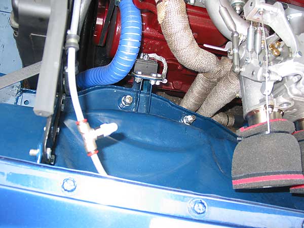

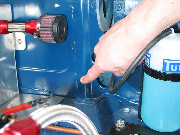

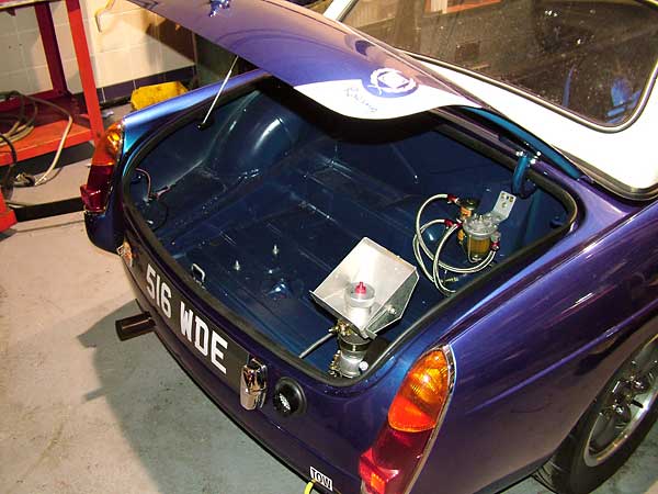

Note the inclusion of an alloy catch tank in place of the heater and the plumbed-in
fire extinguisher.
An electric fan has been installed to cool the car when waiting
on the grid.
Class rules restrict master cylinder and brake plumbing choices

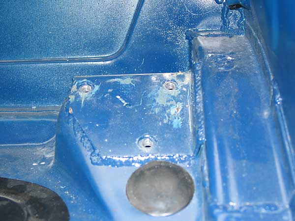

Body seams have been reinforced with strategically-placed MIG stitch welds (aka "seam welding")
Seam welding along more critical joints is continuous (such as here, along the frame flange)
Fire suppression system bottle

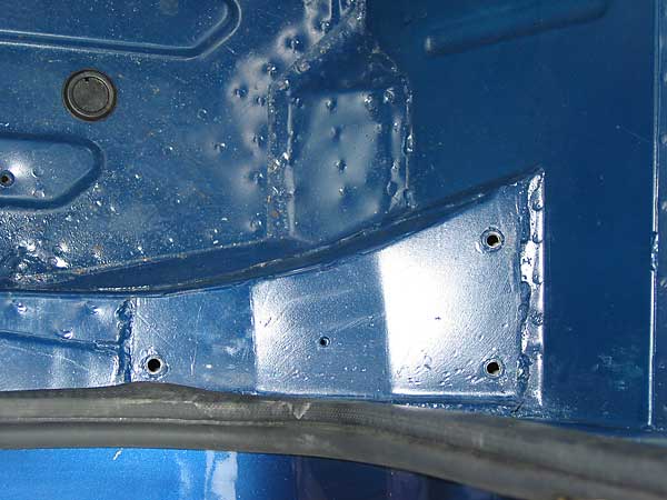

Front roll-cage mounting bracket (notice convenient theaded inserts)
Middle (main hoop) roll-cage mounting bracket
Rear roll-cage mounting bracket

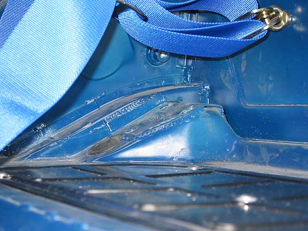

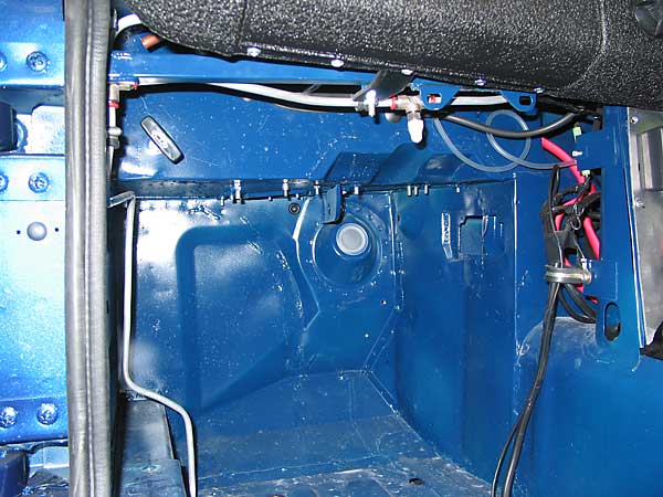

Reinforced seat belt mount (see also inside trunk area)

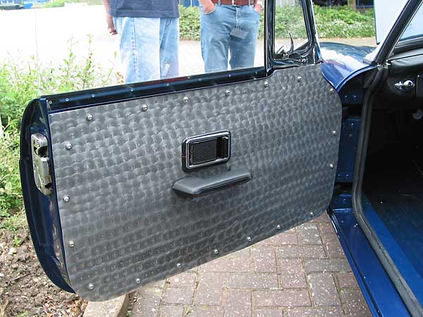

Aluminum door panel

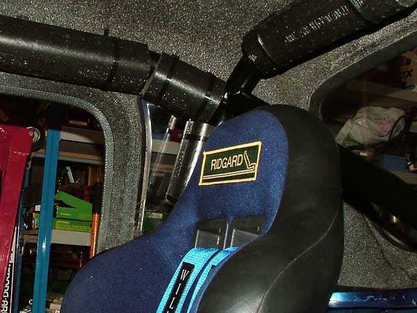

A view of the finished Heritage-built roll cage before the hard top went on the car.
The very comfortable Ridgard seat. FIA specification foam padding can be seen on the roll cage.

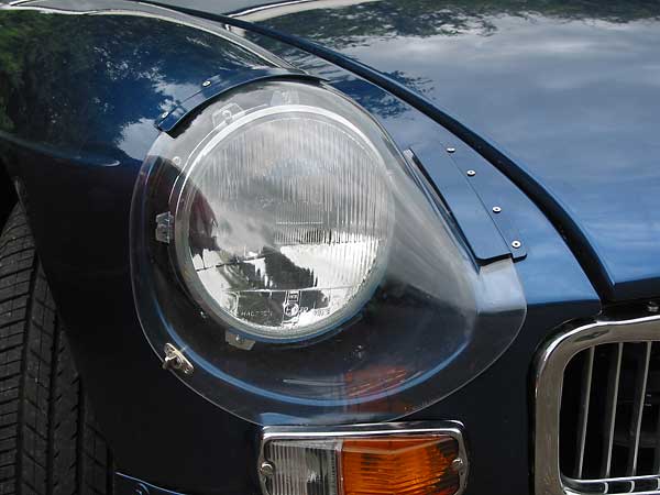

Sebring-style perspex headlight covers and lightweight aluminum bonnet

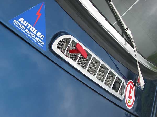

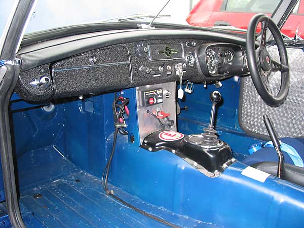

Battery disconnect and remote-starter switches

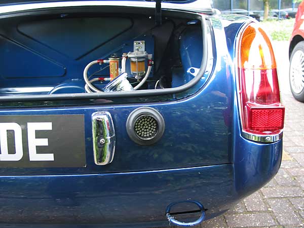

Rear-mounted LED rain light, fiberglass rear valance, and FIA-required tow eye
Notice that the seat belt mounting is stiffened and reinforced by the fuel filter bracket

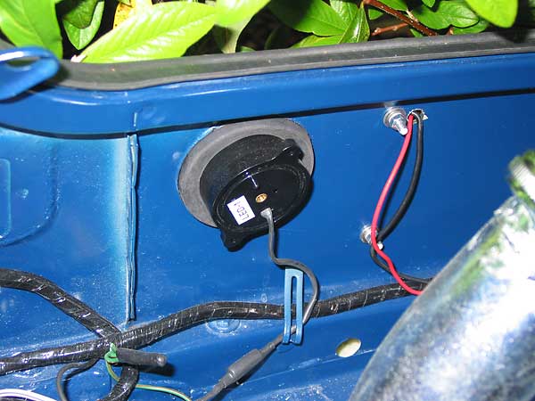

The splash tray is mandatory for the fuel filler neck.

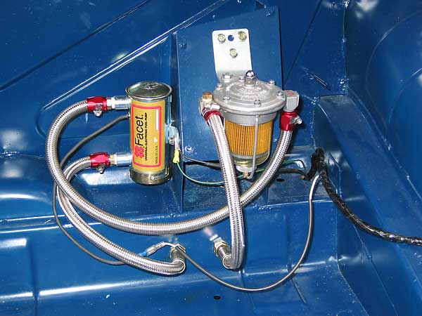

Fuel pump and filter/regulator can be seen mounted to the bulkhead.
Internally baffled and foam-filled MGB fuel tank
Class rules require essentially "stock" suspension/brakes

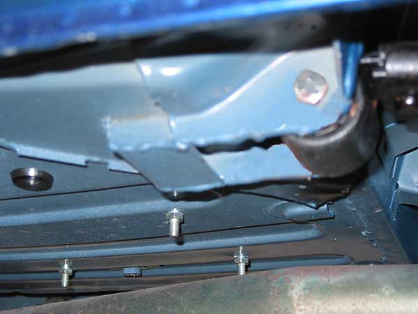

Reinforced leaf spring mounts... and reversed spring-eyes for lowering effect.

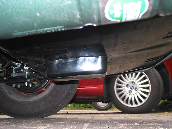

Alloy deep front valance and FIA-required towing eye
