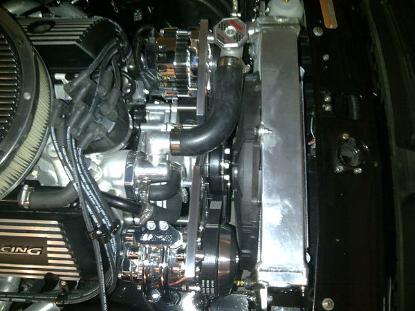

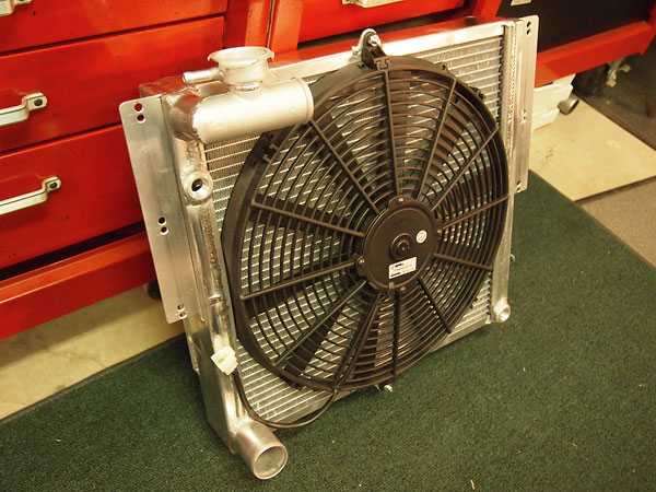

Cooling: custom aluminum radiator by Bill Kydd at Canadian Performance Warehouse. Upper radiator hose (NAPA part# 7096). Lower radiator hose (NAPA part# 7400). Manifold to thermostat hose (Dayco part# 87671). Water pump to heater pipe (Dayco part# 70646-short).

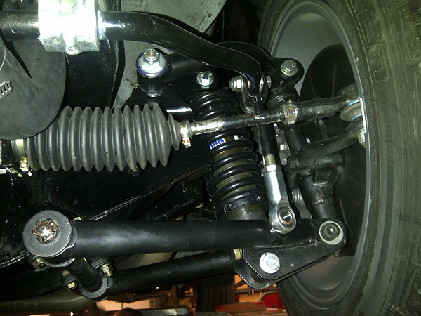

Front Susp.: Hoyle coilover front suspension. GAZ single-adjustable coilover shock absorbers. FabTek dropped spindles.

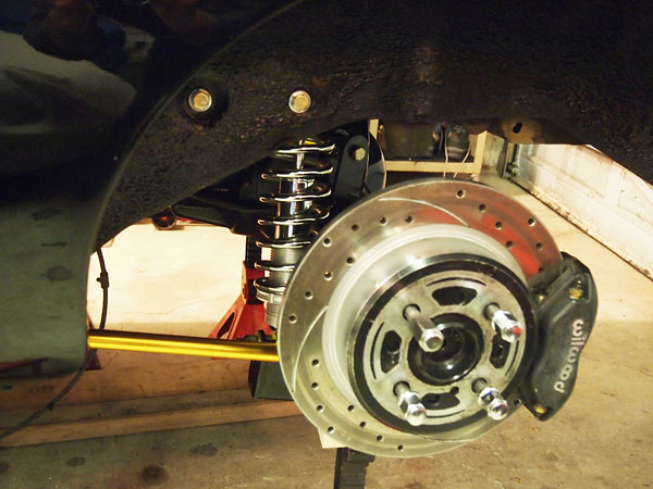

Rear Susp.: Classic Conversions Engineering 4-link rear suspension. GAZ single-adjustable coilover shock absorbers. Blue Coil springs (175#/inch).

(rear) Wilwood disc brakes. Wilwood proportioning valve (part# MBM-APV1).

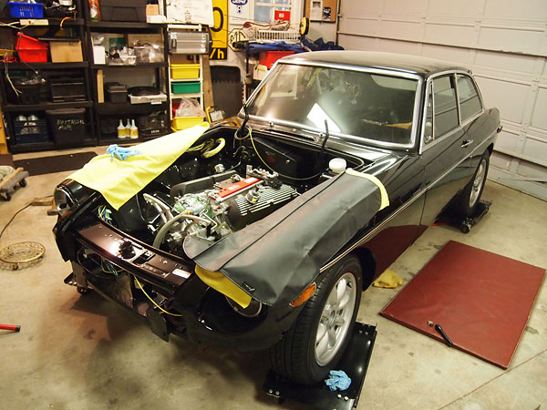

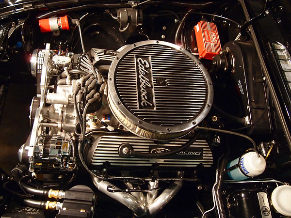

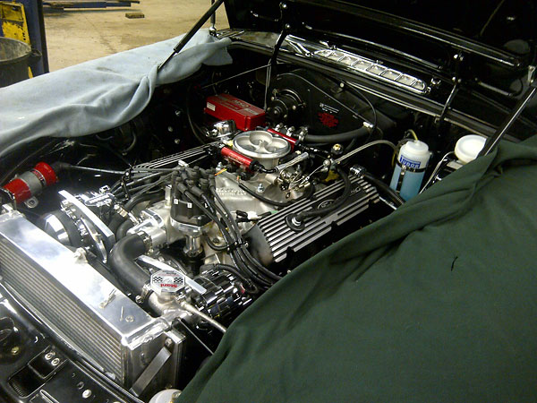

Edelbrock finned aluminum air cleaner
This 1988 Ford 302cid V8 delivers 284 horsepower & 299 ft-lbs of torque to the rear wheels.

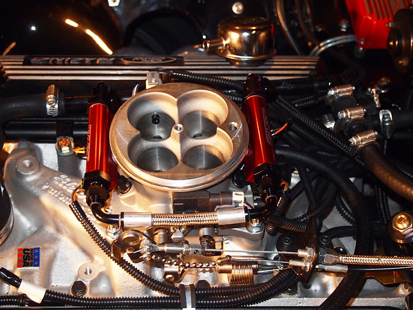

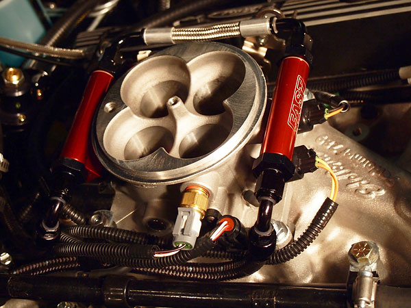

Under the finned air cleaner: Fast EZ-EFI throttle body fuel injection system.

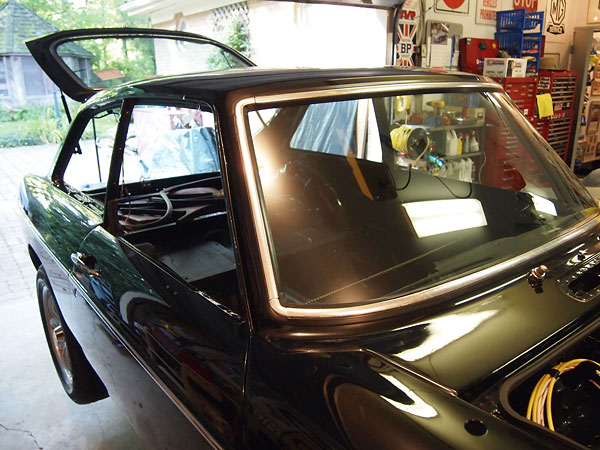

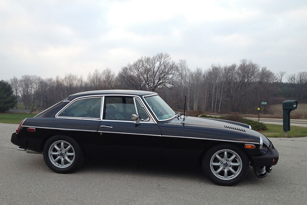

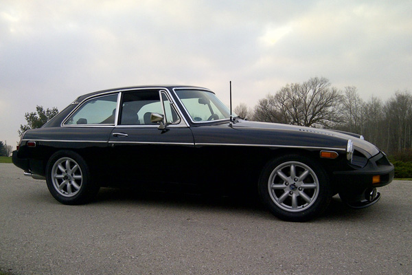

Front three-quarter view.
With coilover suspension both front and rear, Martyn could set ride height precisely where
he wanted it. Wheel and tire selection also helped to give this car its thoroughbred stance.

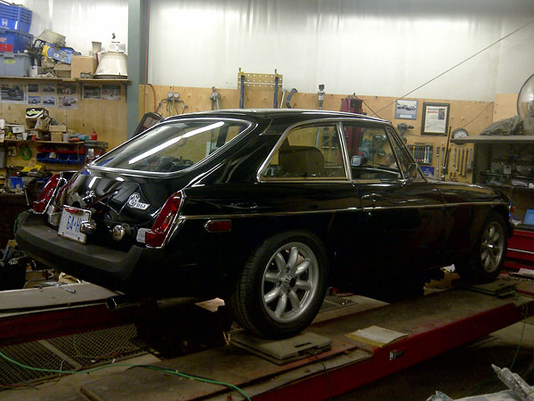

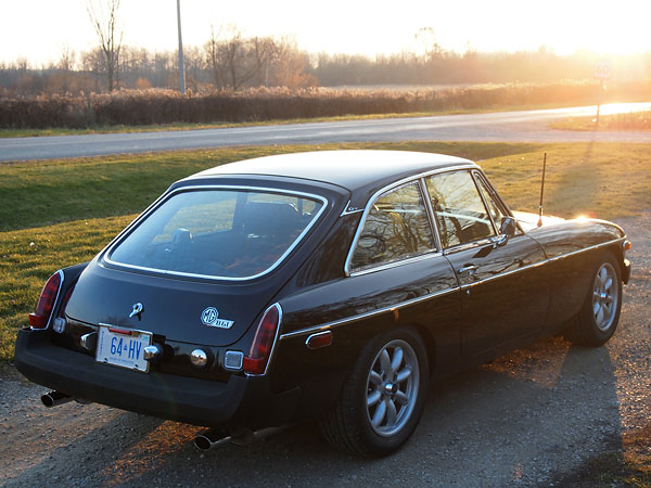

Rear three-quarter view.
Many people feel "rubber bumpers" suit MG's GT model better than their roadsters. After just one-half
year, MG ceased exporting rubber bumper GTs to North America. (Production continued ~5 more years.)
Result: 1974.5 model year GTs are among the most collectible MGs in North America.

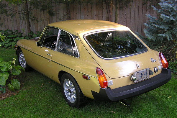

  2. Original Car:

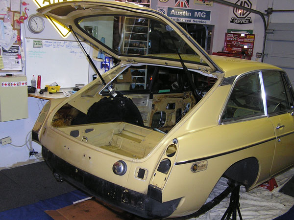

    • Purchased a rust free and well maintained 1974.5 MGBGT (in 1998).
    Purchased a rust free and well maintained 1974.5 MGBGT in 1998.

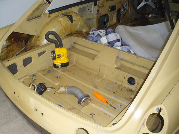

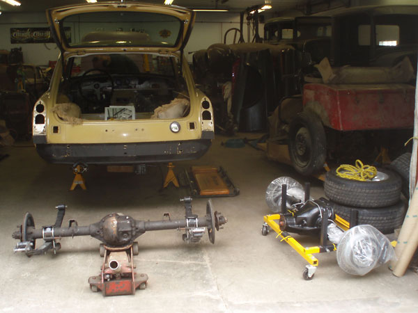

  3. Disassembly:
    • Parted out original MGB drive train.
    The original four cylinder 1800cc MGB engine was removed and sold.

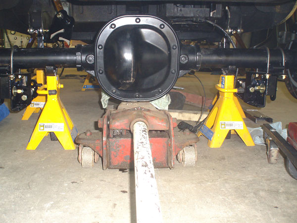

    Original Salisbury axle at left. Ford 8.8 axle at right.
    The interior needed to be disassembled too.

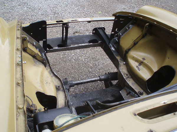

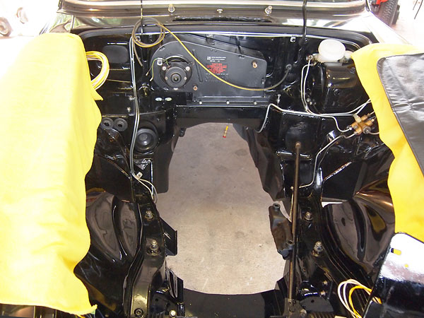

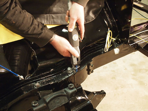

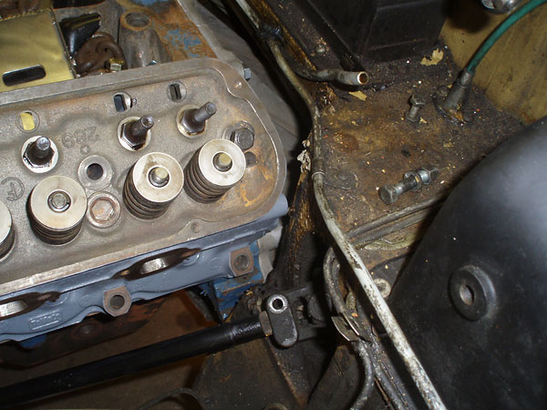

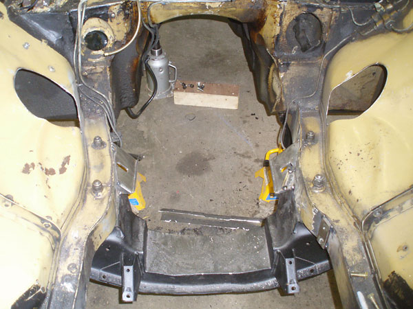

  4. Body & chassis mods: (note: welding & fabrication by Grant Swartz, Swartz Fabrications, Bloomingdale Ontario)

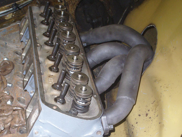

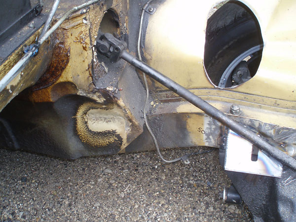

    • Cut holes in inner fenders for exhaust headers.

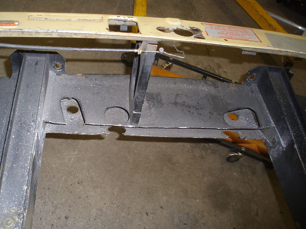

    • Shortened front tray to enable radiator to move as close to front of car as possible.

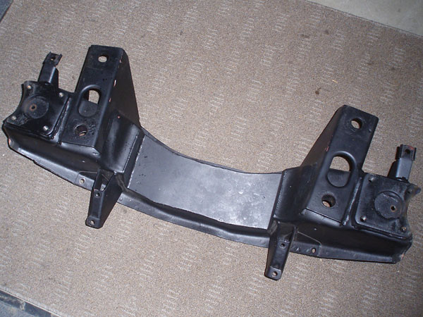

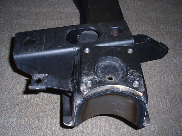

    • Modified front crossmember to accommodate Ford 302 engine and Hoyle coilover front suspension.
    • Fabricated new motor mounts and a gearbox crossmember.
    • Centered fuel tank to accommodate dual exhaust.
    Cut holes in inner fenders...
    ...for through-the-wing exhaust headers
    Cut out material. Fill material back in.

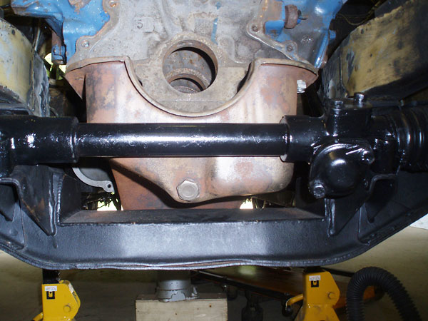

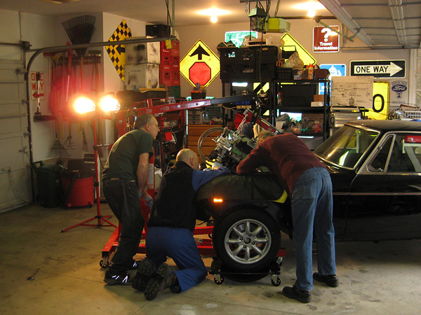

    Checking oil pan clearance.

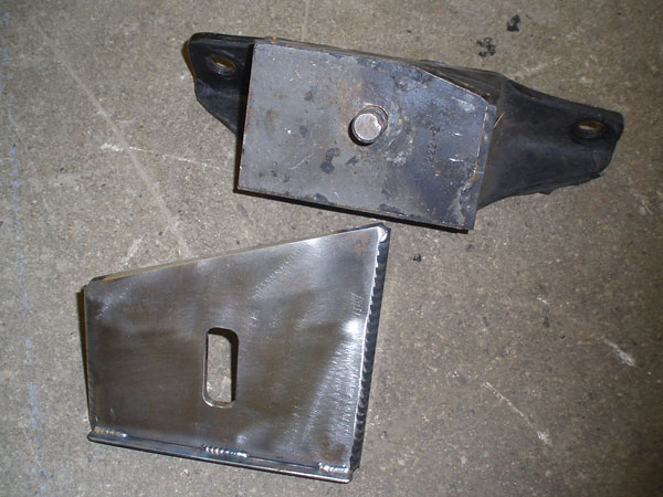

    Fabricated new motor mounts.
    Anchor Replacement Parts, rubber motor mount part numbers 2220 and 2221.
    New motor mounts welded to front subframe.

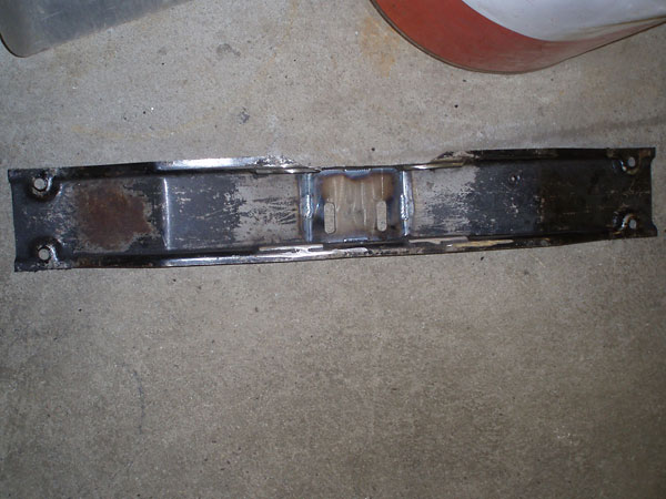

    Modified transmission crossmember.
    Checking cylinder head to footbox clearance.

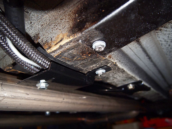

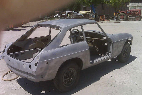

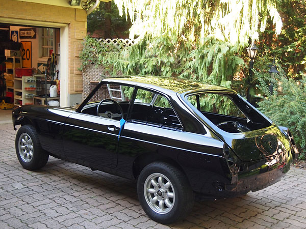

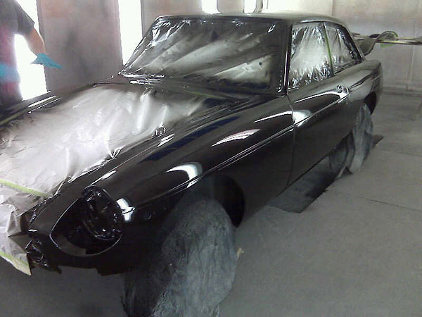

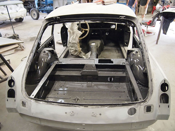

  5. Paint:
    • Stripped off the original paint.
    • Sandblasted the car.
    • New black paint by Gord Kudlowick at Easy-Way Autobody.
    Applied new black paint.
    Back from the paint shop.

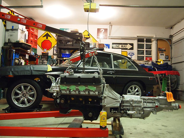

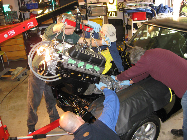

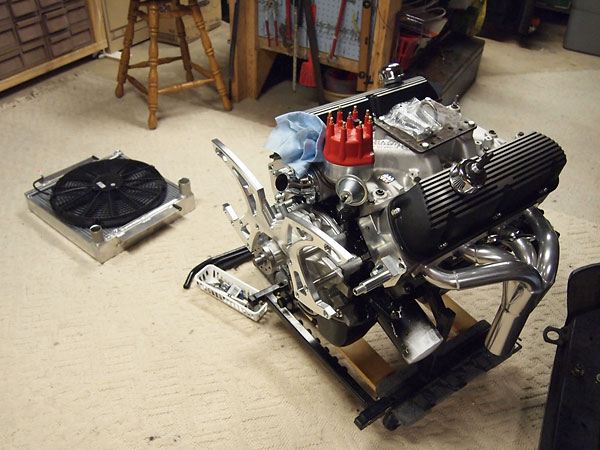

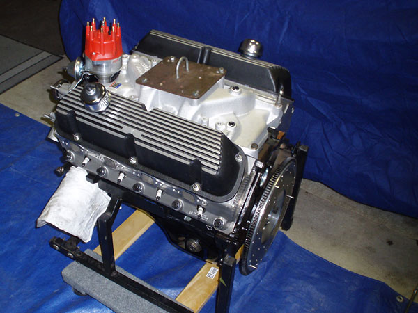

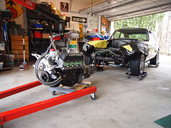

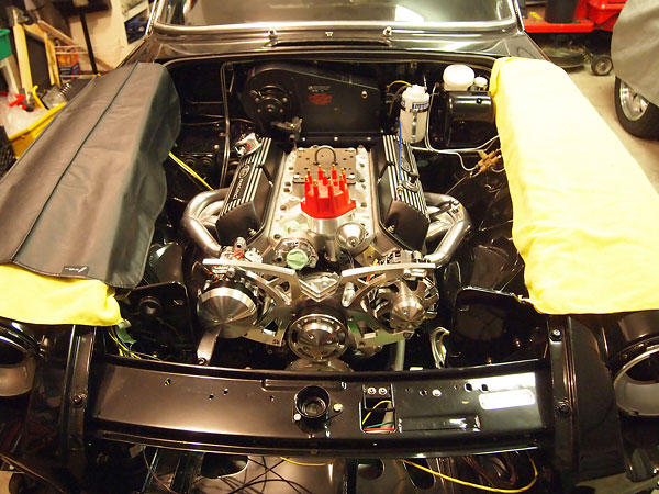

  6. Engine:
    • Purchased a 1988 Ford 302 V8 (ex: Mustang 5.0).
    • Rebuilt the engine from the bearings up.
    Purchased a 1988 Ford 302 V8 (ex: Mustang 5.0) - Rebuilt the engine from the bearings up.
    Trial fitting various engine ancillaries.

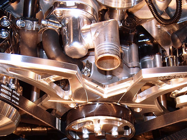

    March bracket kit.

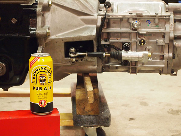

  7. Gearbox:
    • Purchased new Tremec T5 gearbox, Fidanza aluminum flywheel, and clutch.
    • Fabricated new clutch cylinder slave bracket and fitted Nissan truck slave cylinder.

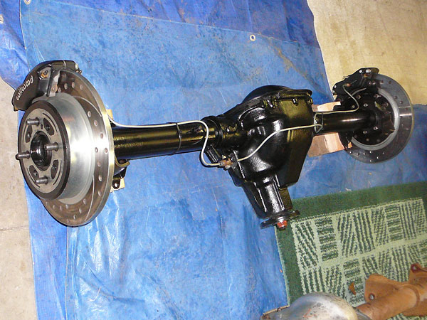

  8. Differential:
    • Purchased Ford 8.8" posi rear axle, narrowed to MGB width.
    Purchased Ford 8.8 posi rear axle, narrowed to MGB width.
  9. Front suspension:
    • Installed Hoyle coilover front suspension kit.
    • Substituted FabTek MGB dropped spindles.
    • Modified the front anti-sway bar.
    Note that crossmember must be modified for shock absorber clearance.

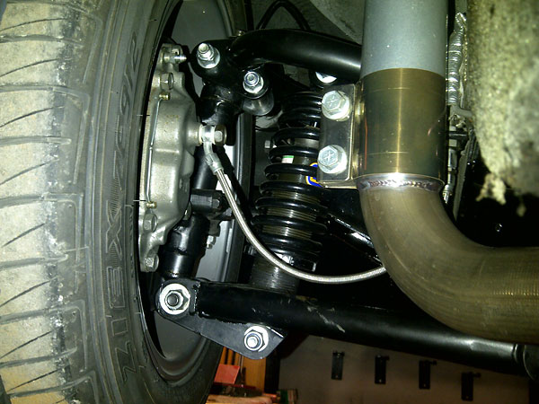

  10. Rear suspension:
    • Installed Classic Conversions Engineering 4-link suspension.
    Trial installation.
    Close-up.

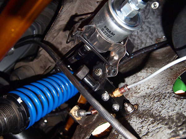

  11. Master cylinders:
    • New MGB brake and clutch master cylinders.

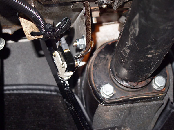

    • Brake light switch replaced / relocated to footbox.

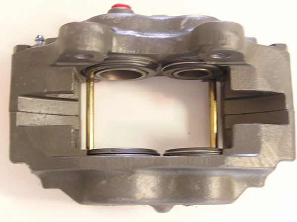

  12. Front brakes:
    • Toyota 4-Runner calipers and Toyota van rotors.

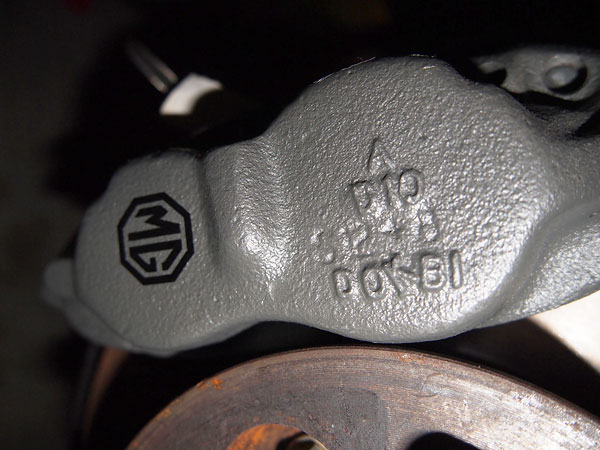

    Improved with an MG logo.

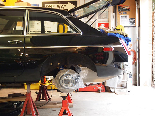

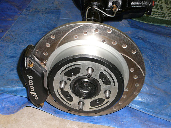

  13. Rear brakes:
    • Wilwood disc brakes.
    • Lokar parking brake cable.
    • Wilwood proportioning valve.

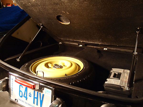

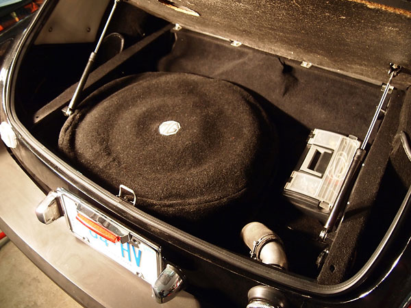

    • Nissan 240SX space saver spare tire.
    Compomotive ML15 8-spoke wheels.

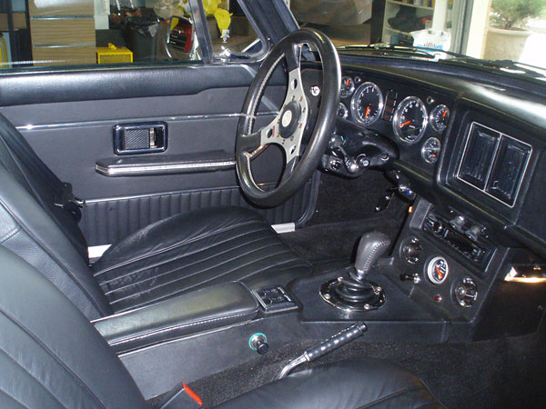

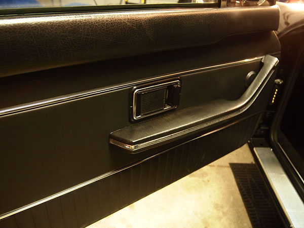

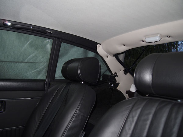

  15. Interior:

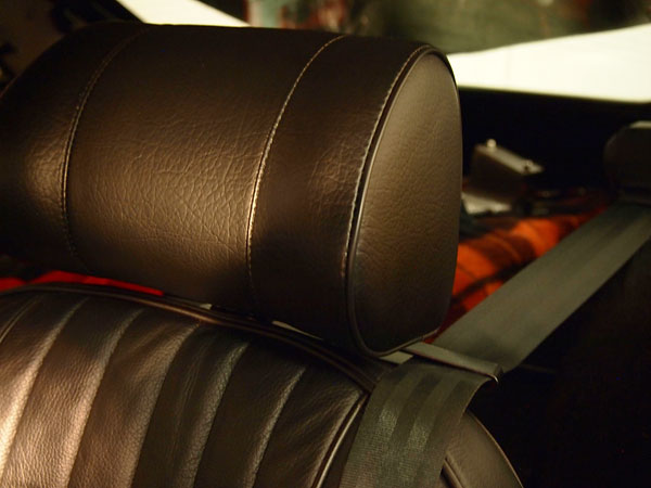

    • Reupholstered MGB seats in leather.
    • Installed a 1980 MGB dashboard.

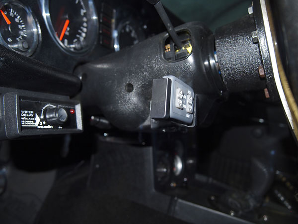

    • Installed an Audiovox cruise control switch.
    • Installed a variable intermittent wiper switch.
    • Sony CD player.
    • Added an oil temperature gauge.

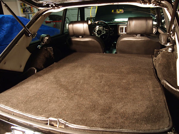

    • Installed new carpet set.
    • New door cards and trim panels.
    • Fiat door arm rests.
    • Jaguar XJ6 grab handles.
    • Vintage courtesy lamps.
    • Accessory outlets.
    • Push button start.
    • Insulated/sound proofed interior of car with Dynamat.

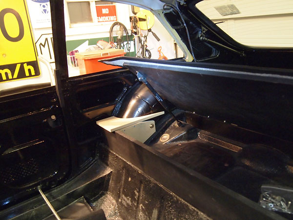

    • Fabricated rear security trunk.
    • Hydraulic trunk and hatch struts.
    1980 MGB dashboard.
    Variable intermittent wiper switch and Audiovox cruise control switch.
    Jaguar XJ6 grab handles. Reupholstered MGB seats in leather. Vintage courtesy lamps.
    Shoulder harness retainers.
    Fiat door armrests.

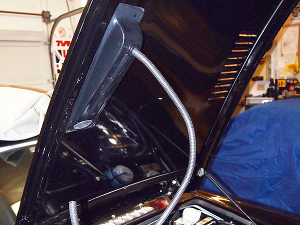

    Hydraulic hatch struts.

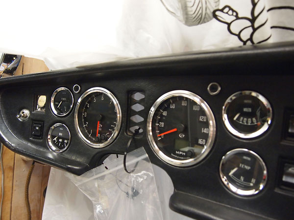

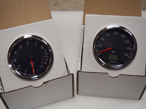

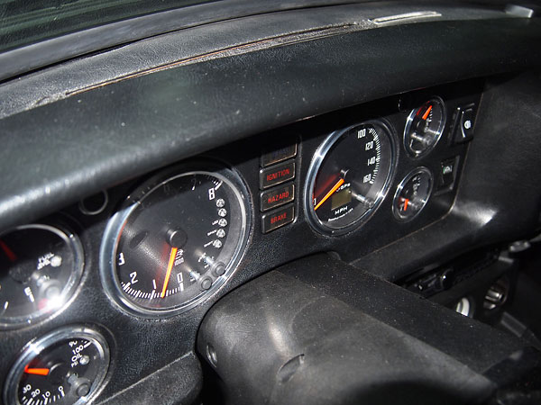

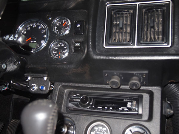

  16. Gauges:
    • Speedhut GPS speedometer and matching tachometer, temperature gauge, voltmeter, and oil guages.
    Speedhut GPS speedometer and matching tachometer.
    Speedhut temperature gauge, voltmeter, and oil guages.

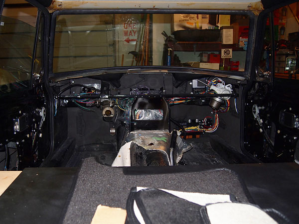

  17. Wiring:
    • Advance Wire harness and fuse panel.
    • Secondary fuse panel to accommodate extra accessories.
    Engine bay wiring.

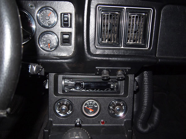

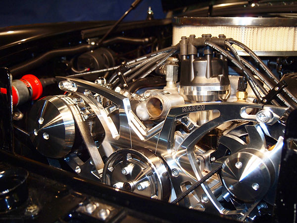

  19. Climate System:
    • Nostalgic Air MGB kit.
    • Installed A/C drier in radiator tray.
    • Under-dash evaporator in passenger footwell.
    • A/C switches on dash.

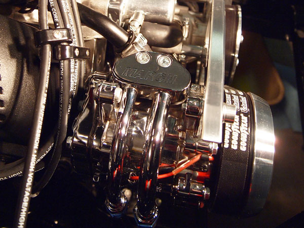

    • March bracket kit.
    • Audi heater valve.
    March bracket kit.
    Sanden compressor
    Audi heater valve

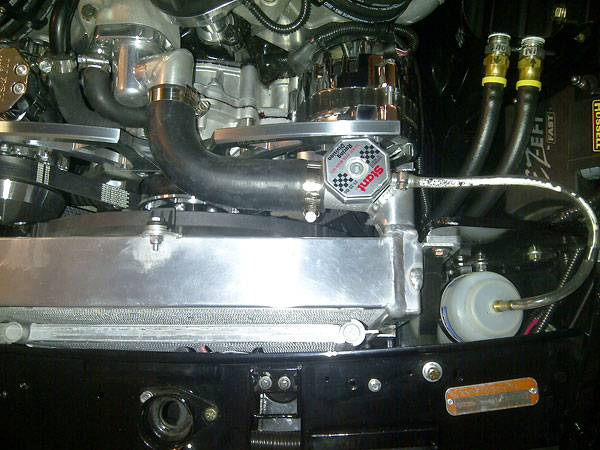

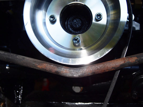

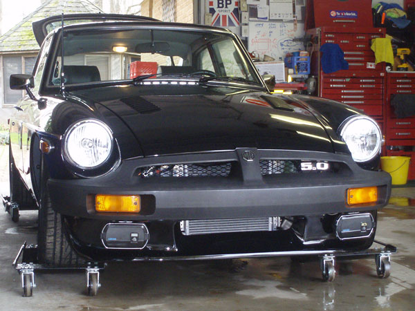

  20. Engine Cooling:
    • Fast Cars aluminum crossflow radiator.
    • Spal electric fan.
    • Louvered bonnet.
    • Magnetically attached rain water diverters.
    • Modified radiator hoses.

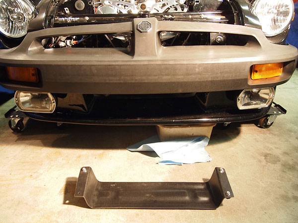

    • Front air scoop.
    • Heater valve.
    Fast Cars aluminum crossflow radiator. Spal electric fan.
    Louvered bonnet.
    Custom modified thermostat housing.
    Radiator hose.
    Radiator hose.
    Front air duct BHH1614

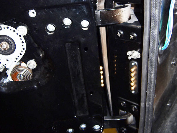

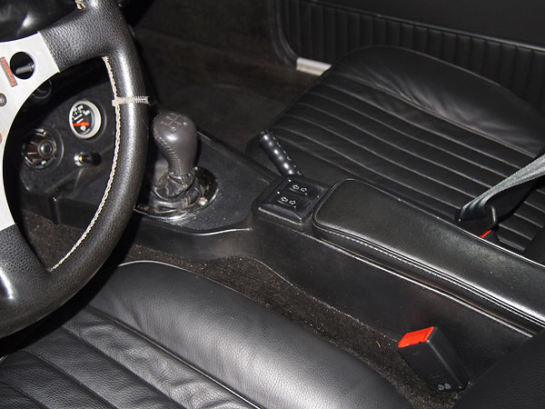

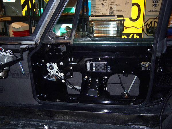

  21. Power windows and locks:
    • Universal power window kit, with switches installed in center console.
    • Universal remote door lock kit.
    • Magnum Shooters (spring-loaded brass button contact) kit.
    Electric window mechanism.

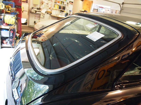

  22. Glass:
    • Tinted windshield.
    • Tinted side windows.
    • Electric rear window defogger.
    Tinted windshield.

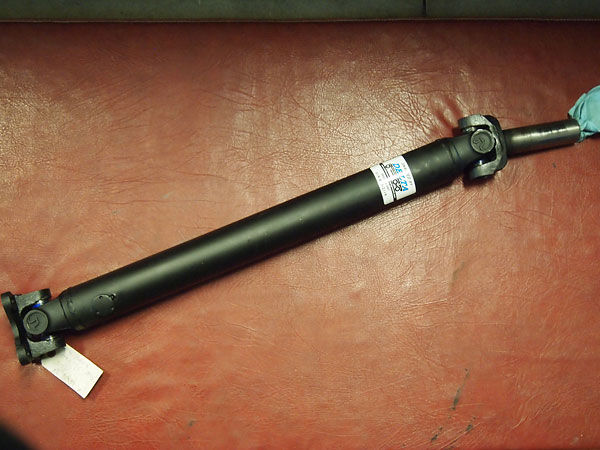

  23. Driveshaft:
    • Custom driveshaft with new universal joints.

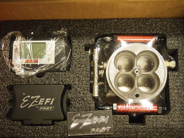

  24. Induction:
    • Fast EZ-EFI throttle body fuel injection system.
    • Edelbrock Performer 289 intake manifold.

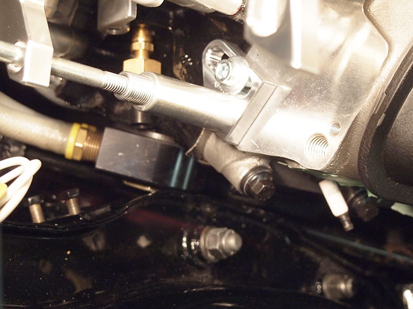

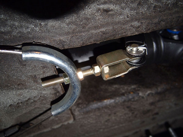

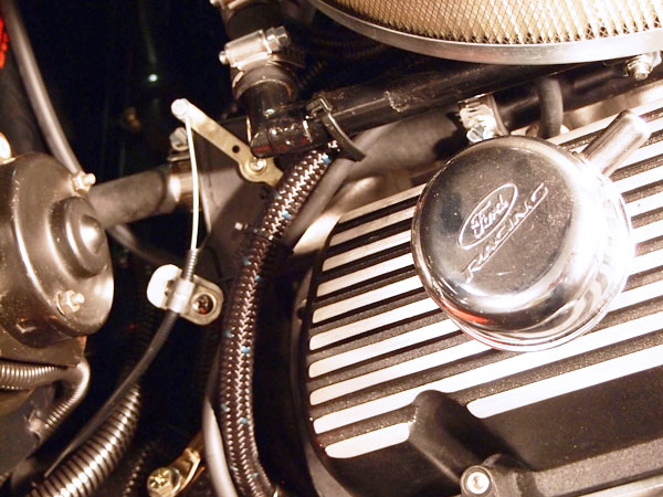

    Throttle Linkage

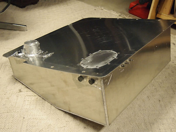

  25. Fuel System:
    • Custom Rod Works aluminum fuel tank with internal fuel pump.
    • Russell high pressure fuel hose and fittings.
    • Fram inline fuel filter.

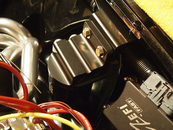

    Canton remote oil filter kit.
    Custom oil filter mount.

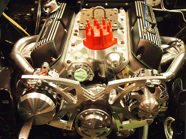

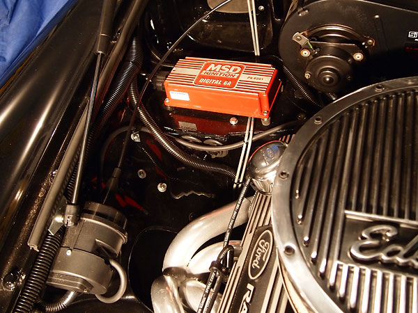

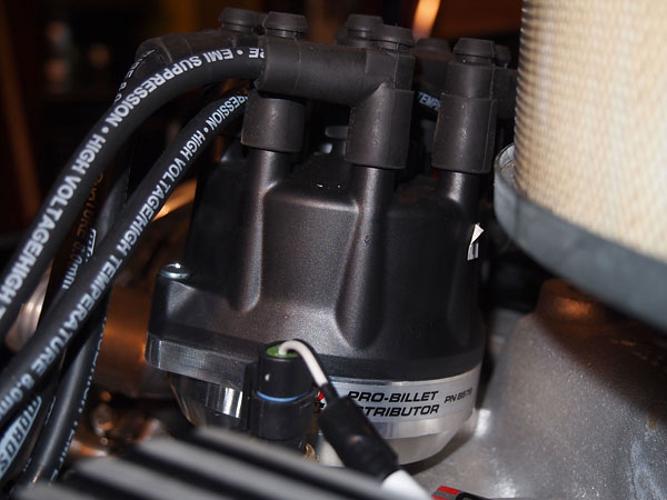

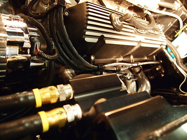

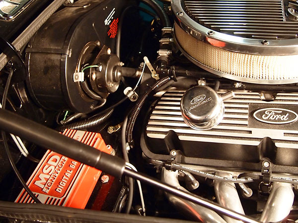

  27. Ignition:
    • MSD Pro Billet distributor (part number 8579).
    • MSD Digital 6A ignition box.
    • Moroso spark plug wires.
    • Taylor wire routing clips.
    Overview of the ignition system.

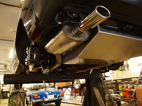

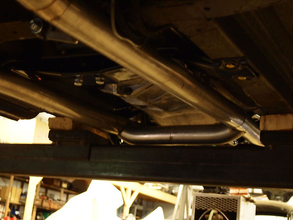

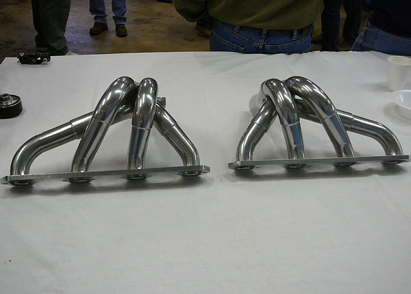

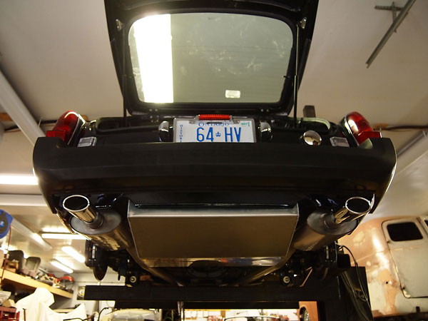

  29. Exhaust:
    • Fast Cars exhaust headers.
    • Hi-Tech ceramic exhaust coating.
    • Twin stainless steel exhaust pipes with cross-over.
    • Borla stainless steel mufflers.
    Fast Cars exhaust headers. Hi-Tech ceramic exhaust coating.
    This photo emphasizes the significance of centering the fuel tank.
  30. Installation:
    • Engine and gearbox together.
    Adjusting engine angle on the cherry picker.
    Three sets of hands.
    Home, safely.
  31. Suspension and Wheel Alignment:
    • Coilover set up. (With corner weights adjusted, car has 50/50 front/rear weight ratio.)
    • Laser wheel alignment by Scott Murfin at Can-Align.
    Coilover set-up.
