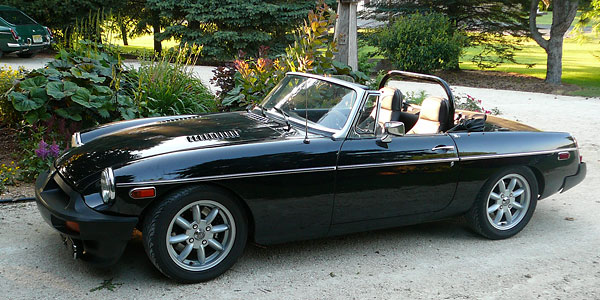

Martyn Harvey's 1980 MGB with Rover 3.5L V8
Owner: Martyn Harvey
City: Waterloo, Ontario CA
Model: MGB
Engine: Rover 3.5L
Conversion performed by: Larry Ellis (circa. 1992)
Intake: Offenhauser Dual Plane / Holley 390cfm 4bbl carb.
Cam: Isky 262.
Engine Electrical: Lucas original.

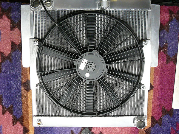

Cooling: MGB V8 radiator.
Exhaust: Clive Wheatley stainless.
Transmission: Rover 5-speed.
F. Suspension: uprated shocks, lowered springs.

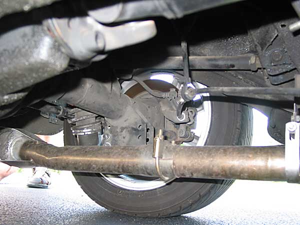

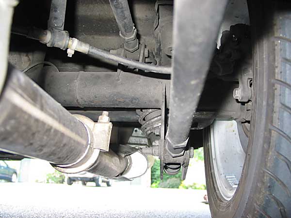

R. Suspension: custom 4-link with adjustable coil-over shocks and Panhard rod.

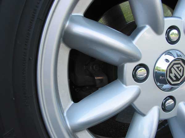

Brakes: (Front) Toyota vented rotors and 4-pot calipers / (Rear) Nissan disc brakes.
Wheels/Tires: MWS Minilights.
Interior: Pontiac Fiero seats with Mr. Mikes leather covers, louvered hood, RV8 style top.
Performance: 184HP at the rear wheels (dyno).
Completed: 1996.
Miles Driven: 40,000 (as of the British V8 2006 meet).

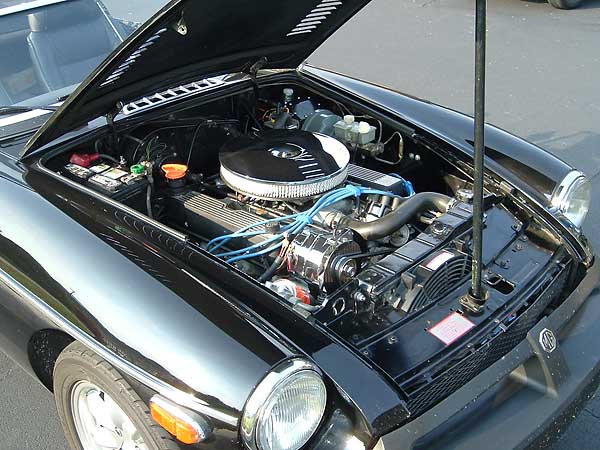

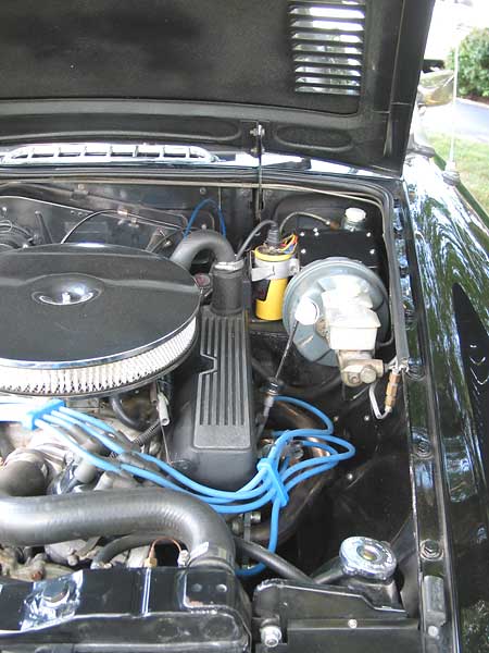

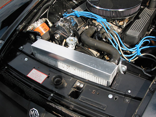

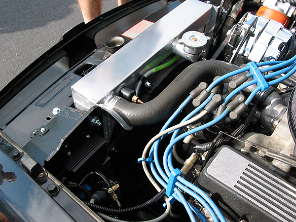

Notice the unique sheetmetal ducting added between the slam panel (where the hood latch is) and the radiator.

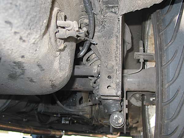

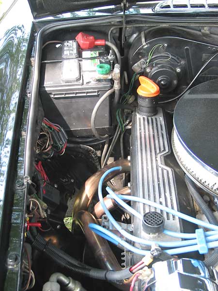

MGB battery location
The battery has been relocated here to make room for a four-link rear suspension.

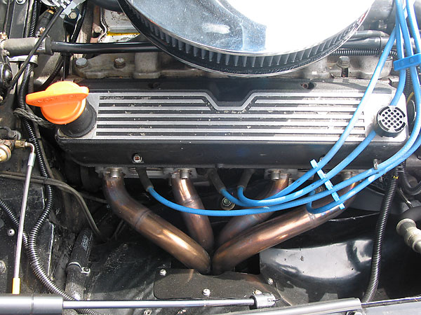

Stainless steel RV8 style through-the-inner-fender header
Stainless steel "RV8 style" through-the-inner-fender headers.

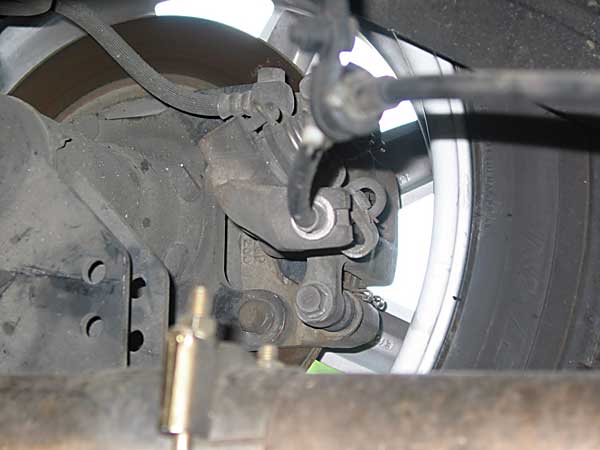

Nissan 240SX rear disc brakes
Nissan 240SX rear disc brakes, seen through 8-spoke wheels

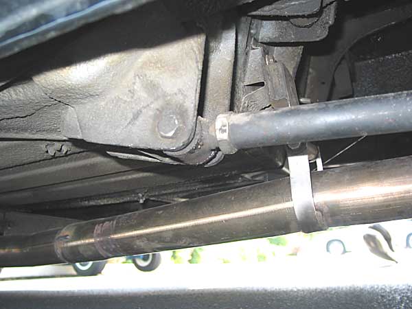

Stainless steel exhaust, Four link IRS, Panhard rod
So much in one photo! Stainless steel exhaust... four-link suspension... disc brakes... Panhard rod...

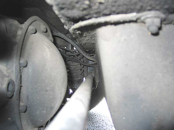

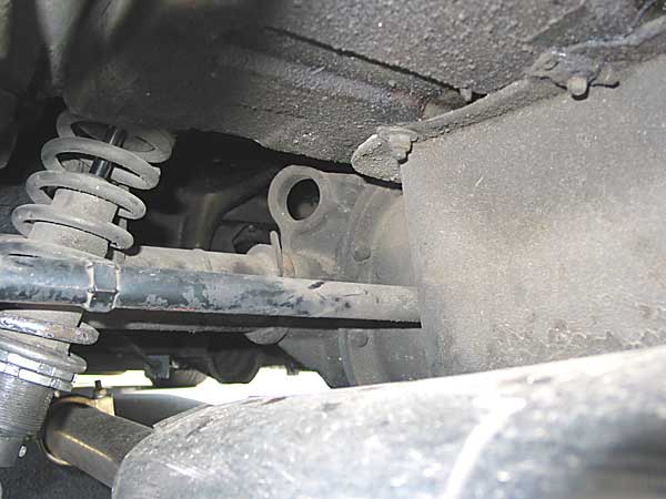

Ford 8.8 axle
Ford 8.8 axle (you can tell by the pierced ears on it's cast iron center section)
Panhard rod mounted rearward of the coil-over shocks
Pre-drilled holes facilitate re-setting the Panhard rod to level after ride height adjustment.
rear roll-center of the suspension
Panhard rod centered between axle and fuel tank; coil-overs centered between Panhard rod and axle.
With the Panhard rod mounted REARWARD of the axle it can be placed LOWER, which is generally very
desireable because Panhard rod location defines the rear roll-center of the suspension.

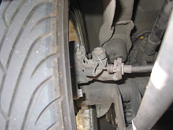

Nissan 240SX calipers emergency/parking brake
Early 90's Nissan 240SX calipers feature a cable-operated parking brake.
The Nissan 240SX rotors have MGB compatible (4x4.5) lug spacing.
