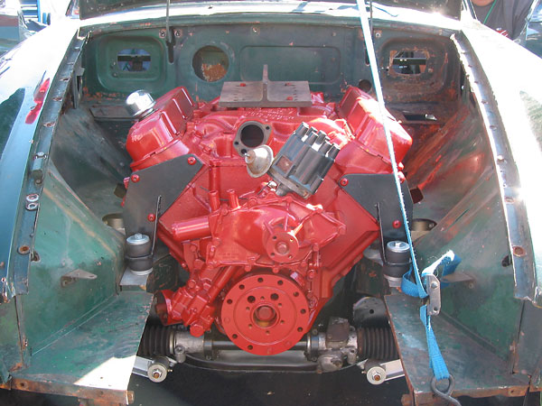

Big Block Buick V8 Engine
See? Plenty of room! A big block Buick V8 (455cid) fits like a glove into the "Project Roadmaster" MGB-GT.

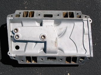

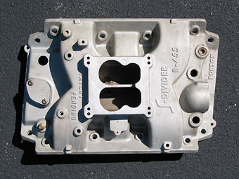

Posten S-Divider   EGR (exhaust gas recirculation) ready
Poston "S-Divider" intake manifold (part #B-455) is aluminum, and will reduce weight somewhat.

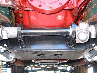

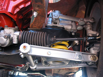

Modified front crossmember (note the steering rack brackets)   Lower control arm
Modified front crossmember (note the steering rack brackets).

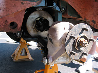

Narrowed Jaguar independent rear suspension   Lower control arm
Narrowed Jaguar independent rear suspension.

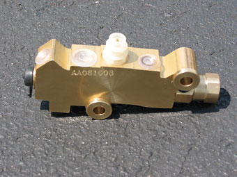

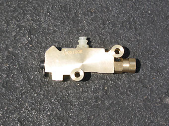

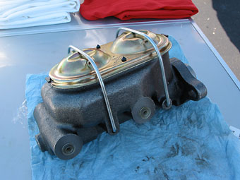

inboard disc brakes   Chevy Corvette master cylinder.
Jaguar inboard disc brakes, and Chevy Corvette master cylinder.

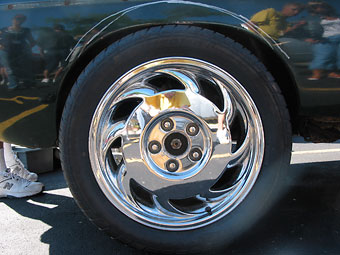

Jaguar wheel   Corvette wheel
For the time being, the Roadmaster is resting on mis-matched (Jag and Corvette) wheels - but that will change!

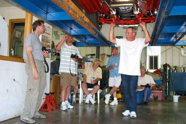

Paul Schils arranged use of a local shop's car lift, so that we could get up close and have a personal look at the Fast Cars suspensions, as installed on Terry Schulte's MGB-GT. We've discussed these suspensions in great detail in previous articles, so rather than repeat that discussion we'll refer you to our previous coverage: Fast Cars MGB Front Suspension & Fast Cars 3-link Rear Suspension. You may also want to review the rest of Terry's MGB GT V8 here.
Ted Lathrop explains features of Terry Schulte's MGB GT V8

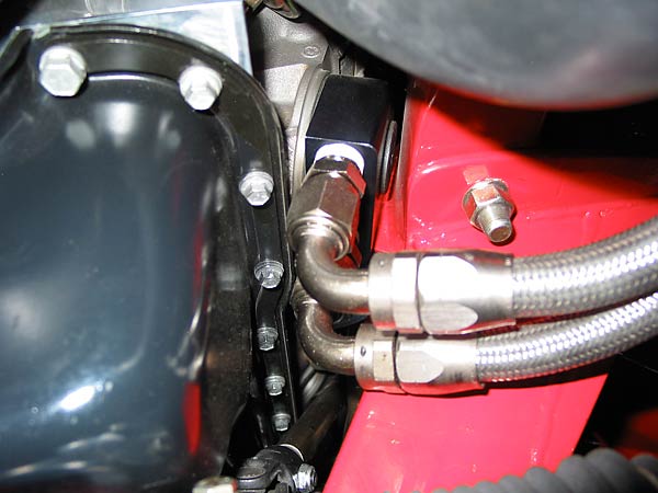

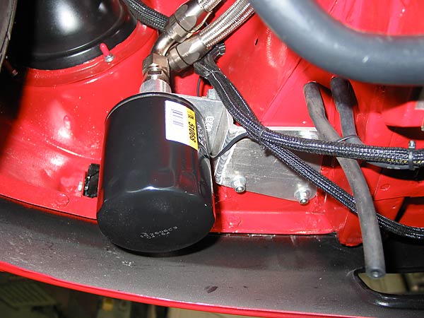

Plumbing for the Ford engine's remote oil filter.
The oil filter is mounted below the driver-side headlamp bucket.

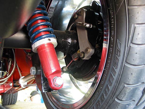

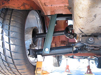

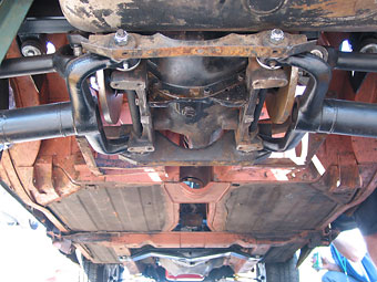

A Ford 8 inch rear axle is used in conjunction with the Fast Cars Inc. 3-link rear suspension.

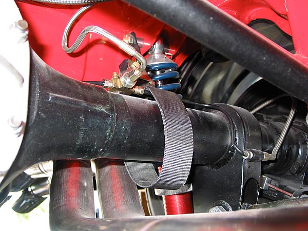

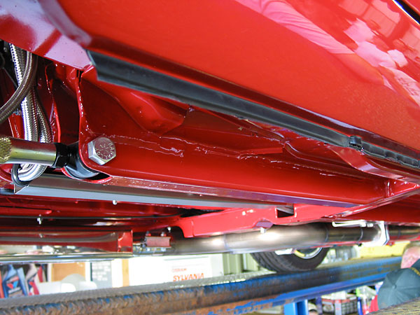

brace forward along the floorboard
The MGB's front leaf spring mounts are probably the weakest point on the chassis.
Fast Cars Inc. reinforces them by adding a brace forward along the floorboard.

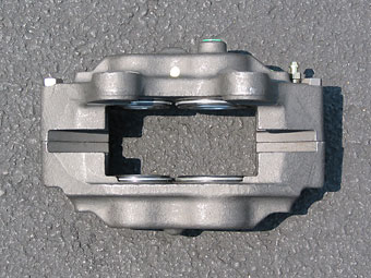

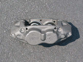

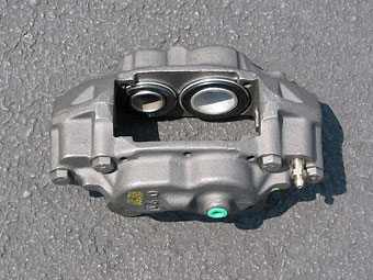

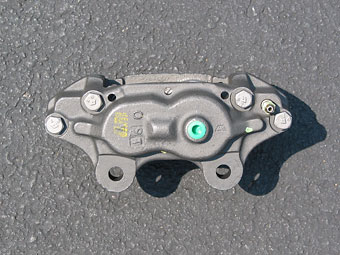

Toyota "4Runner" brake calipers (part #'s C8554 & C8555) are becoming popular as a bolt-on upgrade for MGC.
However, with a little creativity and development work, Pete thinks they might be a good option for MGB too.
Notice that these 4-piston Toyota calipers feature two larger and two smaller pistons. This is to even out pad wear.
On most cars, the "trailing" edges of the brake pads operate hotter and thus wear faster than the "leading" edges.

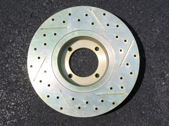

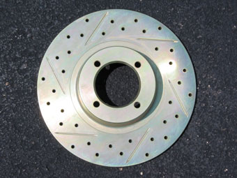

This is a cross-drilled and grooved MGB rotor, from EBC in England.

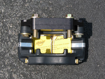

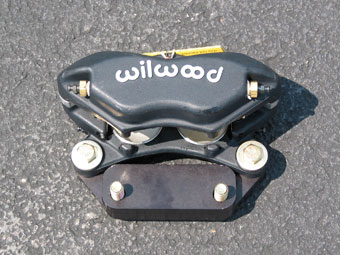

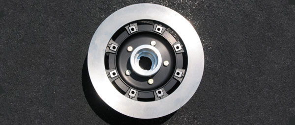

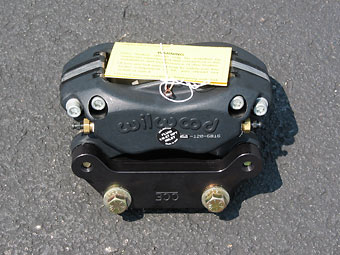

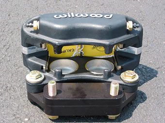

This lightweight aluminum Wilwood brake caliper is part of the Classic Conversions Engineering "big brake" kit.
To go with the Wilwood caliper, this is a "big brake kit" rotor and five-lug hug adapter from Classic Conversions.

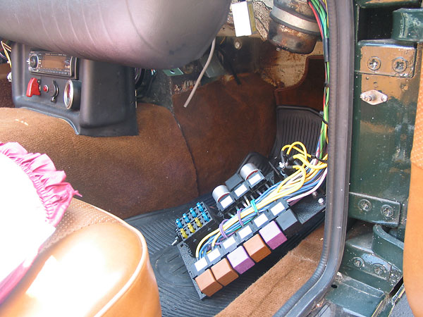

Excellent schematic drawings for British cars are available from Advance Auto-Wire

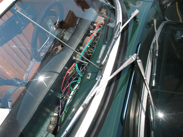

Look how easily the wiring is accessed on Mary Schils' MGB!

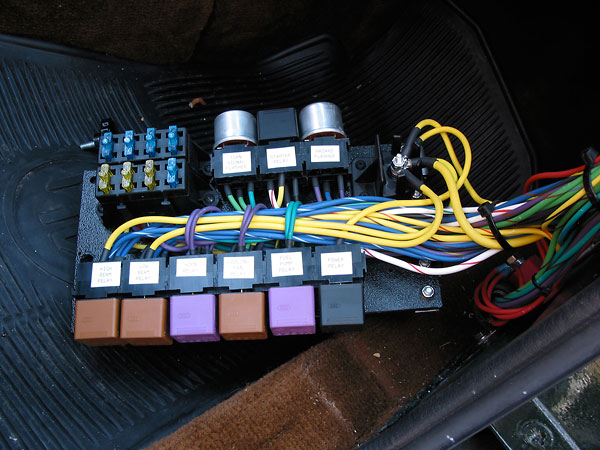

eight fuses, seven relays, two flashers
Advance Auto-Wire fuse block

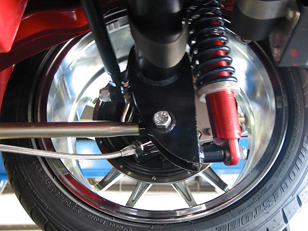

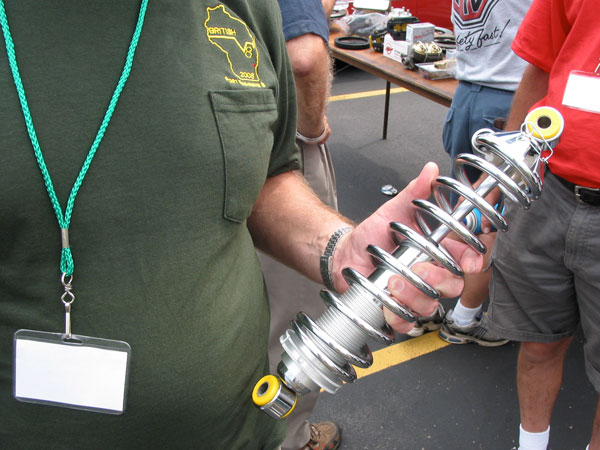

Bill's tech session was primarily a discussion of his new rear suspension design (although we talked a little about brakes too). If you'd like to know more about Bill's suspension, please refer to British V8 Magazine's article archive (Volume XV, Issue 3): The NEW "Classic Conversions" MGB 4-link Rear Suspension. A few small updates have been made to the suspension since the article was written. Notably, Bill has changed to a different supplier for shock absorbers (Carrera) and for link rods (AFCO Racing Products). The coil springs will now be chrome plated. The brackets will be powder-coated black.
Bill Guzman shows an MGB hub adapter
Carrera shock absorber
