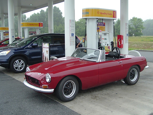

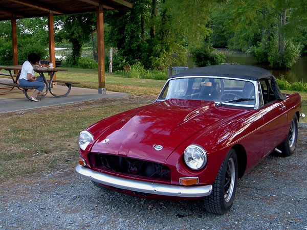

Several years went by and I wanted to help, so we made arrangements to get the car back and complete it. It took a lot of work but it was worth it! I think the results speak for themselves. Everyone who has driven it loves it and wants one. At the recent Endless Summer Cruisin' event, here in Ocean City, MD it drew a crowd wherever it went. It was the smallest car we saw cruising around. At the "Wheels That Heal" show in Salisbury, MD. many people wanted to know what it was and how it was done. (We refered them to BritishV8.org, of course.)

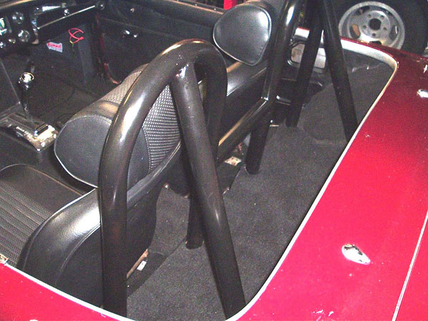

Since the three previous articles, I've built and installed a custom roll structure. I had S&W Race Cars of Spring City, PA bend the dual main hoops from DOM (i.e. seamless "drawn over mandrel") tubing. When I received the hoops a few days later, I welded the foot plates on and notched some tubing for braces and a crosspiece. It was all designed to fit under the MGB's convertible top. I think this design might work better than some others in the event of a rollover because it attachs to the MGB's unibody bodyshell in six different locations. I hope we never find out!

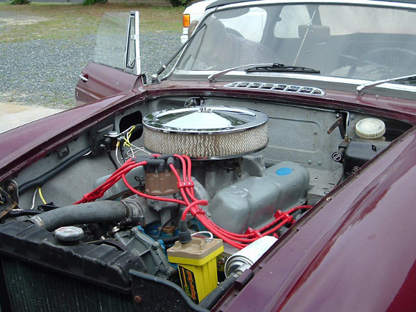

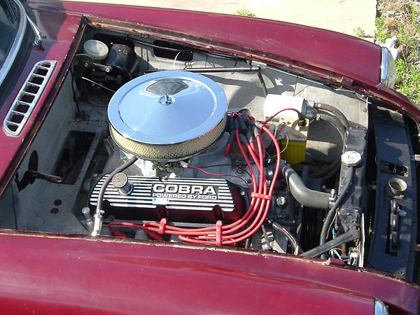

Engine: Ford 302 bored 0.030" over, to 306 cid. Flat top pistons. Ford cast iron cylinder heads with 3 angle valve job and minor porting. Comp Cams EX250H camshaft, with kit. Edelbrock F4B high rise aluminum intake manifold. Edelbrock AFB 4-barrel carburetor. Accel electronic distributor. Accel Super Coil ignition coil. High volume oil pump. Remote oil filter mount. Custom fabricated motor mounts & transmission crossmember.

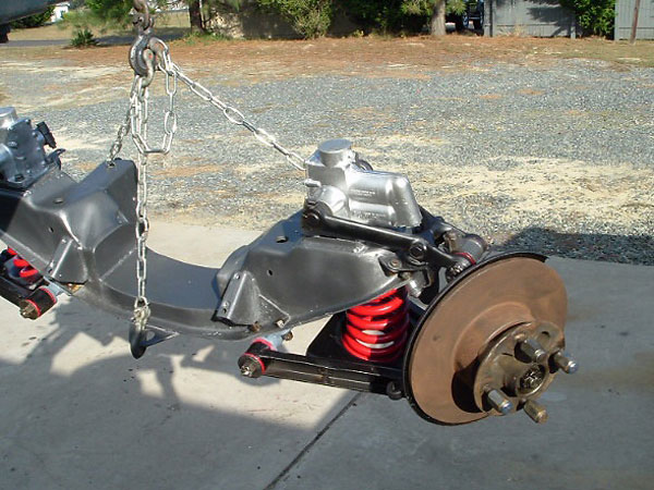

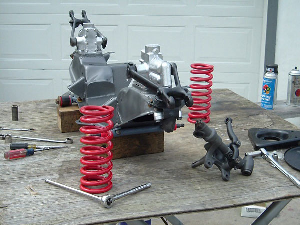

Front Susp.: modified front crossmember (for oil sump clearance). Heavy duty coil springs. Revalved Armstrong shock absorbers. Energy Suspension red polyurethane suspension bushings.

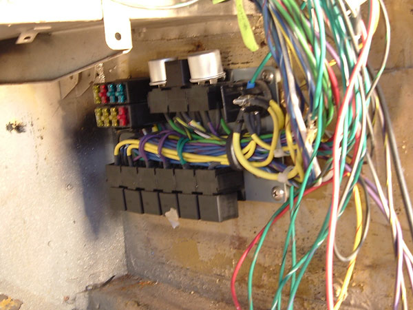

Electrical: complete wiring harness from Advance Auto-Wire. Delco-Remy alternator. Single 12V battery. Ford starter relay (on passenger-side inner fender).

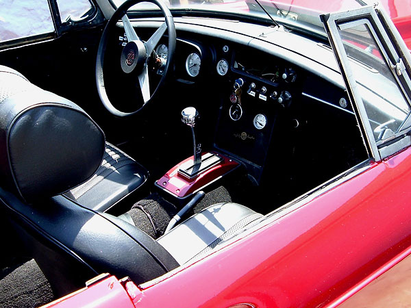

Interior: later model (1973-76) steering wheel. Later model (1970-72) MGB seats, with adjustable headrests and sewn-in narrow pleats. Dual hoop roll bar.

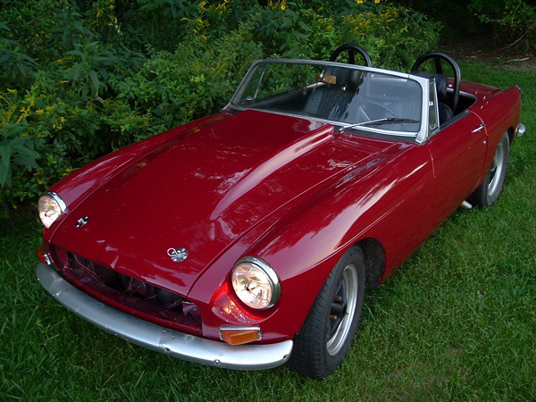

Body: stock, with Unlimited Products (SC-404) hood scoop added. Deleted bumper overriders and front grille. Six coats of Candy Apple red, with three coats of clear.

Ford 302 bored 0.030 over, to 306 cid.

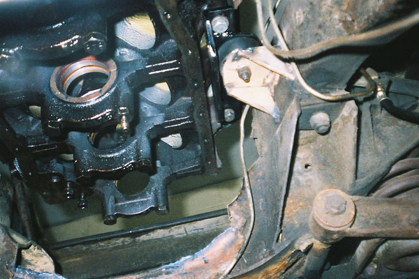

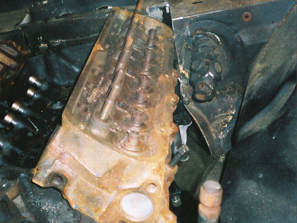

Test fitting the Ford engine on the new motor mounts.
Checking for clearance between cylinder heads and steering pass-thru.

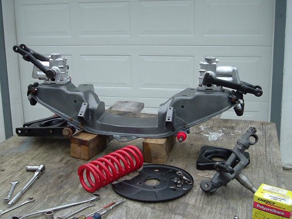

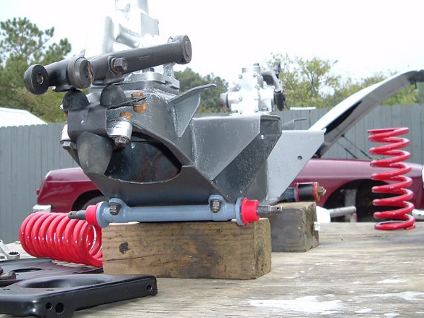

Front Suspension
The front crossmember has been modified for oil sump clearance.
Heavy duty coil springs and revalved Armstrong shock absorbers.
Energy Suspension polyurethane suspension bushings.
One of the nice features of the MGB model is that its front suspension can be removed as a unit.
One of the nice features of the MGB model is that its front suspension can easily be installed as a unit.

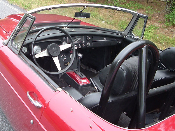

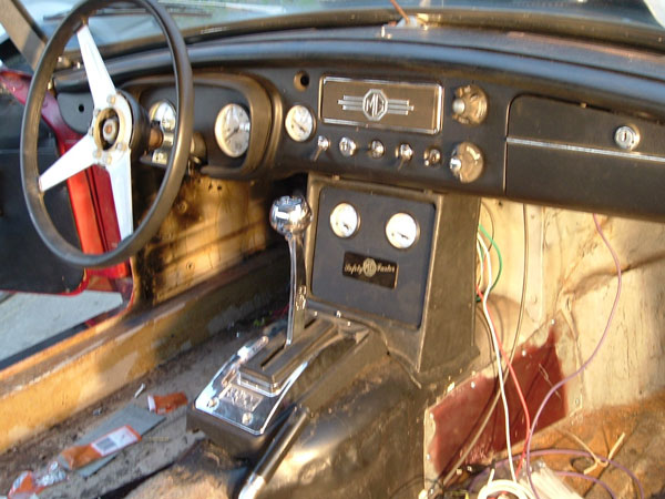

B&M QuickSilver ratchet shifter.
Later model (1973-76) steering wheel.

Speaker console reworked to house two gauges.
Advance Auto-Wire wiring harness.

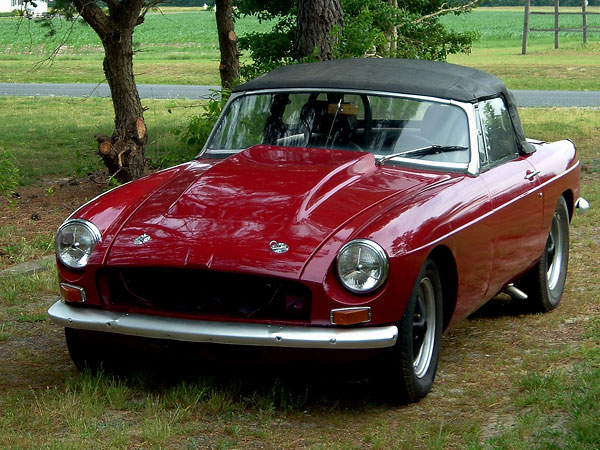

Wet paint! Six coats of Candy Apple red, with three coats of clear.

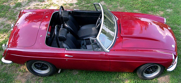

Unlimited Products SC-404 hood scoop.
The custom roll hoops were carefully designed to be strong, yet not block use of the convertible top.

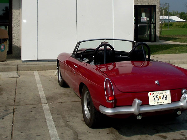

Back-up lamps didn't appear on MGBs until mid-1967.
