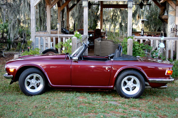

Van Wilder's 1971 Triumph TR6 with Ford Motorsports GT-40 Engine
as published in BritishV8 Magazine, Volume XX Issue 2, December 2012
Owner: Van Wilder
BritishV8 UserID: Wildtr6
City: Brooksville, Florida
Model: 1971 Triumph TR6
Engine: Ford Motorsports GT-40 (302cid) V8
Conversion by: see "Comments" below.

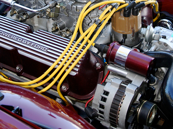

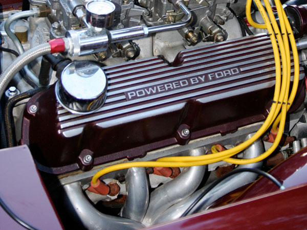

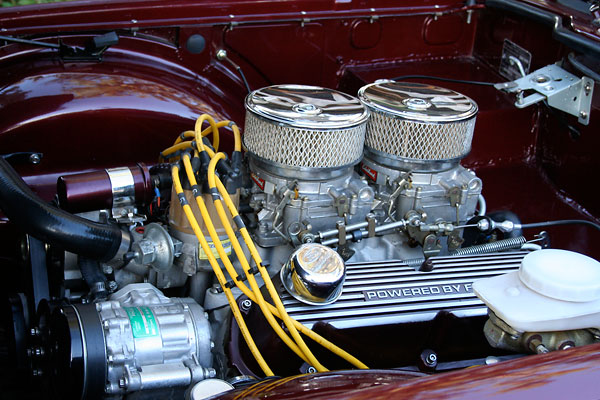

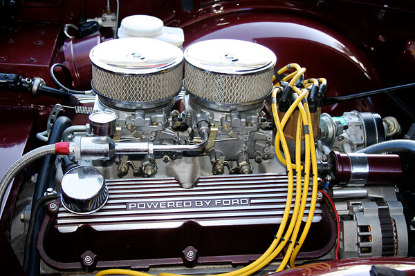

Engine: Ford Motorsports GT-40 (302cid) V8 engine. B-303 billet hydraulic roller camshaft. Accel Distributor (bronze 51201E). Edelbrock intake manifold. Dual Edelbrock 1404 four barrel carburetors. Vintage Air "Frontrunner" serpentine belt drive system (alternator, water pump, etc.) Remote oil filter.

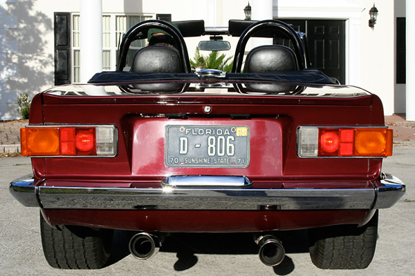

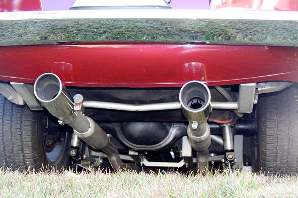

Exhaust: four-into-one headers with Jet-Hot ceramic coating. H-pipe crossover. Flo-Pro Super V mufflers. Resonator tips.

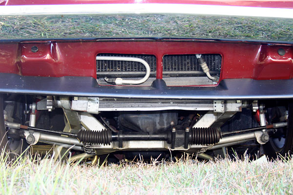

Chassis: new custom tubular frame. Fast Cars, Inc. coilover front suspension with anti-dive. Fast Cars, Inc. coilover 3-link rear suspension.
Brakes: (master) stock master cylinder with power brakes. Proportioning valve. Jamar "park-lok" parking brake.
(front) Wilwood Dynalite 4-pot calipers. Wilwood 11.75" vented rotors.
(rear) Wilwood Dynalite 4-pot calipers. Wilwood 11.75" vented rotors.

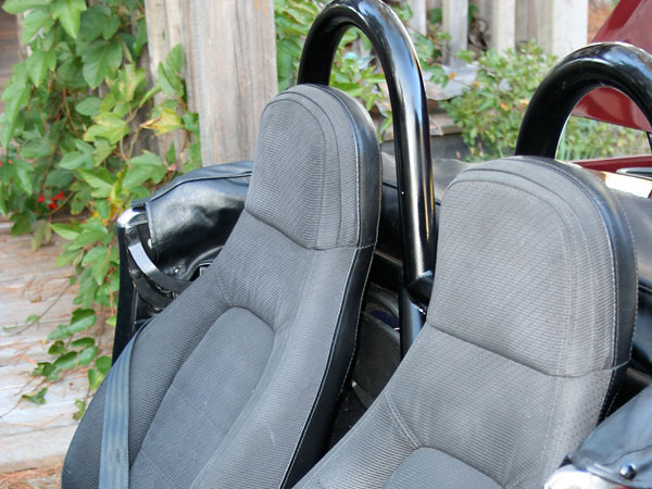

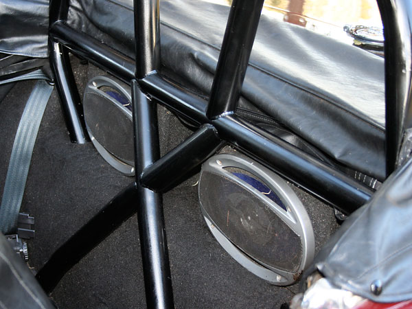

Body: 2 hoop rollbar custom built to match contour of Miata seats with 3 frame connects. Stainless steel wire mesh grille. Tulius fiberglass racing hood modified with cut-down Z28 scoop for cowl induction. Sunfast convertible top. Paint and finish bodywork by Jessie Embry of Hudson Florida.

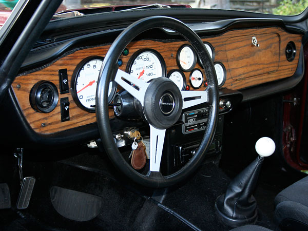

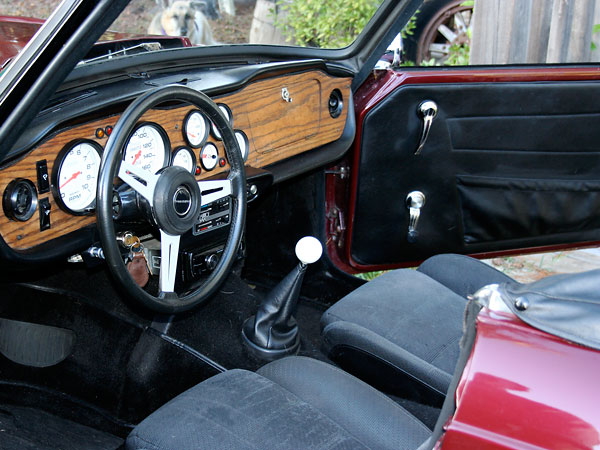

Interior: Solid oak dash by Dan Masters. Autometer Phantom gauges. Vintage Air Mini Gen II A/C, heat, defrost, with Sanden compressor. Pioneer stereo radio and compact disc player. Miata seats. Lizard Skin heat and noise insulation. Koolmat by Roadspeed Garage in Georgia.

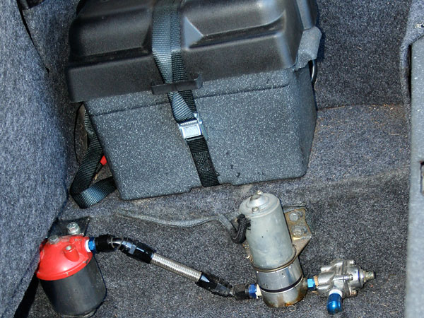

Electrical: Advance Auto Wire harness with 8 fuse fuseblock. Ford Motorsport compact starter motor. Delco CS130 style alternator. Trunk mounted battery.
Fuel system: 15 gallon custom fuel tank. Mallory fuel pump. Holley adjustable fuel pressure regulator.
Accel Distributor (bronze 51201E). Delco CS130 style alternator.

Suspension and Brakes
FastCars replacement chassis for Triumph TR6
Read all about the FastCars replacement chassis for Triumph TR6.
Three-piece anti-sway bar.

Dan Masters crafted this beautiful solid oak dashboard.
Sparks and gasoline fumes in the same enclosed space.
"The original fabricated gas tank I got from Dan Masters was a beautiful fit until I wanted
to put the top down. Then, it was back to the drawing board and eventually cut down to
15 gallons, which is plenty."

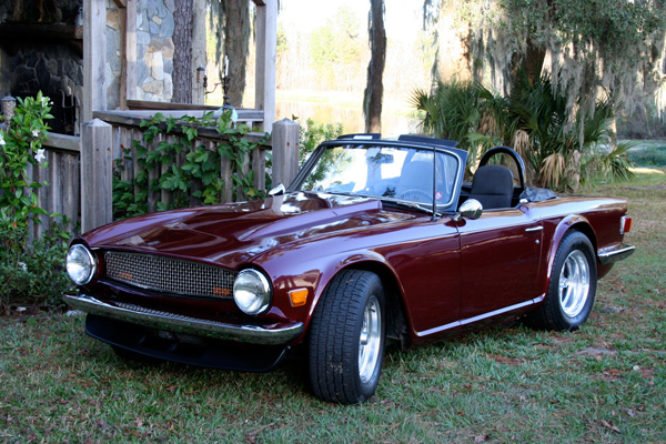

Awesome power and a super-smooth ride delivered by an old-fashioned British sports car.

Resonator exhaust tips.
