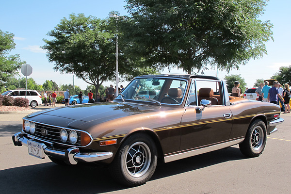

Glenn Merrell's 1973 Triumph Stag with Original Triumph 3.0L V8
as published in British V8 Newsletter, Volume XXI Issue 2, December 2013
Owner: Glenn Merrell
BritishV8 UserID: StagByTriumph
City: Lafayette, Colorado
Model: 1973 Triumph Stag
Engine: Triumph 3.0L V8
Engine: Triumph 3.0L V8 engine, rebuilt. Dual Zenith Stromberg 175 CDSEV carburetors. Lucas 35D8 distributor. Pertronix Ignitor breakerless/electronic ignition module. Pertronix Flame Thrower ignition coil.
Exhaust: all stainless steel dual exhaust system. Dual stainless steel mufflers.
Cooling: stock radiator. Stock engine driven cooling fan. Stock dual electric fans ahead of the air conditioning condensor. Polycarbonate reproduction radiator cowling.
Transmission: Borg Warner Type 35 three speed automatic.
Rear End: Triumph Stag 3.43:1 ratio. Phantom Grip limited slip differential. Goodparts CV jointed rear axles.
Front Susp.: stock MacPherson strut suspension. KYB strut cartridges. SuperFlex polyurethane bushes.
Rear Susp.: stock independent suspension. KYB shock absorbers. SuperFlex polyurethane bushes.
Brakes: stock Lockheed master cylinder and power brake servo. EBC drilled/slotted front brake rotors. EBC Green Stuff pads. Dust shields temporarily removed. Stock rear drum brakes.
Wheels/Tires: stock 5-spoke alloy wheels. Pirelli P400 Touring 185/75R14 tires.
Body: repainted with 2006 Ford Metallic Bronze paint. Brown mohair soft top. Body color factory hard top.
Interior: interior restored. Leather trimmed dashboard top. All carpets replaced. Stock instruments. Original factory-installed air conditioning.
Comments: Glenn is the third owner of this California car. He purchased it on July 2 of 2011 immediately before the Vintage Triumph Registry meet at Breckenridge Colorado, where it placed second in Concours judging! It's a very, very original car in almost all respects. The most conspicuous exception is its paint color. The hue is close to original, but the new paintjob features metallic flakes. This is no trailer queen though; Glenn drives it frequently and BritishV8 photographed it at a casual "cars and coffee" meet-up.

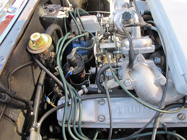

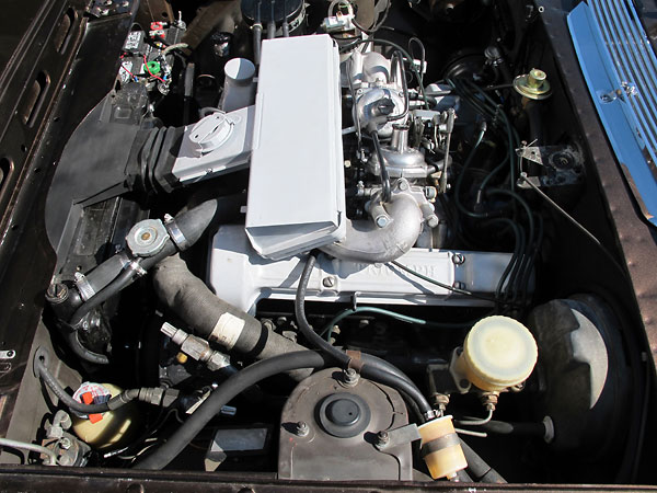

Triumph 3.0L V8 engine, rebuilt to stock specs except with flat top pistons.
Triumph 3.0L V8 engine, rebuilt to stock specs except with flat top pistons to
slightly raise the compression ratio from a starting point of ~7.75:1.
From the factory, Triumph's V8 was rated 146bhp at 5700rpm.
Triumph 3.0L V8 engines came in a low power version for U.S.A. and a higher power version
for the rest of the world. Initially, the U.S. version was rated 127bhp @ 6,000rpm & 142lb⋅ft
@ 3,200rpm. In early 1973, Triumph modified the U.S. variant's tuning and revised its rating
to 127bhp @ 5,500rpm & 148lb⋅ft @ 3,500rpm. 1973-on home-market engine ratings were
146bhp @ 5,700rpm & 167lb⋅ft @ 3,500rpm, achieved with a static compression ratio of 9.25:1.

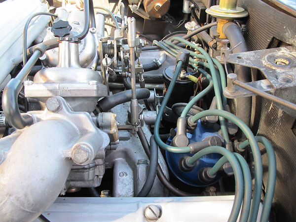

Dual Zenith Stromberg 175CDSE carburetors.

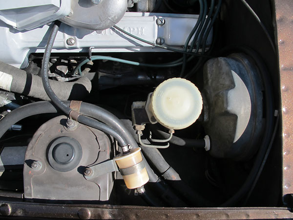

Power brakes were standard equipment on Triumph Stags.
Power brakes were standard equipment on Triumph Stags. (AP Lockheed master cylinder.)

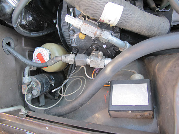

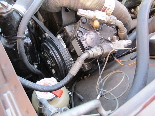

Panco air conditioning compressor controller.
Foreground: a Panco high pressure cut-out for the air conditioning compressor.
(Note uplugged bullet terminal: the A/C compressor has been temporarily disconnected.)

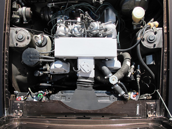

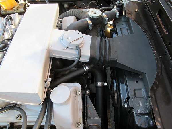

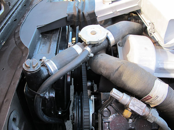

Radiator filler.
Radiator filler.
Panel air filter.
Panel air filter.
Genuine Triumph Stag stamped steel radiator cowling parts are very hard to come by.
Glenn Merrell has tooled up to make polycarbonate reproductions which look quite
authentic. He offers them as a three piece set, for $300. Bonus: they'll never rust!

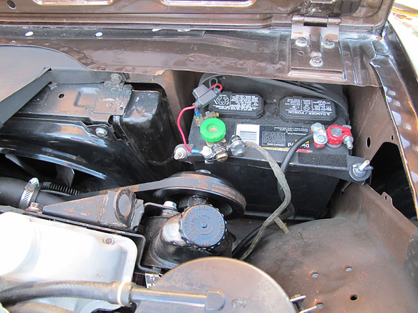

Sears DieHard battery.

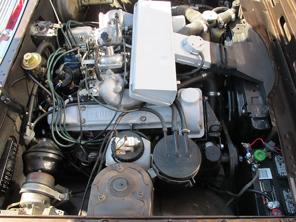

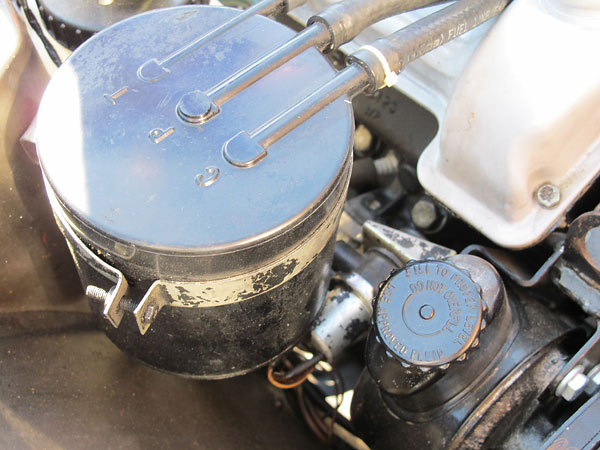

How does an evaporative emission system's charcoal canister work?
Charcoal canister: vapors from the fuel tank vent and the carburetor bowl vents are adsorbed
by activated carbon instead of polluting your garage and neighborhood. Later, fresh air is
drawn through the canister so the fuel fumes may be burned off. Evaporative emission
controls are reasonably simple, easy to maintain, and effective.

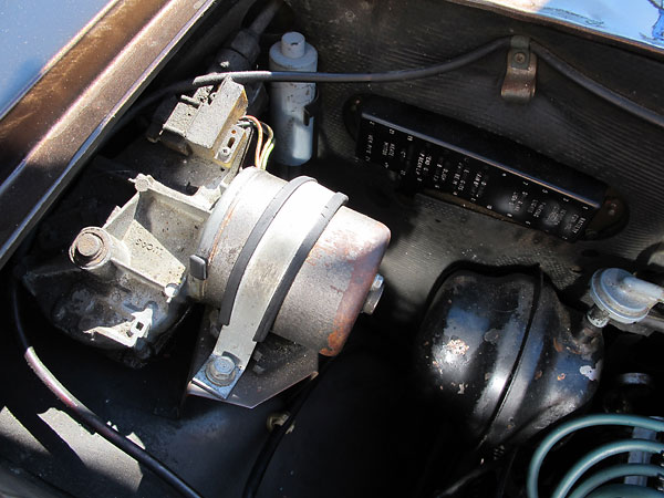

Clockwise from left: wiper motor, inertia switch, fuse block, and vacuum reservoir.
Clockwise from left: wiper motor, inertia switch, 12-circuit fuse block, and the
reservoir for vacuum operated climate control system air flaps and heater valve.

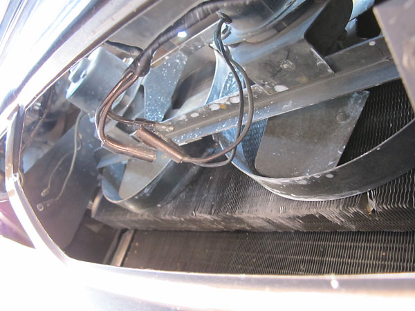

Temporarily disconnected electric fans for the AC condensor.

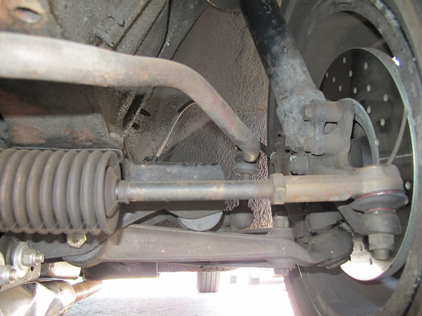

Front Suspension
McPherson strut front suspension.

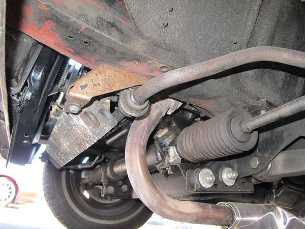

Transmission oil cooler.

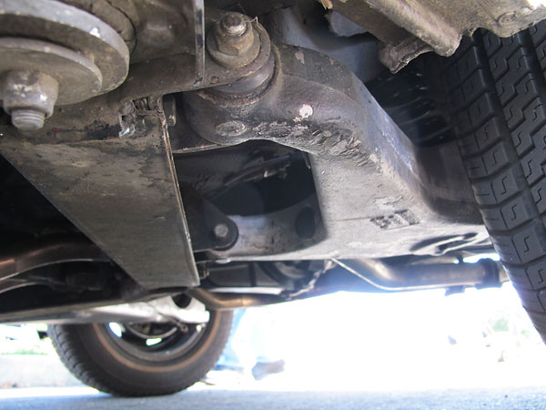

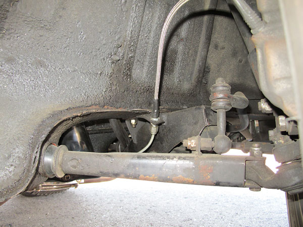

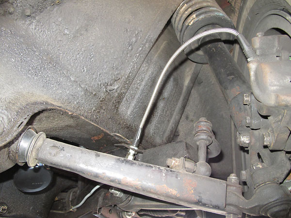

Rearward half of two piece lower control arm.
Rearward half of two piece lower control arm. (There is, of course, no upper control arm.)
Coil spring.
Coil spring.

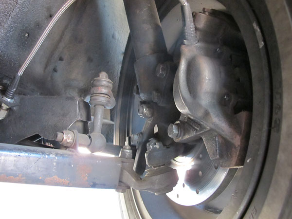

Brake caliper.
Brake caliper. (Dust shield temporarily removed.)
EBC grooved and dimpled front brake rotors.

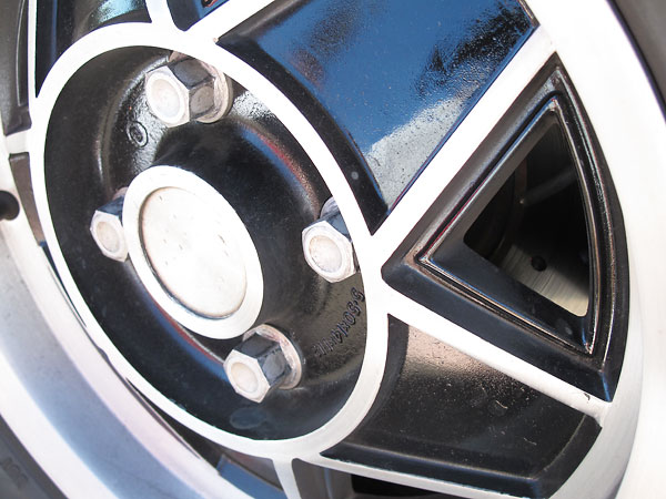

Wheels are marked: 5.50 x 14 x 1.12.
Wheels are marked: "5.50 x 14 x 1.12."

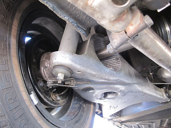

Triumph Stag independent rear suspension.
Coil springs, telescoping shock absorbers, and drum brakes.
Original features: coil springs, telescoping shock absorbers, and drum brakes.

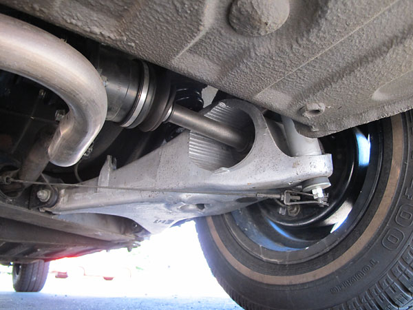

Good Parts CV-jointed rear axles.
Upgraded feature: Good Parts CV-jointed rear axles.

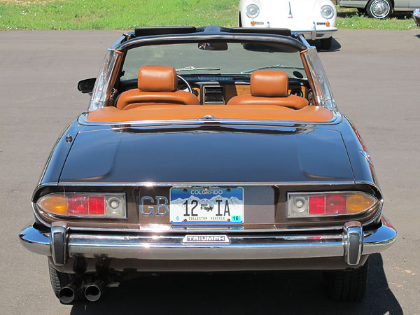

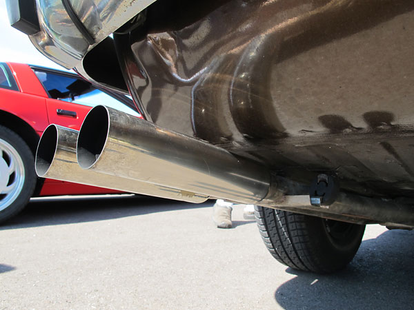

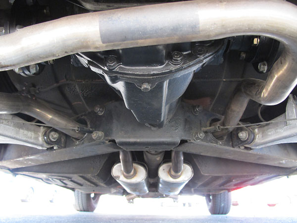

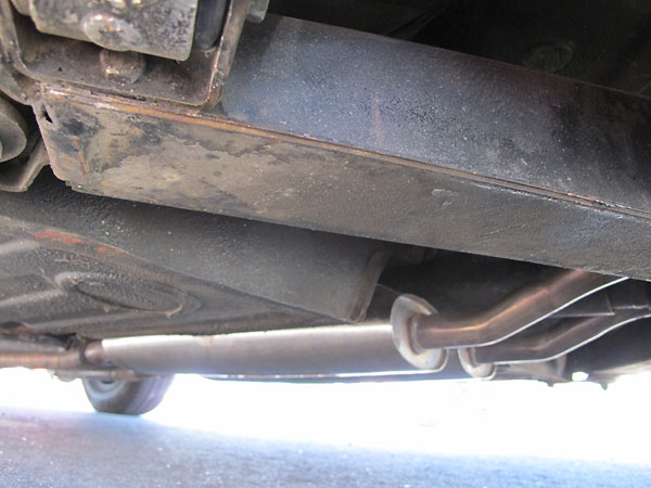

Dual stainless steel mufflers are an upgrade from stock.
Dual tailpipes.
Dual tailpipes.

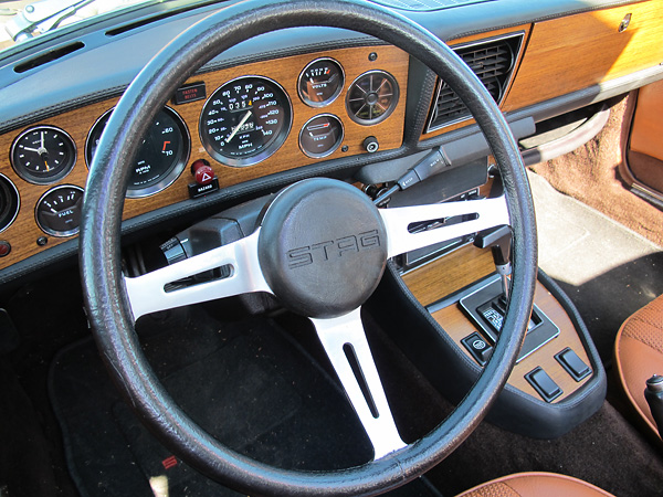

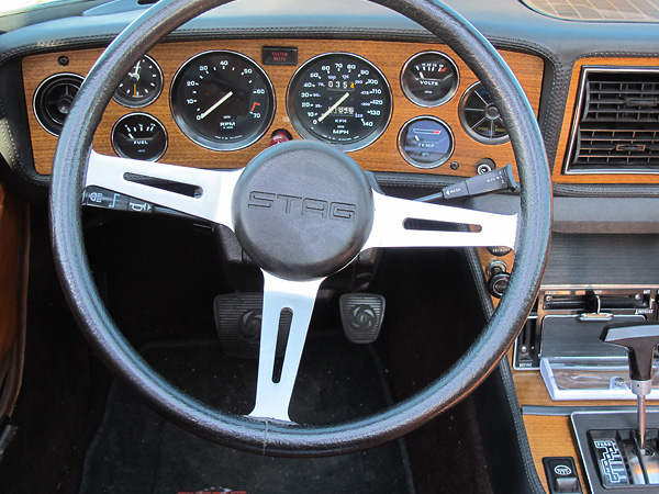

From the 1973 model year onwards, Triumph Stags came with a smaller diameter steering wheel.
From the 1973 model year onwards, Triumph Stags came with smaller diameter steering wheels
(as shown here.)

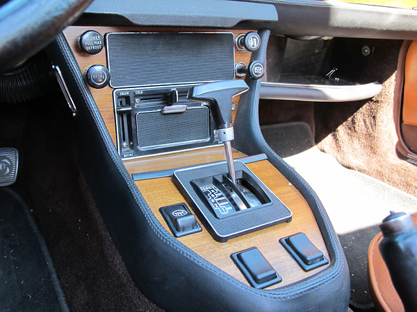

Most Triumph Stags were equipped with Borg Warner Type 35 3-speed automatic transmissions.
Four speed manual transmissions were optional equipment. Four speed transmissions with
Laycock overdrive units were a less popular factory installed option.

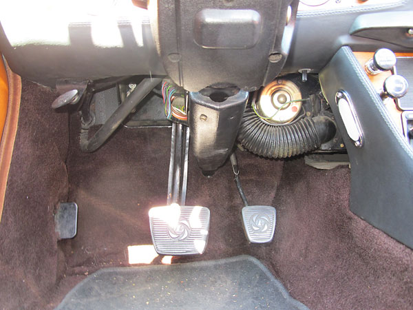

Triumph Stag pedals.

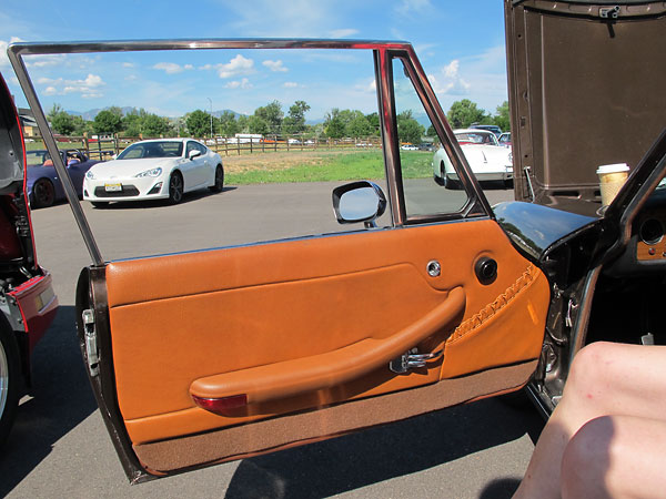

Electric windows were standard equipment.

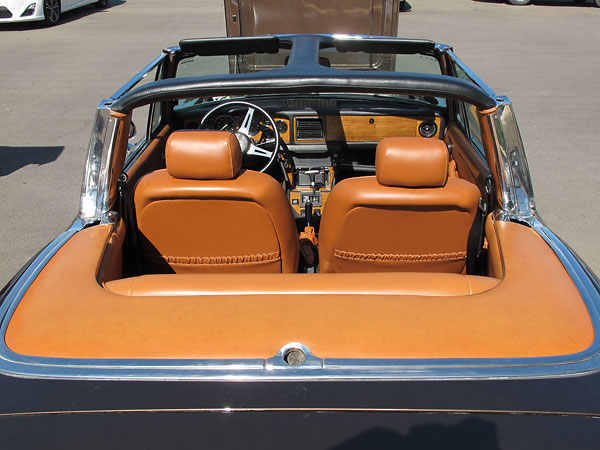

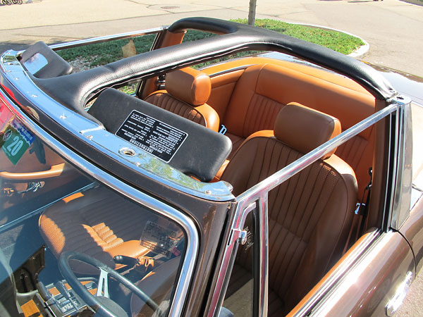

The Triumph Stag features unibody construction with a unique supplemental T-bar structure.
The Triumph Stag features unibody construction with a unique supplemental "T-bar" structure.
Why? Despite having vary different styling, the Stag underpinnings were derived from Triumph's
"2000" saloon, which had a full steel roof and which was equipped with a much less powerful
engine. The T-bar was deemed necessary to add stiffness to the Stag's otherwise open body.
Most Triumph Stags were provided with both a soft top and a hard top.
From the 1973 model year onwards, Triumph Stags were provided with both a soft top and
a hard top as standard equipment. With either top installed, the T-bar is underneath and
separate from the roof. This is distinctly different from a "T-top" design as seen on
Chevrolet Corvette models and some other General Motors products.

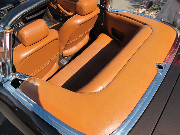

Triumph Stag back seat.

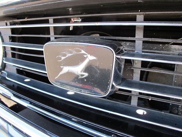

Triumph Stag grille badge.

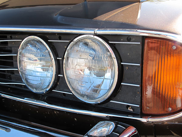

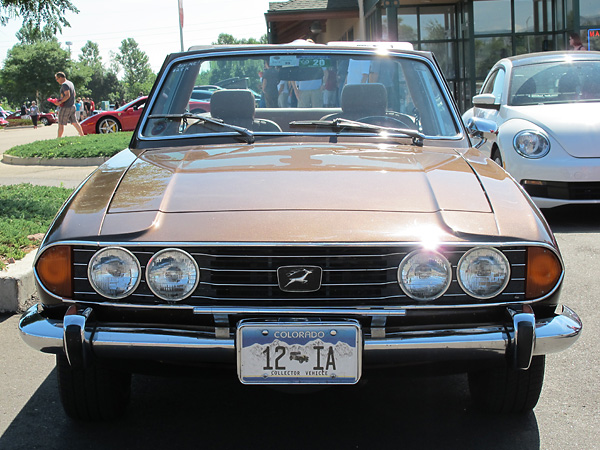

Sylvania Halogen sealed beam headlights.

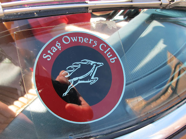

Stag Owners Club windscreen decal.

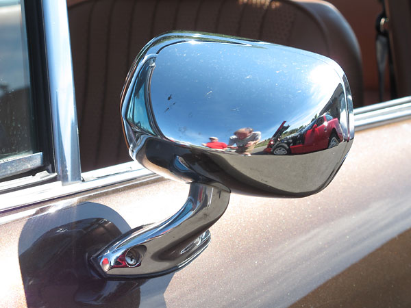

Triumph Stag side view mirror.

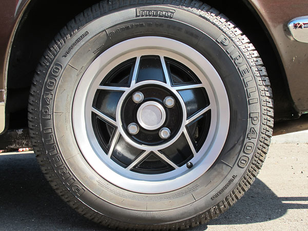

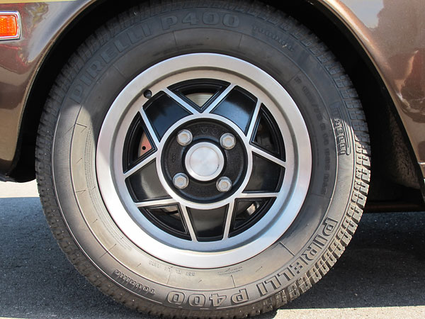

Triumph Stag Mk2 5-spoke alloy wheels.
Triumph Stags were initially provided with Rostyle steel wheels as standard equipment and
with wire spoke wheels as an option. From the 1973 model year onwards, this style of 5-spoke
alloy wheels was offered instead of the wire wheel option.
