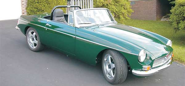

Robert Milks' 1965 MGB with Buick 215 V8 Engine
Originally featured in British V8 Newsletter, Volume 11 Issue 2. Updated May 2015. (Scroll down for earlier version.)
Owner: Robert Milks
BritishV8 UserID: RobM65BV8
City: Hendersonville, NC
Model: 1965 MGB
Engine: 1963 Buick 215 V8
Conversion performed by: Gary Nye of Nye Performance, Brevard NC
Engine: 1963 Buick 215cid aluminum V8, built by Dan LaGrou. The compression ratio is 9.6:1. The engine is equipped with both lateral and rotational stabilizers. Valve covers are aftermarket UK MGB GT. Correction from previous notes: Engine mounts are stock Buick. 500 CFM Edelbrock 1404 carburetor, using 1422/1426 jets and a 1460 metering rod for two stages lean on both power and cruise mode, with a stock manifold. Throttle linkage from D&D.
Transmission: 1983-87 Borg Warner T5 NWC 5-speed from D&D with a .63 overdrive. TransAdapt bellhousing from D&D. Clutch is a Sachs 10.4", with a McLeod 1400 HTOB and a 1420 adjuster screw. Flywheel is a 28 lb. unit.
Electrical: Pertronix ignition, MSD 6A control box and coil, Powermaster 150 amp alternator and a mini starter. Gauges are stock, but with an electronic tach and Smiths GPS speedometer. Voltmeter is installed to the left of the fuel gauge. The windshield wiper was replaced with a 2-speed Mark II unit. Painless Wiring. Lucas European headlamps with LED bulbs.

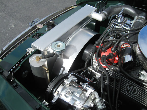

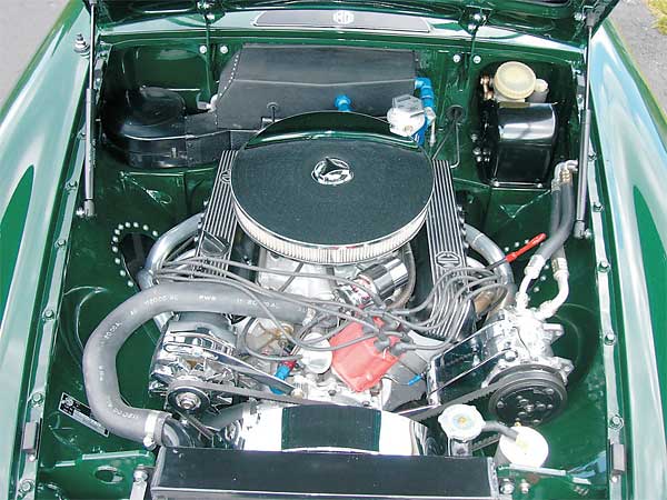

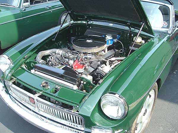

Cooling: A FlowKooler high volume aluminum water pump, with an overdrive pulley. The radiator is an 18" x 18" aluminum Be-Cool with integral fan shroud and a 16" 2070 cfm Spal fan. Two small pusher fans operate with the a/c.

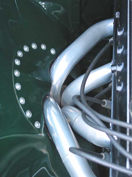

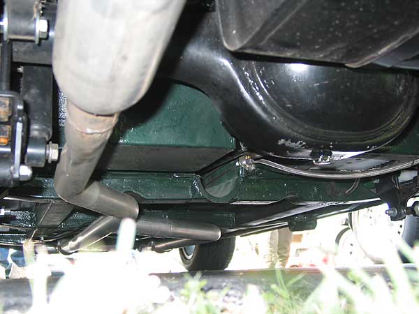

Exhaust: RV8 headers, Jet Hot coated by D&D, with a 1 3/8" primary tube ID. Early cars have the gas tank skewed to the right side, so this car has a single exhaust pipe of 1 3/8" ID aft of the Y pipe. Muffler is a Flowmaster Super HP-2 with an Ansa tip.
Rear Axle: 1975-79 Ford Grenada 8" rebuilt and modified by Ted Lathrop of Fast Cars Inc. with a Moser gear set at 3.55:1 ratio and an Auburn limited slip differential. The driveshaft is a shortened MGB shaft.
Front Suspension: Stock early crossmember, lever shocks with heavy-duty valves, 1" lowered 480 lb. springs and a 3/4" sway bar. Later model slower ratio steering rack. 3 degree caster wedges to lighten the steering effort.
Rear Suspension: Classic Conversions 4-link with QA1 coil-over shocks set to 1" lower than stock, replacing leaf springs, track bars, sway bar and panhard rod (and the even earlier traction bars).
Brakes: Front: "Ted's Big Brake Kit" by Ted Lathrop of Fast Cars, Inc. 11.75" vented Wilwood discs and C&C hats, Dynalite 1.75" four-piston calipers.
Rear: 11.00" vented Wilwood discs, Dynapro 1.38" four-piston calipers with integrated drum e-brake, p/n 140-11403. The smaller volume of the rear pistons reduced the pedal travel with the brake master cylinder from a Mark II dual unit. Wilwood proportioning valve.

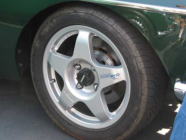

Wheels/Tires: Compomotive 16 x 6.5, 31 mm offset; 4.9" backspace, with 205/50ZR16 tires. Fenders were trimmed to the welds for clearance, but flares weren't needed.

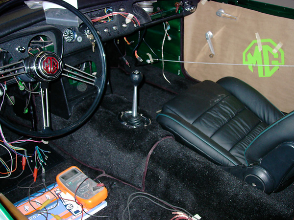

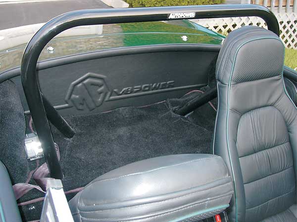

Interior: 1990 Miata seats with custom "Katskin" leather upholstery, custom door and rear bulkhead trim panels were made up by Murdock's Auto Upholstery shop, Brevard, NC. The MG logo formed on the doors and additionally includes "V8 Power" on the rear bulkhead. Stock banjo steering wheel downsized one inch in diameter using a Midget rim.
AC: Air conditioning is a Hot Rod Air unit (similar to Vintage Air), with fold-flat Acura eyeball vents behind removable original console speaker grill. Controls are incorporated into original dash heater controls.
Stereo: Kenwood flip face stereo system with MG blanking plate on reverse. Amp is in an enclosed extra battery box.
Body: Visually, the body is a stock pull-handle with an aluminum hood, but modifications have been made to the floor cross members and to the bulkhead. The floor members are strengthened by the addition of an extra transverse hat section bracing at rear bulkhead and the A-Post and an extra longitudinal hat section bracing forward of rear bulkhead. The firewall, front valance and steering rack are from a 1977 MGB. Seam sealer was used extensively. A full body restoration was done by Gary Nye, of Nye Performance, Brevard, NC.
Paint: The paint color is XKE Series 3 BRG. 3 coats of acrylic enamel were applied over multiple primer coats

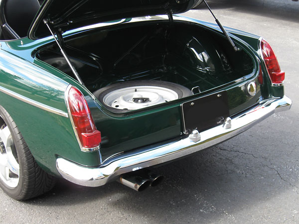

Struts: Hood and trunk struts are Stabilus 752827 150# for both front and rear.

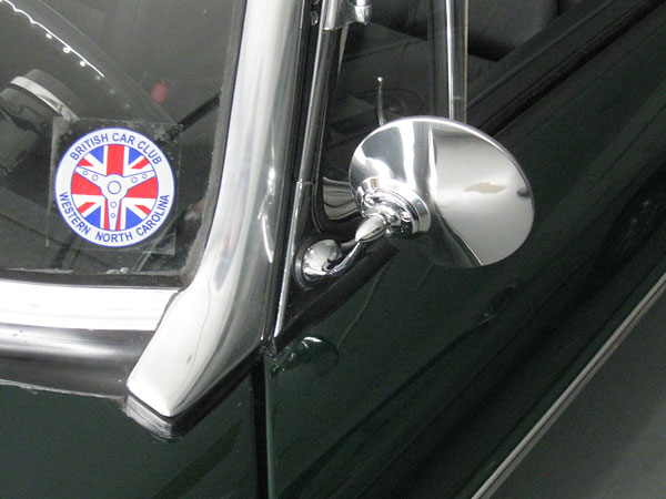

Outside Mirror: Outside Mirror TR4 right-hand fender mirror mounted on the left wing window frame.
Bumpers: OEM bumper over-rider bolts welded, shaved and re-chromed. CB license plate lamps mounted directly on the bumper. Fitted with an early stainless radiator grill from 1962-64
On the road: 5/1/2003.
Comments: Our focus was to maintain the clean lines of early "pull-handle" MGBs. Other than the wheels and roll-bar, our car looks pretty much stock. What would I do differently on the next conversion?

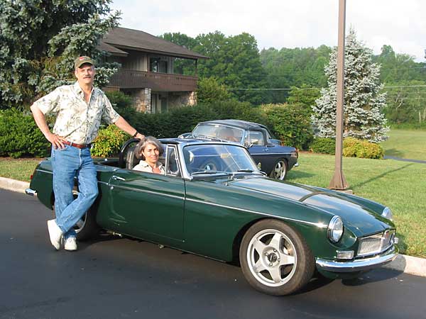

Robert and Dreama Milks
Robert and Dreama Milks at BritishV8 2006, Townsend Tennessee

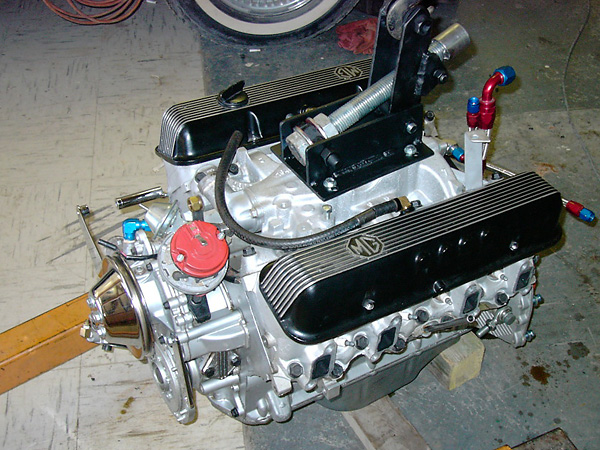

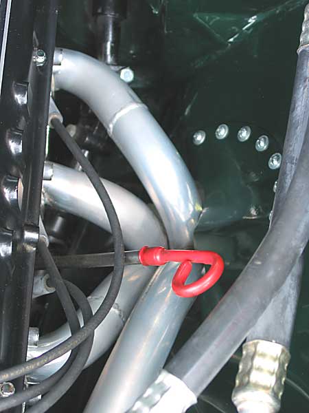

Buick 215 aluminum V8, note extended dipstick tube and tilting hoist mechanism
engine overview, including AC system
MGB hood struts (aka gas springs)
2010: BeCool aluminum radiator has replaced the earlier D&D unit.
2010 update: BeCool aluminum radiator has replaced the earlier D&D copper/brass unit.

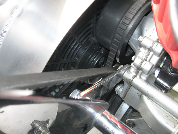

2010 update: a smaller water pump pulley speeds coolant flow rate.

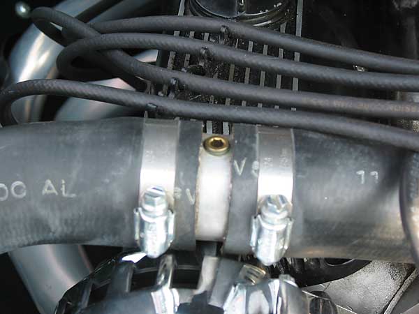

trick for purging air from cooling system
Jet Hot coated headers
RV8 style headers

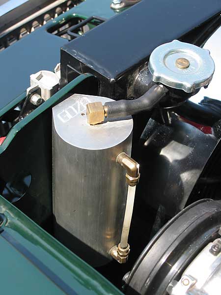

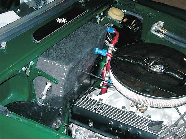

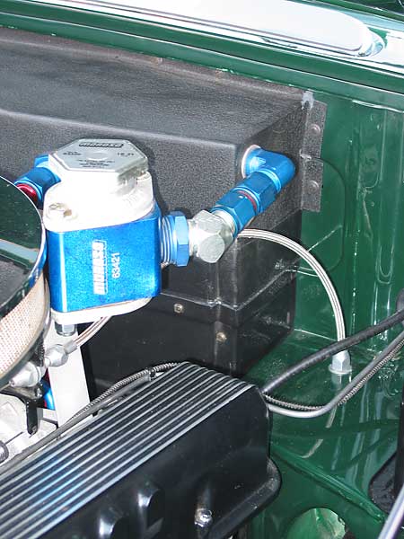

Moroso remote filler
sight glass for coolant level

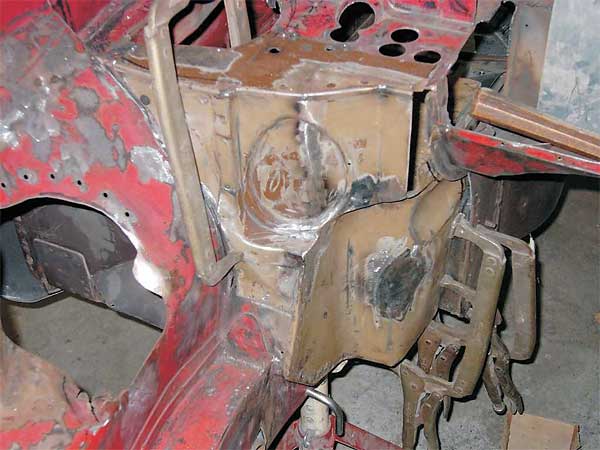

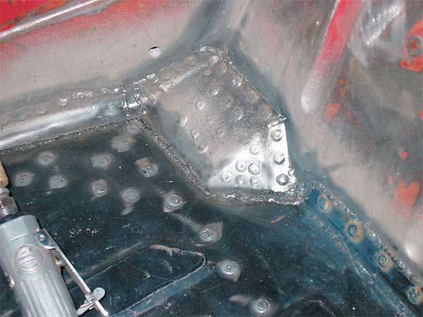

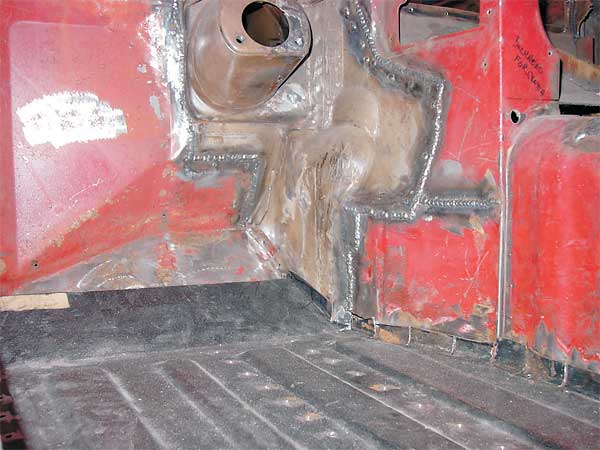

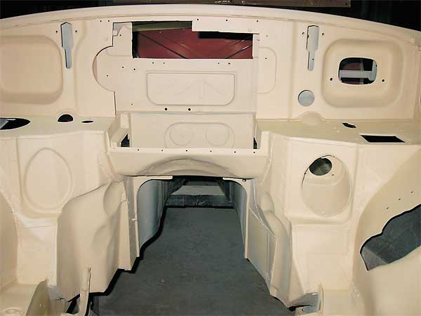

Bodyshell Modifications
Drivers side footbox.
Passenger side footbox.

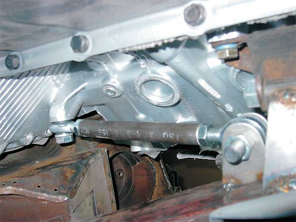

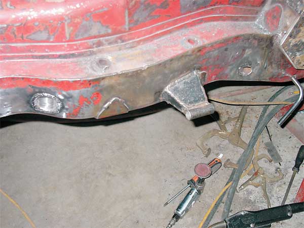

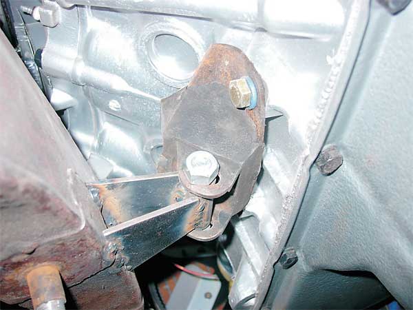

Motor mount (passenger side).

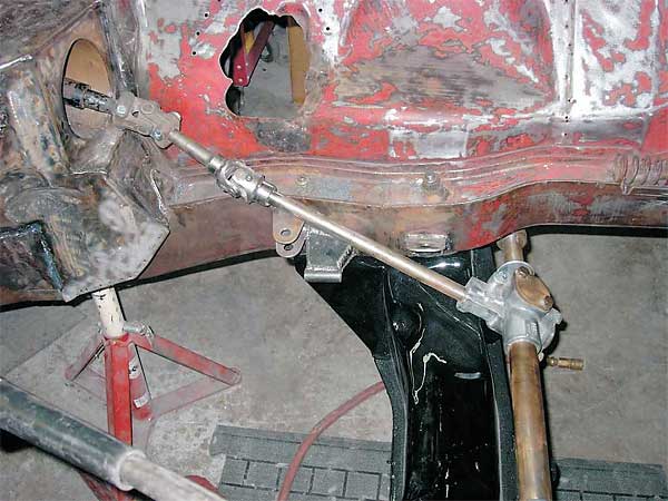

Steering.
Steering.
Motor mount (driver side).

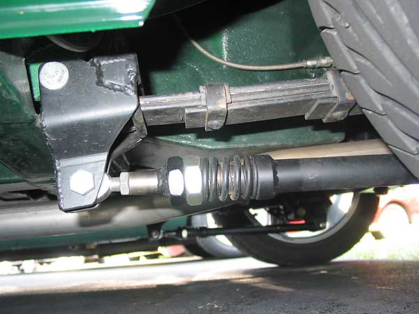

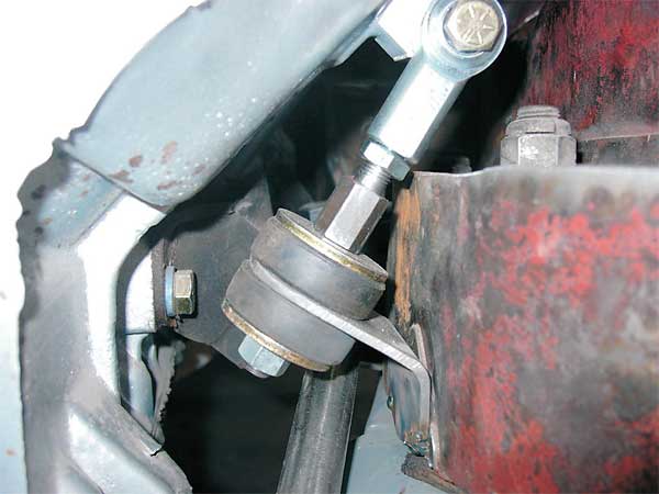

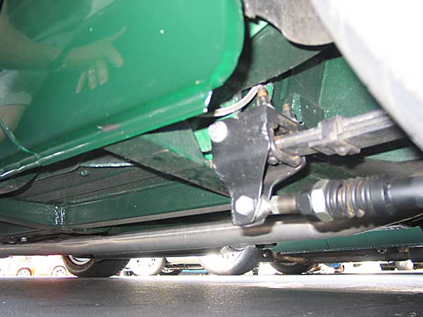

Torque rod.
Torque rod.
Lateral torque rod.
Lateral torque rod.

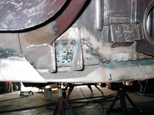

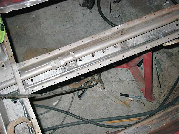

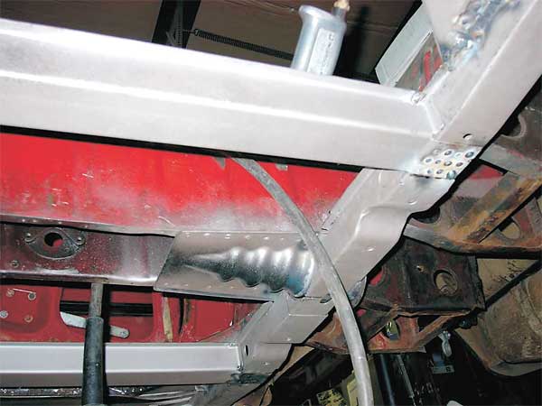

Floor reinforcements.
Spring perch reinforcement from above.
Spring perch reinforcement from below.

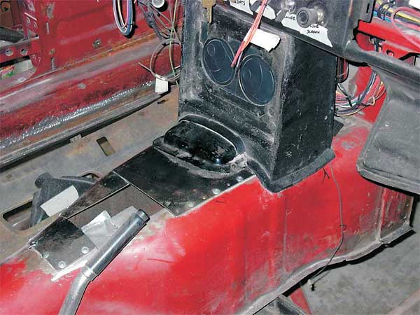

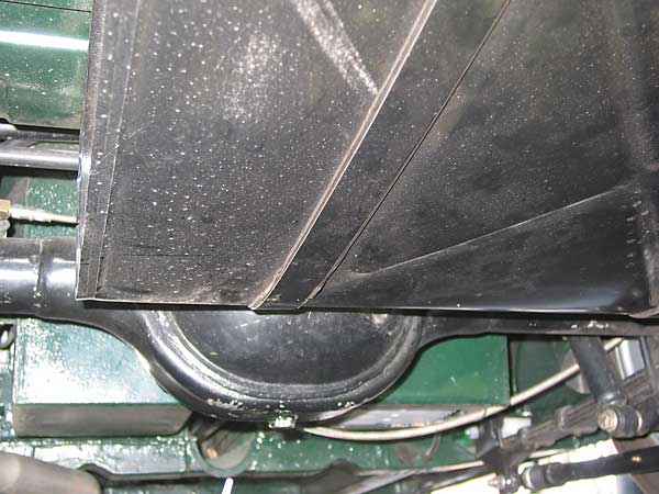

Transmission tunnel.
Completed firewall modifications.

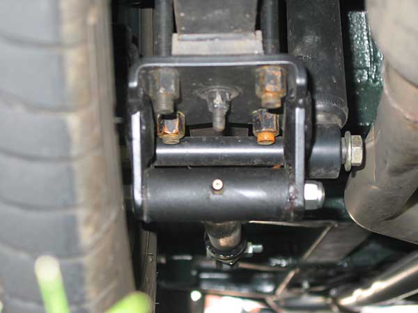

Rear Axle and Suspension
traction bars by Gary Nye of Nye Performance
telescoping traction bars

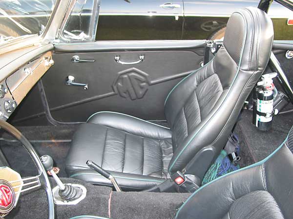

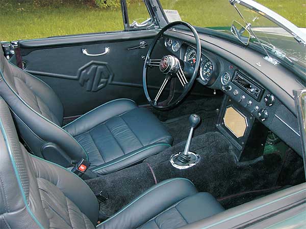

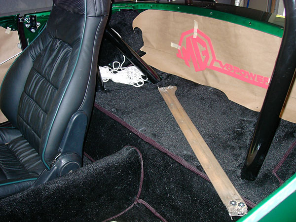

custom MGB interior
sculpted MGB door panels
rear deck trim

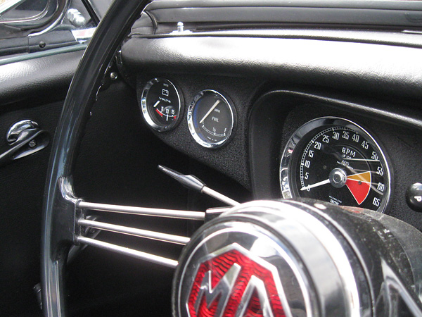

2010: voltmeter

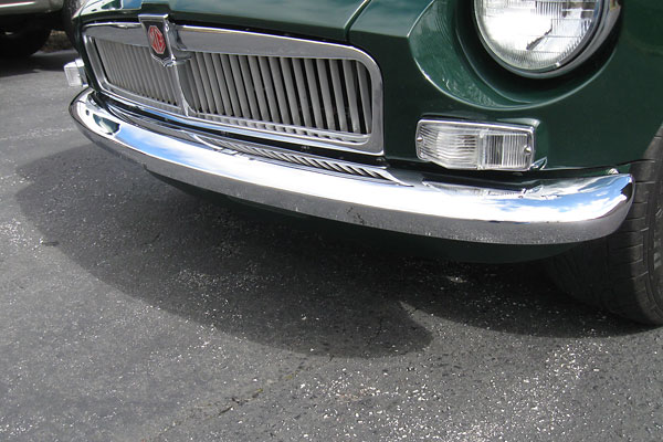

grille
mirror

MGB boot struts
Compomotive wheels

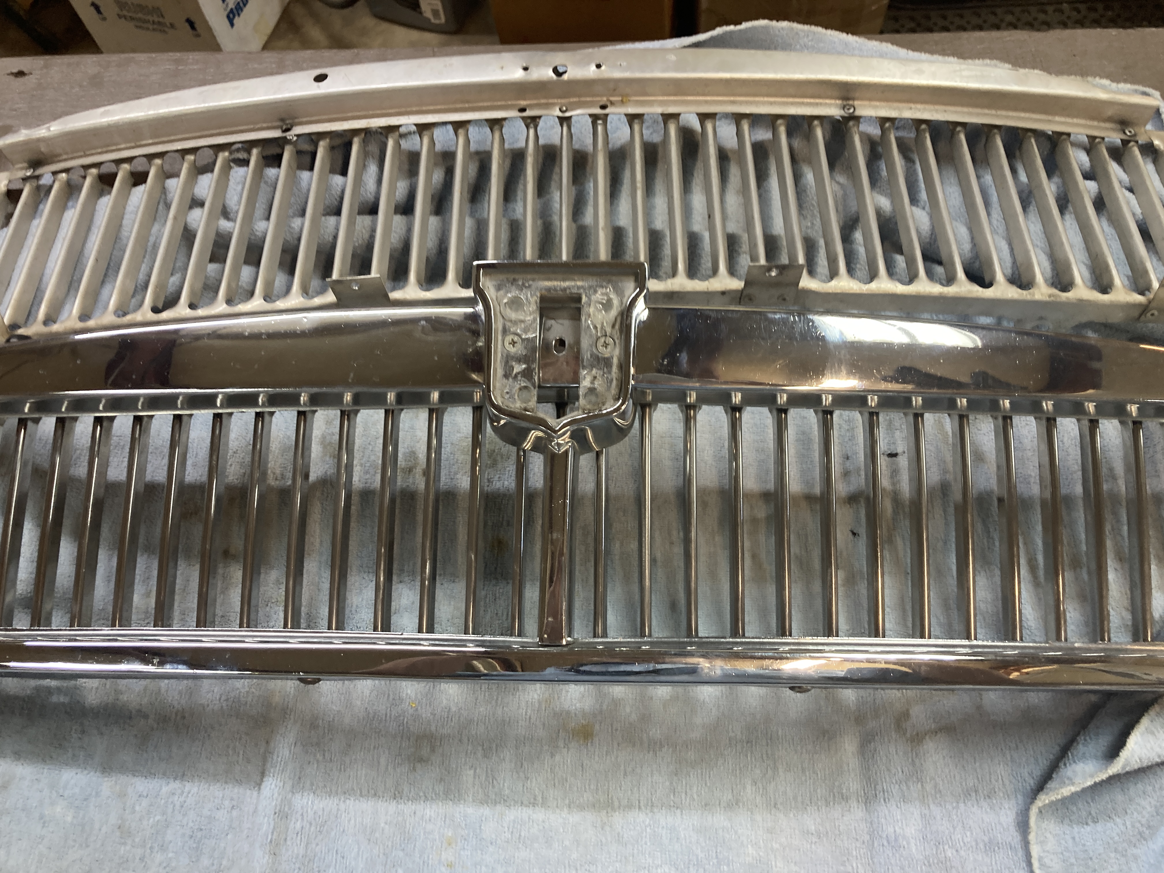

Early Grill Addition
grille

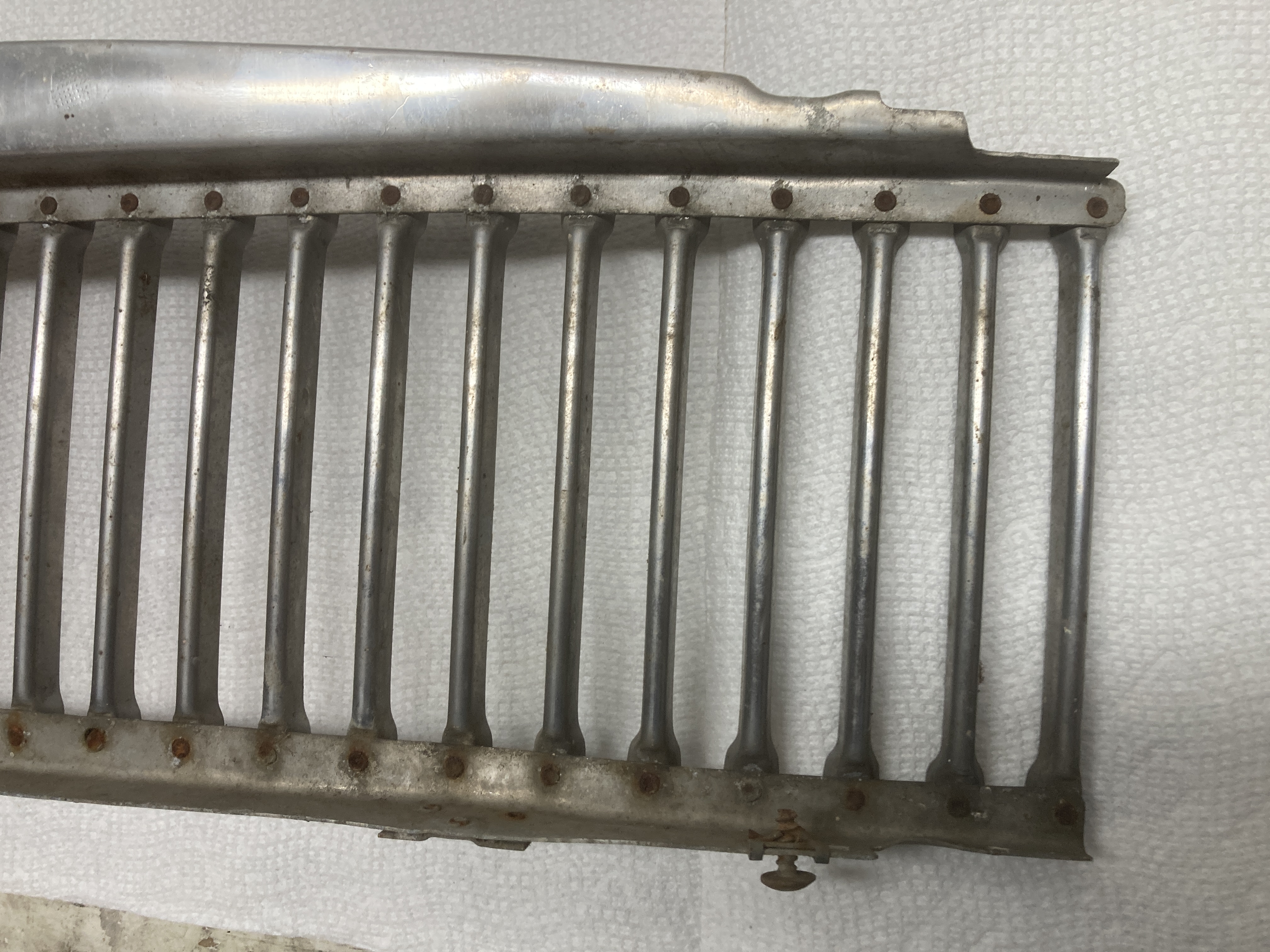

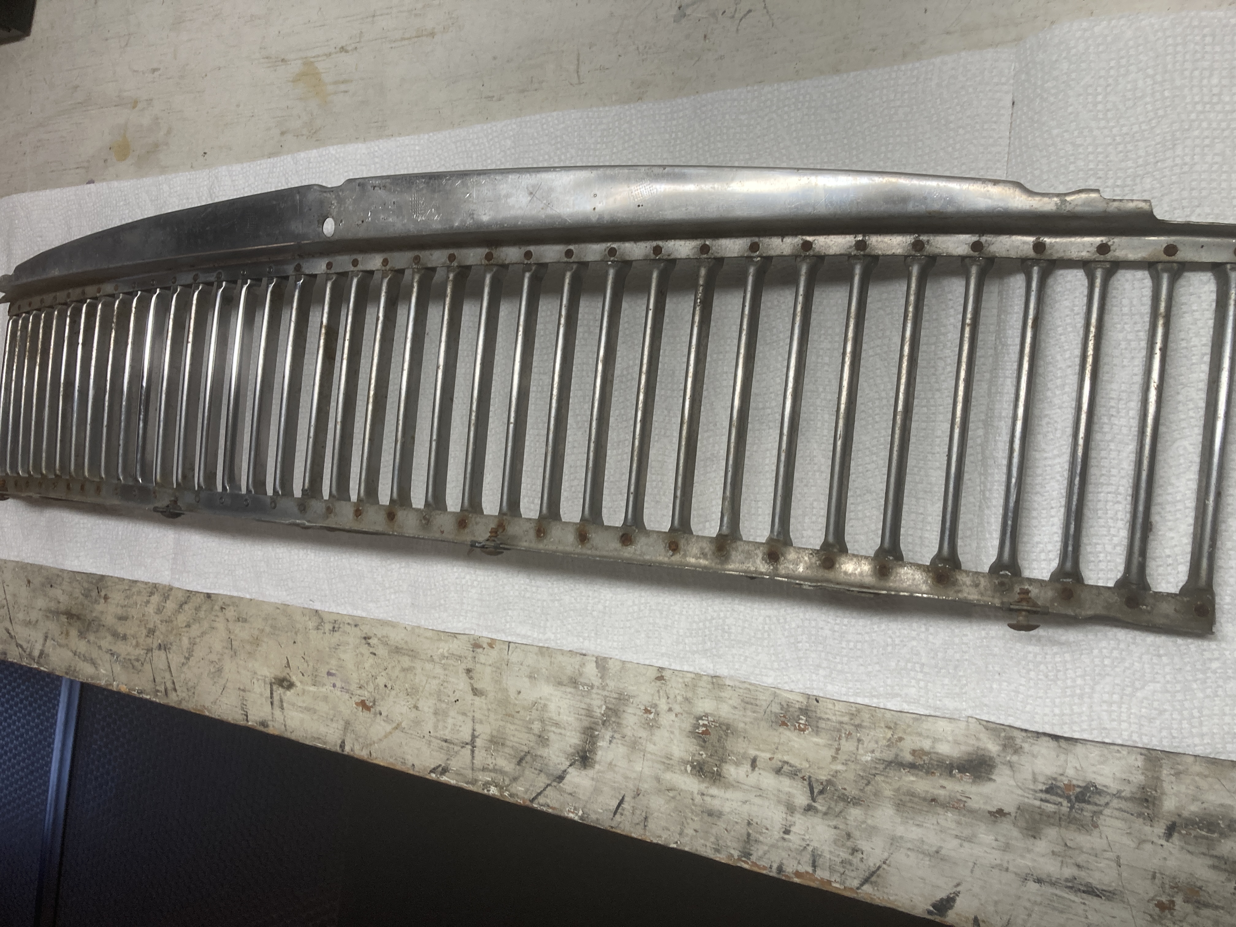

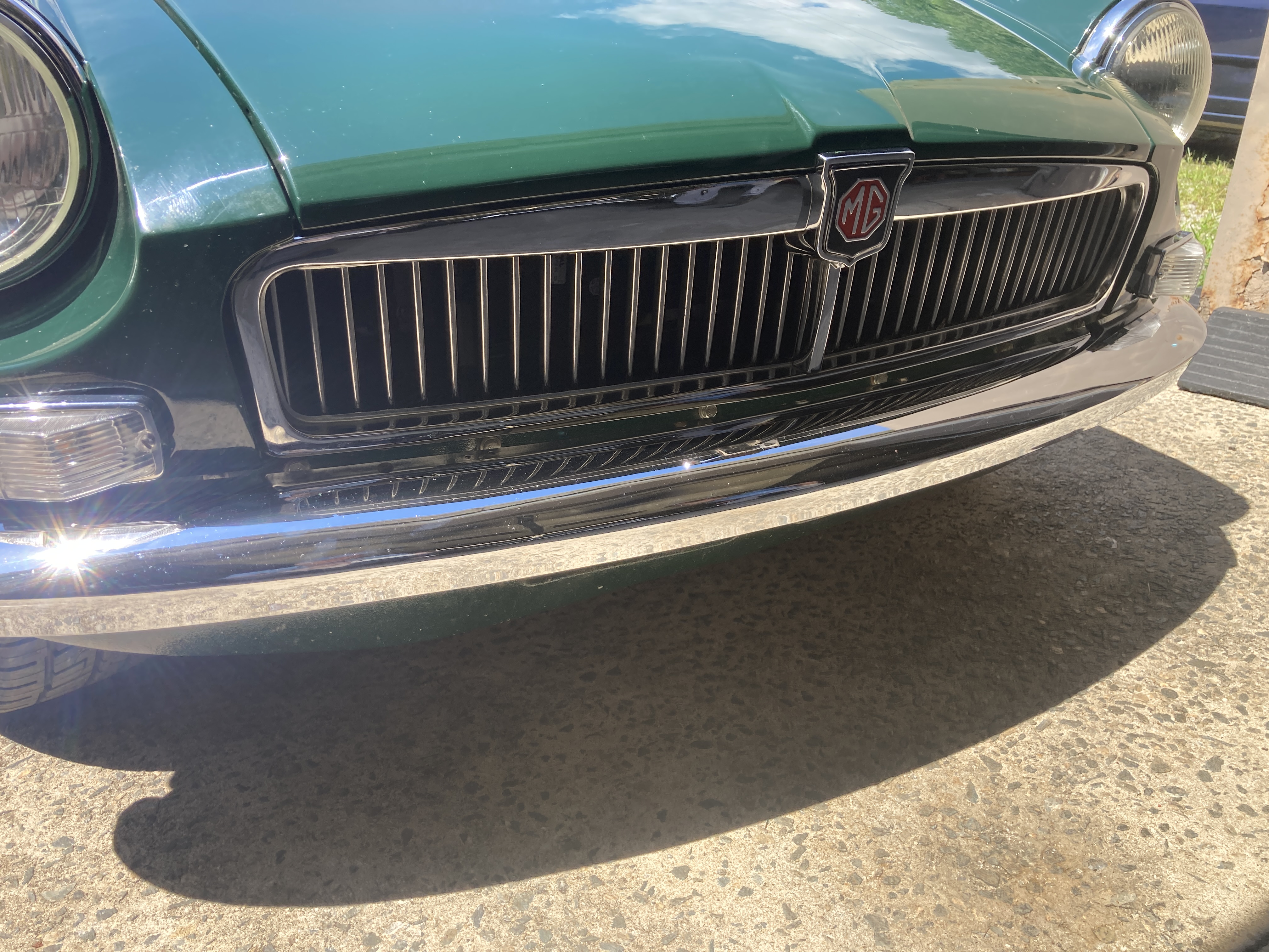

2025 Update: Just for fun, the stock 1965 stamped aluminum grill was replaced with an early stainless grill. Shown is the backside of the early SS grill insert (discontinued in 1964) as purchased on eBay. Note individual rivets in the slats.
mirror
Frontside of the early SS grill insert.
mirror
(Top) Unpolished stamped aluminum insert introduced in the fall of 1964. (Bottom) Polished early SS insert.
mirror
Polished early SS insert installed over original bumpers with shaved overrider bolts.

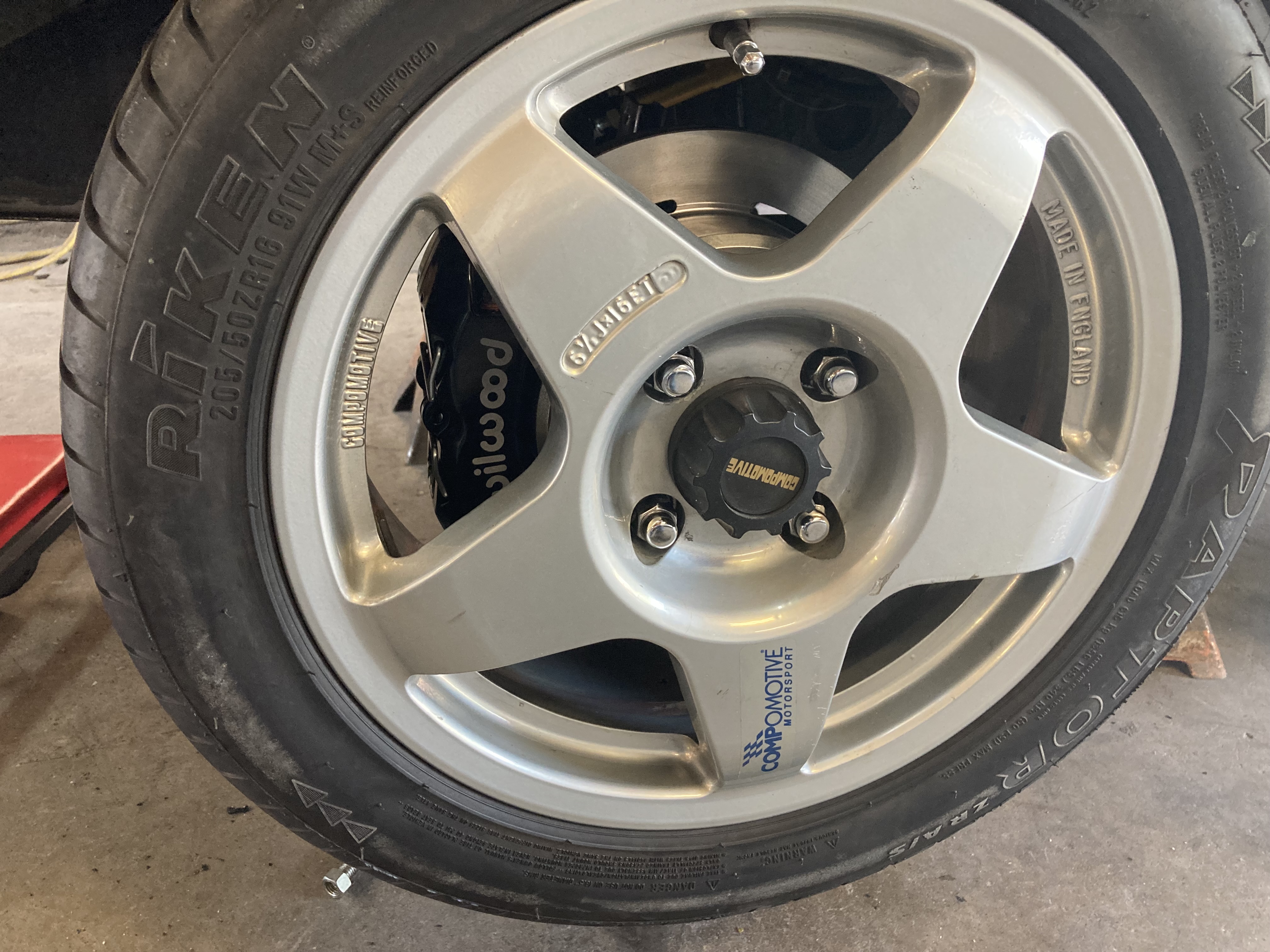

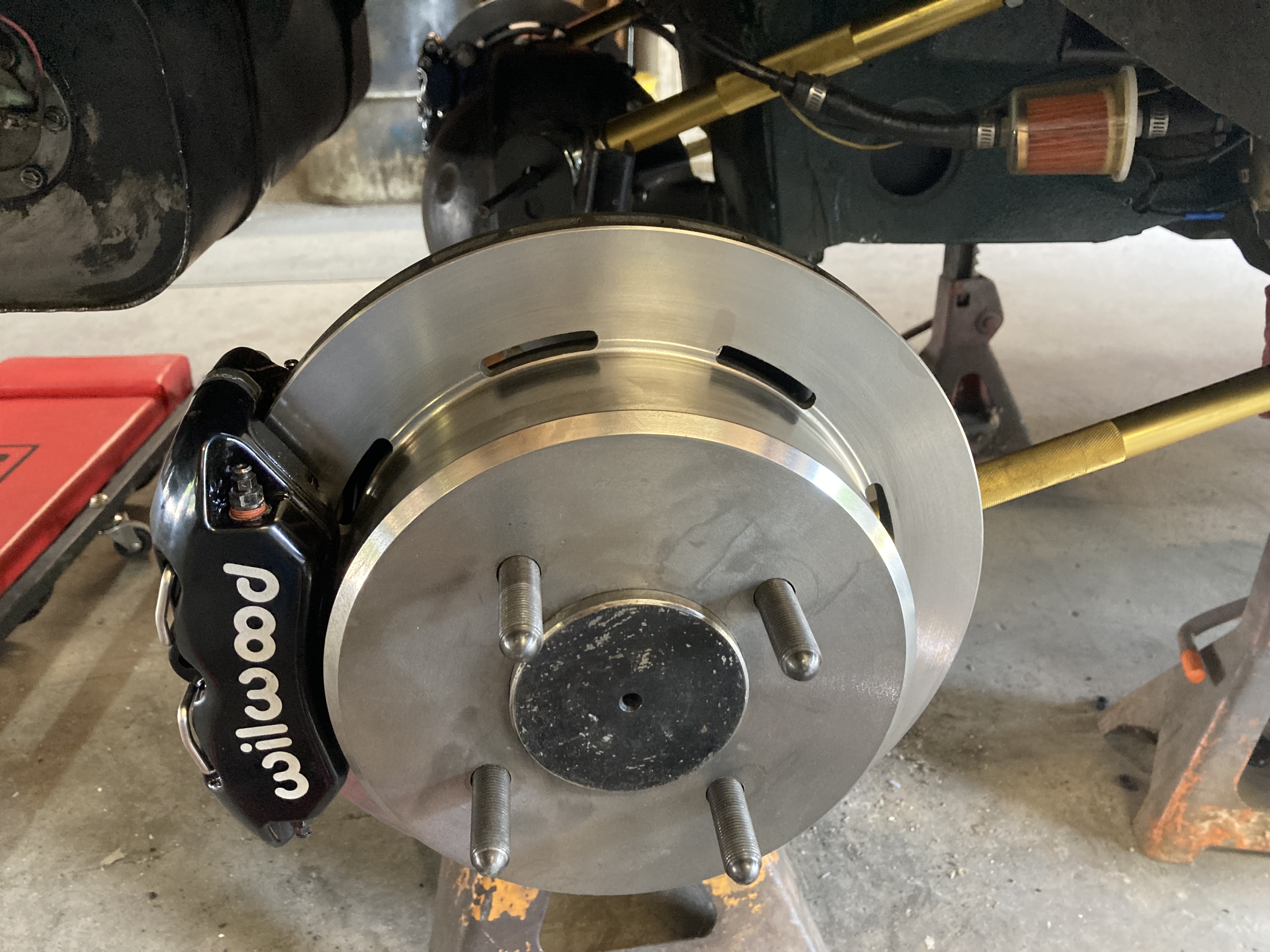

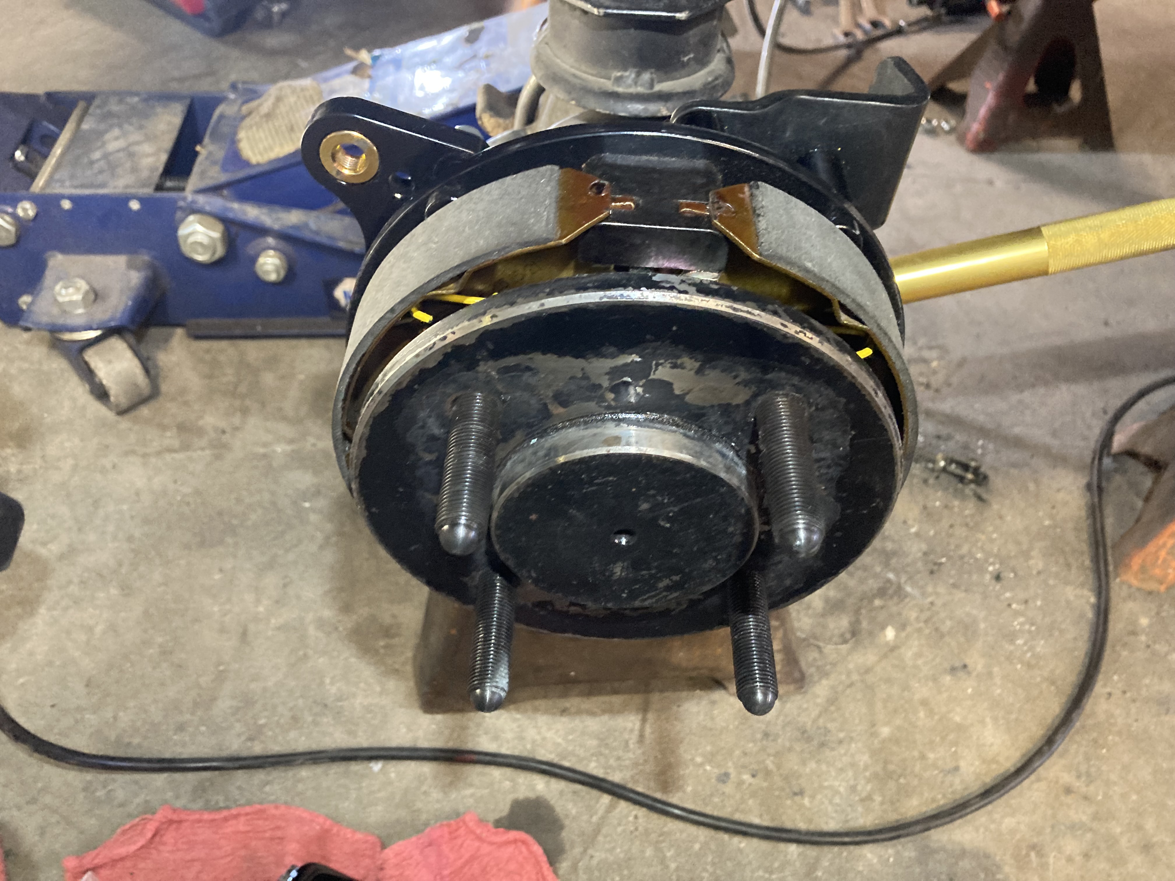

Rear Brake Upgrade
grille
2022 Update: Previous rear solid and drilled Wilwood rotors with a separate e-brake caliper were replaced with Wilwood drum e-brake kit p/n 140-11403 with 11" vented rotors.
mirror
New Wilwood rotor and DynaPro caliper installed on the Ford 8" axle. Also showing is Bill Guzman's 4-Link suspension installed at the same time in 2022.
mirror
Brakes as viewed through the 16" wheel.

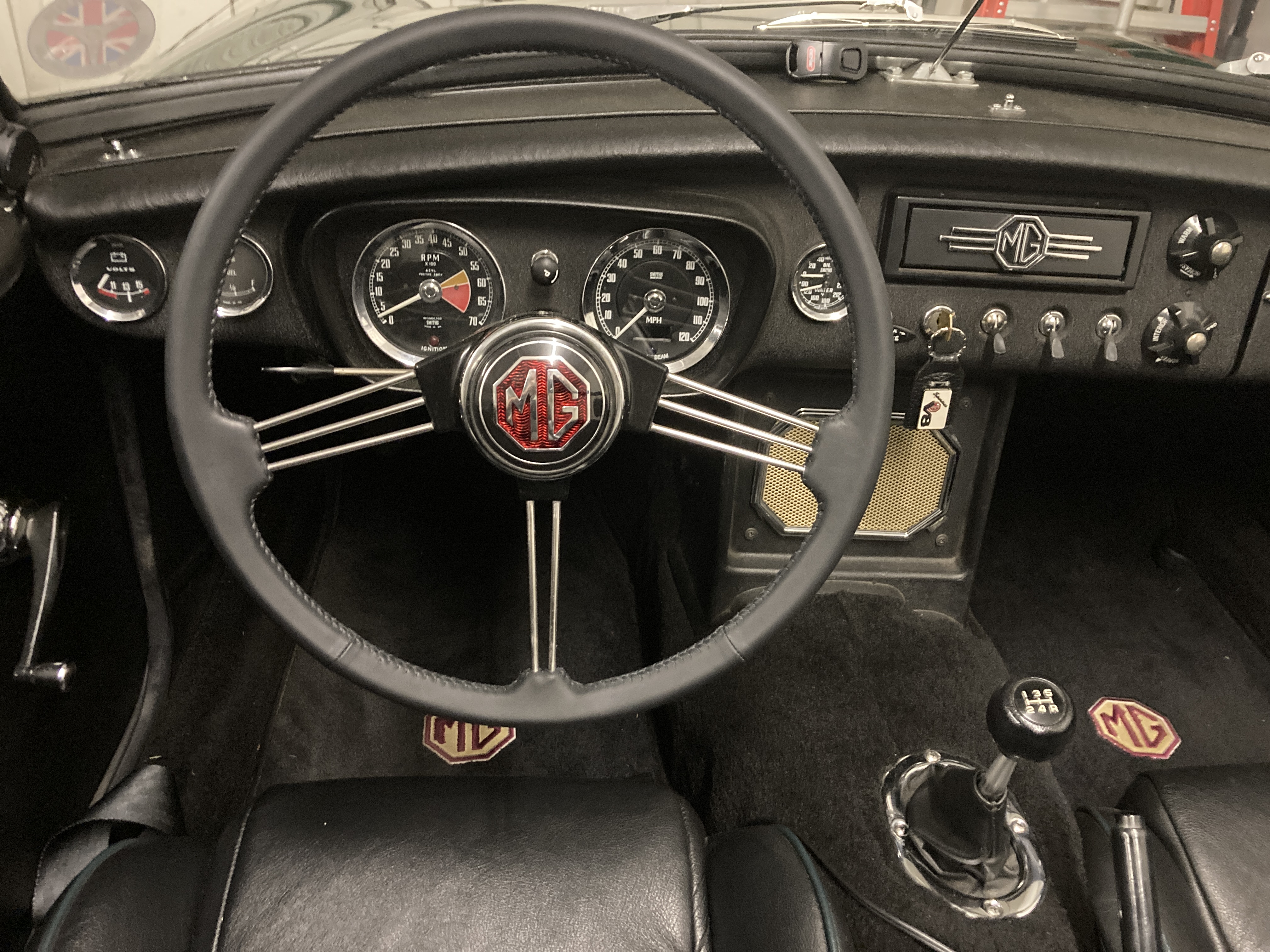

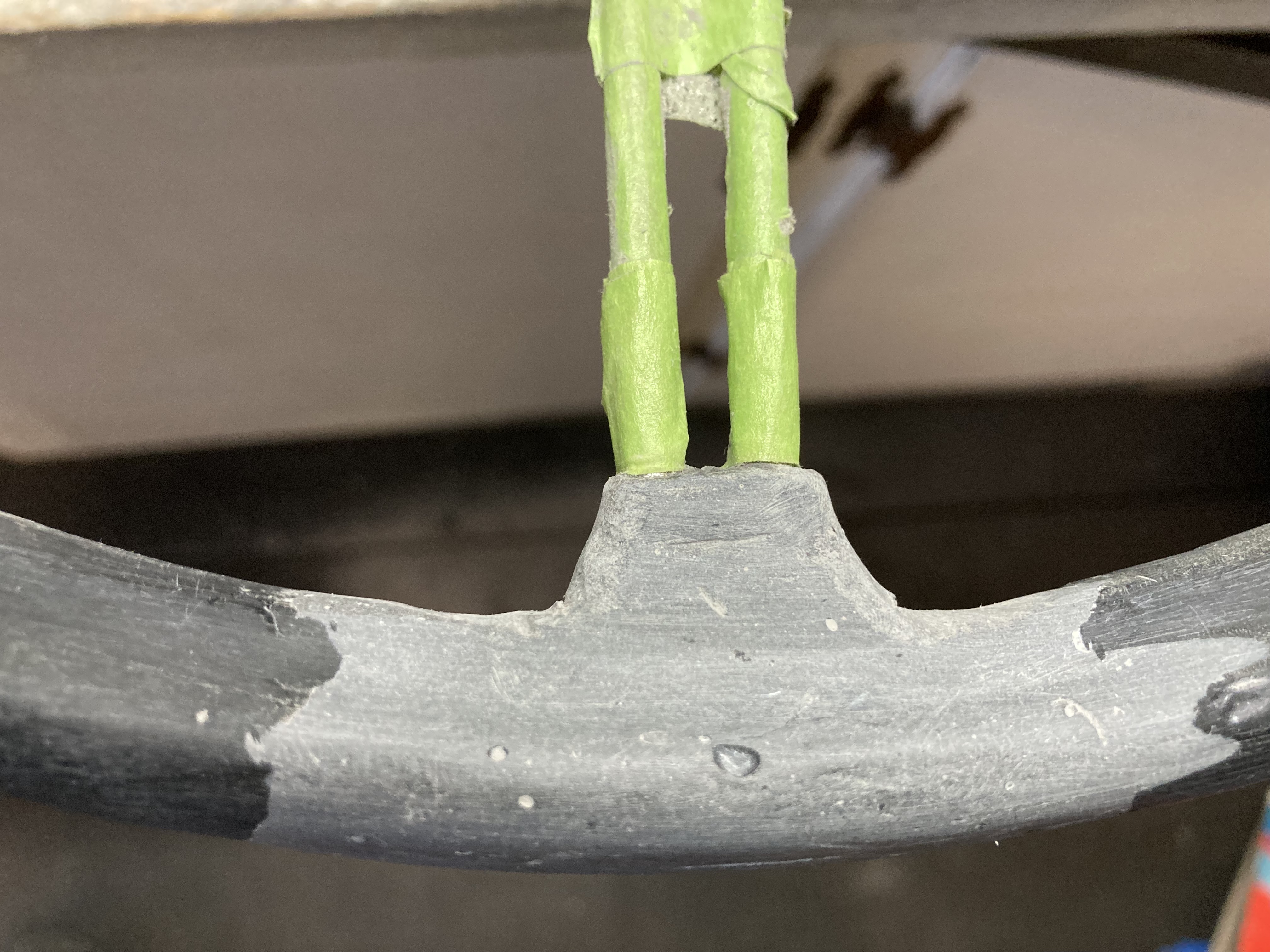

Steering Wheel Modification
grille

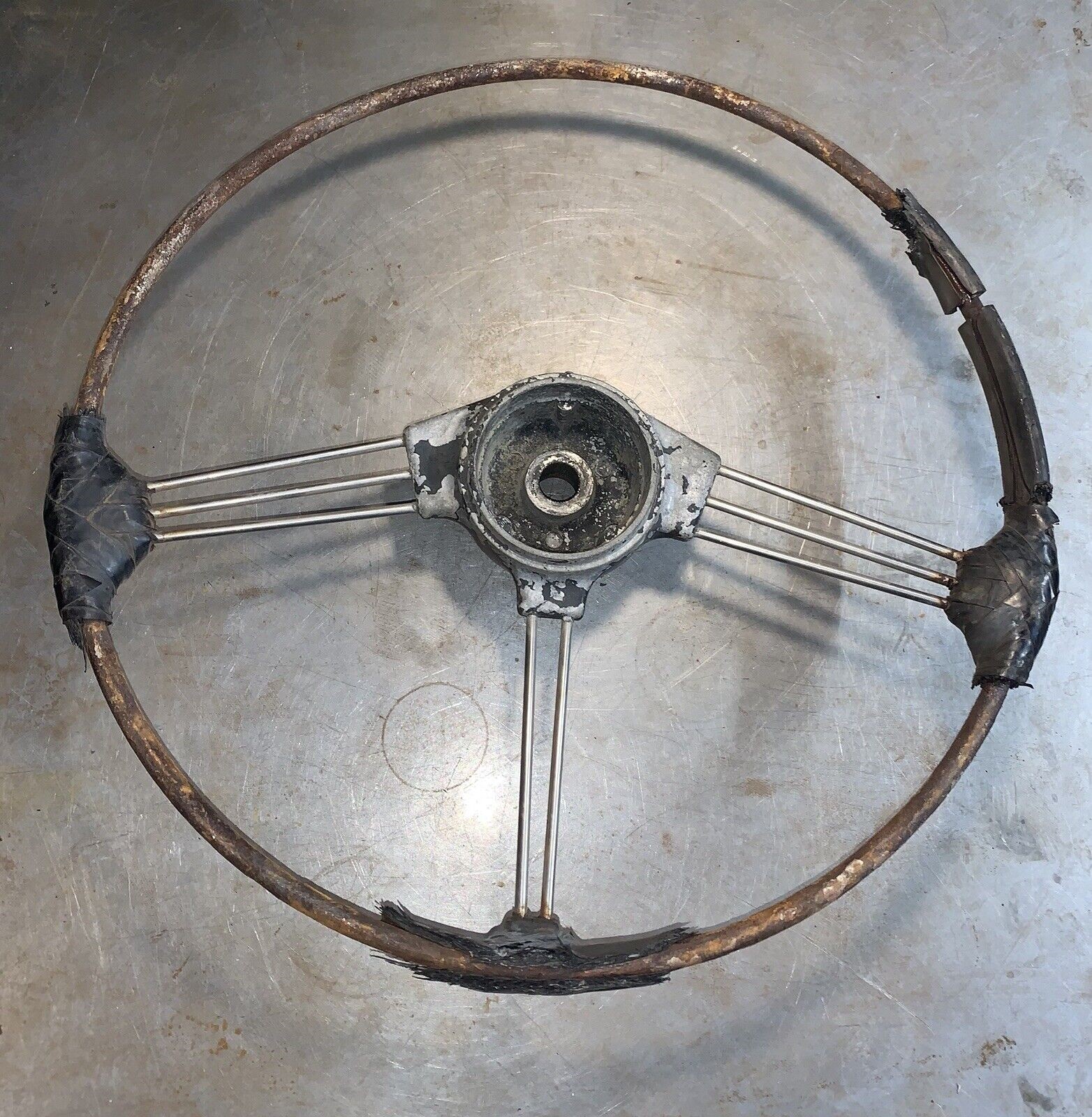

2023 Update: Banjo steering wheel restoration and downsizing from 16 ½" to 15 ½". A good Midget rim was welded to a good MGB hub and spokes. Photo is of the MGB wheel as purchased on eBay. The rim was discarded; all that was needed was a solid hub and spokes assembly.
mirror

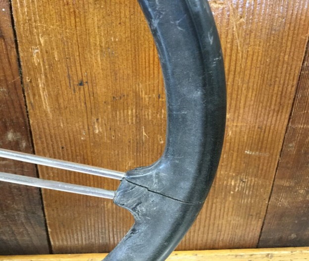

Midget wheel as purchased on eBay with bakelite crack at banjo spokes.
mirror

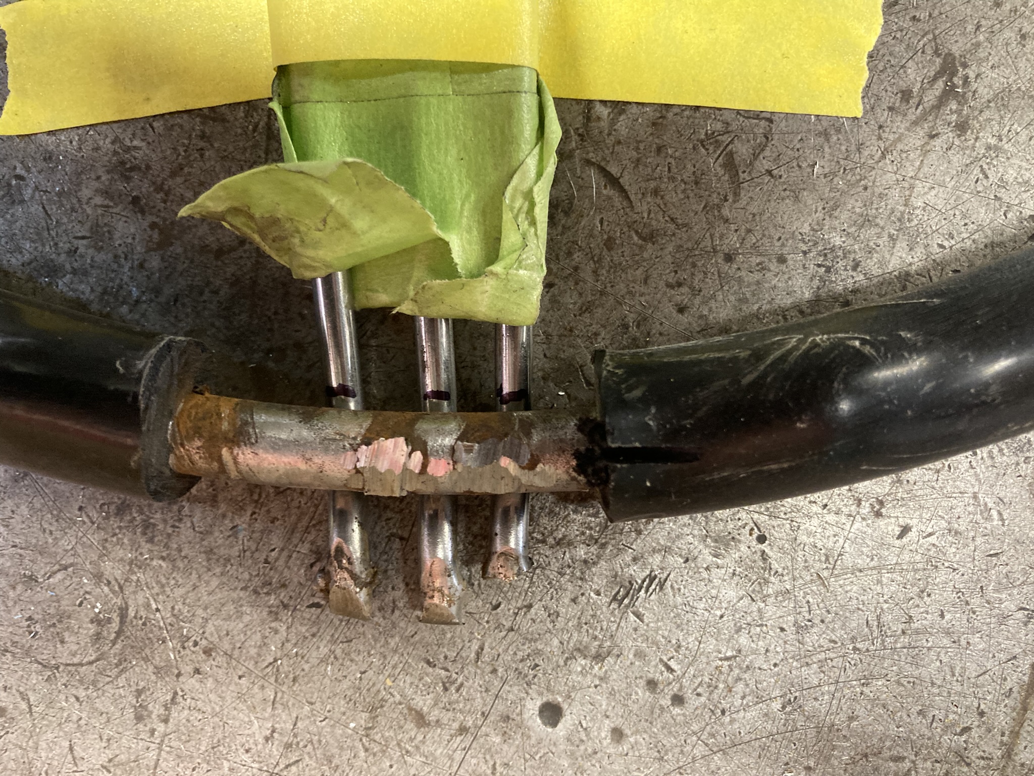

Photo reveals the original weak spot welds under the old brittle Bakelite.
mirror

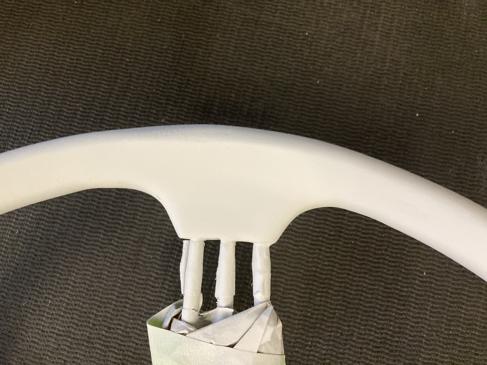

The MGB spokes prepared for cutting and butt weld to Midget rim.
mirror
The spokes have been welded and bakelite beveled in preparation for epoxy buildup.
mirror
PC7 epoxy after initial filing and sanding.
mirror
Eastwood 2k Primer Filler after more sanding.
mirror

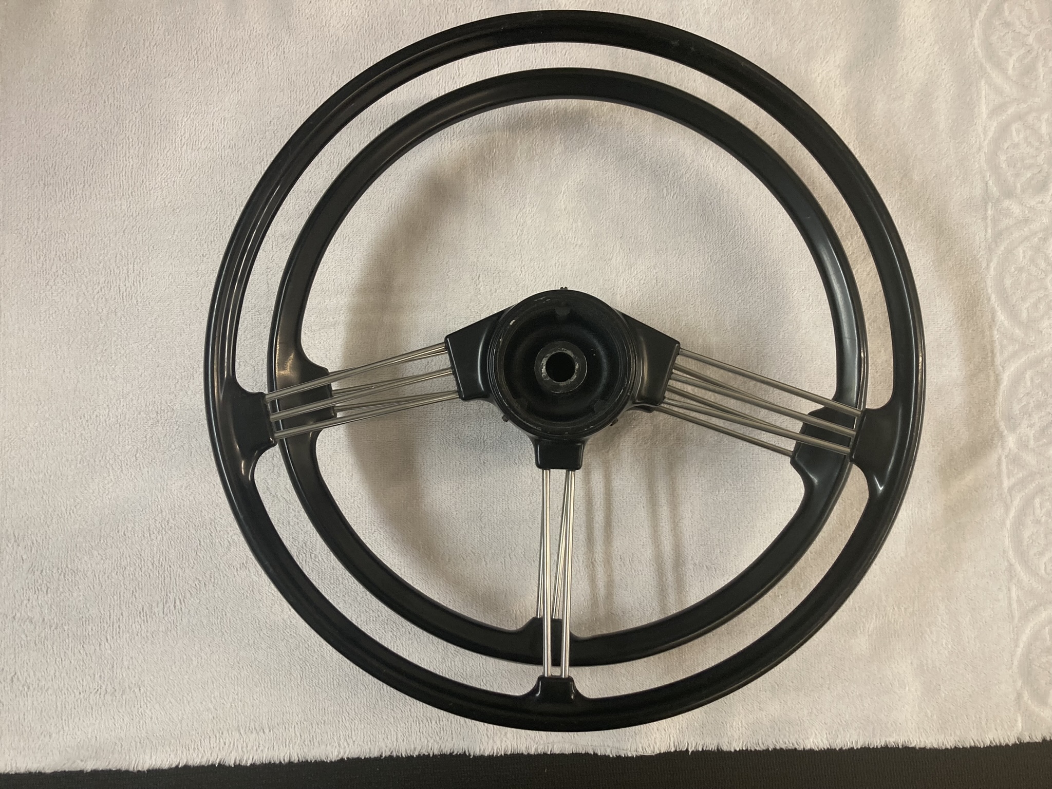

Comparing the original to the modified wheel after painting.
mirror
The new wheel, covered in leather by Craft Customs, installed in the car. To compensate for increased steering effort of the smaller wheel, a Moss 3o caster kit was also installed. Decreasing the caster from the original 7o did not affect straight tracking.

Lastly, I added a roll bar and bought more life insurance. All the folks we worked with were great. They all helped create ideas, rather than just selling time and materials.

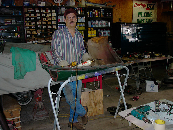

Robert at the car shop.
