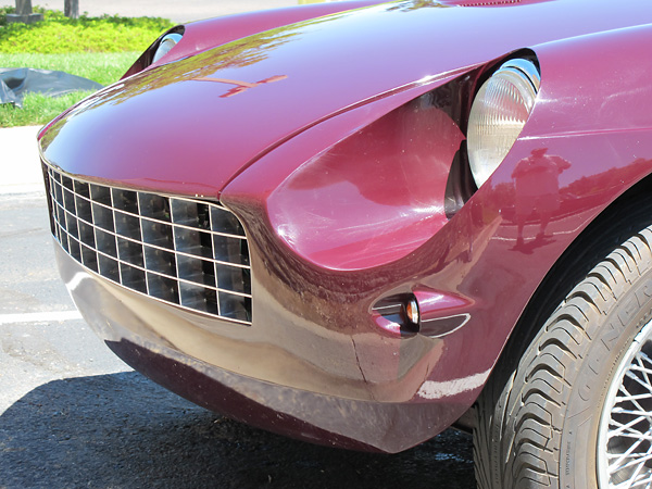

The design is influenced from studying hundreds of photos of early to mid 1960s Ferraris, particularly ones designed by Scaglietti and Farina. Having already stripped the MGB down to the unibody and placed on a rotisserie, I began to model possible changes with 2" thick foam insulation (purchased in 4X8 sheets). This material is cheap, lightweight, and easily rough formed with a course grinder and a surform "cheese grater". I modeled five or six rear ends before I got a shape I liked. Then, all I had to do was figure out how to replicate it in steel. No plastic parts!

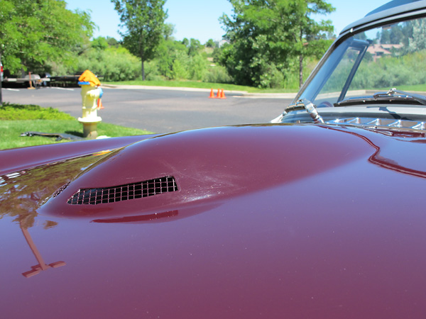

My hood scoop was inspired by the ones on early Ford Thunderbirds, but obviously completed without the little V-shaped chrome grille. I liked the shape, and my hood wouldn't close without it.
Then I began to play. I fitted side port fender vents from a Factory 5 Cobra kit. Stretched the nose about 1.5" in the middle and made the badge bulge go away. (I really wish I'd done much more here: think shark-nosed 1961 F1 Ferrari!) I reworked the front grille opening and built an "egg crate grille" from 6061 T6 aluminum. Specifically, I used a CNC water jet to get precise curves and clean cut edges. Front turn signal lamps were fabbed from exhaust pipe scraps, reverse-frenched into the fenders. I installed a flush fuel filler lid, shortened the boot lid, and wired an electric "popper" boot lid release. Rear lights were sourced from an early 1970s Opel Manta Rally.

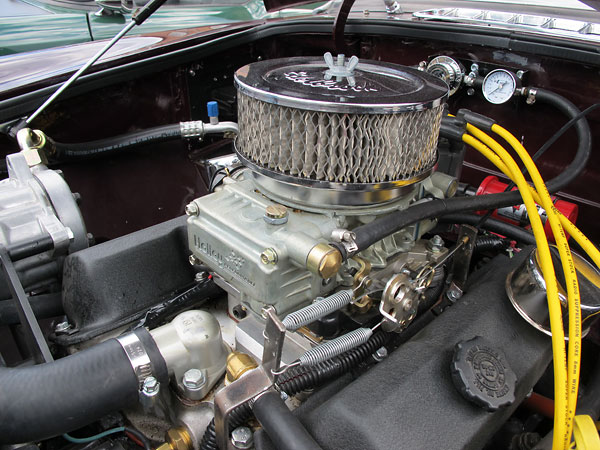

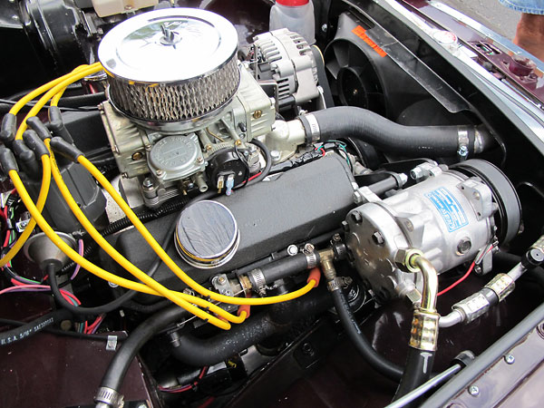

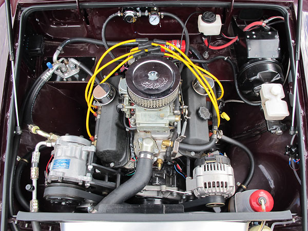

Engine: GM 3.4L 60-degree V6 engine, bored 0.030" over. ARI Phase II camshaft and lifter kit. Comp Cams Magnum roller rocker arms. Classic Conversions Engineering motor mounts. Edelbrock lower intake manifold. Classic Conversions Engineering upper intake manifold. Holley 390cfm carburetor. Mr Gasket fuel pressure regulator. Mr Gasket fuel pressure gage. Edelbrock air filter. MSD Blaster 2 ignition coil. Accel Hi-Temp 8mm spark plug wires. Classic Conversions Engineering accessory drive system.
Cooling: aluminum down-flow radiator. Volkswagen Scirocco dual electric fans mounted on plastic fan shroud. Oil cooler, with its own Spal electric fan.

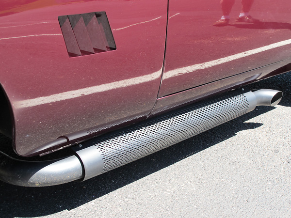

Exhaust: Classic Conversions Engineering headers. Dual side pipes with black ceramic coating over original chrome.

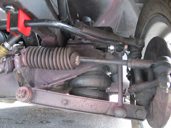

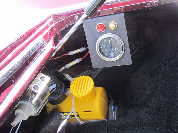

Front Susp.: Blackwood Engineering airbag suspension in lieu of springs. Red polyurethane bushings. SPAX CK 12 adjustable shock absorbers.

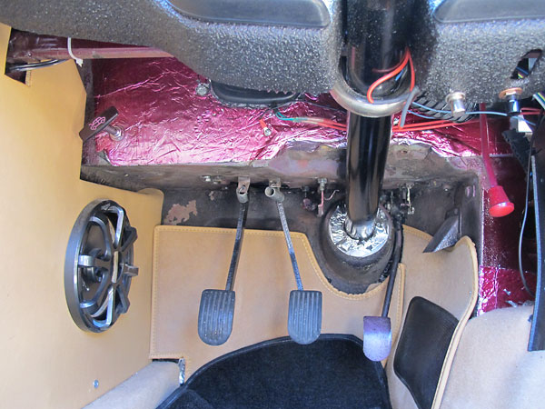

Brakes: late model MGB pedal assembly with power brake booster.

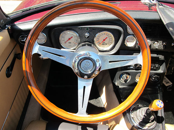

Instruments: (left to right) TPI Tech fuel level (E-F), tachometer (0-8000rpm), speedometer (0-140mph), oil pressure (0-100psi), water temperature (100-250F), analog clock, and voltmeter (10-16V).

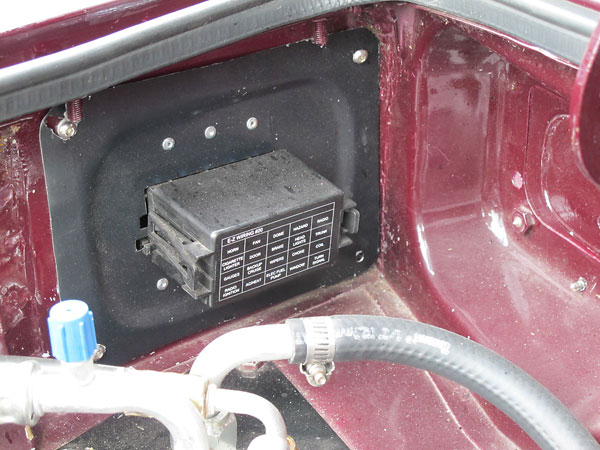

Electrical: Delphi alternator. Trunk mounted jump start studs. E-Z Wiring 20-fuse wire harness kit.

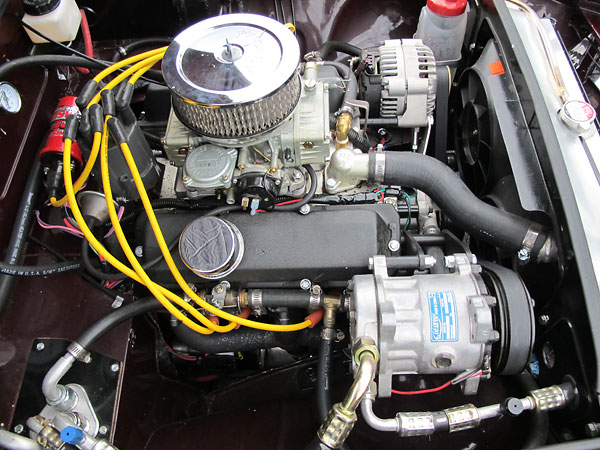

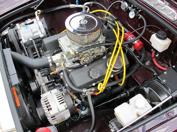

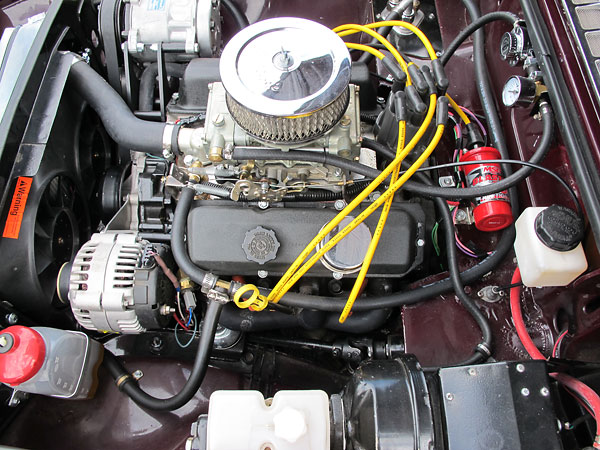

GM 3.4L 60-degree V6 engine.

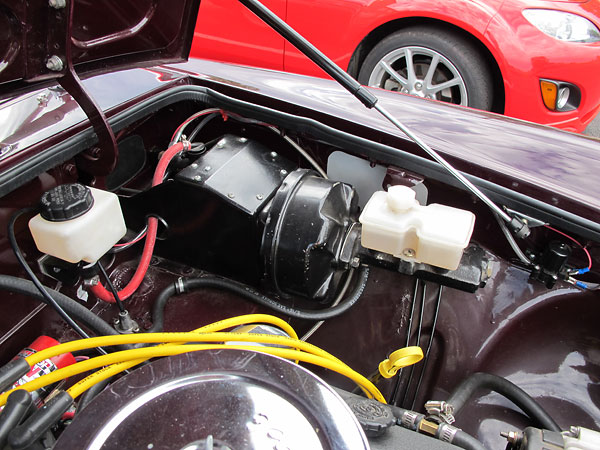

Late model MGB pedal assembly with power brake booster.

Holley 390cfm carburetor. Edelbrock air filter.

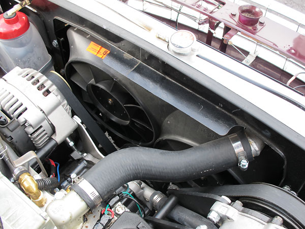

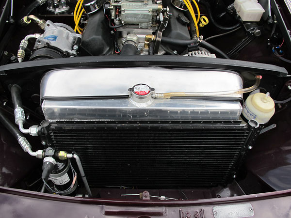

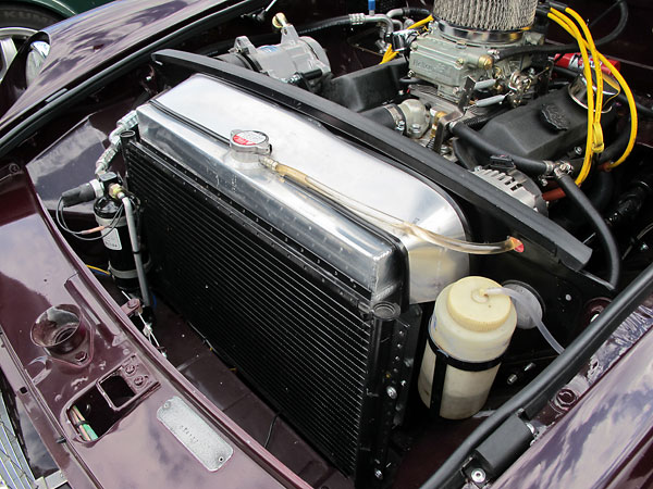

Aluminum down-flow radiator.
Air conditioning condenser and receiver/drier.

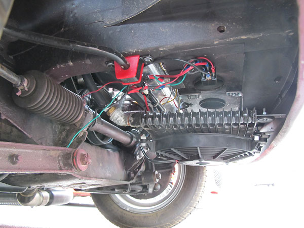

Dual electric fans mounted on plastic fan shroud.

Sanden air conditioning compressor.

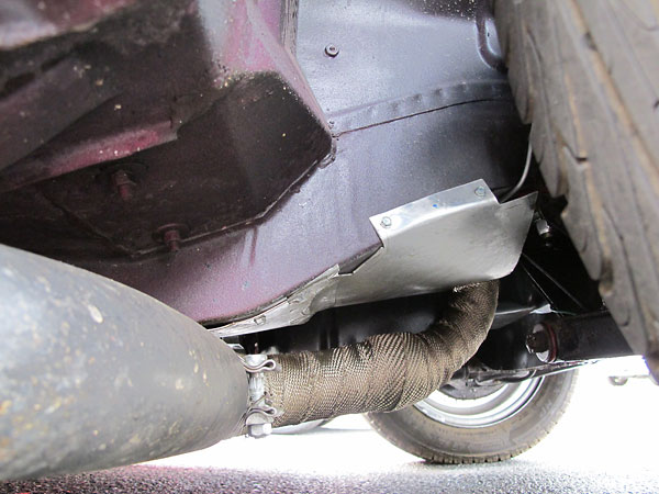

Header wrap.
Header wrap.

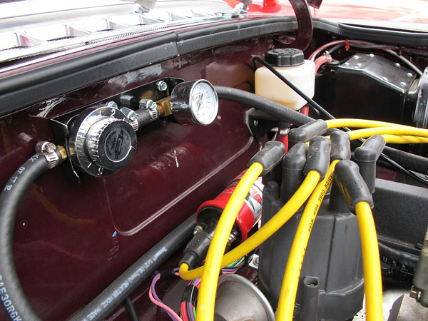

Mr Gasket fuel pressure regulator and fuel pressure gage.
E-Z Wiring 20-fuse fuse block.

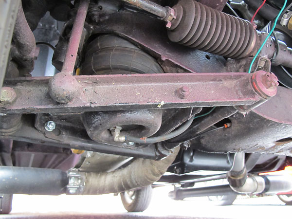

Blackwood Engineering airbag front suspension in lieu of springs.
Blackwood Engineering airbag suspension, in lieu of coil springs, to facilitate taller stance.
Air suspension is one way to address inadequate tire clearance.
"Cutting the original headlamp buckets out and fabricating deeper pockets for an XKE/Maserati/Ferrari
inspired look caused an unfortunate consequence: inadequate tire clearance! I didn't discover the
problem until after I took the bodyshell off the rotisserie. At that point, the only thing to do
was to crank up the ride height. If I had it to do over, I'd buy complete headlight bucket
assemblies off a Datsun 280ZX. Doing so would save so many hours and dollars."

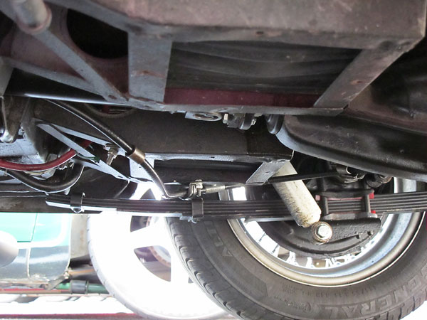

Telescoping shock absorbers. Red polyurethane bushes and pads.

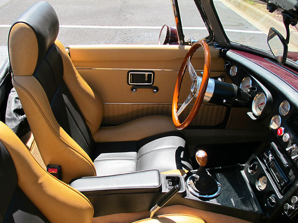

Pontiac Fiero seats with Mr Mikes brand upholstery.

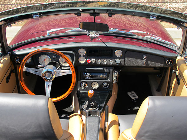

TPI Tech instruments.
Instruments, left to right: TPI Tech fuel level, tachometer, speedometer,
oil pressure, water temperature, analog clock, and voltmeter.

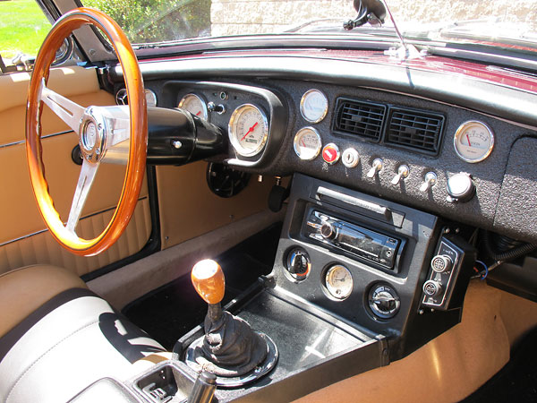

The center console is made from two to three different MGB styles...
"The center console is made from two to three different MGB styles: chopped, sectioned,
and glassed. I needed something to completely fill the space between dashboard and
transmission tunnel. By the way, when I replaced the pillow dash with the older all-steel
type, the cowling had to be extended about 1.5 inches in the middle and re-arced to fit.
Incidentally, it provides a bit more room for fat fingers under the dash/instruments."
Nardi steering wheel.
Pedal box appears essentially stock.

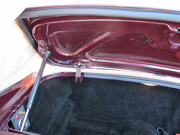

Inspired by Triumph TR-4, MGB boot lid cleverly sectioned and grafted back together.
Pneumatic pump for air bag front suspension.

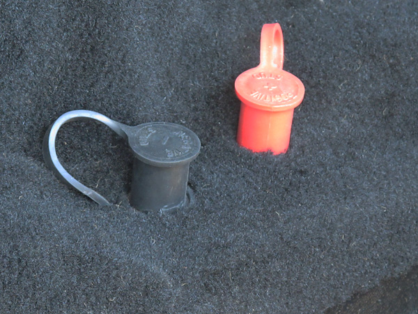

Jump start studs.
Jump start studs.

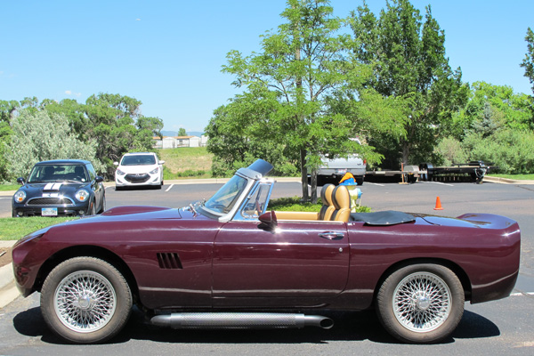

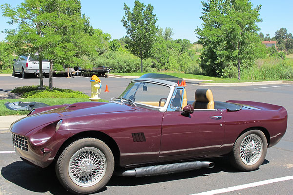

Influenced by early to mid 1960s designs by Scaglietti and Farina.
Completed just in time for the roadtrip to BritishV8 2014!

Nose stretched ~1.5 inches forward in the middle.
Nose stretched ~1.5" forward in the middle. Shaved badge bulge. Front turn signal

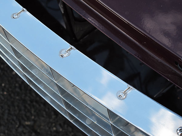

Egg crate grille fabricated from CNC water-jet cut 6061-T6 aluminum.
Ford Thunderbird inspired hood scoop.
"My hood scoop was inspired by the ones on early Ford Thunderbirds,
but obviously completed without the little V-shaped chrome grille."

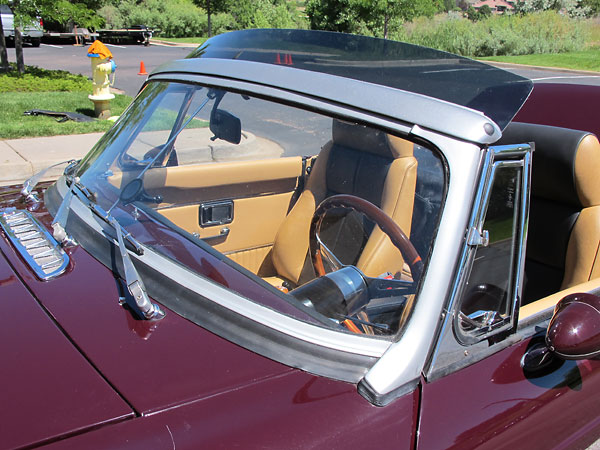

Mike Moor conceived this wind deflector, made from the header of an old convertible top.
Side port fender vents from a Factory Five Cobra kit.

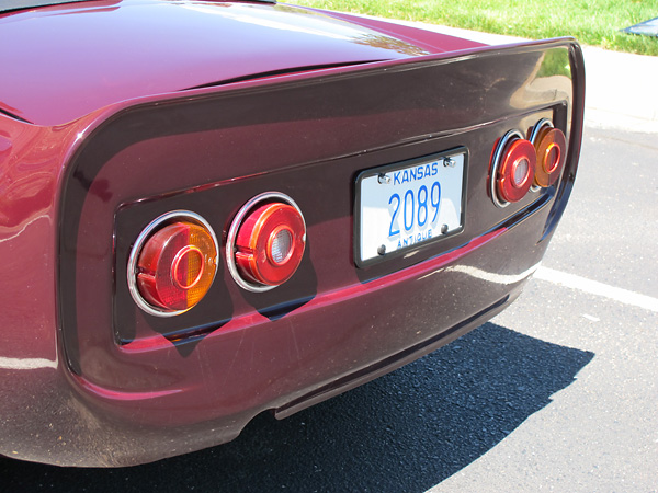

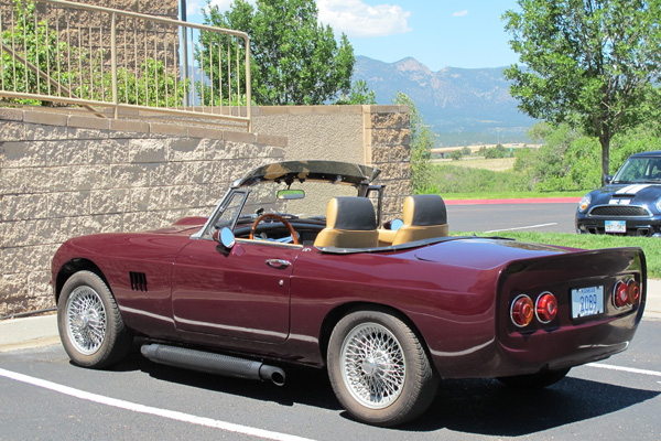

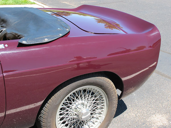

"I modeled five or six rear ends before I got a shape I liked."
Kammback rear styling treatment reflects Ferrari 250 GTO inspiration.

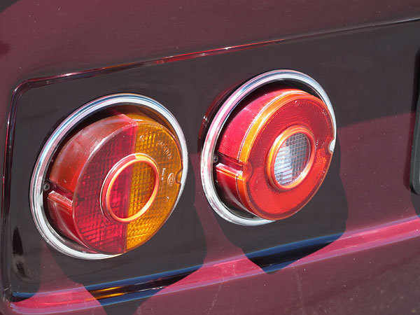

Opel Manta Rallye taillamps.

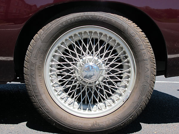

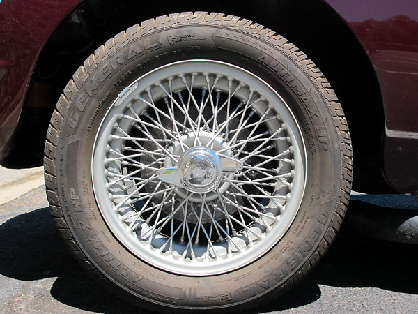

Dunlop 15 inch wire spoke wheels.
Dunlop 15" wire spoke wheels.
General Altimax HP P185/65R15 tires.
