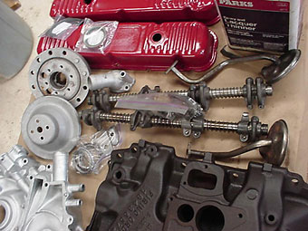

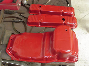

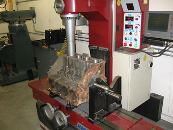

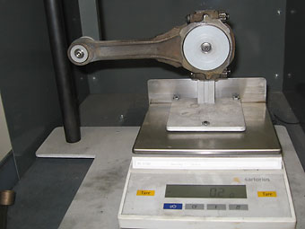

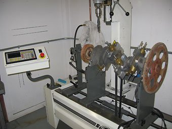

The Roadmaster is being readied for its visit to British V8 2008. Engine machine work and reassembly is largely completed, although we find that the oil pan and valve covers have received some damage. (If anyone has some chrome or alloy covers - or a set that is straight enough for powder coating - we could really use them!)

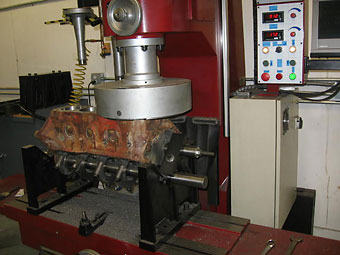

boring the big block buick   milling the decks on the big block buick
balancing the crank of the big block buick   balancing connecting rods

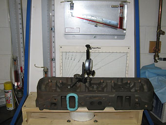

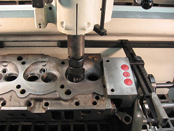

big block buick heads getting a valve job   a big block buick head on the flow bench
parts laid out for assembly   newly painted valve covers and big block buick oil pan

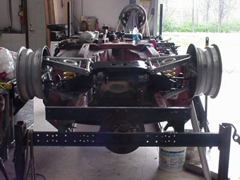

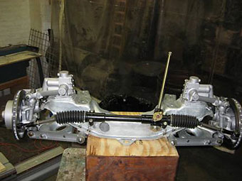

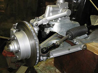

Early on in the process we were planning to use MGB hubs and were going to retain the MGB's original 4-lug wheel pattern. Generous support was given and promised for that combination: Bill Guzman pledged front and rear disc brake conversions and Jim Stuart donated a set of alloy wheels. Dan Masters donated a Jaguar independent rear suspension. When a complete modified MGB (Cobra kit car) front suspension was donated by Arthur Mitchell, plans for the wheel lug pattern were adjusted to accommodate its bolt pattern. We still enjoy Bill Guzman's support and are sure that if other items are needed that he could supply, he'll be there to fill the need.

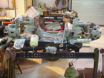

lots of Cobra kit cars used modified MGB front suspensions, like this one   inspection of the Cobra kit car MGB front suspension

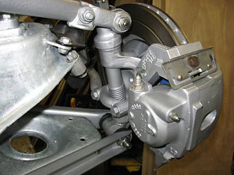

big vented rotors   great big calipers too

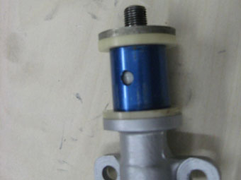

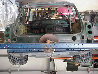

these aren't the control arm bushings we're used to seeing!   it's easier to do suspension work when the cars on a rotisserie
Getting the suspension fully installed and sorted out is a particular priority because the Roadmaster must roll on and off a trailer so it can be transported to this July's British V8 Meet in Wisconsin.

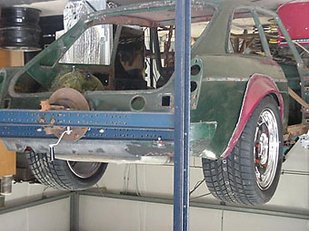

The Roadmaster is and will be the product of a large number of British V8 enthusiasts from around the world. Probably no single topic has received more input than tire and wheel size - and on the related implications for fender flares and rear suspension design.
just how large a tire can you install on an MGB?   you can go even larger if you flare the fenders...

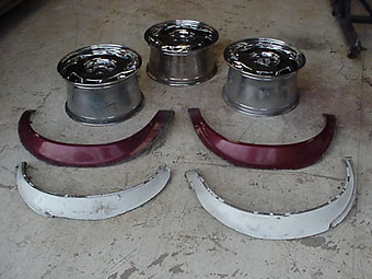

these are Dodge Omni flares and Corvette wheels   here's a mock-up to show what the Omni flares will look like installed

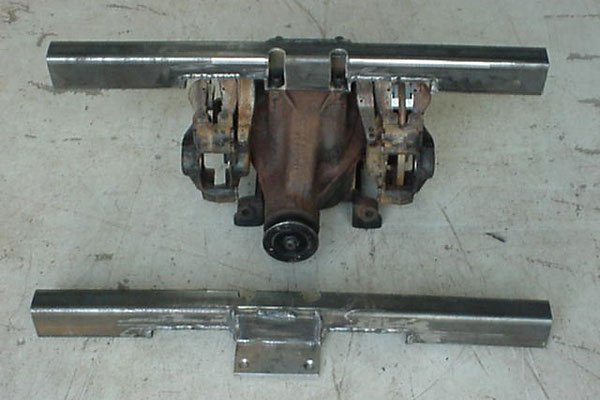

a carrier fabricated for the Jaguar IRS
