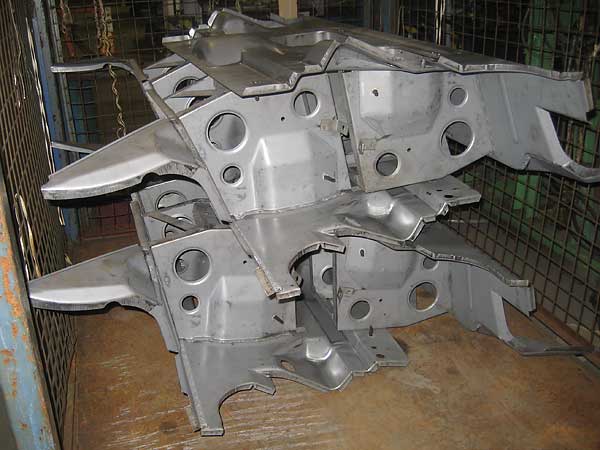

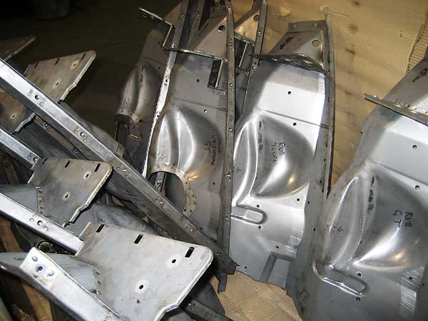

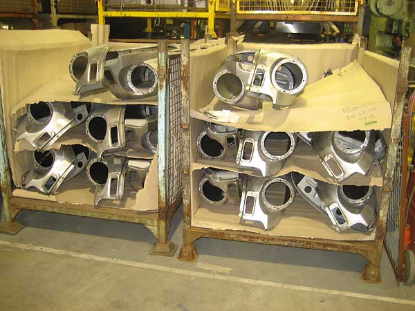

Notice that some of these Heritage MGB front inner wing assemblies have reinforced cut-outs for RV8-style headers!
MGB inner wing assemblies.
Notice that the ones in the center have reinforced cut-outs for RV8-style headers!
They also appear to have the additional bracket for the MGB GT V8 remote oil filter.

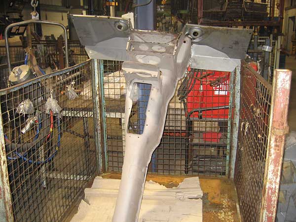

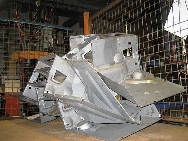

Firewall sub-assemblies.

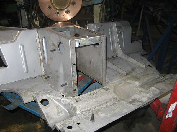

early three-synchro transmission tunnel that's been prepared for re-use.
This is a used, early model "three-synchro" transmission tunnel that's been prepared for re-use.
This is one of very, very few parts for which original tooling no longer exists.

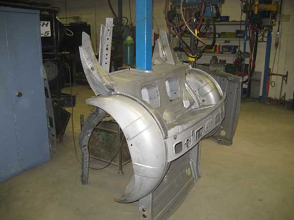

Here the trunk floor (HZA535) and wheel arch panels (inner and outer) have been added.

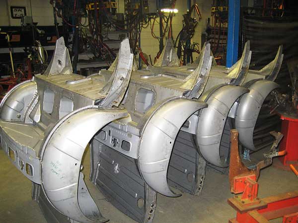

MGB (roadster) rear sections.

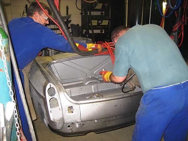

Spot welding the rear body panels together.
Spot Welding the rear body panels together.
Beginning in March 1967, all MGB's were fitted with back-up lamps at the rear of the car. To accomodate this decision, the original tooling was permanently modified to punch holes for the lamps - and all Heritage bodyshells come with lamp holes. They can, of course, be blanked-off if the earlier-style appearance is desired.
All "chrome bumper" MGB's were finished with lead-filling over the seams between the rear wing assemblies (a.k.a. "rear fenders") and the rear valance panel. The later "rubber bumper" cars which started production in 1974 didn't have lead-filling here. The seam was relocated about two inches outboard, and left visible. On the right-hand-side, this design change moved the seam from under the fuel filler grommet to outboard of the grommet. The rear valance panel was made wider and the inner wings were made narrower. Because the original tooling was permanently modified to accomodate this change, all rear wing assemblies and rear valances on Heritage bodyshells incorporate this later design. The joint can, of course, be filled if the earlier-style appearance is desired.

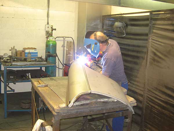

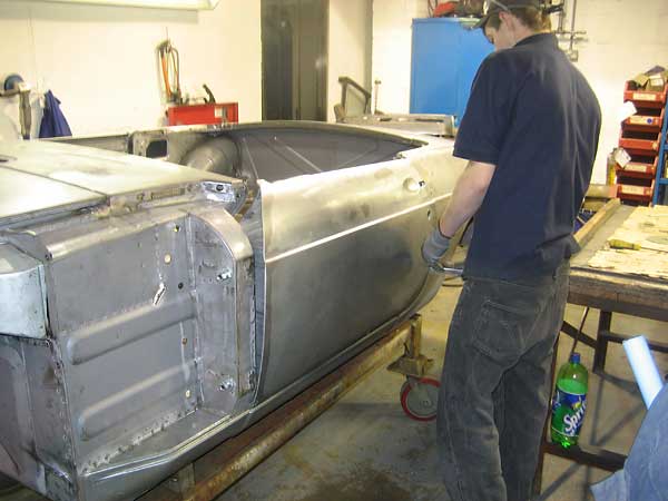

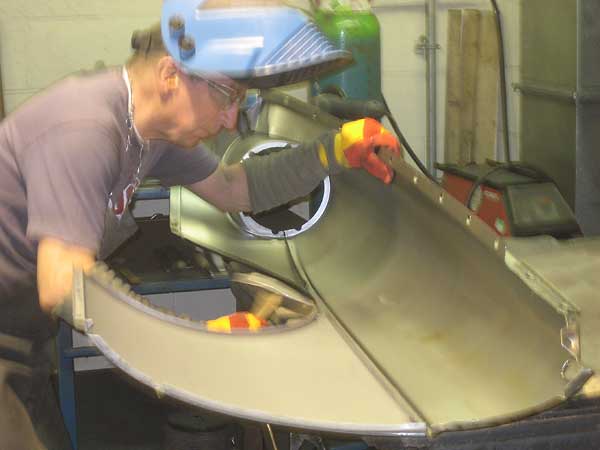

Welding a front wing assembly. (The front wings are assembled from ten parts.)
A little finesse (with a hammer, for example) is required to get the front wing just right.
A little "finesse" (with a hammer, for example) is required to get the front wing just right.
MGB front wings.
MGB front wings.

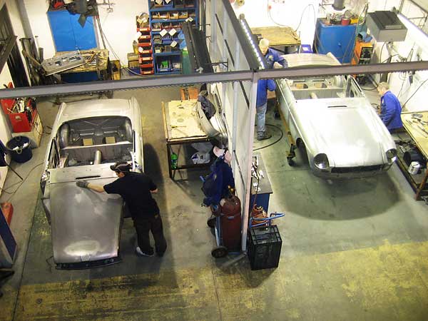

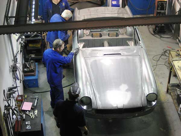

Fitting the bonnet and front fenders.
Panel gaps get adjusted until they're just right.
Fine tuning and rectification.
