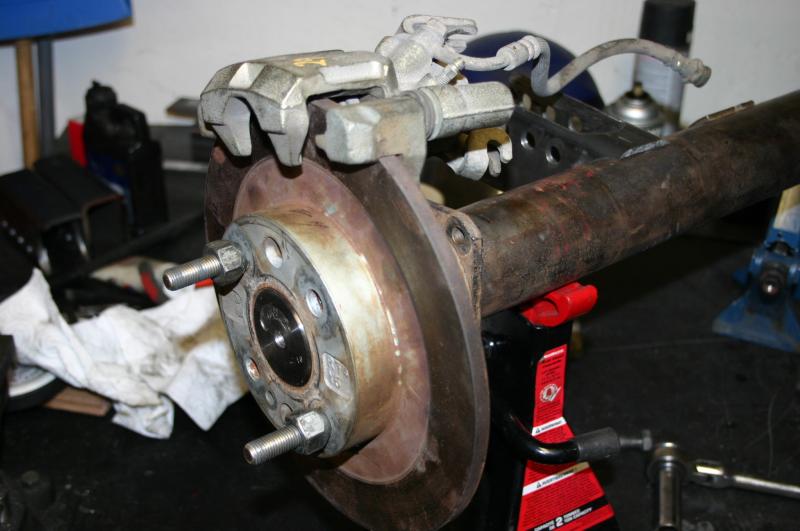

Doug, you are shortening an 8.8 already I take it? Youll have to order custom axles anyway.....I had my 8.8 shortened and bought moser custom axles and I am using nissan 240sx rotors which have the same bolt pattern as the mgb.

So the jist of it is to find a Nissan 240 X and get the rear disk brakes off of it?
mgb260
Doug, Standard 95-04 Mustang V6 rotors and calipers are the easy way.
Keith
FYI, I put Miata rotors and calipers on my GM rear. It was quite simple. Mosler supplied axles with the appropriate ends on them for me and I just welded a bracket on to the axle tube in place of the factory one. I can't imagine the Ford version would be any more difficult.
