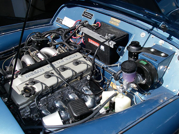

Engine: Nissan 240SX 2.4L, DOHC. Stock Nissan 240SX fuel injection. Stock camshafts and valvetrain. Reversed oil pan and re-routed oil pick-up.
Cooling: Summit Racing radiator.

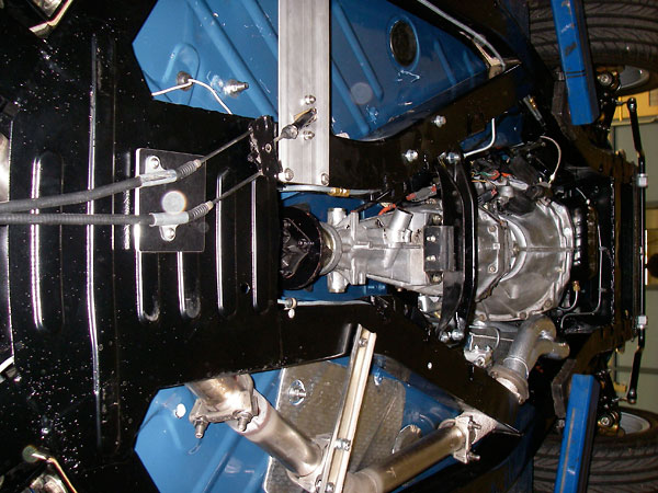

Transmission: stock Nissan 240SX 5-speed. Racing Nissan 240SX clutch. Austin Healy 3000 master cylinder. Nissan slave cylinder.

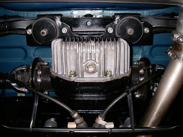

Rear End: stock Nissan 240SX limited slip differential. Custom rear hub carriers. Corvair axles & bearings. Hybrid halfshafts (Chevrolet Corvair to Triumph TR6).

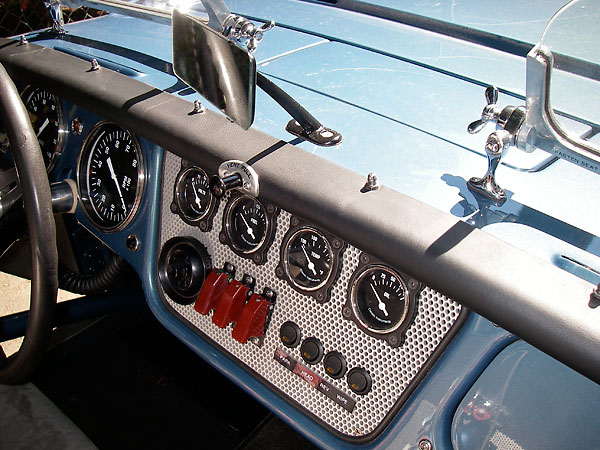

Instruments: Classic Instruments brand.

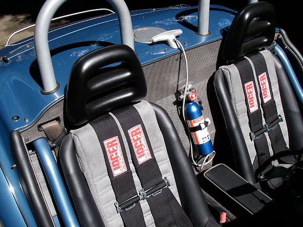

Interior: custom (see detailed articles.)
Body Mods: body cut in half lengthwise and widened 4 inches, Body closed in behind seats. Custom rollcage. (See detailed articles.)

Nissan 240SX 2.4L DOHC engine with electronic fuel injection.
Custom instrumentation, switch gear, and wiring.
Custom interior trim, including roll structure and racing belts.
Chassis
Triumph TR6-based independent rear suspension.
Nissan 240SX limited slip differential...

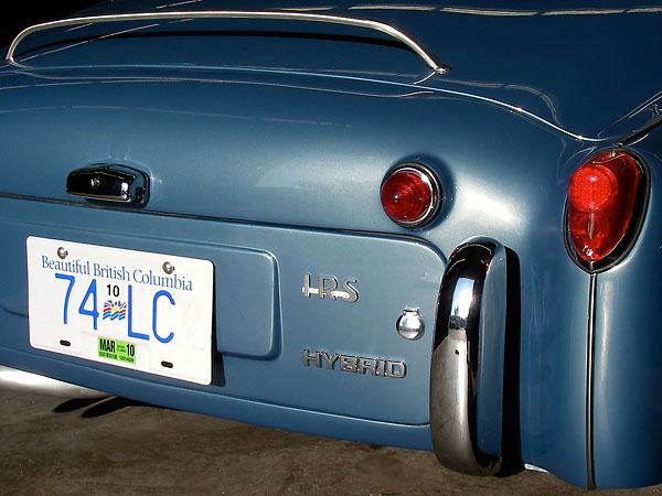

Refined body, four inches wider than stock.
