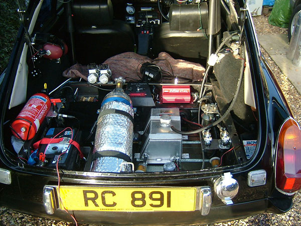

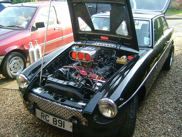

Engine: Rover 4.6L aluminum V8 with cross-bolted mains. Chrome-moly rods. Real Steel "blower" cam and bleed-down lifters. Double valve springs to suit cam. Edelbrock Performer 3.51 manifold. Weber 500cfm carburetor. Wizards of NOS ("WON") nitrous system/controller with 100hp of gas. Mallory HyFire capacitive discharge ignition system, with (boost proportional) remote ignition retardation module.
Cooling: all new, but to original specification.
Exhaust: RV8 headers (through the inner wings), but with the collectors opened out to 2.5 inches. Home-made stainless steel pipes. Chevy mufflers.

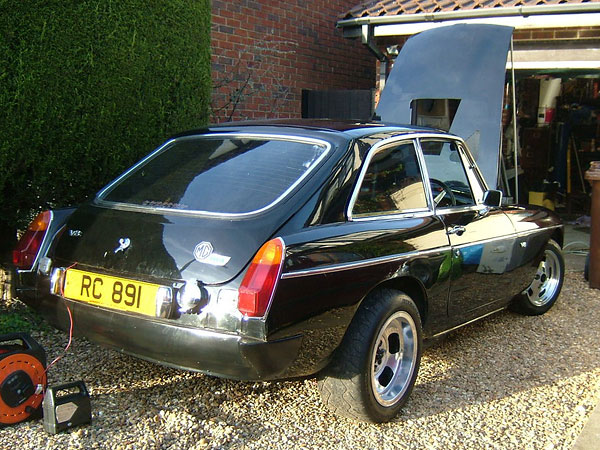

Wheels/Tires: (front) 6" Cosmic alloys with Toyo Proxis tires.
(rear) 8" Wolfrace alloys with Mickey Thompson ET Street tires.

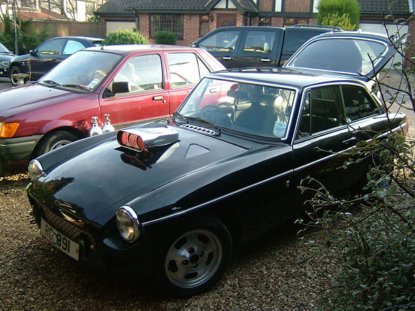

Enderle-style carburetor scoop
Enderle-style carburetor scoop.
NOS bottle and fuel cell
NOS bottle and fuel cell.
