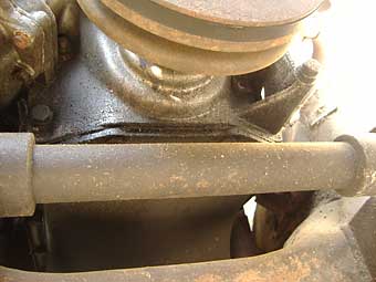

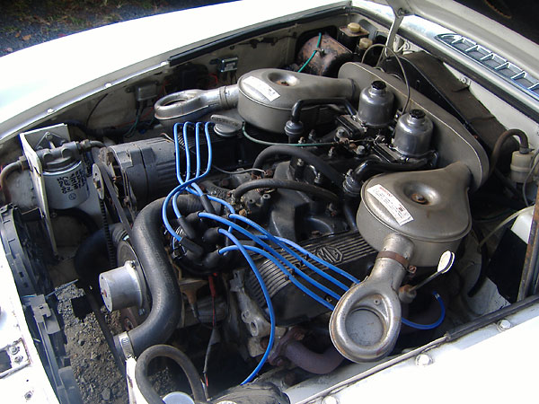

At the time of Don's visit, the radiator had been removed to be re-cored. It's conspicuously missing from some of the photos, but with the radiator out of the way we can see construction details that are usually hidden.

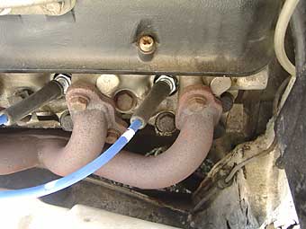

Also, the original iron exhaust manifolds have been replaced with tubular "block hugger" headers.

twin SU HIF6 carbs mounted on a manifold adapter
When Rover installed these engines in their saloons and utility vehicles, they centered the SU
carburetors over the intake manifold. Keen to keep the carbs under an un-modified MGB hood,
MG engineers designed an adapter that shifted carburetor placement rearward as shown here.
bi-metallic thermostatic air cleaner
MG developed the engine installation to comply with both European and U.S. anti-pollution
regulations. The thermostatic air cleaners draw warmed air from near the exhaust manifolds
to help the engine warm-up quickly. A bi-metallic valve allows the warmed-up engine to
breathe cooler air. (The phillips screw head seen here isn't original.)

Kevin told us a previous owner had the engine rebuilt, and selected a performance camshaft
(of unknown spec.) There's also a pretty good chance the rebuilder may have chosen
higher-compression pistons. In stock form, MGB and Range Rover versions of this engine
came with only 8.25:1 compression-ratio pistons. When these engines are being rebuilt,
it doesn't cost extra to select higher-compression pistons. Rover "3500" sedans, came
with 10.5:1 pistons. Buick versions of the engine started at 8.8:1 compression.

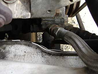

miles of oil pan clearance   ignition timing indicator
oil pump valve body (for remote filter)   oil hoses
These two photos show how the original MG oil-pump valve-body accomodated their remote oil filter.

block-hugger headers   exhaust routing
Believe it or not, the original cast iron exhaust manifolds were fragile (and replacements
are scarce). A wide range of replacement headers are available. The style shown here allows
otherwise standard piping.

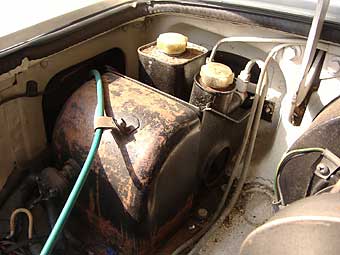

master cylinders   remote brake servo
A remote power brake servo and oversized rotors for the front disc brakes were standard equipment
on MGB GT V8. Although by all accounts the MGB GT V8 brakes worked quite well, North American
readers may be surprised to learn that, for the English market, MG was very late to equip their
cars with tandem master cylinders. Shame on them!

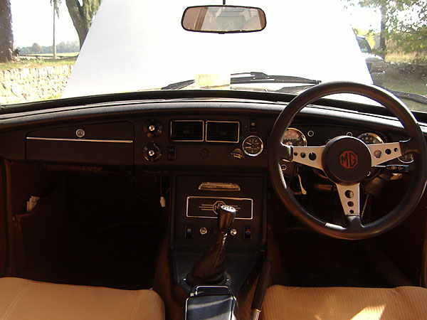

original MGB GT V8 dashboard
MG made collapsible steering columns standard on the MGB GT V8, although they didn't upgrade
to an impact absorbing dashboard. (Both of these highly-effective safety features had been
mandated by the Federal "Safety Act of 1966" so North American MGBs were ahead of the game.)
To accomodate the larger steering column, MGB GT V8s featured smaller-diameter speedometers
and tachometers than regular home-market MGBs.
The righthand-side stalk switch controls lighting functions: turn signals, beam dip, and hi-beam flash.
(The end cap appears to be missing.) The key switch has a peculiar little button for releasing the key.

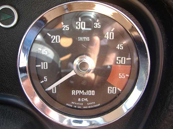

original MGB GT V8 tachometer

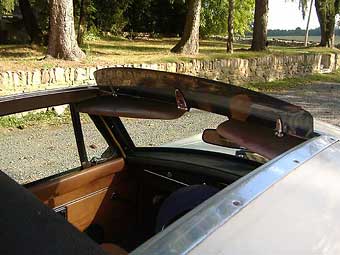

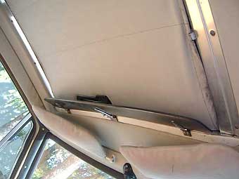

dealer-installed Sunroof
Sunroofs were a very popular dealer-installed option on MGB GT's, apparently especially on the V8s.
There were several popular manufacturers... this specimen is a "Sunway" model sunroof, manufactured
by Weathershields Ltd. of Birmingham. That company has changed ownership several times now (from
Britax, to Hollandia, and now to Webasto GMBH). How does this folding sunroof work? We'll show you!
Sunway sunroof   Weathershields sunroof
Britax sunroof   Hollandia sunroof
Webasto sunroof   Sunray sunroof (this was actually the name of another Weathershields model)
canvas sunroof   vinyl sunroof
folding sunroof   want ventilation?

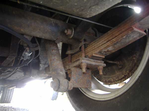

telescoping shock absorbers
The MGB GT V8 model came with stiffer leaf springs (550 lb vs. 510 lb) to combat axle tramp.
This spring pack appears to have been modified, with one leaf cut short (possibly to lower
ride height.) The telescoping shock absorbers aren't original though; MG installed regular
knee-action shocks on the MGB GT V8s.

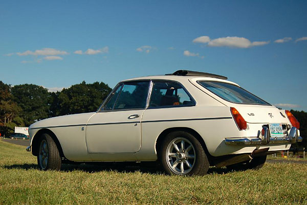

With a sunroof, the MGB GT V8 has plenty of ventilation!
Minilite replica 8-spoke wheels
MGB GT V8 tailgate badge
