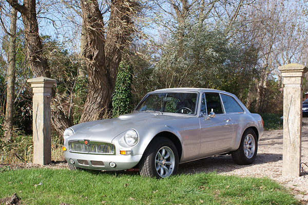

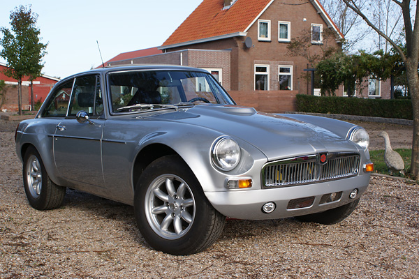

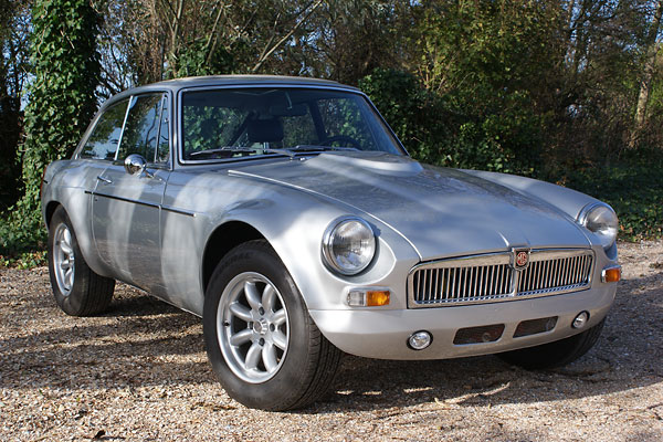

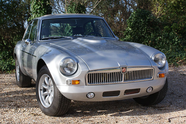

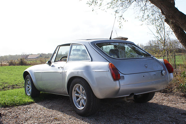

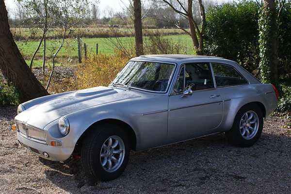

Jos Minderhoud's 1976 factory MGB GT V8, updated with Rover SD1 engine and Sebring kit.
Jos Minderhoud's 1976 MGB GT V8 with Rover 3500 Aluminum V8 Engine
Jos Minderhoud's factory MGB GT V8: restored, with Sebring kit!
Owner: Jos Minderhoud
BritishV8 UserID: Lesswood
City: Grijpskerke, The Netherlands
Model: 1976 MG (factory) MGB GT V8
Engine: Rover 3500cc V8
Built by: owner and his father

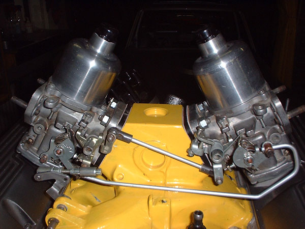

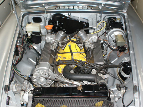

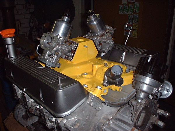

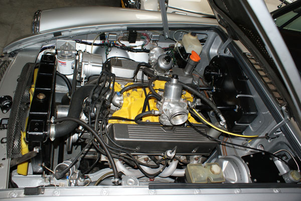

Engine: Rover 3500 V8 (ex SD1). Dual SU HIF6 carburetors on standard Rover SD1 intake manifold. Standard Lucas electronic ignition with 35DLM8 distributor. Remotely mounted oil filter.

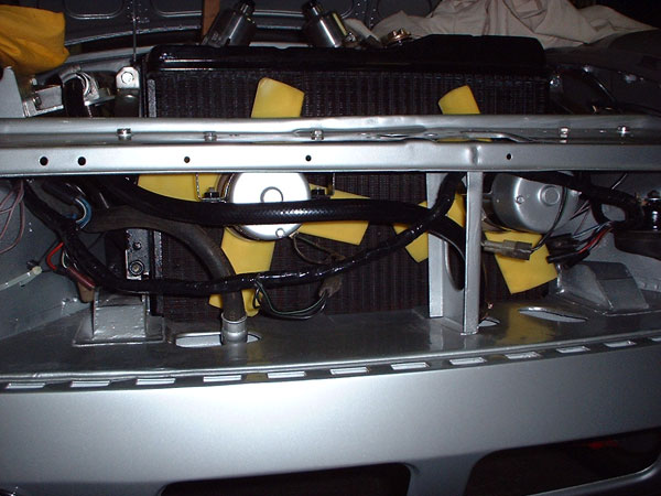

Cooling: stock MGB GT V8 radiator and oil cooler. Stock dual electric fans, re-wired to a manual switch on the dashboard. Various aerodynamic modifications for cooling (see below.)
Exhaust: four-into-one block hugger headers. Home-made stainless steel exhaust plumbing, muffler, and tail pipe.
Transmission: Rover LT77 5-speed. Standard Rover clutch and slave cylinder, with custom made clutch hose. Home-made driveshaft (i.e. LT77 driveshaft rebuilt with small MGB flange at the back.)

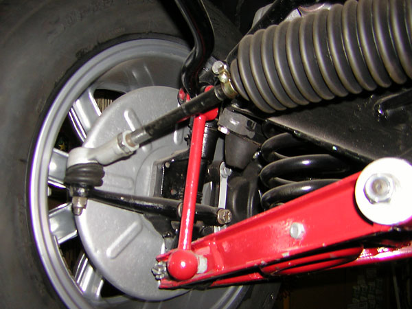

Front Susp.: RHD To LHD conversion. Standard rubber-bumper MGB Front suspension with V8 bushings added, and with extra long lower wishbones to produce negative camber. Stiffeners added to steering rack brackets to suit bigger (15x7) front wheels.

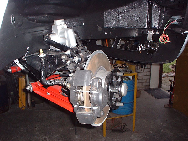

(front) original V8 calipers and thicker rotors.

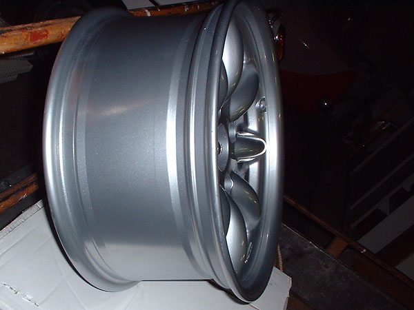

Wheels/Tires: special ordered Compomotive wheels (15x7J) with cast on bosses to accommodate Sebring body widening. Federal Super Steel 621 tires (205/65/15 front, 215/65/15 rear.)

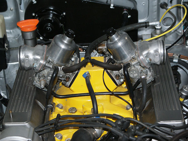

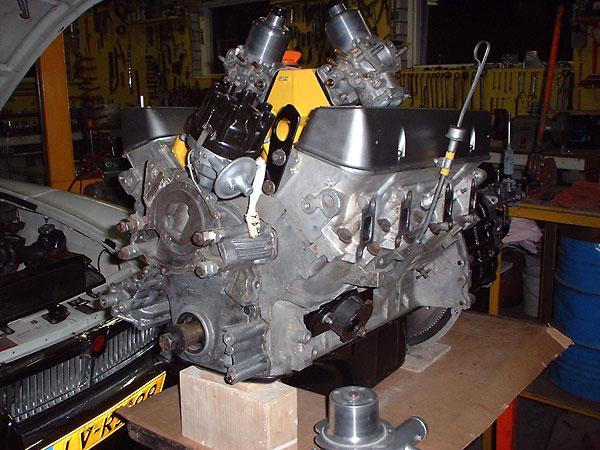

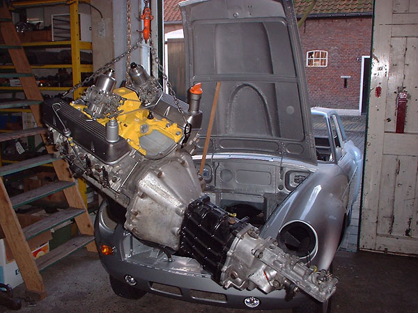

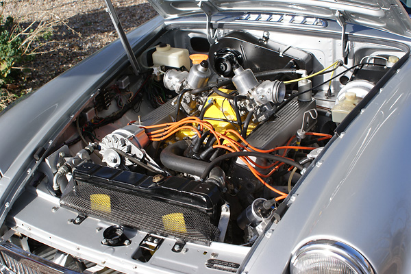

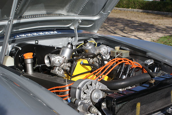

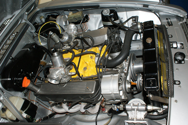

Later model 3500cc aluminum engine, taken from a Rover SD1.
The original Rover V8 engine for this car has been replaced with a similar but
later model 3500cc aluminum engine, taken from a Rover SD1 saloon.
The most conspicuous difference between an original MGB GT V8 engine and a Rover SD1 engine.
is right up top. Although they both use dual S.U. carburetors, they're mounted on different
intake manifolds. The MG manifold (not shown) placed the carburetors lower and rearward, and
the axis of the throttle bores were oriented parallel to the crankshaft, not perpindicular.

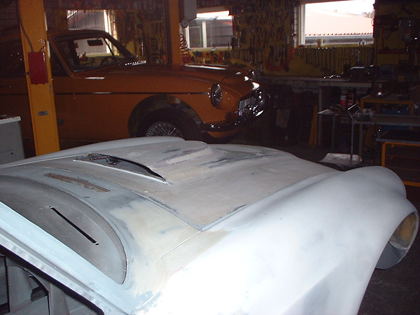

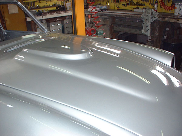

With an original MGB GT V8 manifold, there's no need to add a bulge or scoop to the hood.
Cooler air is denser air.
Cooler air is denser air. A vent in the hood can potentially improve performance by
providing more oxygen-dense air for the engine to work with.

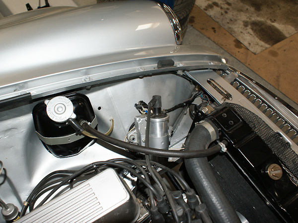

Recirculation shields omitted.
Unorthodox approach: rather than building up shields to prevent airflow from bypassing
the radiator, Jos has taken the opposite approach. He has even removed original bracketry
on either side of the radiator in an attempt to coax more airflow into the engine compartment.
The vent at the back of the hood is primarily intended to let hot engine compartment air escape.

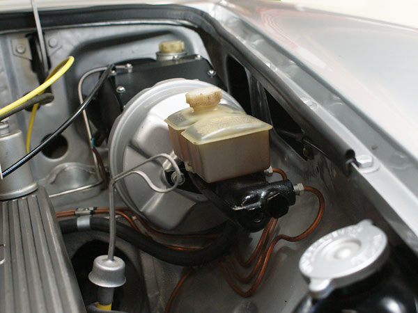

Tandem master and close-coupled booster.
Original factory MGB GT V8s only came with single-circuit master cylinders and remotely
mounted power brake boosters, which was all the home market required. Jos has updated
this MGB GT V8 export specification: tandem master and close-coupled booster.

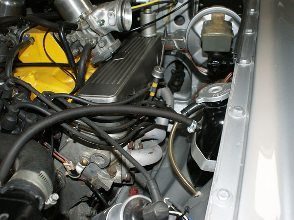

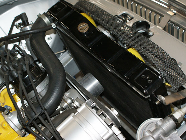

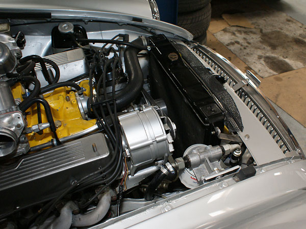

Stock MGB GT V8 radiator and dual electric fans.
Breaking from tradition, and Lucas, original MGB GT V8s were built with Delco-Remy alternators.

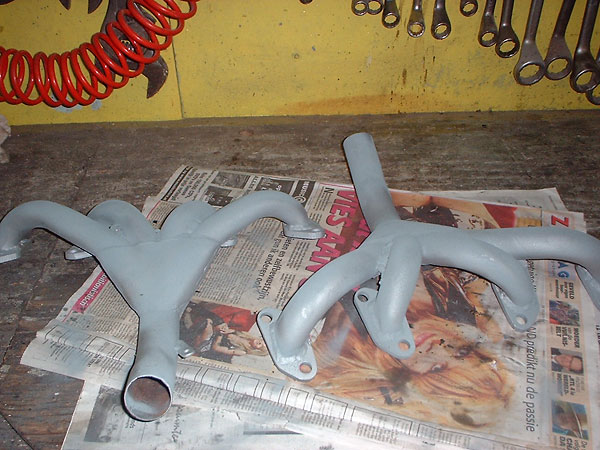

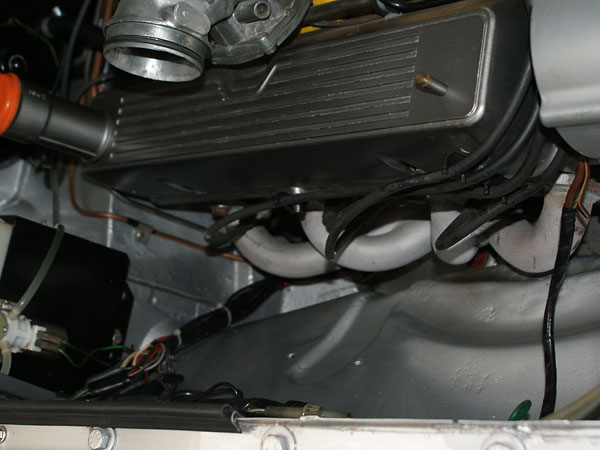

Tubular four-into-one block hugger headers.
Stock MGB GT V8s originally had cast iron exhaust manifolds. This one has
been rebuilt with tubular four-into-one block hugger headers instead.

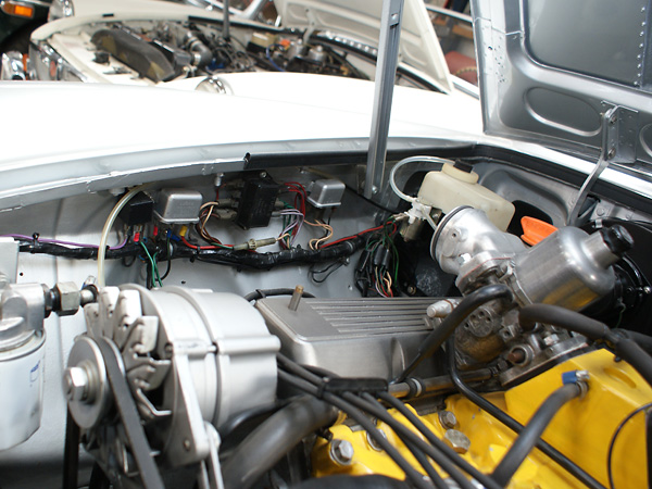

Clean wiring.
Clean wiring.

Something to keep mechanics busy: multiple carburetors have long been favored in Europe.
Multiple carburetors have long been favored in Europe.

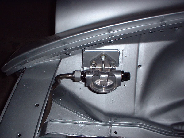

Remote oil filter mounting bracket.
Remote oil filter mounting bracket. To the right, two rivet holes where the car number
plate used to attach. (It's been relocated to the slam panel, as seen below.)
Oil lines from the engine toward the filter and oil cooler.

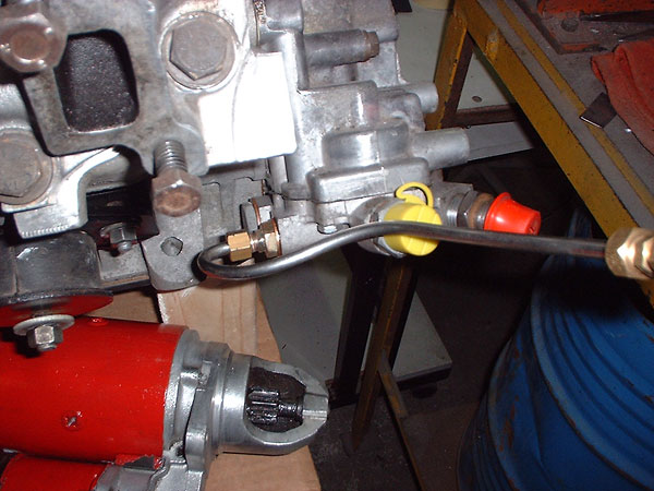

Starter motor.
Starter motor.
Four-into-one block hugger headers.

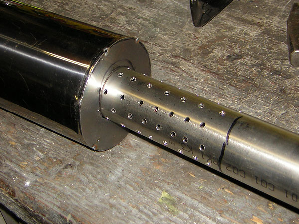

Home-made stainless steel muffler.
Home-made stainless steel muffler (going together).

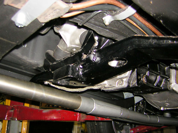

Transmission mounts.

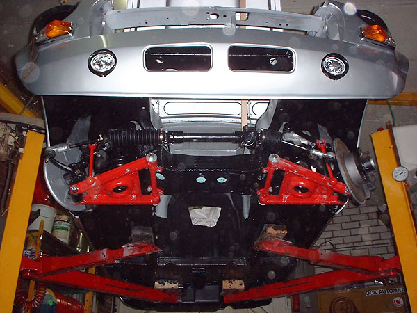

Front Suspension
Notice the ductwork around the oil cooler.
Refreshed front suspension.
Original V8 calipers and thicker rotors.

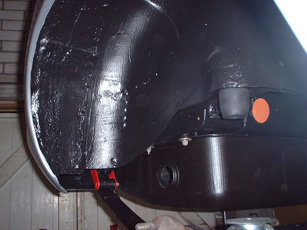

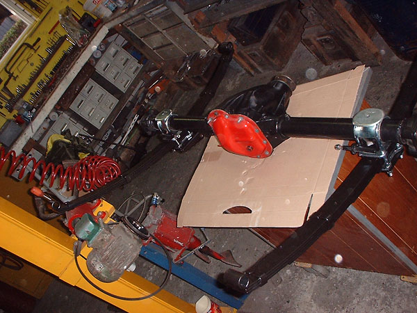

Rear Suspension

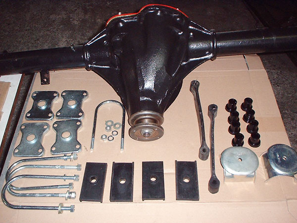

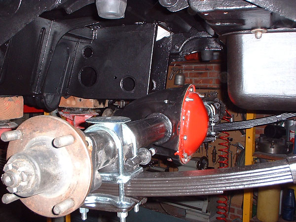

Salisbury axle, and all the parts to install it.
Stock four-cylinder MGBs came with 3.909:1 ring-and-pinion sets whereas original MGB GT V8s...
usually came with 3.07:1 gearing. Jos will use the MGB ratio, at least for awhile.
The 3.5L engine produces enough torque that first gear won't be needed to launch this lightweight car.

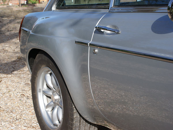

Filler paneling, custom made to fill the wheel arches.

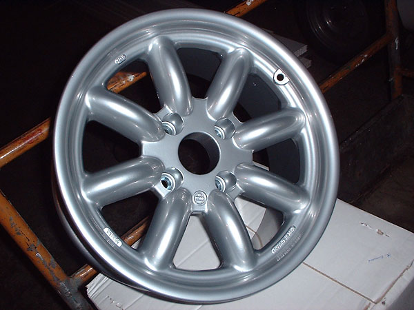

Special ordered Compomotive (15x7J) wheels.
Cast-in bosses which alter the wheel backspacing.
Instead of using a wider axle or hub spacers, Jos ordered these wheels with special
cast-in bosses which alter the backspacing, and thus accommodate Sebring body width.

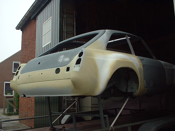

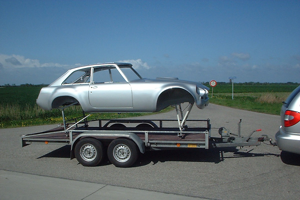

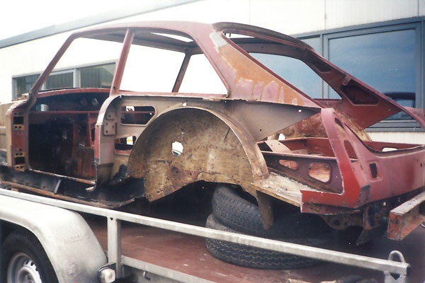

Body Restoration

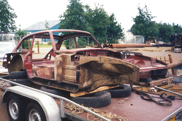

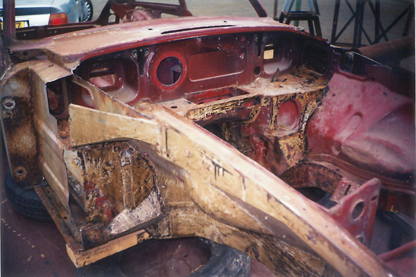

A very rusty MGB GT bodyshell.
Worth messing with? Maybe, but only because this is a rare factory MGB GT V8 bodyshell.
Worth messing with? Yes, but probably only because this is a rare factory MGB GT V8 bodyshell.
MGB front fenders don't carry much load, but the rear quarterpanels do.
MGB front fenders don't carry much load, but the rear quarterpanels do. This car will have
fiberglass quarterpanels, so the steel underneath needs to be restored to tip-top shape.
This photo shows off a great amount of skilled labor.

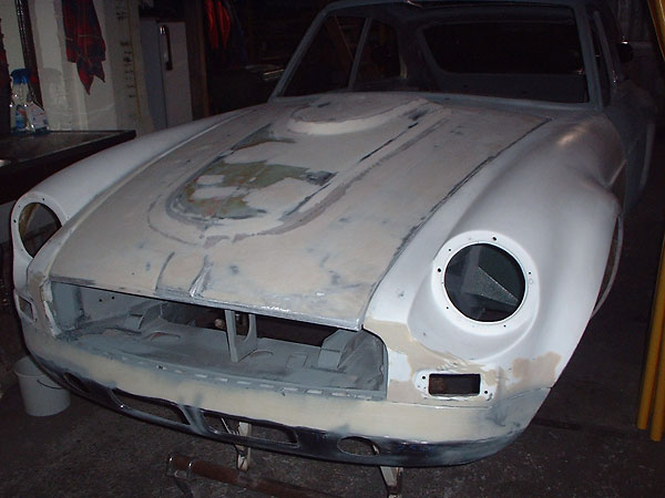

Modified bonnet with cowl-induction style hood scoop for engine cooling.

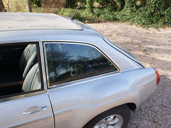

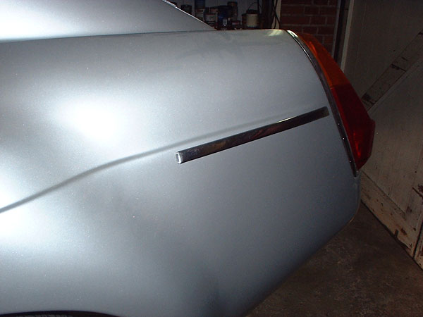

Newly installed traditional Sebring-style fiberglass rear fenders.
Building out the area beneath the taillamps.
If you compare this photo to earlier shots of the bodyshell (above), you can see how omission
of the original rubber bumpers has necessitated building out the area beneath the taillamps.

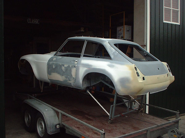

Shiny new paint.
Shiny new paint.
Transporting the painted bodyshell home, ready for reassembly.

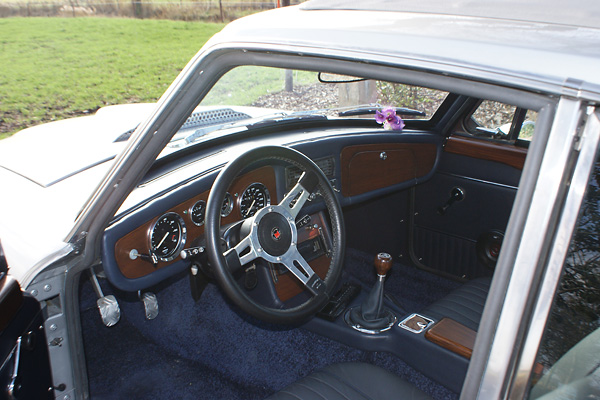

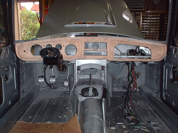

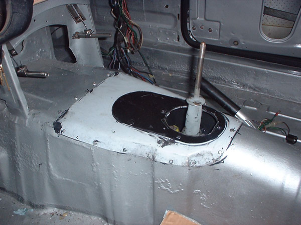

Right-hand-drive to left-hand-drive conversion. Mountney steering wheel.
Custom made sculpted dashboard.

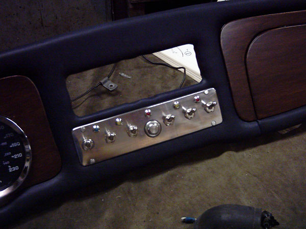

Stainless steel switch panel, chrome toggle switches, and starter pushbutton.
On either side of the radio console, there's a vertical slider for heater vents.

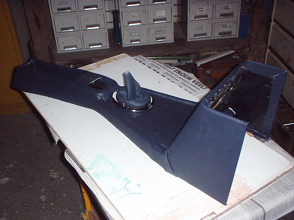

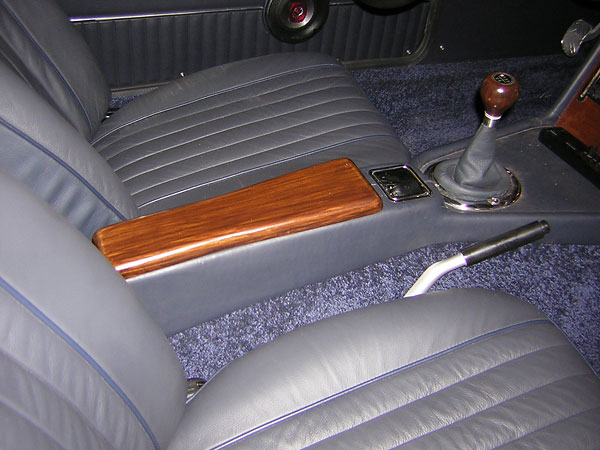

Tunnel console covered with foam and leather upholstery.
Wooden trim accents added.

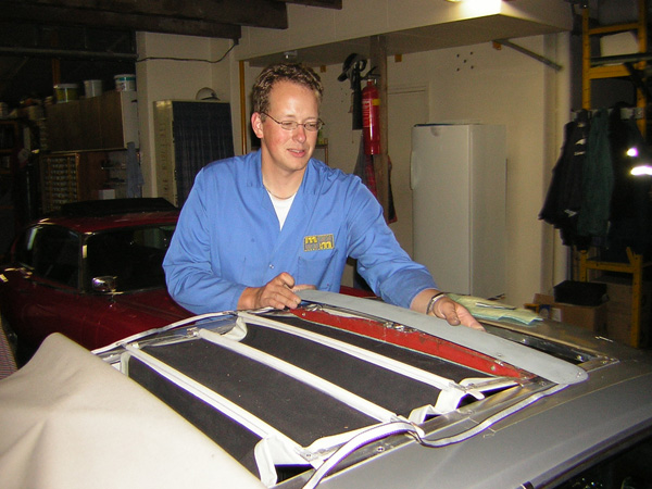

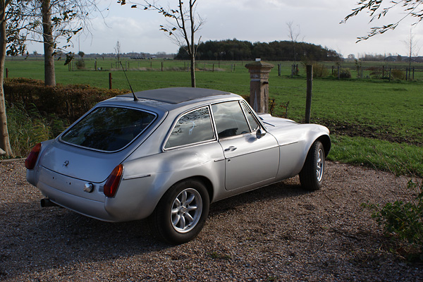

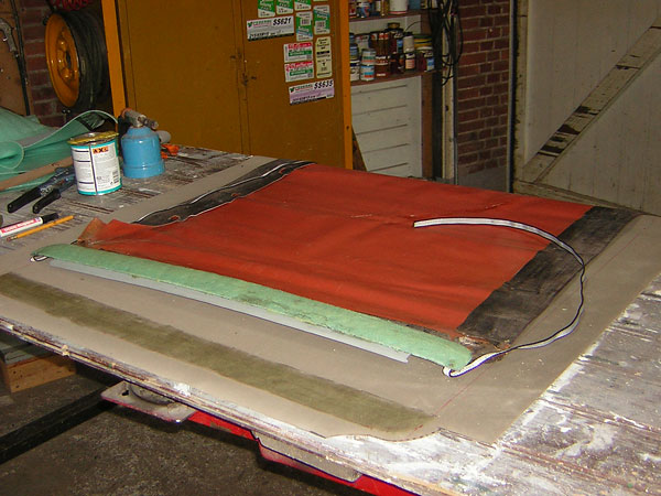

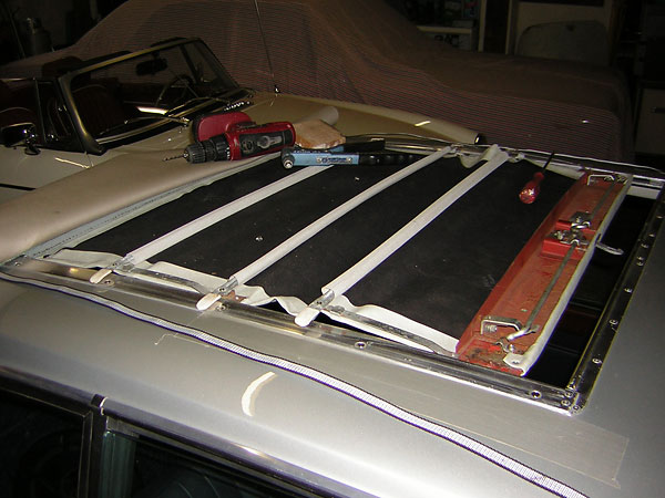

Home-made replacement for the Webasto roof, installed on existing rails.
Home-made replacement for the Webasto roof, to be installed on existing rails.
Installation of the Webasto sliding roof.

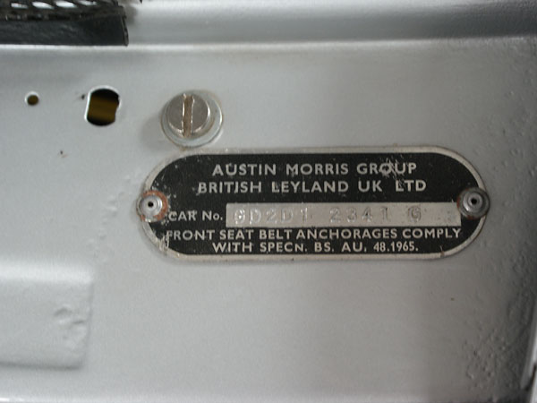

MGB GT V8 car number tag (car 2341)
Factory MGB GT V8 car number tag. "GD2D1-2341 G" can be parsed and translated as follows:
G = MG, D = 3,000cc and over, 2 = two door, D = GT body, 1 = 1st series. 2341 is the
car's serial number. After prototype and pre-production cars, serialized chrome-bumper
MGB GT V8s were assigned serial numbers from 0101 through 1956. A first series of
rubber-bumper GTs were numbered 2101 through 2632, and later 2701 through 2903.

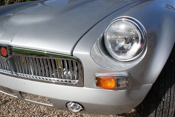

This is an early model (1962-1969) MGB grille.
Front valance (steel) raised one inch and flared at the ends.

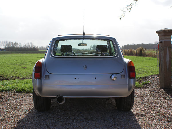

Sebring rear valance. Note: this car originally had big, black rubber bumpers.
Quick-lock (pop to open) fuel filler.
H2 fog lights, integrated in front valance.

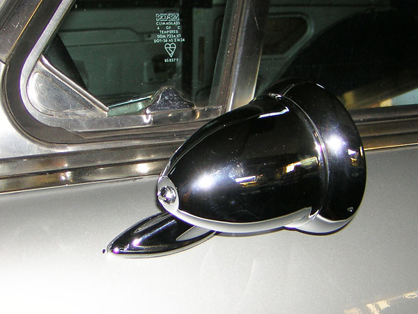

Rally mirror.

Custom modified stainless steel side trim strips on front and rear fenders.
