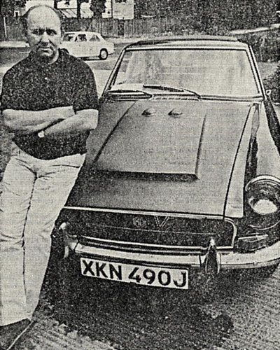

The problem of the under-engined MGB remained but British Leyland have been too busy lately revamping their more popular lines to do anything about it. Now the problem has been taken out of their hands and a solution found - albeit at a price - by a free-lance engineer and well-known former saloon car racing driver called Ken Costello. After 2.5 years work in the garage of his bungalow in Bromley, Kent, Costello has developed an MGB which can out-drag a Jaguar E-type up to 100 mph, which has a theoretical top speed of 140 mph, and which is actually lighter than the original car.
Costello and the MG that's faster than an E-type Jag
(photo by Kelvin Brodie)
