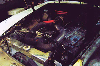

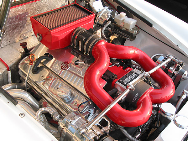

I got home from the races and dusted the cobwebs off that Buick V-8. I studied it for awhile. I measured the space I had to work with. I searched on the computer for conversion sites. Eureka! I found "The British V8 Newsletter" page - and the sacred chart of engine comparisons (in an article by Dan Masters, which included Buick, Ford and Chevy V8 weights and dimensions.) That convinced me that a Chevy was the way to go. The Buick motor was pushed back into the dark corner of the garage.
Chevrolet 350 LT-1 engine, from a 1995 Corvette
Steve's Chevrolet 350 LT-1 engine, from a 1995 Corvette.

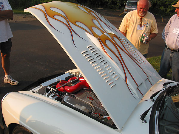

My choice of engines was a second generation 350 LT-1 from a '95 Corvette. For the next three years I worked just about every day designing and building the parts to make my dream come true. I completed the project April 24, 2004 at 2:30am. I showed the B at All British Car Day in Dallas at 12:00pm that same day!

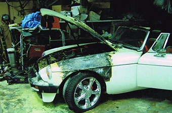

107 days later, just 3 days before I was to leave to go to the 2004 British V8 convention in Grand Rapids, the B caught fire in my garage. Brake fluid got spilled onto the headers! I had taken it for a couple shots in a secluded part of my neighborhood - drove into the garage and closed the garage door behind me. Several months of dealing with insurance companies, I was ready to start again. However, this time I could build it bigger and better!

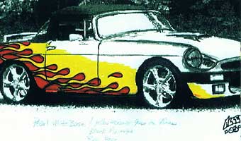

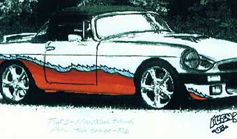

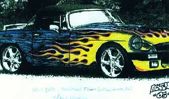

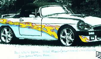

Next was a new paint scheme. First time around it was Arctic White, over-sprayed with Violet Pearl. Beautiful, but missing the pizzazz factor. Hence, several artist renderings, resulting in the obvious choice!
paint scheme sketch - 1   paint scheme sketch - 2
paint scheme sketch - 3   paint scheme sketch - final

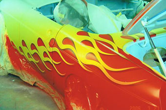

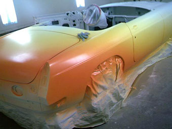

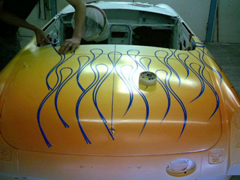

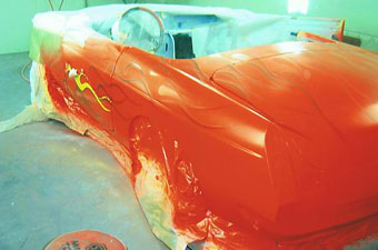

The entire car was initially sprayed Arctic White, then over sprayed with Silver Pearl, and then a base clear. Base clear was used between each level of the paint process so that if something went wrong, it would not have to be stripped all the way down. The "Oh So Yellow" and the "Orange Glo" were shot, followed by base clear. The flames were laid out using the blue fine line tape. A clear masking sheet was then laid over the flame design. The back end of the car was shot with "T-Rod Red". The masking sheet and fine line were removed to expose the fading flame design. The car was then sprayed with base clear. A hand-painted purple enamel pinstripe was used to outline the flames. It was then cleared with three coats of polyurethane. The pinstripe was sanded until it was flat with clear. The entire car was shot with Amber Glo" and then cleared with two additional heavy wet coats of polyurethane clear. The "B" was then color-sanded using 1200, 1500, 2000, 2500, and 3500 grit wet sandpaper and then compounded and polished.
Orange Glo over Arctic White   masking tape
T-Rod Red for the flames   unmasked flames paint scheme

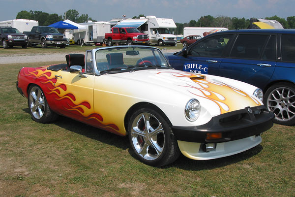

The final product, I showed at the 2007 British V8 meet. It was a painstaking three years (twice!) of restoration, but well worth the time.
