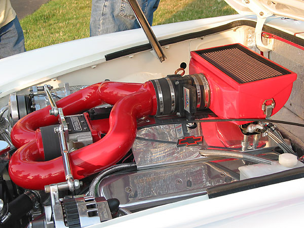

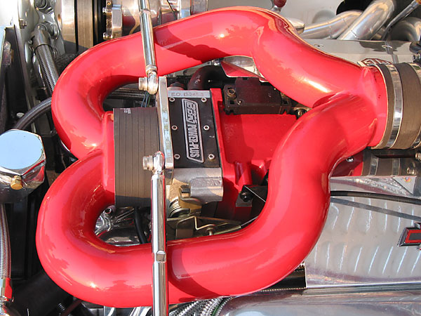

Heart shaped air ram pipes were custom designed by owner, and fabricated by Dallas Metro Metal.
BBK 52mm throttle body. S. Granatelli Motor Sports mass air flow sensor. K&N air filter.

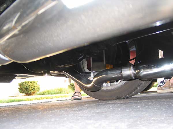

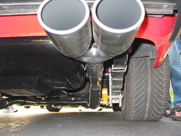

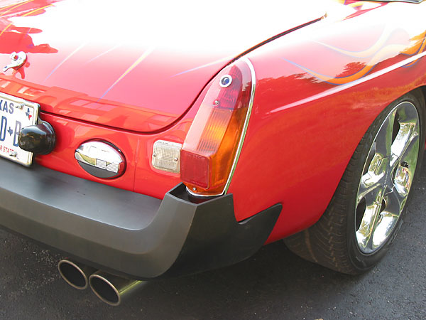

Exhaust: custom-built mild steel Jet-Hot coated headers into polished stainless steel pipes with
3" stainless steel mufflers. Solenoid-operated exhaust cut-out valves.

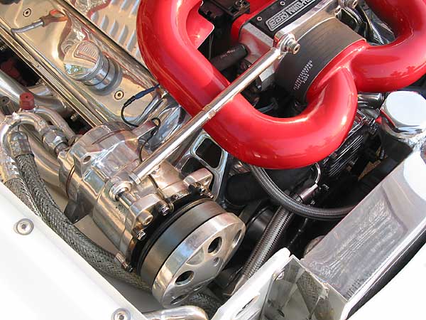

Cooling: Ron Davis custom aluminum radiator. "Speed and Performance" serpentine belt system with
polished billet aluminum pulleys and brackets, and single 7-rib Goodyear "Gatorback" belt.

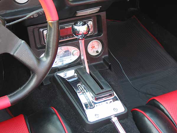

Transmission: GM 4L60-E computer controlled 4-speed automatic with B&M Quicksilver full-ratchet shifter.
(Gear ratios: 1st = 3.06:1, 2nd = 1.63:1, 3rd = 1.00:1, 4th = 0.70:1, R = 2.29:1.)

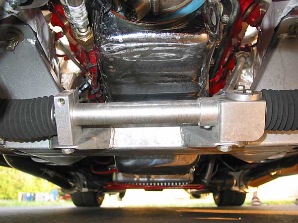

Front Susp.: Fast Cars Inc. front suspension.

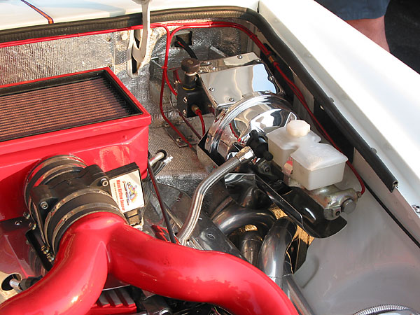

Brakes: master cylinder and brake booster are both stock, original parts.

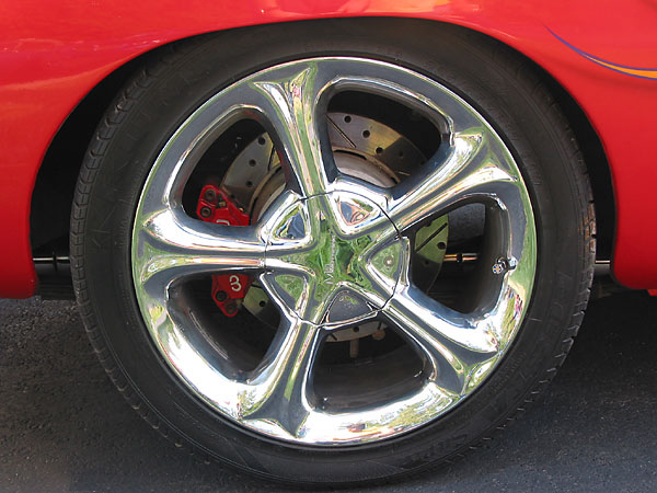

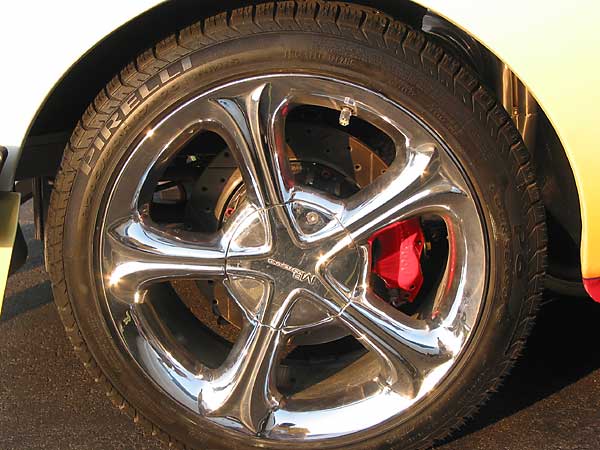

(Front) Wilwood calipers and cross-drilled/vented 12.25" rotors,
(Rear) Wilwood calipers and cross-drilled 11.5" rotors. Adjustable proportioning valve.
Wheels/Tires: MB Motoring 17x7 aluminum wheels with Pirelli 225/45-X front and 225/40-X rear tires.

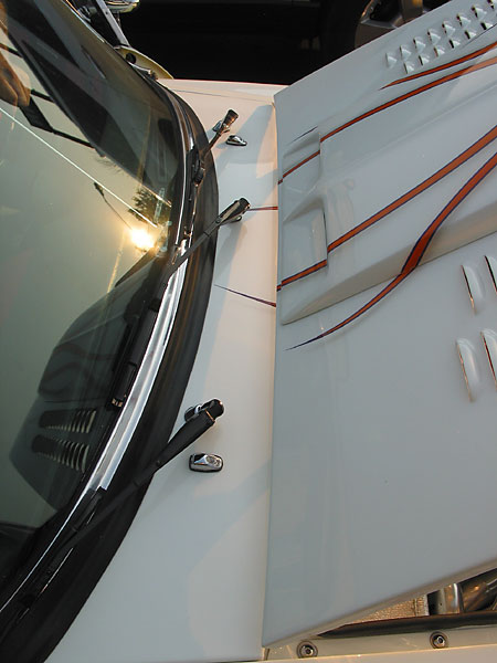

Body: welded and smoothed body seams. Removed windshield cowl. 1969 Ford Cobra Jet hood scoop.

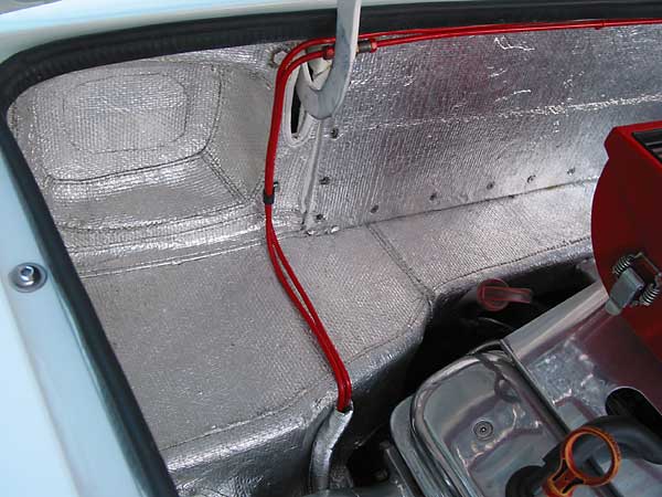

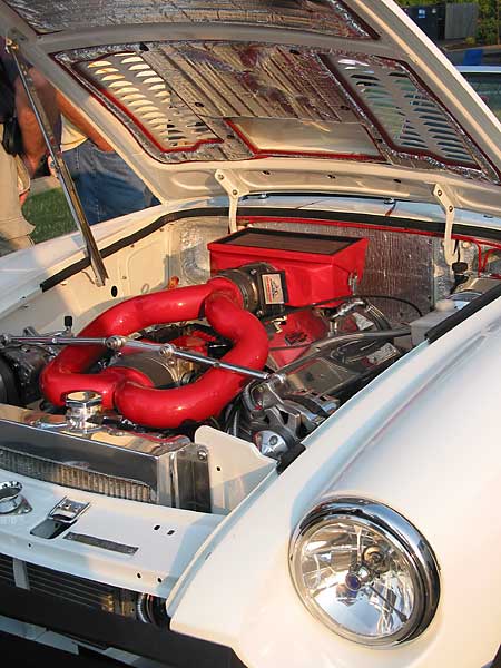

Jaguar flip-top fuel filler. Cool It "Thermo-Tec" aluminized heat barrier (on the firewall) custom
sewn by ASM Upholstery. The Thermo-Tec barrier was also applied throughout the transmission
tunnel, between the headers and inner fenders, the underside of the floorboards, etc.

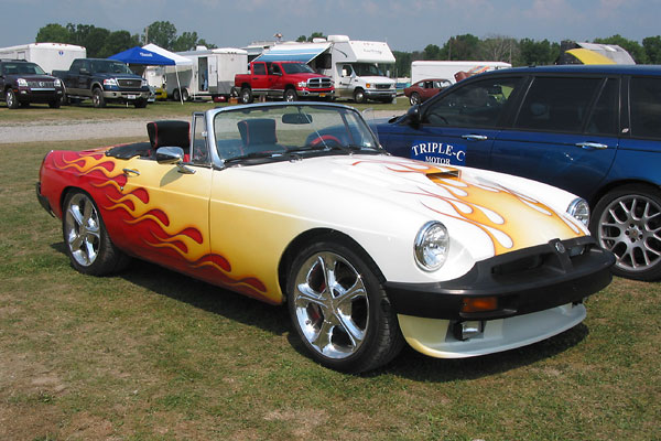

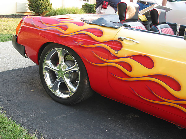

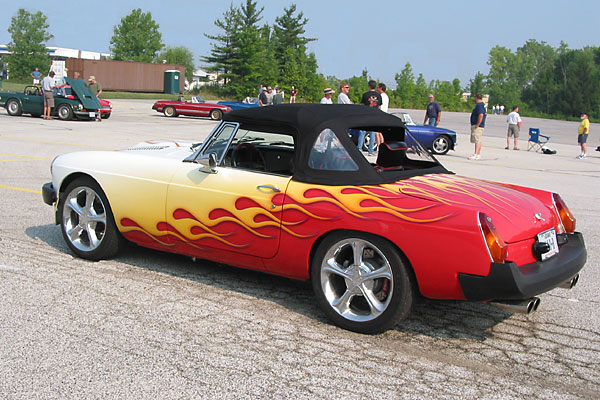

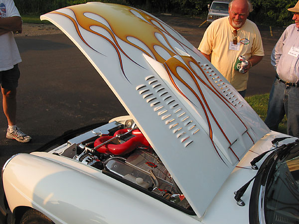

Paint: the custom (flamed) paint job was created by Dave Dusold of Dusold Designs, Lewisville Texas.
All finishing products are PPG brand, and were purchased from English Color & Supply:
 •  epoxy primer DP 50LF,
 •  Prima acrylic urethane primer K36,
 •  Deltron 2000 DBC GM "Artic White" 4185,
 •  Vibrance "Crystal Pearl" PRLX2 (Silver Pearl),
 •  Vibrance "O-So-Orange" 908414/2,
 •  Vibrance "Yella" 908413/2,  •  Deltron 2000 DBC "T-Rod Red" 4740,
 •  Deltron 2000 DBC 500 with "Emberglo Pearl" VM4102
 •  Concept High-Solid Clear Polyurethane DCU 2002.

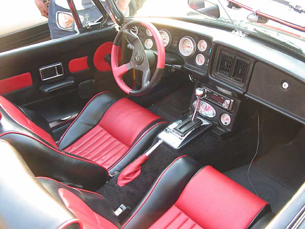

Interior: Vintage Air Mini Generation II heater/AC/defront unit (mounted between firewall and dashboard).

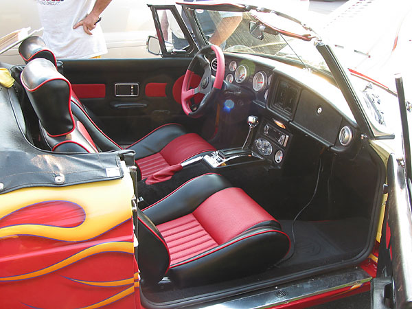

Custom narrowed and upholstered 1996 Chevy Camaro Z28 seats mounted onto the MGB rails. Auto-Meter Pro Comp gauges.

Steven's Chevrolet 350 LT-1 engine, from a 1995 Corvette

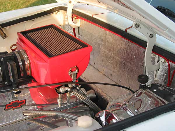

The induction piping was custom designed by Steven and fabricated by Dallas Metro Metal
The induction piping was custom designed by Steven and fabricated by Dallas Metro Metal.
K&N Air Filter
K&N air filter.
Cool It Thermo-Tec aluminized heat barrier, custom sewn by ASM Upholstery
Cool It "Thermo-Tec" aluminized heat barrier, custom sewn by ASM Upholstery.
stock master cylinders and brake booster, but added brake proportioning valve
Stock MGB master cylinders and brake booster, with Wilwood brake proportioning valve added.
Sanden a/c compressor
Sanden air conditioning compressor.

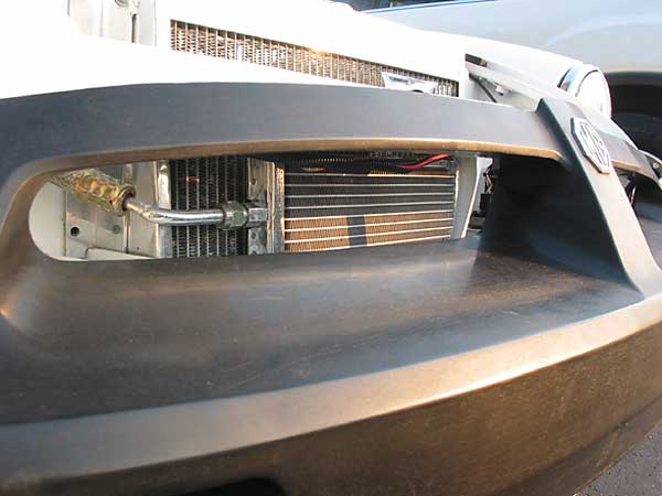

A/C condensor
Vintage Air air conditioning condensor.

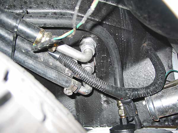

A/C plumbing in the front fenderwell
A/C plumbing in the front fenderwell.

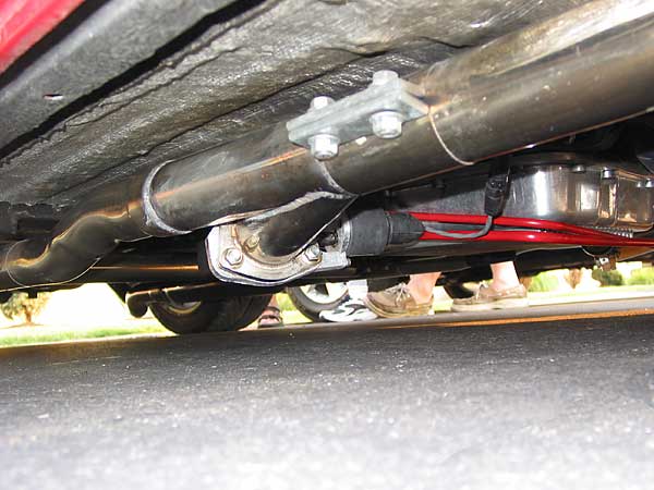

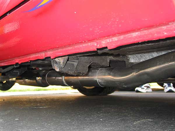

polished stainless steel exhaust pipes
Polished stainless steel exhaust pipes.

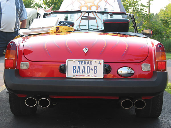

stainless glass pack mufflers

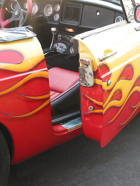

Custom upholstered door panels.

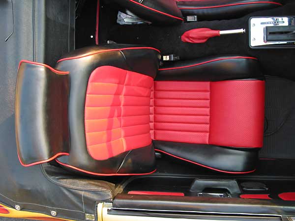

Custom narrowed and upholstered 1996 Chevy Camaro Z28 seats.

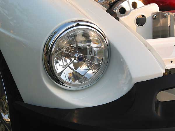

tripod headlamps

painted door jams
detailed doors / plated lock and latch
flamed paint job

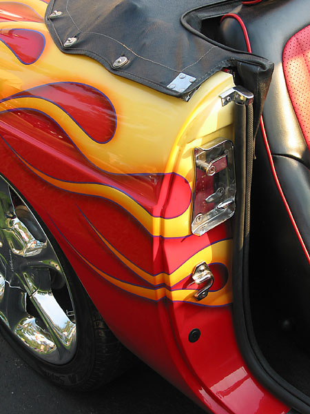

Four wheel disc brakes, with Wilwood calipers
Four wheel disc brakes, with Wilwood calipers.
MB Motoring wheels, Pirelli tires
MB Motoring wheels and Pirelli tires
the custom, flame paint job was created by Dave Dusold of Dusold Designs, Lewisville Texas
The custom, flame paint job was created by Dave Dusold of Dusold Designs, Lewisville Texas.
