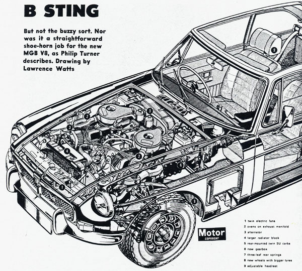

B Sting
But not the buzzy sort. Nor was it a straightforward shoe-horn job for the
new MGB V8, as Philip Turner describes. Drawing by Lawrence Watts.
Re-printed unedited by exclusive written permission of "Motor".
This article originally appeared in their issue for the week ending August 18, 1973.
1. twin electric fans, 2. ovens on exhaust manifold, 3. alternator, 4. larger radiator block
5. rear mounted twin SU carbs, 6. new gearbox, 7. three leaf rear springs,
8. new wheels with bigger tyres 9. adjustable headrest, 10. seat belt mounting.

The Rover engine has been installed in the MGB engine bay very neatly, with no external power bulges to betray its presense. To this end, the two SU HIF6 horizontal integral float carburetters are mounted at the rear of the engine instead of in the centre of the vee. A special manifold has been devised to enable this revised mounting to be carried out and has the additional advantage of reducing temperature scatter between the cylinders compared with the original penthouse manifold.
To comply with the ECE 15 regulations on exhaust emission, especially when the engine is cold, bi-metal valves shut flaps in the air intakes so that the incoming air is warmed by diverting it through "ovens" on the exhaust manifolds which pre-heat the air. As soon as the engine reaches its normal working temperature, the flaps open and air is drawn direct from the atmosphere.
Emission regulations are also responsible for a reduction in the compression ratio from 10.5:1 to 8.25:1. Modifications to the engine engine to enable it to fit in the MG's engine bay include the use of an AC Delco alternator instead of a dynamo, and the installation of the oil filter in series with the oil cooler instead of in the base of the oil pump.
The exhaust manifolds have also been redesigned to suit the new installation and the two branches now merge into one in the region of the bell housing. This housing is also new for a new gearbox casing has been developed to enable the clutch diameter to be increased from 8" to 9.5" to cope with the increased torque. A further refinement is the use of a ball race for the clutch withdrawal race instead of a carbon brush.
The gearbox internals are mostly C-type with the intermediate ratios modified to bring them closer together. With a new final drive ratio of 3.07 instead of 3.91, the overall ratios are now 9.634, 6.059, 3.864, and 3.070 instead of 13.46, 8.48, 5.40, and 3.91. A Laycock overdrive operating only on top gear gives an overall ratio of 2.517 and is operated by a forward pull on the left-hand stalk which also controls the windscreen wipers and washers.
Few changes have been made to the body structure. The front bulkhead has been modified slightly to accomodate the rear ends of the cylinder heads, and slight depressions in the rear arch panels make room for the exhaust manifolds. The new and bigger radiator core with four rows of copper gills holds 16 pints of coolant instead of 9.5 and cooling is aided by two thermostatically controlled four-blade electric fans mounted in front of the radiator. The twin fan layout was adopted when supplementing the normal engine-driven fan to cure a heat soak problem in heavy traffic.
