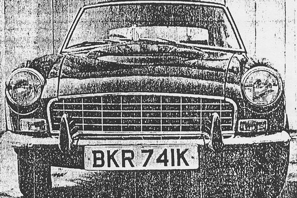

(BKR741K) The Costello MGB - Ferrari look outside, Rover V8 in.
(photo by Gordon Wilkins)
Ken Costello of Costello Engineering is Farnborough Kent has now converted nearly 40 MGBs. The engine goes in neatly with minor modifications to engine mountings and scuttle. The oil filter is moved to the wheel valance. The conversion, costing £975, includes a new glass fibre bonnet with bulge to clear the engine, plus new grille and badges.
Radiator, clutch, propeller shaft and differential are from the MGC. The gearbox of the MGB has a heavy, jerky action but the converted car's V8 helps by cutting the need for gear changing. In top gear it will go from 20 to 80 m.p.h. faster than a V12 E-type and from 20 to 100 m.p.h. it will leave behind a Porsche 911E running in the fourth of its five gears.
