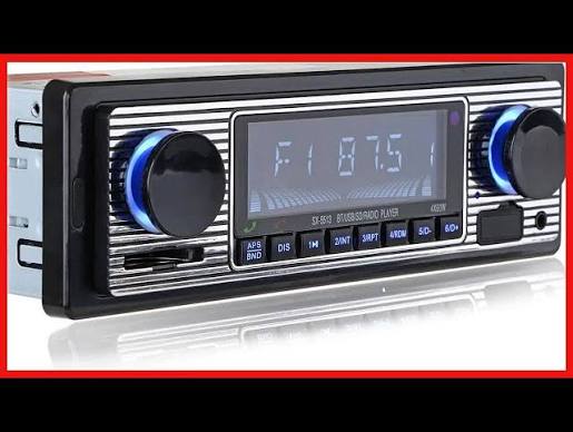

Anyway in testing, the Audisons are nearly their equals but the A-Ls have an ever so slightly nicer sound. They do not have the raw power capacity of the Audisons however which is why they went where they did. At present I am waiting on an impedence matching circuit (2 actually, https://www.ebay.com/itm/166814777054?_trkparms=amclksrc%3DITM%26aid%3D777008%26algo%3DPERSONAL.TOPIC%26ao%3D1%26asc%3D20250417133020%26meid%3Dbb0c1afe61c74fbf91efb854dde2455b%26pid%3D102726%26rk%3D1%26rkt%3D1%26itm%3D166814777054%26pmt%3D1%26noa%3D1%26pg%3D4375194%26algv%3DRecentlyViewedItemsV2DWebWithPSItemDRV2_BP%26brand%3DUnbranded&_trksid=p4375194.c102726.m162918 needed due to the Marantz's wacky input setup) to go between my vintage Marantz 7 band equalizer (SA-247)
 and my cheap Chinese head unit (Dongguan SX-5513, https://encrypted-tbn0.gstatic.com/images?q=tbn:ANd9GcSfi0BJKMUbcVha70DImZtYYW2m0XZekvpy8BBPMI1ppA&s=10
), and a set of inline fuse holders for the tweeters. I am very concerned about overdriving the speakers and amps. Even a cheap amp can blow an expensive speaker if it's abused, so on the tweeters I'm going to rely on 2-1/2 amp AGC fast blow glass fuses, and on the front and rear amps which are nothing fancy, just vintage Optima 50 and 110 watt units that are fitted with ATO style plug in fuses, I plan to measure the supply current and fit auto-reset circuit breakers of an appropriate value.
