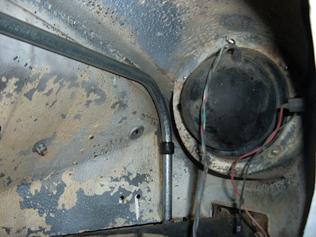

Conduit in passengers side wheel well for hidden harness. The harness is taken out of the engine bay and rerouted through this piece of 1/2" (I.D.) conduit. The hole is drilled here in the wheel well and runs in between teh inner and outer 'wing' and then through teh standard rubber grommet in the firewall. No fuse panel in the engine bay means everything under the dashboard.
Conduit in the wheel well for the hidden harness. Aproximately 32" long and 8" down. Requires a minimum of one clamp up front and to have the hole sealed in the rear with silicone sealer. two made at the same time for two different projects.
No harness in the engine bay. The 1/2" conduit is large enough for a ground, left and right turn, low and high beam, fog lamp, parking lamp, horn and engine fan. This all stretches across the front of the car and with this tube in place, anything that gets stuck in your wheel well is not very likely to damage the harness. The clean engine bay looks far better. You need to create a separate harness that runs to the passengers side and only bullet connectors fit through the tube. Anything more and you may want to go with a larger conduit. The hole is pretty easy to drill- about a 3/4" hole when done.

Looks good Brian.  Did you do anything at the ends to keep them from chafing the wires so you don't get shorts down the road?

You bring up an excellent point. I recommend siliconing the ends of the pipe only to keep things from chafing. For now since I know that I may do a little more to it, I have just wrapped the wires with electrical tape in that small section coming out the pipe. You are correct- chafing can be a serious concern down the road in  what i would imagine is about 2 years or when you have long forgotten what you have done.
Finally, someone asked where the fuse panel went over on the other site. This picture also shows the location of the engine harness hole being drilled out, the main electric wire to the power junction block and main fuse. The fuse panel is connected to a special piece of sheet metal made specifically for the fuses and if we install the underdash panels, we will just cut out the location for the fuses They will be around 1/2" inside or out of this panel, so it should look good and be easy to reach.
