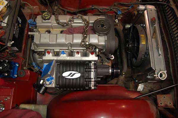

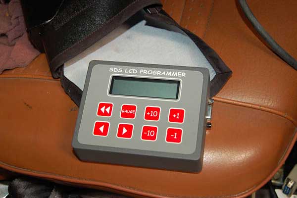

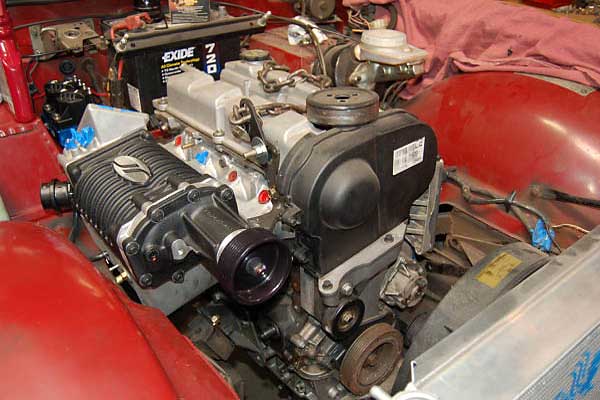

Engine: Ford SVT 2.0L 16v DOHC inline four cylinder engine, plus Jackson / Eaton Rootes-type supercharger, and Simple Digital Systems direct ignition system.

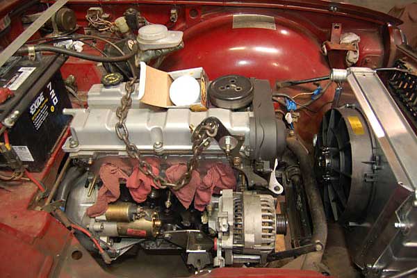

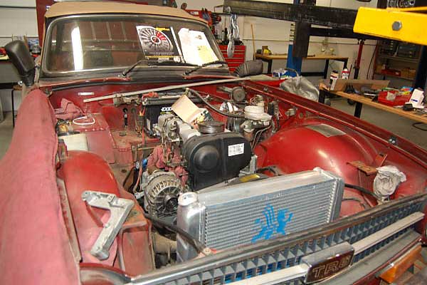

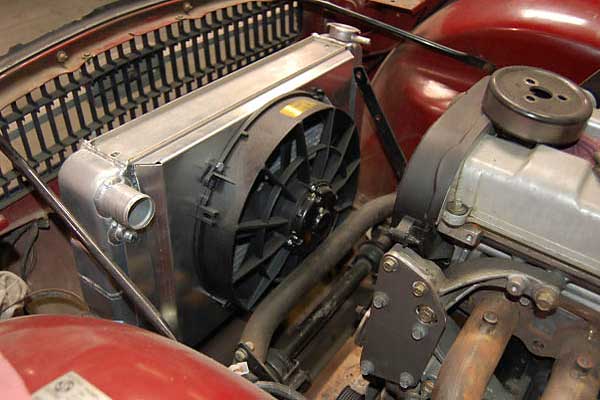

Cooling: Griffin aluminum crossflow radiator, large electric fan, and aluminum sheetmetal fan shroud.

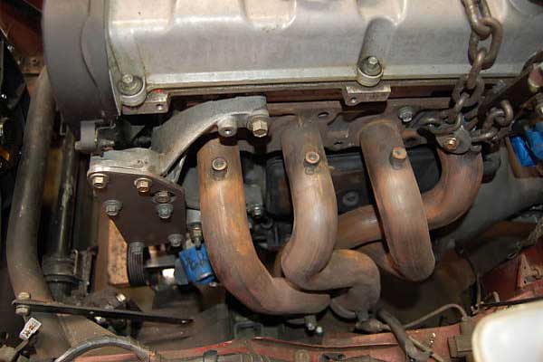

Exhaust: stock SVT header.

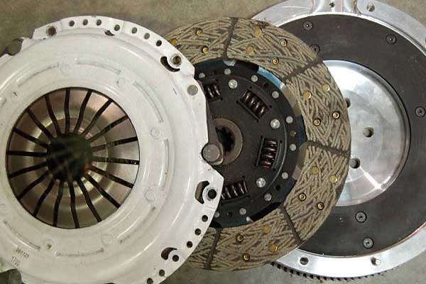

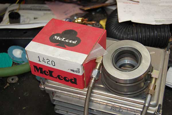

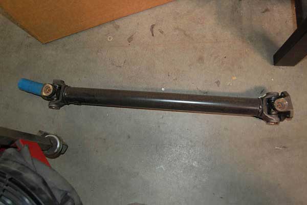

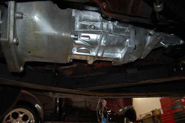

Transmission: Borg-Warner T5 (Ford pattern), rebuilt by Boxes N Gear. Clutch Masters "single mass" clutch system, McLoed hydraulic throw-out bearing. Wenco driveshaft.

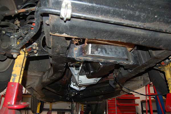

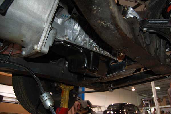

Other Chassis Mods: Minor frame adjustment (visible in the pictures) moving a lateral brace to make room for the new engine's deeper stance.

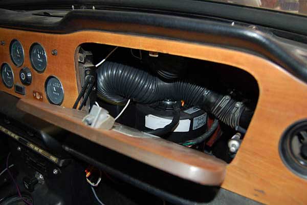

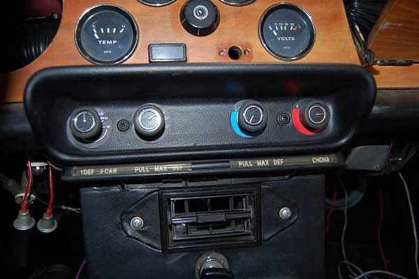

Body/Interior: Replaced all trim panels, carpet, and the plinth. Replaced the four pull levers for heat/blower/choke with rotary air conditioning controls. Vintage Air air condition system.

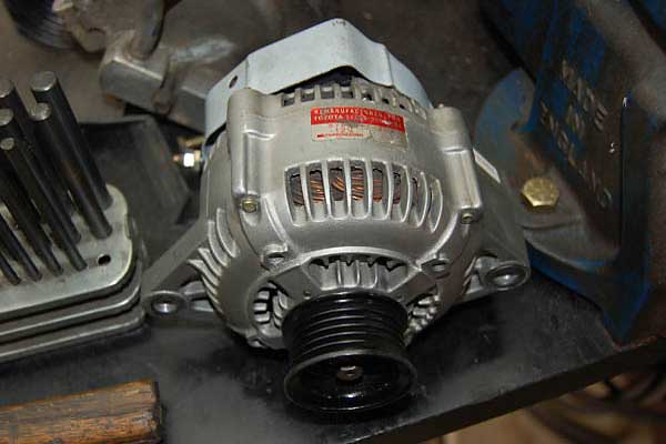

Electrical: Toyota alternator.

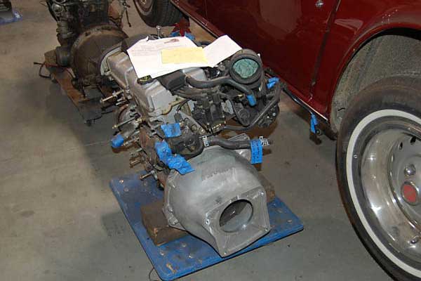

Comments: Engine seemed readily available when we started, but Ford stopped making them available via their "crate motors" program and the car went out of production. A racing series of midget cars had standardized on the engine, which made RWD conversions available for the normally FWD/transversally mounted I4, but it also ate up supply! Thankfully Tri-C located a wrecked low mileage SVT Focus and we had ourselves a donor car.
Supercharged Ford SVT engine
Jackson Racing supercharger

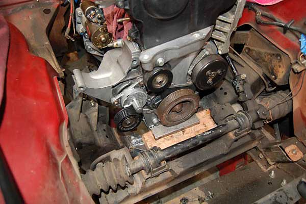

modified front crossmember

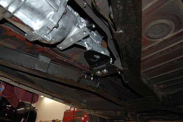

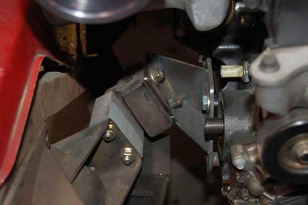

motor mounts

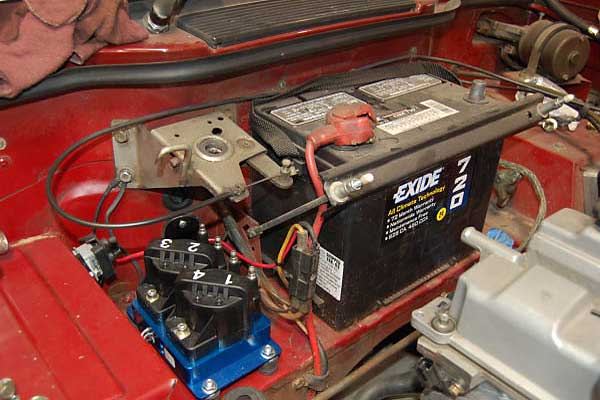

Simple Digital Systems ignition programmer
Simple Digital Systems ignition coil installation
Toyota alternator
Griffin aluminum radiator, great big fan, and aluminum fan shroud
stock SVT header
Clutch Masters single mass clutch system
Borg-Warner T5 five speed
mounting bracket for Borg-Warner T5 transmission
Wenco driveshaft

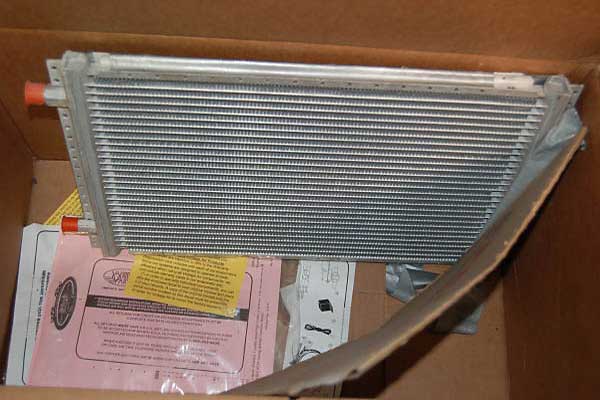

Vintage Air air conditioning condensor

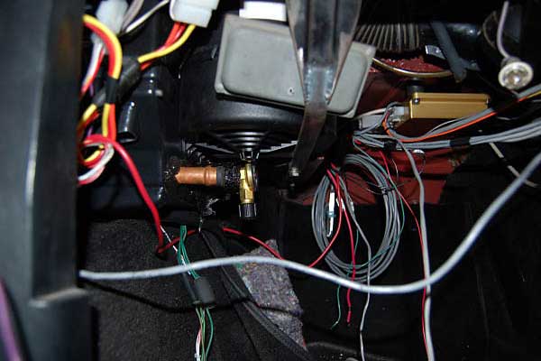

Vintage Air under-dashboard climate unit
Vintage Air air conditioning blower fan

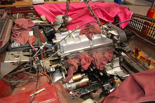

this is how the engine arrived

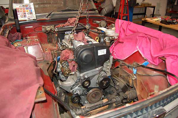

initial installation in the engine bay
assessing clearance to the front crossmember
ready to start fabricating motor mounts
custom front crossmember
planning the cooling system
fitting a fan shroud and electric cooling fan
