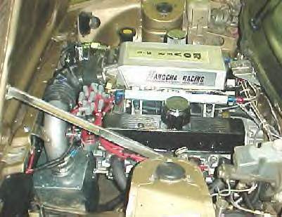

Tim Lanocha's Triumph TR8 with 5.0 LITER Rover V8

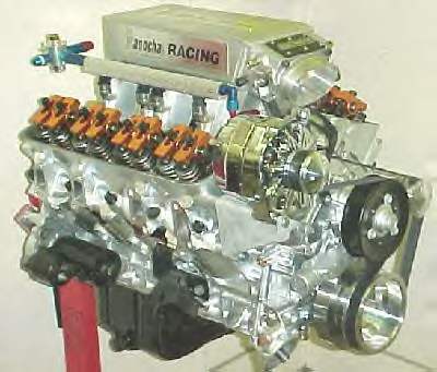

This is not what Buick/Oldsmobile/Pontiac had in mind when they designed this engine back in the '50s, was it? From 215ci to 302ci...

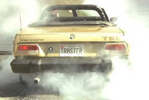

TR8 burn-out
The Rover 4.6 engine has been stroked and bored to 5.0 liter, with 11:1 pistons, Manley rods, ported, polished and flow bench tested heads and a custom sheetmetal intake.
Fuel is controlled by an SDS EM-3D injection, ignition is with an MSD distributor and 6AL.

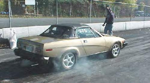

A custom bellhousing as been fitted, with a T56, 6 speed transmission. A custom 4-link 8 3/4" Mopar differential with 3:91 ring and pinion gears handle the massive increase in torque. Quarter mile: 12.568 @ 108!
drag racing TR8

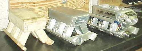

fabricated intake manifolds
