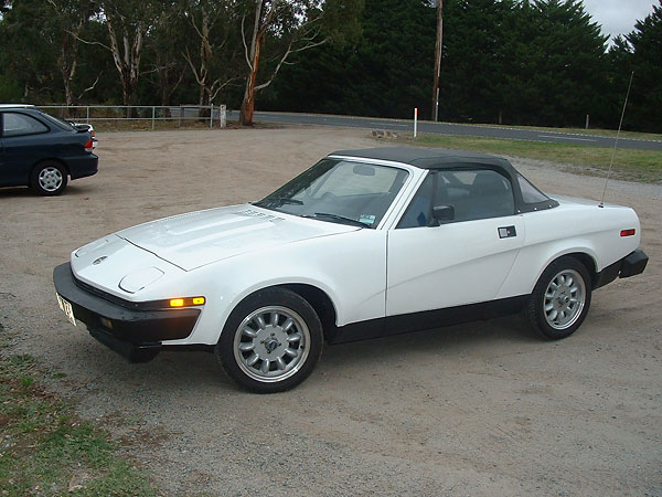

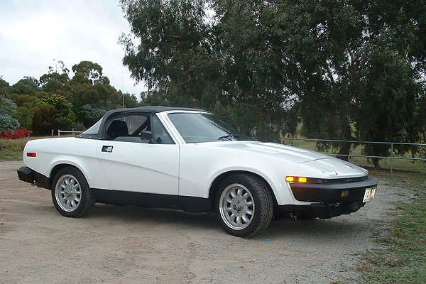

Rodney Wells' 1980 Triumph TR7 with Toyota Soarer 1UZ-FE V8 Engine
Rodney Wells' 1980 Triumph TR7 with Toyota Soarer 1UZ-F V8 Engine
Owner: Rodney Wells
City: Sunbury Victoria Australia
Model: 1980 Triumph TR7
Engine: Toyota 4.0L V8
Conversion by: owner

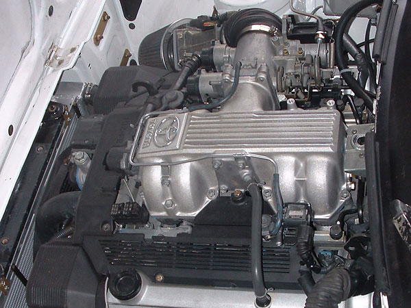

Engine: Toyota Soarer 1UZ-FE 32-valve quad-cam 4.0L V8 engine. Stock Toyota electronic fuel injection. Stock Toyota computerized ignition.

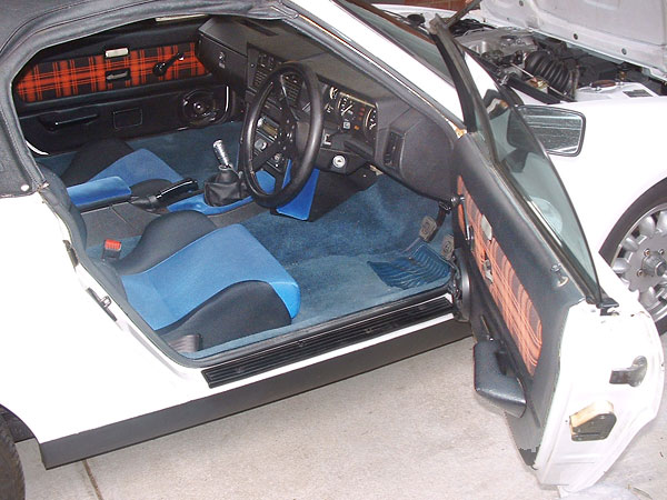

Instruments: stock Triumph TR7.

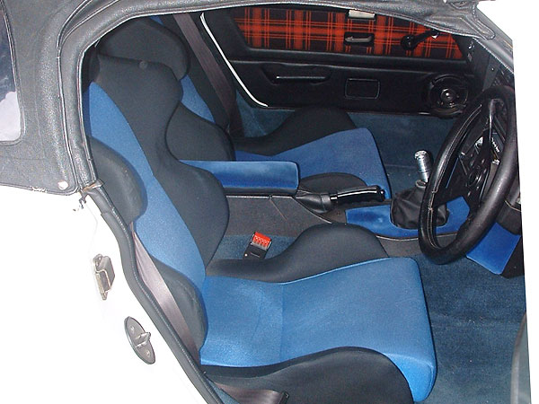

Interior: custom racing seats from Aero Tech.

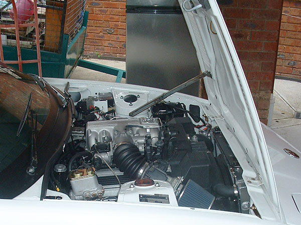

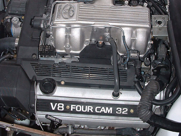

Toyota 1UZ-F 32-valve quad-cam 4.0L V8 engine.
Toyota 1UZ-FE 32-valve quad-cam 4.0L V8 engine.
Toyota 1UZ engines: aluminum engine blocks and heads, steel rods and cranks, hypereutectic pistons, and six-bolt main bearing journals.
Toyota "1UZ" engines have aluminum engine blocks and heads, steel rods and cranks, hypereutectic pistons,
and six-bolt main bearing journals. The cylinder bore is 87.5mm (3.44") and the stroke is 82.5mm (3.25").

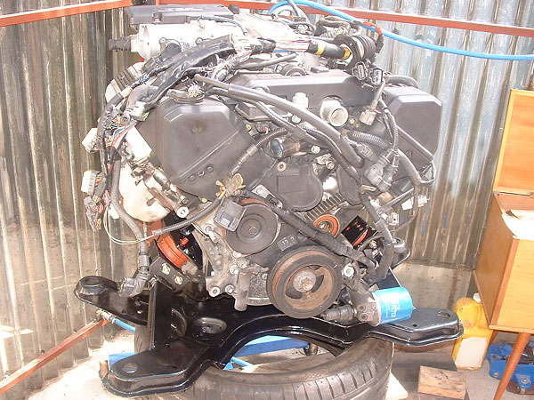

Rodney copied the TR8 subframe design, and added another bracket to support a Range Rover engine mount.

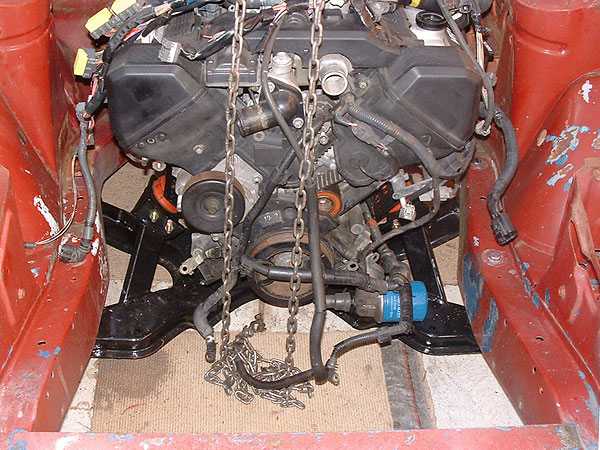

First installation of the Toyota Soarer V8 engine in the Triumph TR7.

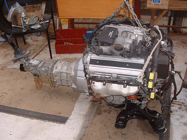

Toyota Supra W58 5-speed with 0.783:1 5th gear.
Toyota electronic fuel injection and ignition systems were used without modification.

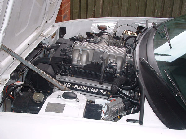

The induction system plenum fits neatly under the Triumph TR7's bonnet.
Stock Toyota Soarer tubular manifolds into custom dual exhaust.
Toyota Soarer tubular exhaust manifolds fit neatly without any alterations.
Aluminum radiator is an off-the-shelf item, made to fit a Nissan Skyline (turbo/R33).
The aluminum radiator is an off-the-shelf item, made to fit a Nissan Skyline (turbo/R33).

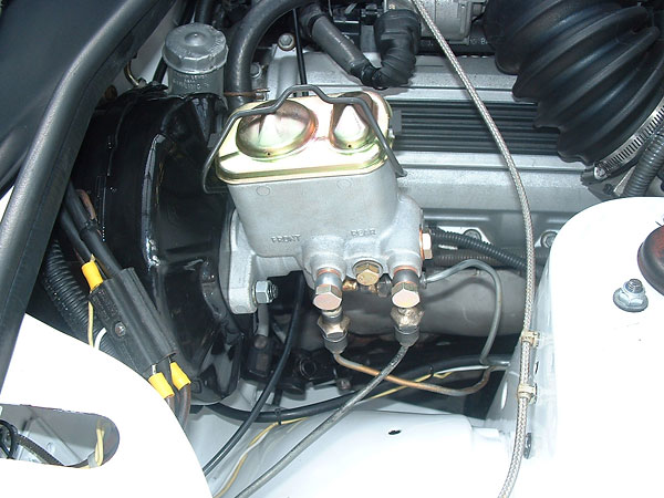

The master cylinder is from an Australian Ford Falcon (1979-81 model). It has an internal proportioning valve.

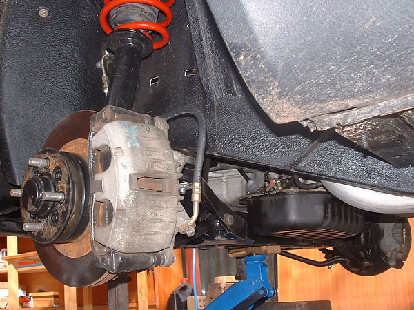

Pontiac GTS calipers. Subaru WRX rotors.

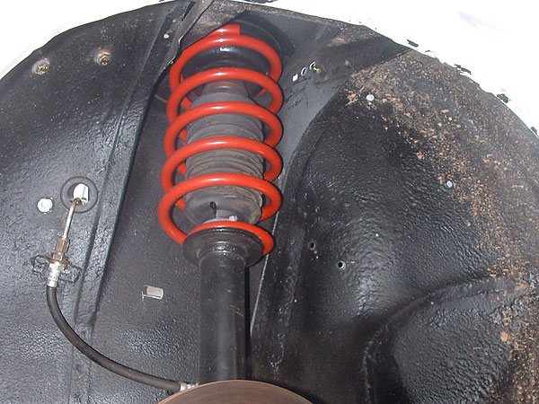

Spax Sport Triumph TR7/8 adjustable gas shock absorbers from Robsport International.
Stock Triumph instruments.
Custom racing seats from Aero Tech of Australia.

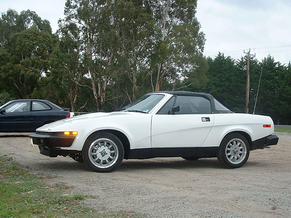

TR7 convertible
white paint

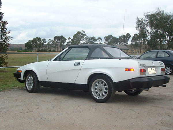

TR8 rear end with 3.08:1 final drive ratio.
