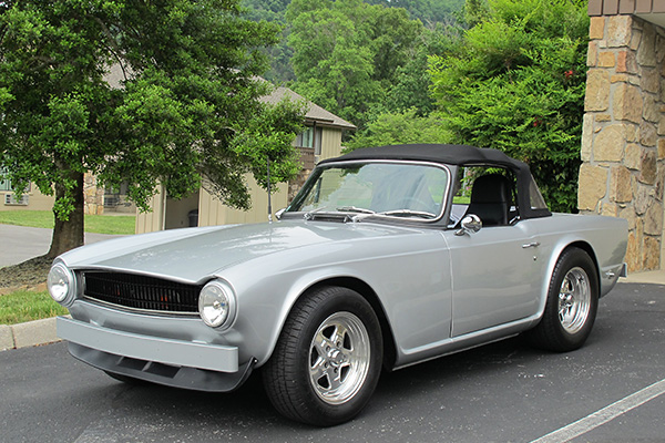

Paul Overbeek's 1972 Triumph TR-6 with Ford 302cid V8 Engine
Owner: Paul Overbeek
BritishV8 UserID: skyrocket65
City: Zeeland, Michigan
Model: 1972 Triumph TR-6
Engine: Ford 302cid V8
Conversion by: owner

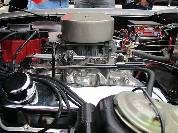

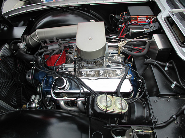

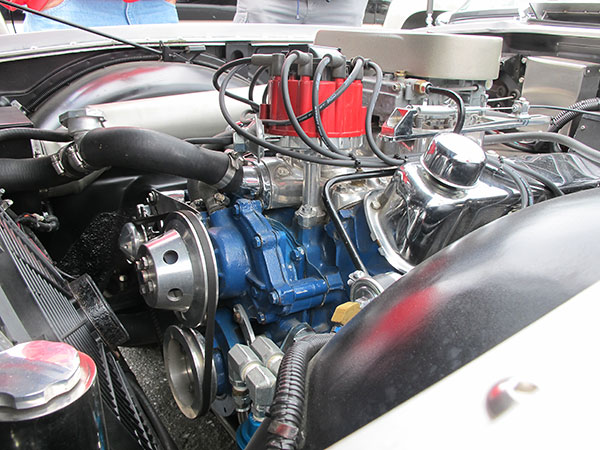

Engine: Ford 302cid V8. Professional Products Typhoon polished intake manifold (part number 54000). Holley 390cfm carburetor (part number 0-8007). Mechanical fuel pump. Speedway Motors HEI-style distributor (part number 910-12350). MSD Street Fire spark plug wires. Billet aluminum pulleys.

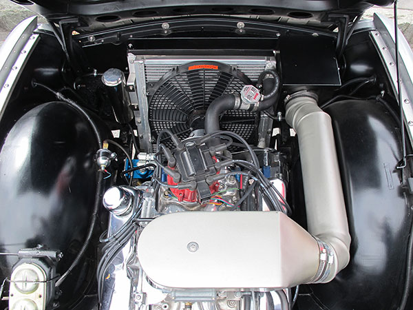

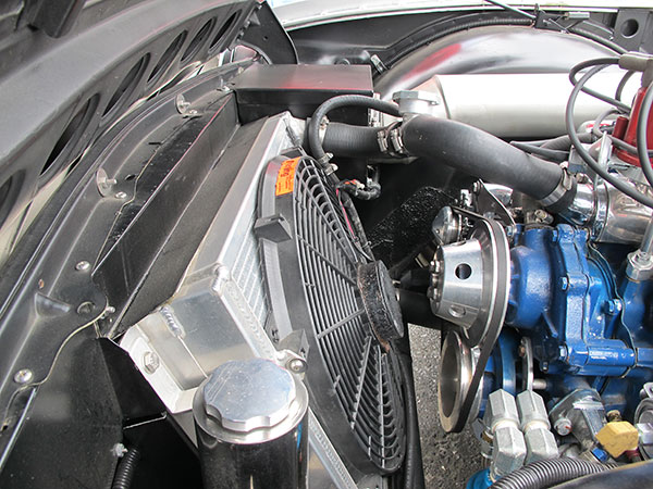

Cooling: Afco crossflow aluminum radiator. 16" electric fan.

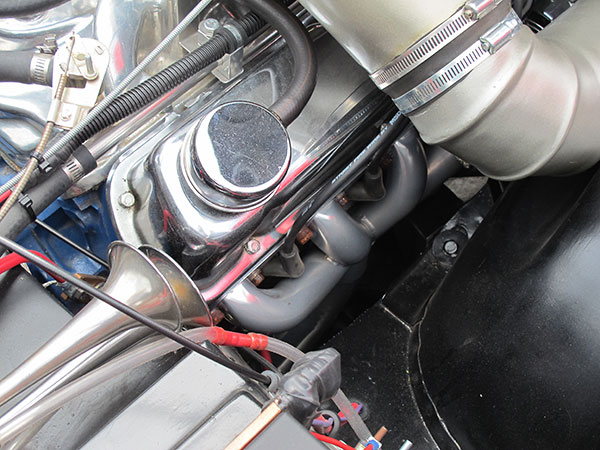

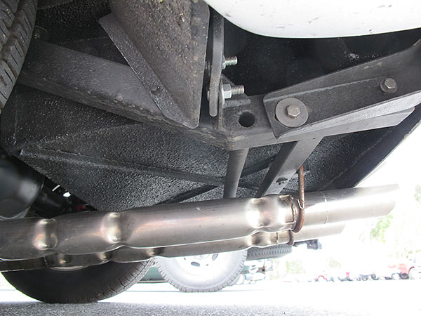

Exhaust: Fast Cars block hugger headers with Jet-Hot ceramic coating. H-pipe. Dual Flowmaster mufflers. Dual Sweet Thunder chambered mufflers. 2.5" stainless steel.

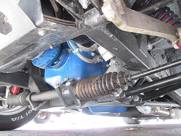

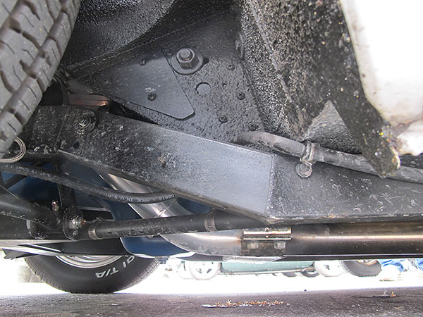

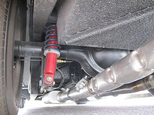

Chassis: new custom tubular frame. Fast Cars, Inc. coilover front suspension with anti-dive. Fast Cars, Inc. coilover 3-link rear suspension. Hyperco springs. QA1 shock absorbers.

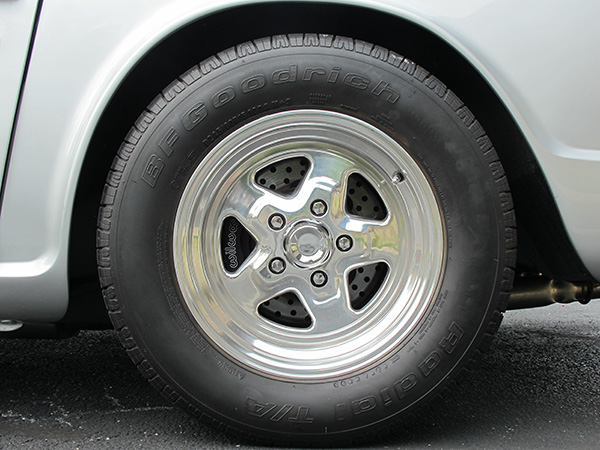

(rear) Wilwood Dynalite 4-pot calipers. Wilwood 11.75" cross-drilled rotors.
Wheels/Tires: Summit Racing Fast Five aluminum wheels. BF Goodrich Radial T/A tires (front 215/60R15, rear 245/60R15.)

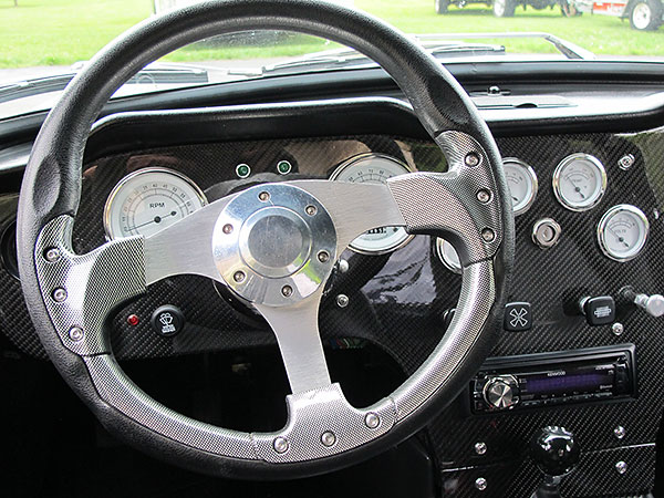

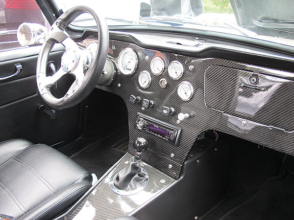

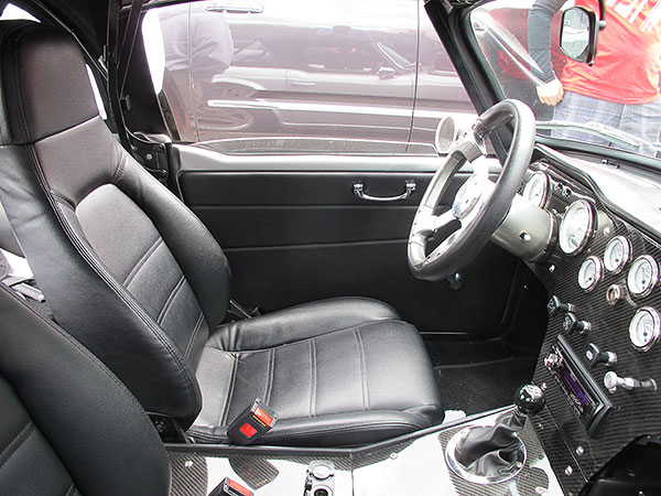

Interior: carbon fiber trimmed dashboard and center console. Black PVC and carbon fiber look universal 12.5", 6-hole steering wheel. Tilting steering column. Kenwood audio system. Mazda Miata seats.

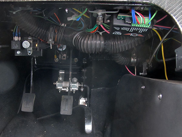

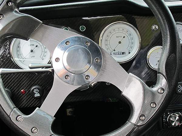

Instruments: Classic Intruments gauges, left to right: tachometer (0-8000rpm), speedometer (0-140mph), fuel level (E-F), oil pressure (0-100psi), coolant temperature (140-280F), and voltmeter (9-18V). Classic Intruments SN74 electronic speedometer signal module.

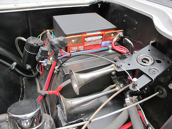

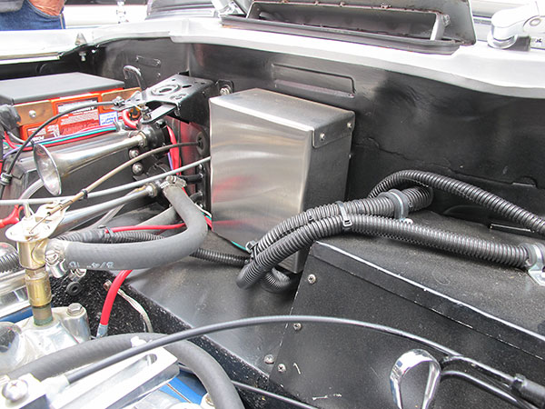

Electrical: Advance Auto Wire wiring harness. Odyssey PC680 drycell battery. Air horn.

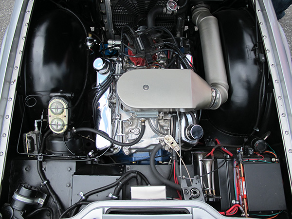

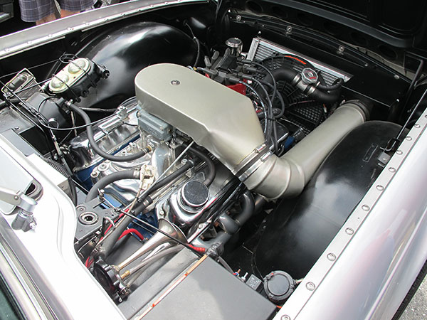

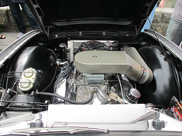

Ford 302cid V8.
Ford 302cid V8.
Corvette style brake master cylinder. Wilwood clutch master cylinder.
Speedway Motors HEI-style distributor. MSD Street Fire spark plug wires.
16 inch electric fan.
16" electric fan.
Custom induction system and remote filter.
Electric components are tucked away inside this tidy box.
Brake vacuum booster plumbed to the engine's intake manifold.

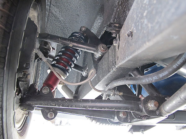

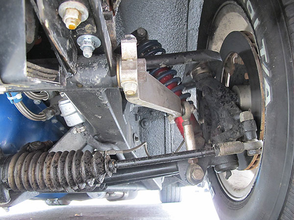

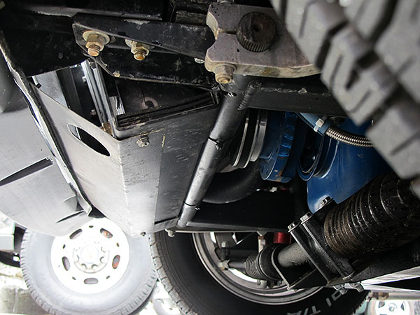

Front Suspension
Splined, modular front anti-sway bar.
Unequal length, non-parallel control arms.

Rear Suspension
New Ford 8 inch housing. (Not cut down.)
New Ford 8" housing. (Not cut down.)
Dual chambered mufflers.
Carbon fiber trimmed dashboard and center console.
Classic Intruments gauges.
Classic Intruments tachometer, speedometer, fuel level, oil pressure
coolant temperature, and voltmeter.
Black PVC and carbon fiber look universal 12.5 inch, 6-hole steering wheel.
Mazda Miata seats.
Mazda Miata seats.

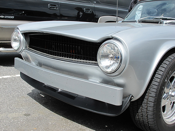

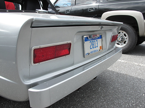

Robust, modern, energy absorbing bumpers. Aftermarket plastic front spoiler.
LED brake lights and turn signals.

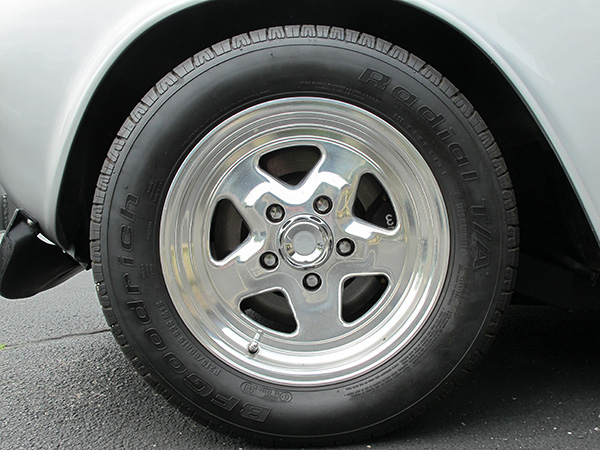

Summit Racing Fast Five wheels are Weld ProStar lookalikes. Recessed lugnuts are the giveaway.
Summit Racing "Fast Five" wheels are Weld ProStar lookalikes. Recessed lugnuts are the giveaway.
