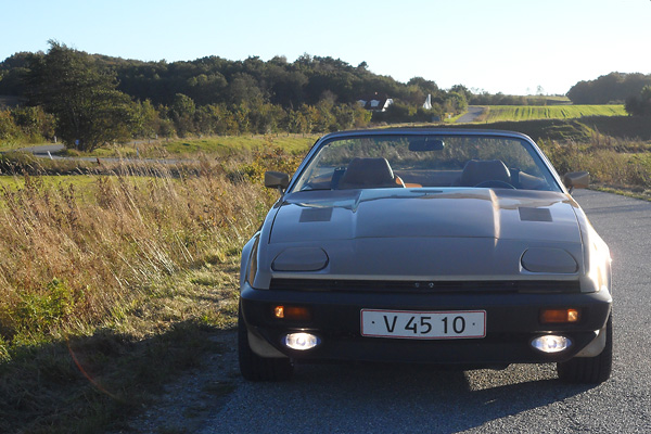

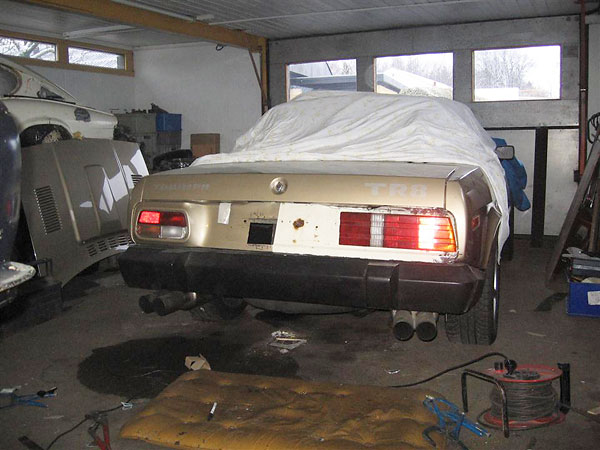

Ole Holm Larsen's 1980 Triumph TR8 with Rotrex supercharged Rover V8 Engine
Ole Larsen's 1980 Triumph TR8 with Rotrex Supercharger and EFI
as published in BritishV8 Magazine, Volume XX Issue 2, December 2012
Owner: Ole Holm Larsen
City: Frederikshavn, Denmark
Model: 1980 Triumph TR8

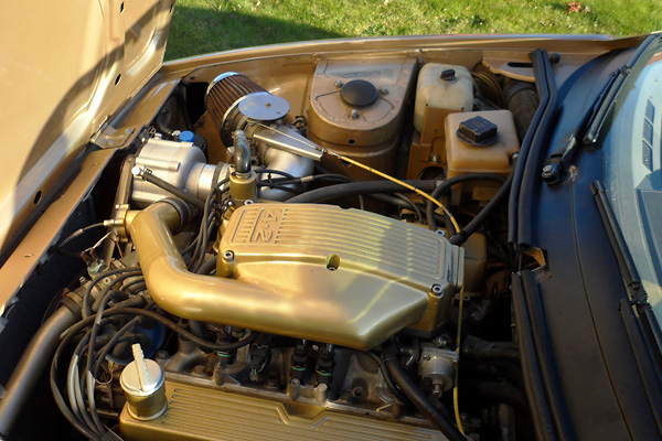

Engine: Rover 3.5L V8 (supercharged & fuel injected)
Conversion by: owner

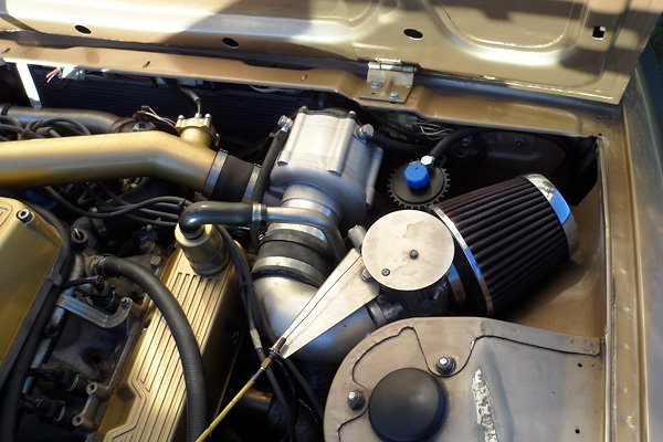

Engine: original 3.5L engine. Original camshaft and valvetrain. Rover 4.2 intake manifold / plenum modified to suit supercharger and to move the throttle butterfly upstream of the compressor. Rotrex C30 supercharger with 70mm pulley. DTAfast P8 Pro engine management system (electronic ignition and fuel injection). Coolingmist methanol injection system.
Cooling: stock radiator and oil cooler.
Exhaust: dual 2.5" system, front to rear.

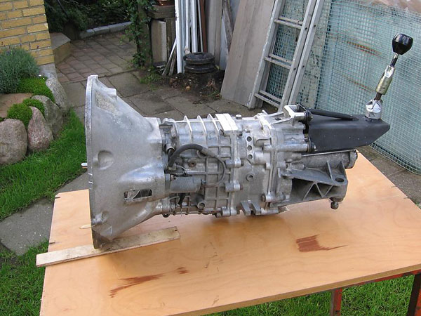

Transmission: Getrag 290 5-speed from a Jaguar XJ40 (4.0L). Jaguar XJ40 clutch and driveshaft.
Rear End: Mercedes with limited slip differential and 3.27:1 final drive ratio. Mercedes halfshafts.
Front Susp.: Front track increased 3". BMW McPherson struts with rear mounted anti-sway bar.

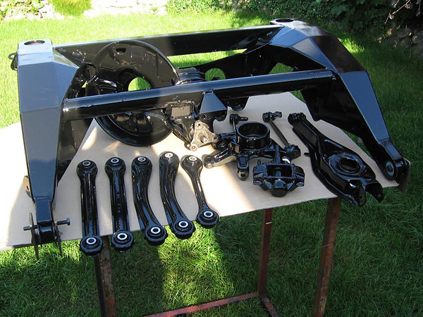

Rear Susp.: Rear track increased 4". Camber set to -1.5 degrees. Multilink IRS from a Mercedes.
Brakes: (master) original Triumph.
(front) 12" disks with original Triumph calipers.

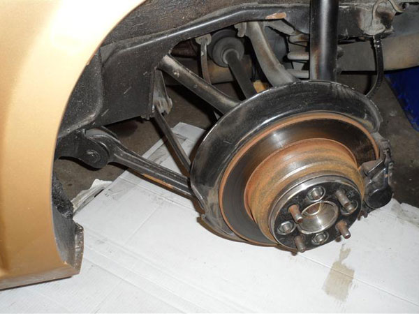

(rear) Mercedes disk brakes.
Wheels/Tires: Borbet 16"x8" aluminum wheels. 225/45R16 tires.

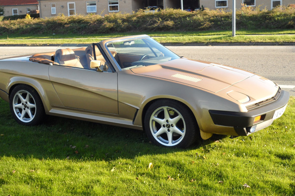

Body: modified for a cleaner, more modern look. Painted "champagne metallic". Rover SD1 tail lamps.
Interior: tan leather interior. Saab 9000 seats.
Performance: 308hp at the wheels.
Weight: 1235kg. (~2725lbs.)
Completed: completed in 2008. Driven approximately 12,000 miles since conversion.
Comments: the added power and upgraded suspension have completely changed the experience of driving the car. My target was a powerful and daily drivable GT car. This certainly has been achieved. Mileage is quite good, and far better than the original carburetor.
Rover 4.2 intake manifold.
Ole's Triumph TR8 has its original 3.5L Rover engine, with a fuel injection type
intake manifold from a later model (4.2L) Rover V8.
Throttle body.
Throttle body.

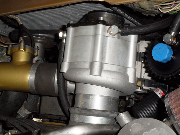

Rotrex supercharger.
This is a Rotrex supercharger. However, since these photos were taken, Ole has actually
upgraded to a Rotrex C30 supercharger with a 70mm pulley for even more boost effect.

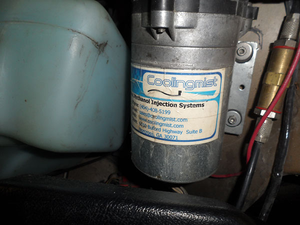

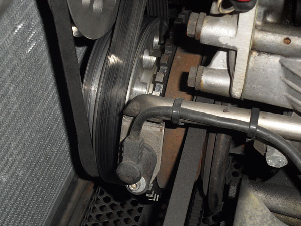

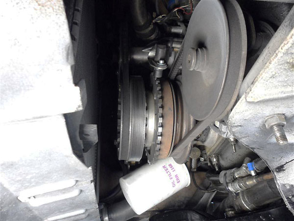

Crankshaft position sensor.

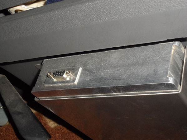

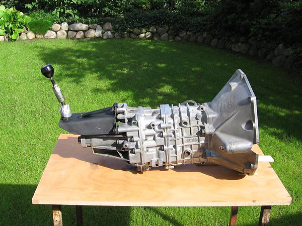

Clutch slave cylinder.

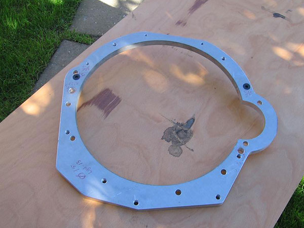

Transmission adapter.

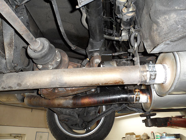

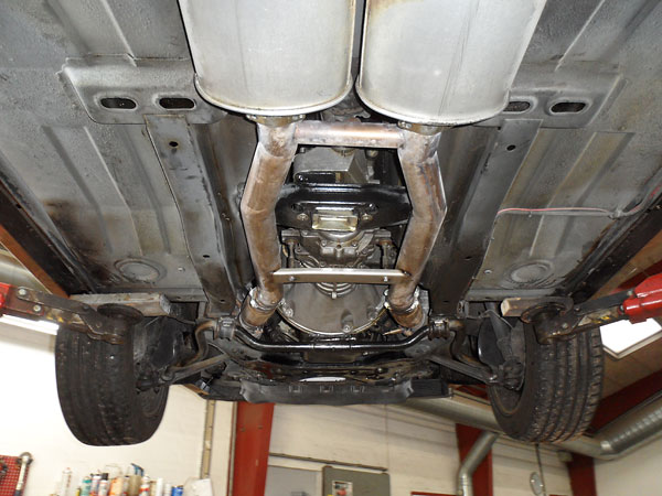

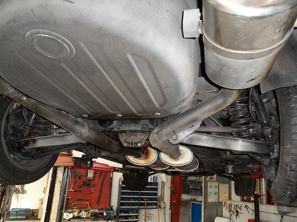

Dual 2.5 inch exhaust system, front to rear.
Dual 2.5" exhaust system, front to rear.

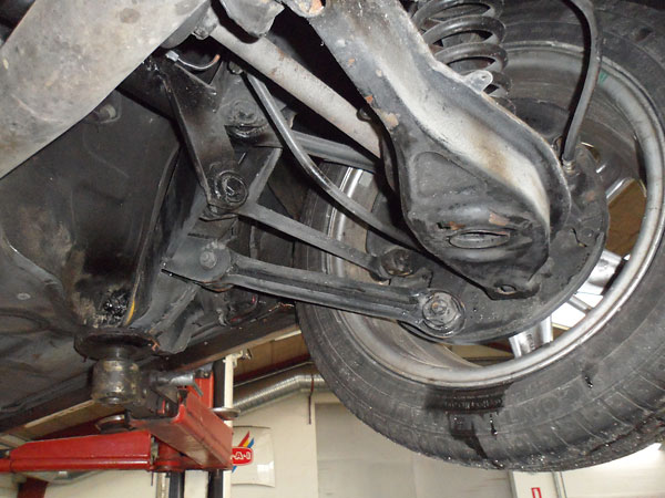

Rear track increased by four inches.

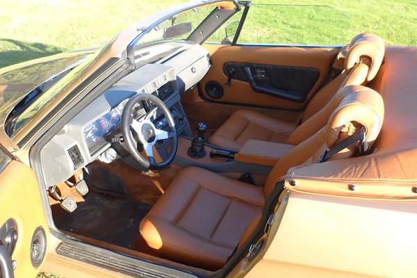

Saab 9000 seats. Interior re-finished in tan leather.

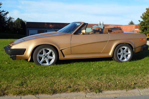

Champagne metallic Triumph TR8.
Borbet 16x8 aluminum wheels with 225/45R16 tires.

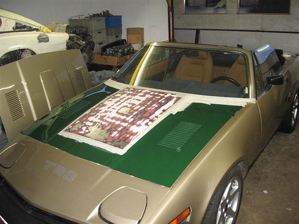

Modifying a Triumph TR8 bonnet to make more room for the EFI plenum.
(Note original TR8 bonnet in background.)
