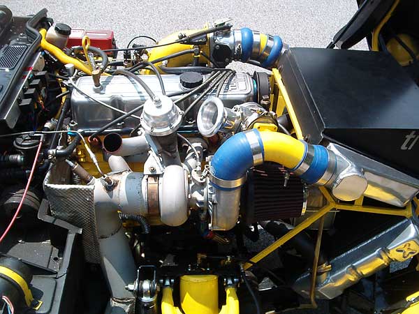

Ford 2.3 Engine with Intercooled Turbo

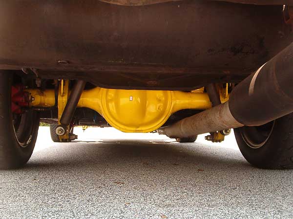

Air ride, with narrowed 9 inch Ford rear axle.
Air ride rear suspension with narrowed 9 inch Ford axle.

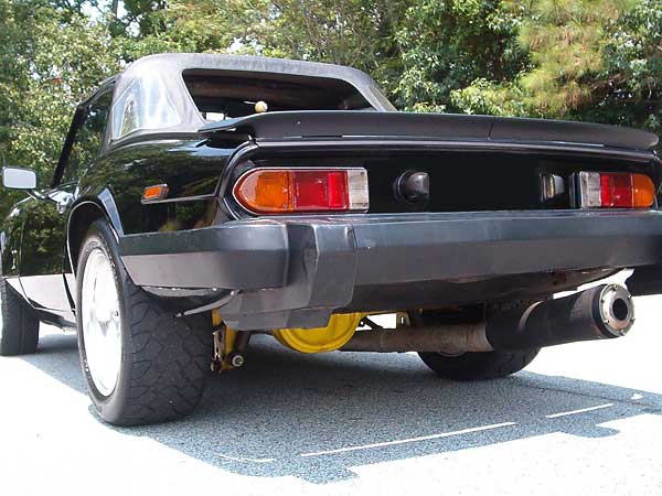

Ford rear spoiler. Supertrapp muffler.

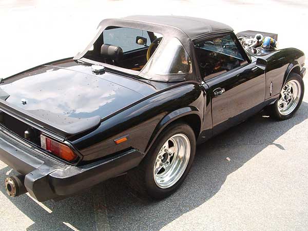

15 Prostar Street and Drag aluminum wheels
15" Prostar "Street and Drag" aluminum wheels.
