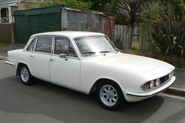

Mike Puke's 1977 Triumph 2500TC Mk2 with Rover 3500 V8 Engine

Owner: Mike Puke
City: Dunedin, New Zealand
Model: 1977 Triumph 2500TC Saloon Mk2
Engine: Rover 3500 V8

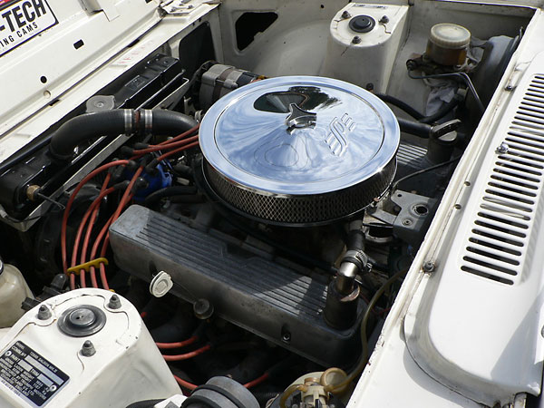

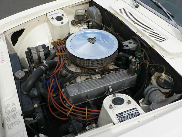

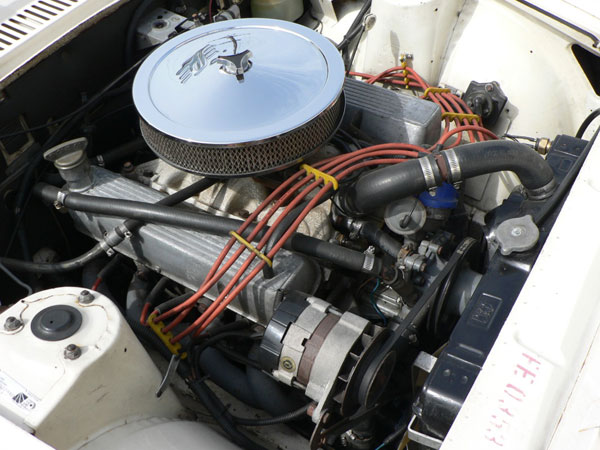

Engine: Rover 3500cc aluminum V8 with Edelbrock intake manifold and Holley 390 carburetor. Electronic ignition. Electric fuel pump. Lucas alternator.
Exhaust: twin 2" exhaust system.
Cooling: twin electric fans.

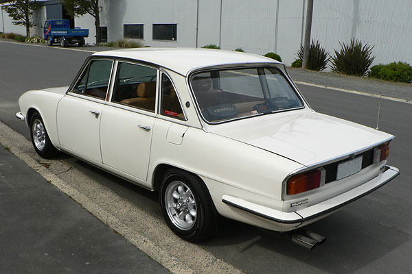

Wheels/Tires: 14x6 Performance aluminum 8-spoke wheels with Bridgestone 185 tires.

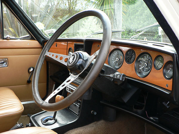

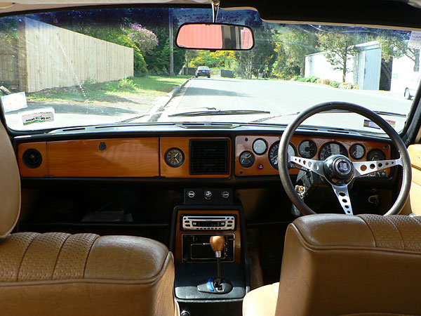

Interior: Triumph "2500 PI" dashboard and gauges (speedometer, tachometer, fuel level, coolant temperture, oil pressure and volts. Note: the "PI" was the premium version of the 2500, which featured fuel injection as well as a different instrumentation package, apparently.)

Triumph 2500PI dashboard and gauges
Kenwood speakers

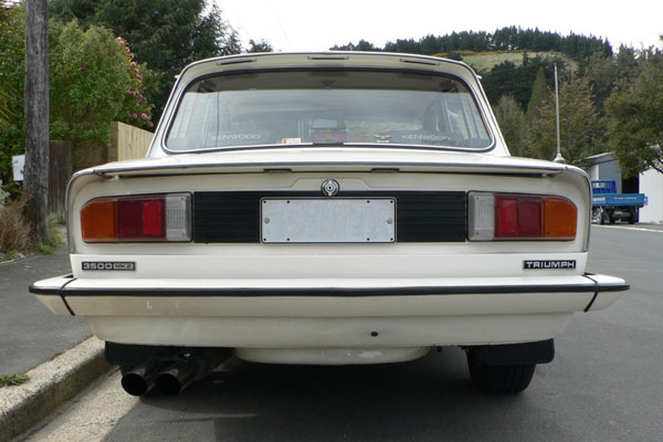

custom rear badge
The custom "3500 Mk2" model designation badge is a very nice touch!
