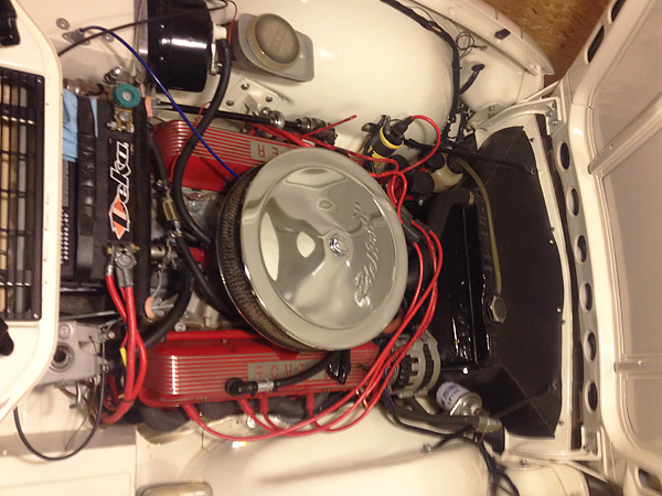

Engine: Rover 3.5L V8 from a Rover P5 saloon. 10.5:1 compression ratio. Fast road camshaft. Edelbrock intake manifold. Edelbrock four barrel carburetor. Edelbrock air cleaner. Lucas distributor with breaker points. Accel ignition coil and spark plug wires. Remote-mounted oil filter.
Cooling: copper and brass radiator. Electric cooling fan, pushing.

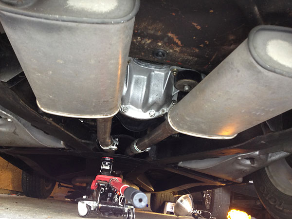

Exhaust: block-hugger headers. Custom piping. Dual turbo mufflers.
Transmission: Rover LT77 5-speed manual (from a Triumph TR-8).
Rear End: 3.90:1 (from a Triumph TR-8).

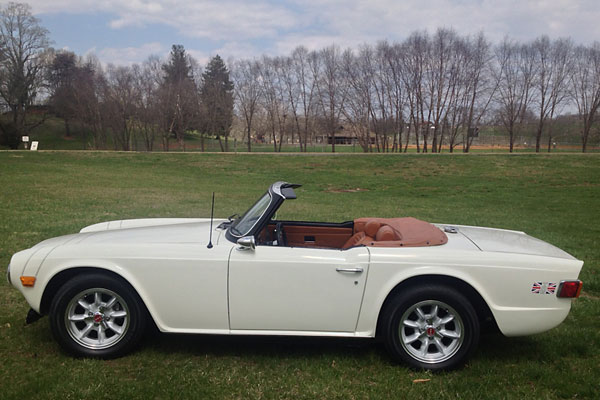

Wheels/Tires: Panasport Racing 8-spoke aluminum wheels. Toyo Proxes H4 tires (205/60R15 90H).
Body: bumpers removed.

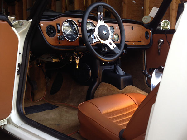

Instruments: stock gauges plus a Sun Pro tachometer.

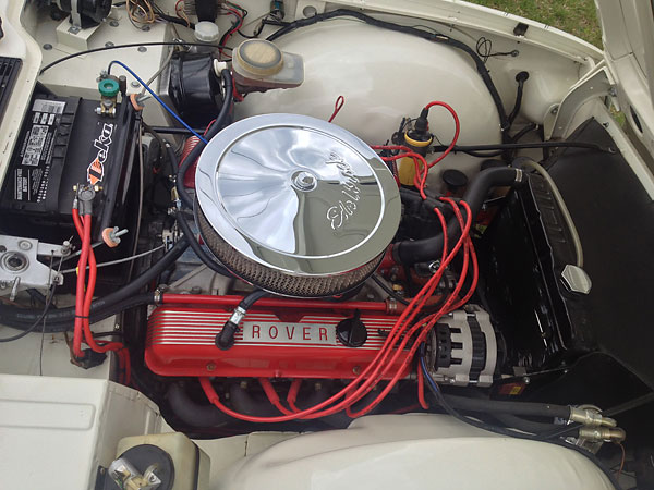

Edelbrock intake manifold, four barrel carburetor, and air cleaner.

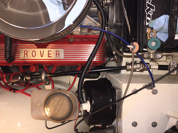

Steering modified to clear exhaust.
Custom exhaust pipes and dual mufflers.

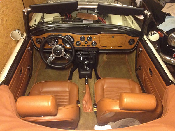

Interior restored to original appearance.
Aftermarket steering wheel.

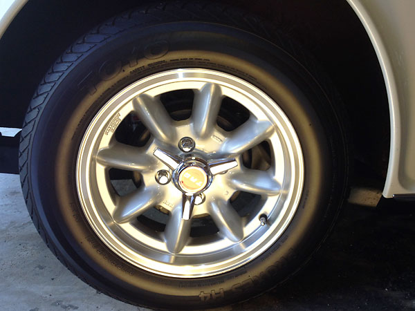

Panasport Racing 8-spoke fifteen inch aluminum wheels.

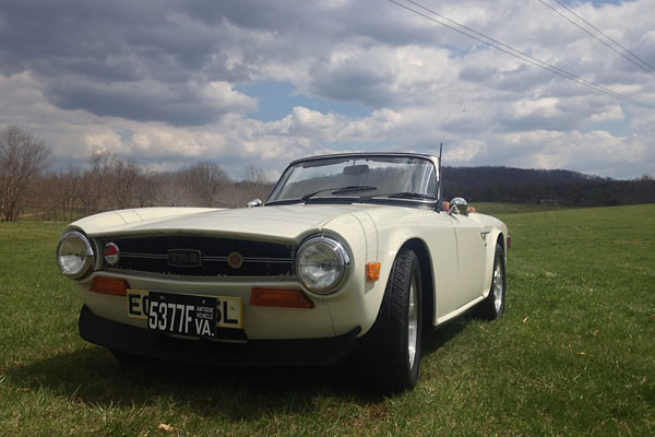

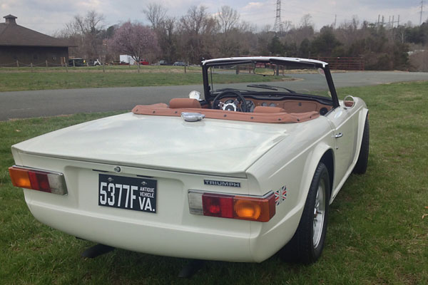

Bumpers removed.
Bumpers removed.
