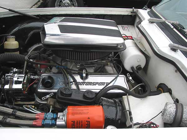

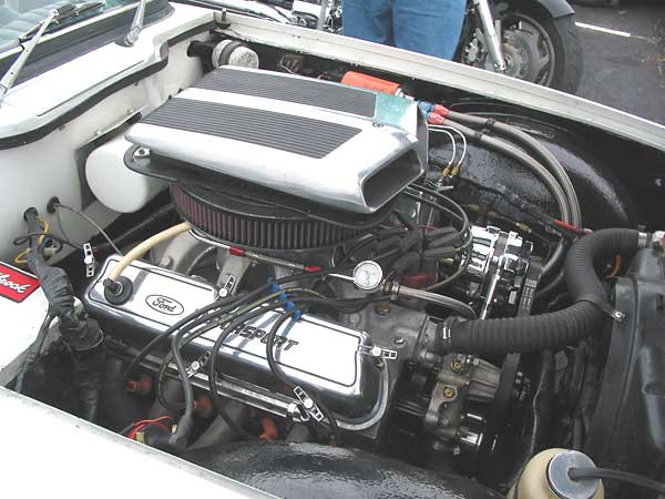

Engine: 1977 Ford 351 Windsor, bored and stroked to 408cid
Intake: Edelbrock Stage 1 High Rise. Holley 750 carburetor.
Cam / Heads: Isky / Edelbrock. The heads have been ported and polished.
Ignition: MSD ignition unit, with a Mallory distributor.
Engine Electrical: Ford one-wire 100 amp alternator, Tilton Super Starter, dual batteries.

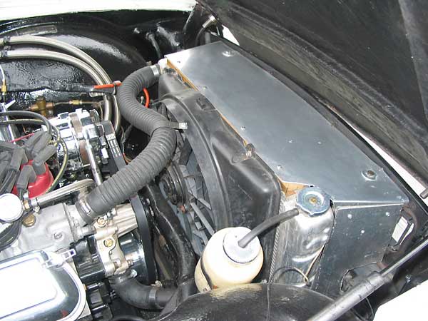

Cooling: Griffin radiator (five row, 1/2" tube) with a 20 Amp electric fan and a fan shroud from a Ford Taurus. Edelbrock aluminum water pump.

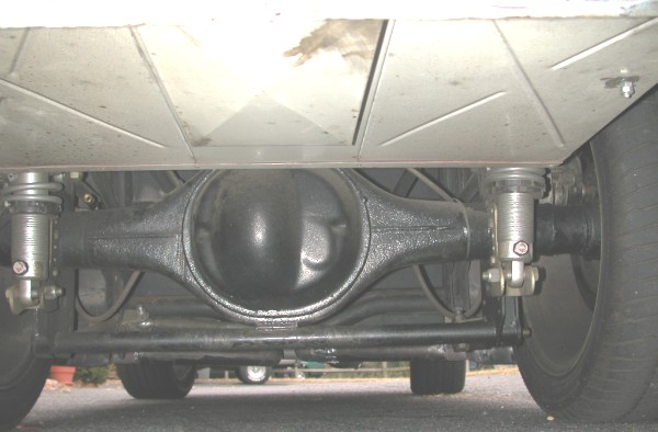

Rear Axle: Ford nine inch, Strange axles, limited slip differential, 3.50:1 gears.
F. Suspension: Mustang coil-overs.

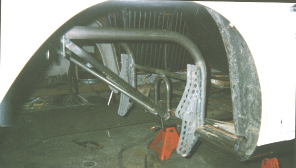

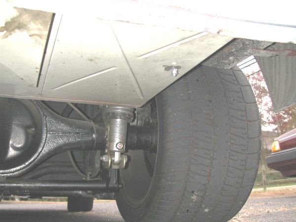

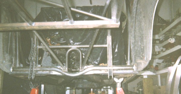

R. Suspension: Completely custom four link suspension, mated to a custom tube-frame (back half).

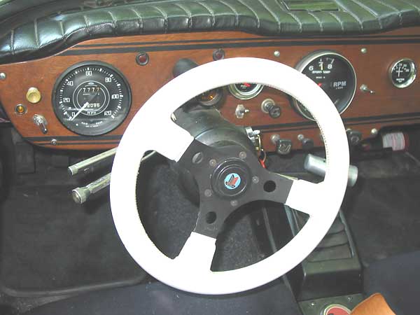

Interior: Autometer gauges, custom dashboard, custom upholstery, tilt steering wheel from a Ford LTD. Sparco seats (a little hard to get in and out of, but once in they hold the occupants snugly and comfortably.)

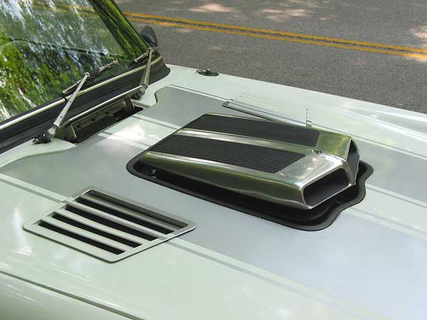

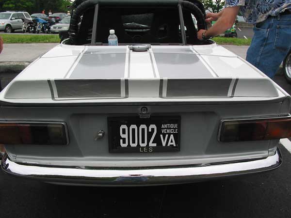

Body: For the most part the body is stock, but the rear fenders and the hood are fiberglass, with a scoop in the hood. The trunk compartment has been totally revised, and now contains the fuel cell and dual batteries. The front bumper has been replaced with "bumperettes" made from TR6 rear bumper bars. A rear spoiler has been added.

Comments: Heat is a still problem on hot days, although Jet Hot coating the exhaust helped. The 4-link rear suspension setup is a marked improvement over the stock IRS.

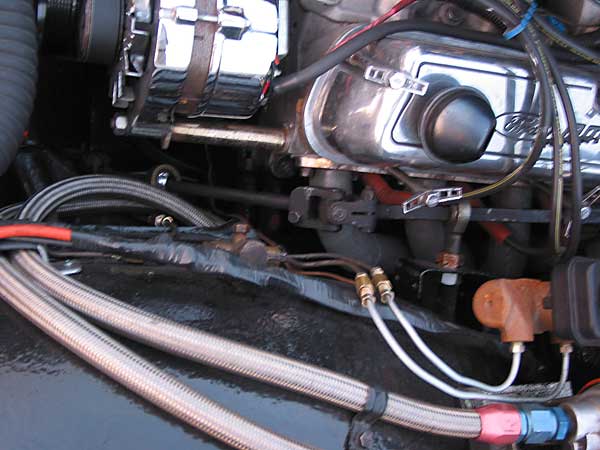

Ford 351 Windsor

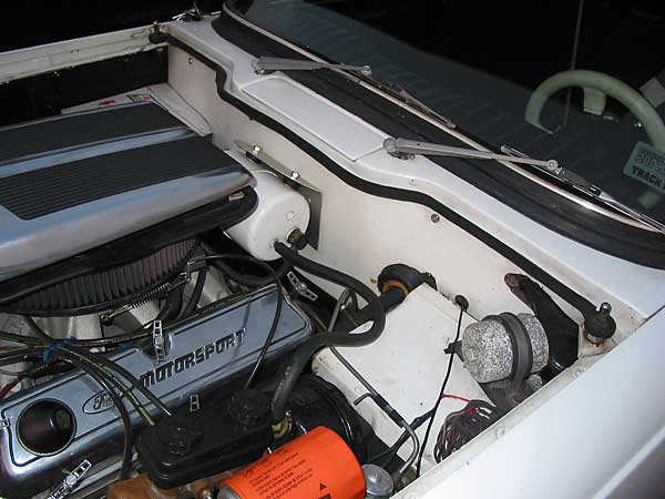

firewall
A firewall liner provides extra insulation. A vacuum reservoir keeps the power brakes working well.
Ford 351 Windsor
steering linkage
TR6 cooling system with Griffin radiator

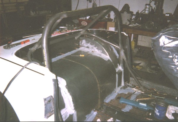

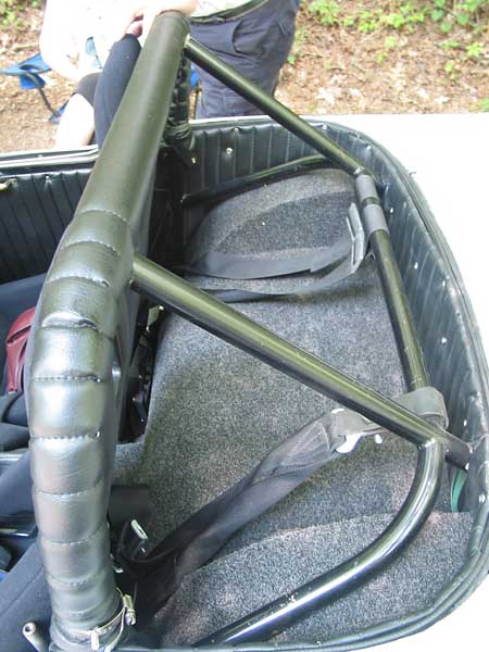

TR6 roll cage
TR6 roll cage main hoop

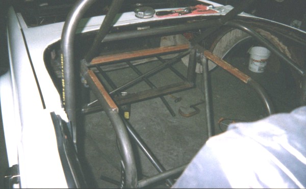

TR6 tube frame with adjustable suspension link points
TR6 tube frame - driveshaft hoop
TR6 with Ford nine inch axle
TR6 with four link rear suspension

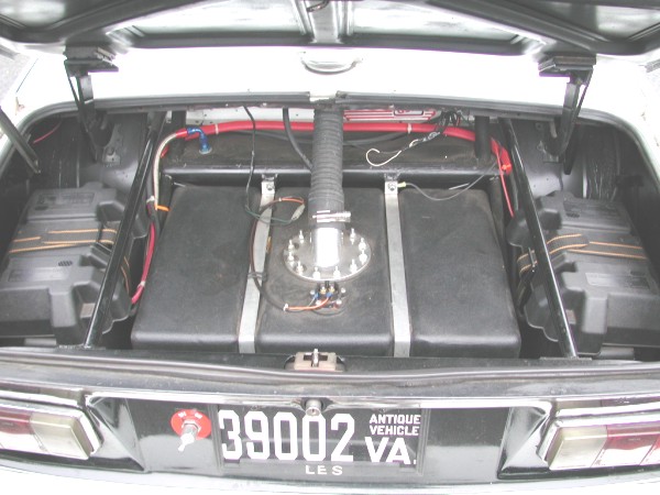

TR6 with fuel cell and trunk mounted battery boxes
TR6 dashboard
TR6 safety harnesses

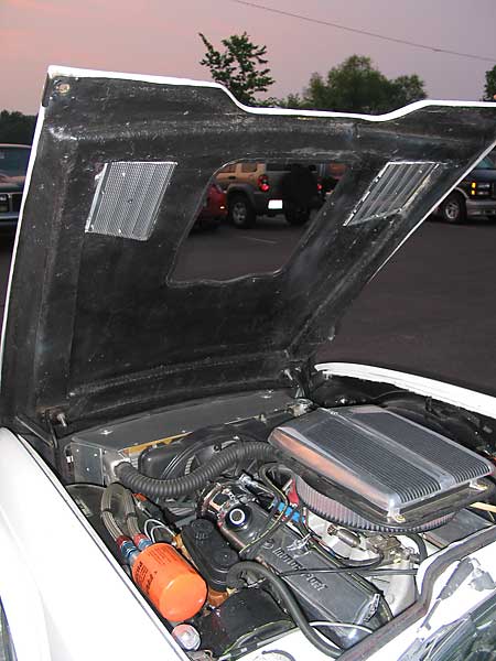

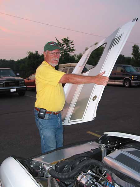

lightweight fiberglass hood
Les built his own lightweight fiberglass hood. It only weighs about fifteen pounds!

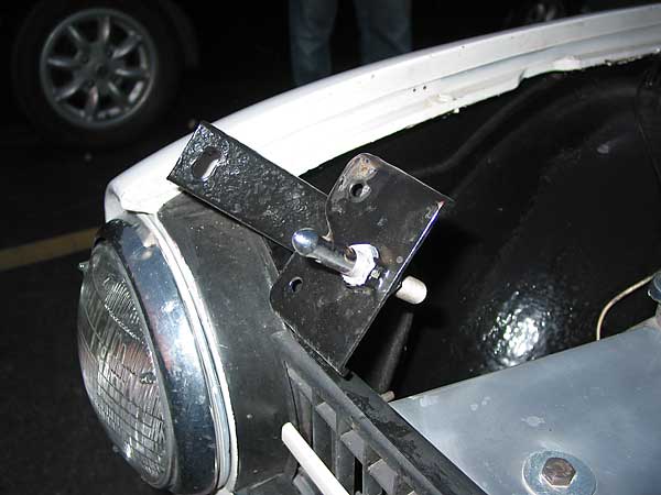

hood pins hold down the lightweight fiberglass hood
The hood hinges up, or can be lifted off and moved aside for better engine access.
modified hood hinge
