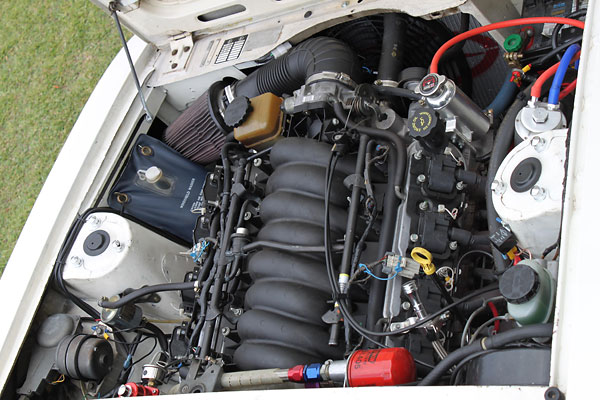

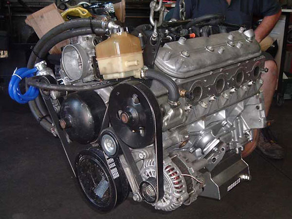

Engine: Chevrolet LS1 5.7L with electronic fuel injection. Stock intake manifold, plenum, and throttle body. Reprogrammed PCM, which accomodates "MAFless tuning". (The LS1's mass airflow sensor has been removed and airflow is instead estimated based on manifold absolute pressure, engine speed, and throttle position.) K&N oiled gauze air filter. Aeromotive adjustable fuel pressure regulator. Moroso reverse-pickup fabricated aluminum oil sump. Remote mounted oil filter (Baldwin Filters B1405).
Cooling: custom PWR aluminum radiator. 16" Zirgo fan, thermostatically controlled.

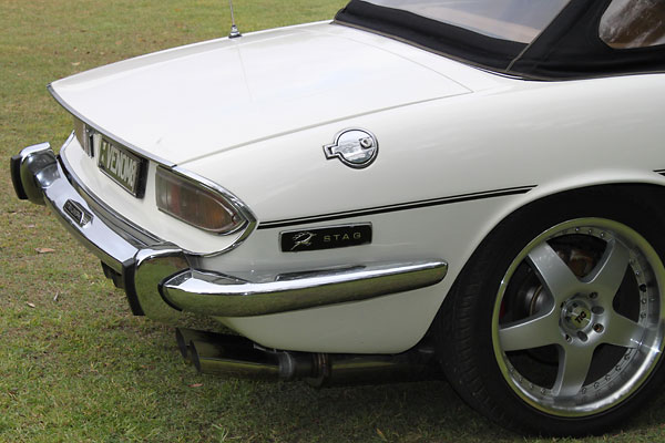

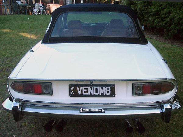

Exhaust: custom four-into-one headers. Dual MagnaFlow dual-outlet stainless steel mufflers. Four rear outlet 2.5" exhaust system.

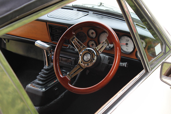

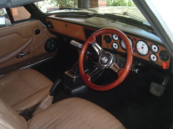

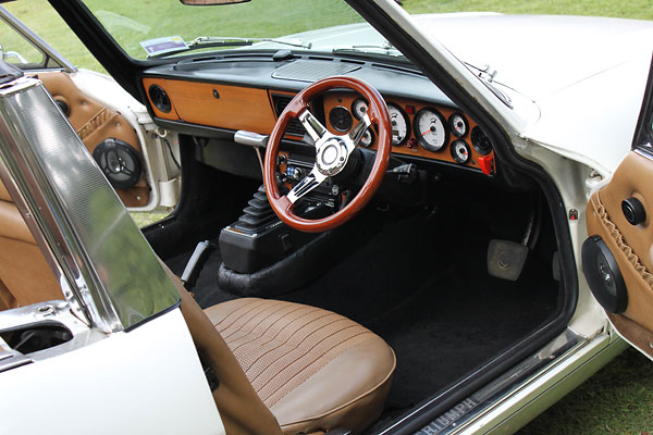

Instruments: Speedhut "Legacy" white dial voltsmeter, coolant temperature, oil pressure, fuel level, GPS speedometer, and tachometer gauges. Shift light.
Interior: mostly stock. Alpine stereo system.

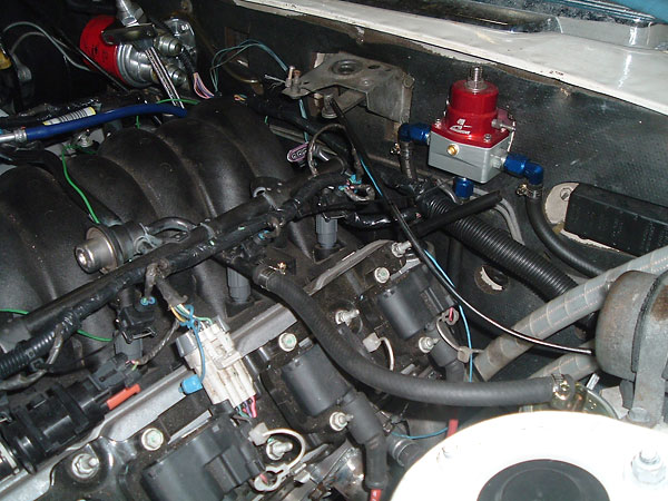

MAFless fuel injection.

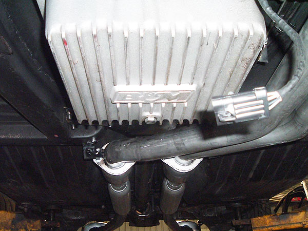

Upgraded Turbo 700 (TH700R4) 4-speed automatic, with B&M deep sump.

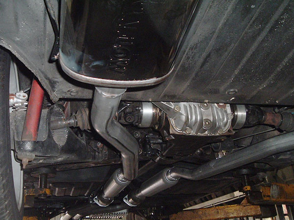

BMW 8 bolt with limited slip differential, 3.7:1 ring and pinion, and Datsun drive shafts.
BMW 8 bolt with limited slip differential and 3.7:1 ring and pinion. New Datsun drive shafts and KONI shocks
were added after this photo was taken. Foreground: dual MagnaFlow dual-outlet stainless steel mufflers.
B&M Mega Shifter.
B&M Mega Shifter.
Speedhut Legacy white dial instruments.
Speedhut "Legacy" white dial instruments.
Mostly stock interior, but with Alpine stereo system.

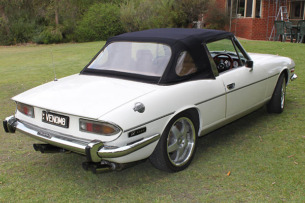

Triumph Stag's came with a distinctive T-bar rollover structure.
Venom8
Venom8

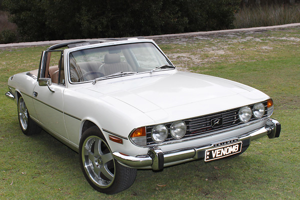

Kingsley Dunstan's Triumph Stag is only slightly lowered from stock.
TIG 17x7 aluminum wheels.
Maxxis MA-V1 P205/45R17 tires.
Four rear outlet 2.5 inch exhaust system.
