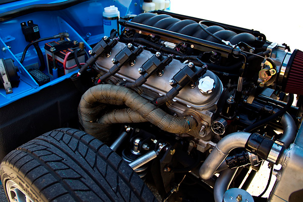

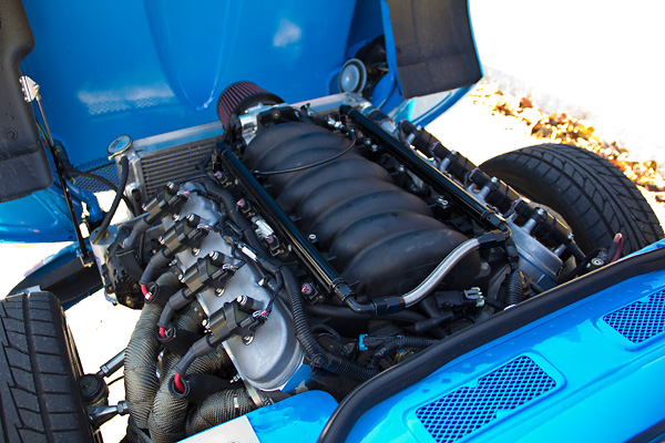

Engine: General Motors Ls1 all aluminum V8 from a 2001 Pontiac Trans Am. Upgraded oil pump. Upgraded timing set. Lingenfelter GT 2-3 camshaft. Stock Ls1 cylinder heads. Stock Ls6 intake manifold. Ported throttle body. Summit Racing fuel rails. Stock Ls1 wiring harness. Ls2 ignition coils. Summit Racing underdrive crankshaft pulley.
Exhaust: custom stainless steel headers. Sweet Thunder chambered mufflers. Dynomax mufflers.
Cooling: Griffin Scirocco-style aluminum radiator. Twin electric fans, pushing. Meziere electric water pump.

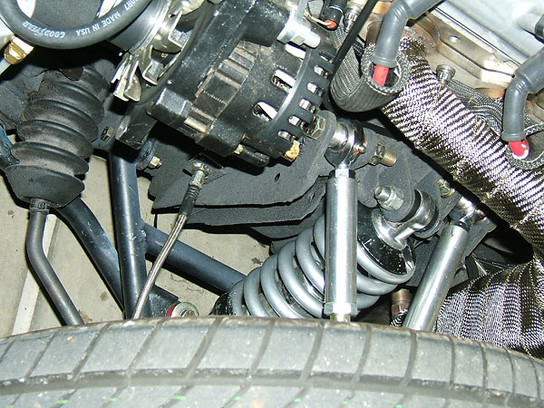

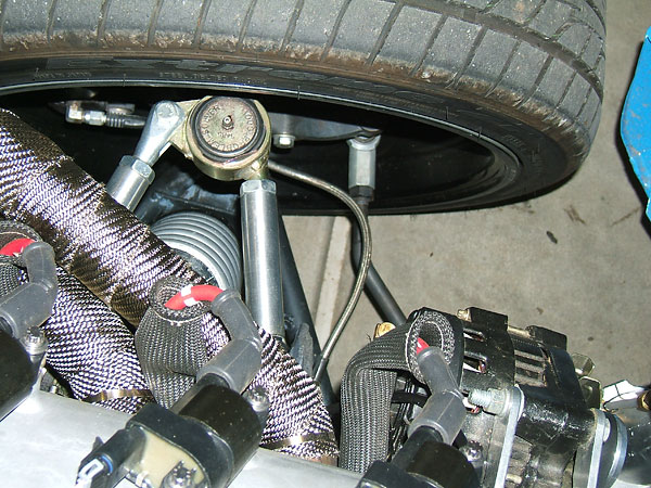

Front Susp.: custom fabricated A-arms. Wilwood Pro Spindles. QA1 Promastar single adjustable coilover shock absorbers. Addco 1" anti-sway bar. Narrowed Triumph steering rack, modified to accept screw-in tie rods. Custom steering linkage. (Two Flaming River steering universal joints with a piece of double-D steering shaft between.)

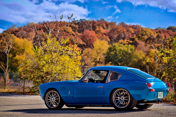

Wheels/Tires: Enkei GTC 01 17" wheels. Nitto NT555 tires (205/40-17 front, 275/40-17 rear.)

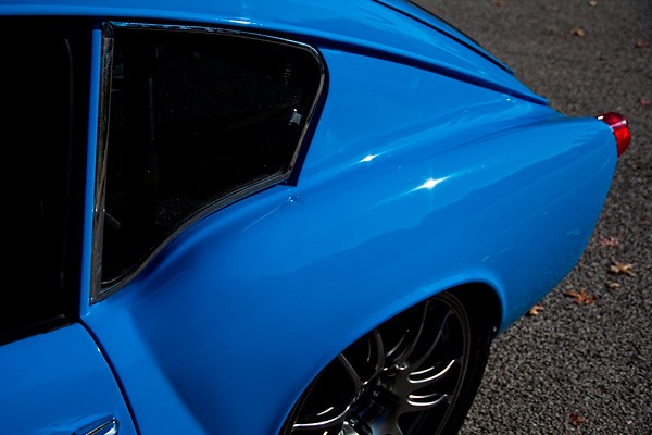

Body: de-bumpered. De-seamed. Vent panels and fuel door holes filled. Custom black wire mesh grille. Ford "Grabber Blue" basecoat/clearcoat paint, applied by Roger Ferris of Showcar Specialist in St. Louis. Original badges removed; likenesses of them appear in silver, under the clear coat.

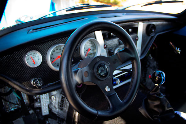

Interior: custom carbonfiber dashboad insert. AutoMeter Ultralite instruments. Grant GT 12" steering wheel. Original Triumph seats, reupholstered with light blue accent stitching. Five point safety harnesses. Custom chromoly 6-point rollcage.
Custom stainless steel headers.
Front Suspension
Wilwood Pro Spindles and custom fabricated A-arms.
Powermaster mini alternator. QA1 Promastar single adjustable coilover shock absorbers.

Grant GT steering wheel. AutoMeter Ultralite instruments.
Grant GT 12" steering wheel. AutoMeter Ultralite instruments.

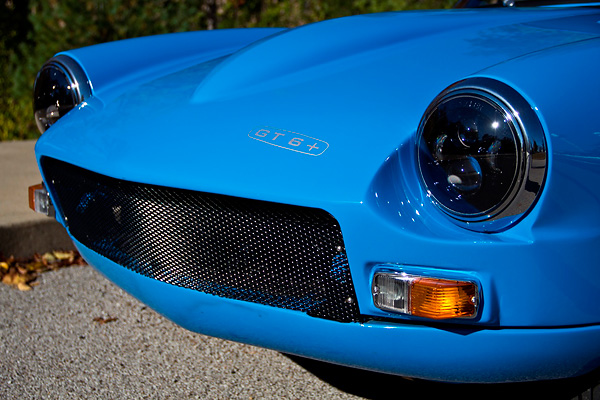

JW Speaker LED headlamps. Custom black wire mesh grille.
Enkei GTC 01 wheels. Nitto NT555 tires (205/40-17 front, 275/40-17 rear.)
Smoothed rear quarter panels.
