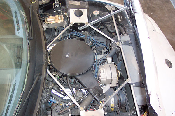

Engine: 1981 Buick 231cid (3.8L) V6, completely stock except for the addition of an MSD ignition controller.
Cooling: custom radiator. Oil cooler.

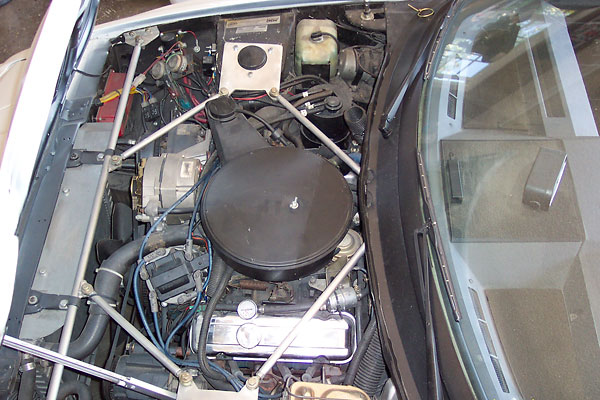

1981 Buick 231cid (3.8L) V6, completely stock except the addition of an MSD ignition controller.
This 1981 Buick 231cid (3.8L) V6 is stock except for the addition of an MSD ignition controller.
John fabricated the strut tower braces.

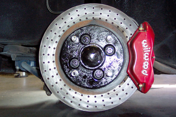

Wilwood 4-piston calipers and 11 inch vented rotors.
Wilwood 4-piston calipers and 11" vented rotors.

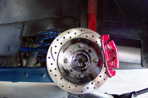

Stainless Steel Brake Co. calipers and 10.25 inch vented rotors.
Stainless Steel Brake Co. calipers and 10.25" vented rotors.

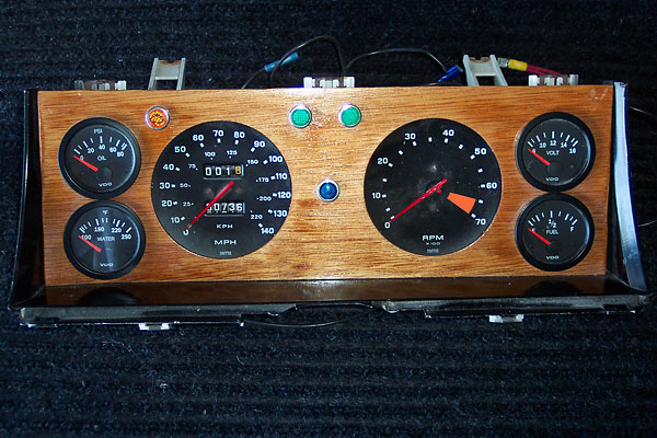

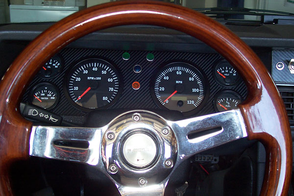

Custom instrument cluster featuring VDO gauges.

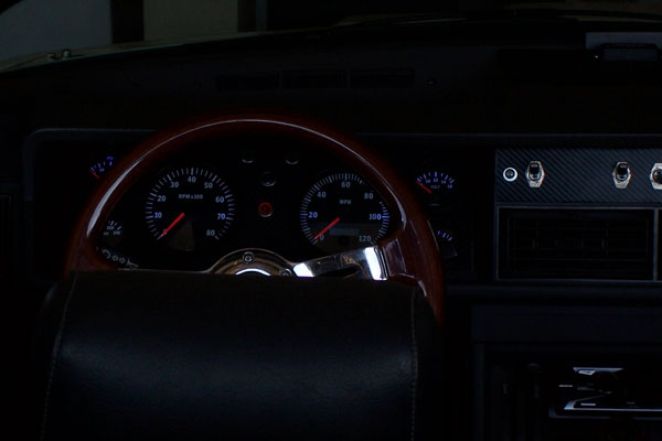

Illumination.
Illumination.

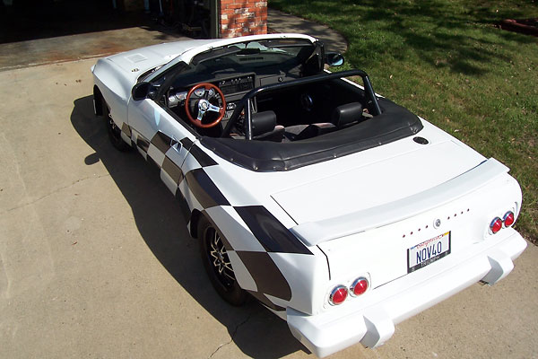

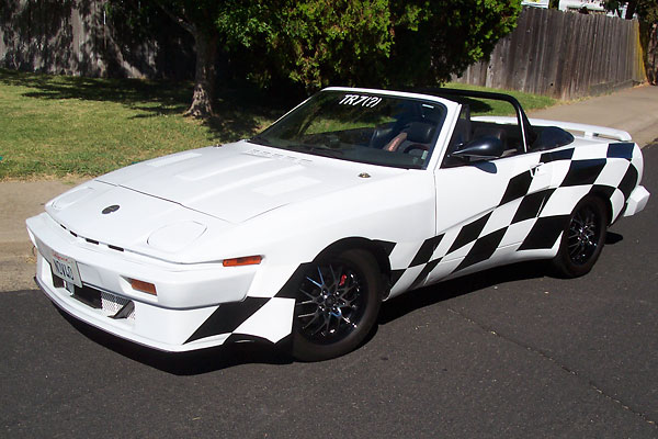

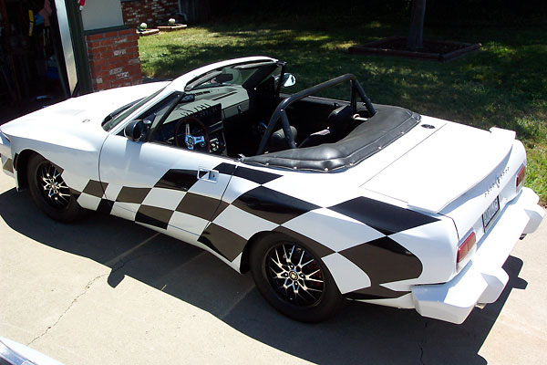

Huffaker Engineering fiberglass body panels give this Triumph TR7 a distinctive look.
Authentic Huffaker Engineering fiberglass body panels give this Triumph TR7 a distinctive look.
John says: "She is good looking, fun to drive and she does turn heads!"
Triumph TR7 convertible top.
A roll hoop has been installed. It fits neatly under the Triumph TR7's convertible top.

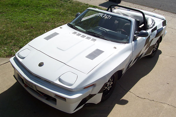

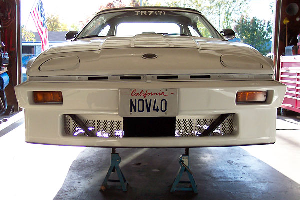

Huffaker Triumph TR7/TR8 air dam.

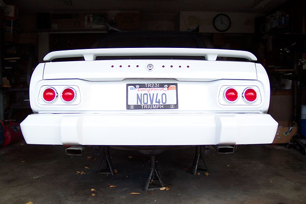

LED brake lights and third brake light(s).

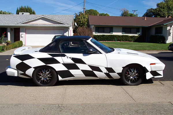

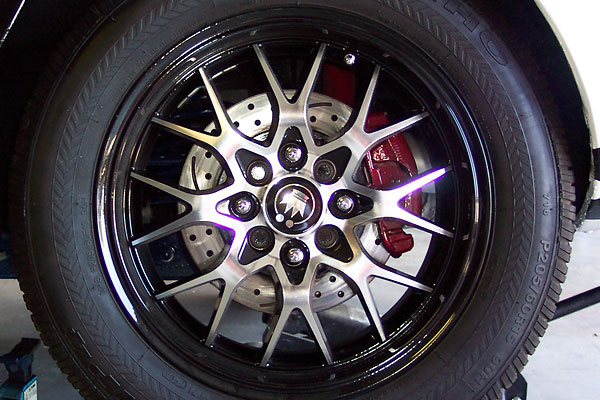

Konig Lace aluminum 15x6.5 wheels. Kuhmo Ecsta 205/60x15 tires.

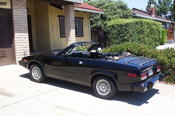

This is what John's TR7 looked like when he purchased it.

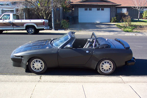

This is what John's TR7 looked like a year ago, before he repainted it.
