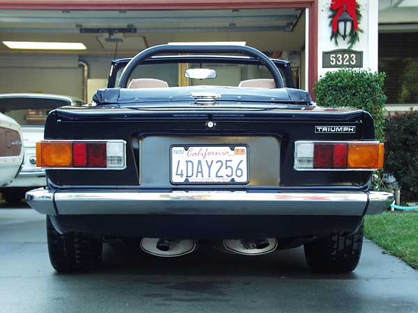

Exhaust: "Quiet" dual exhaust (Ford iron manifolds) with 2 small stock-type mufflers.

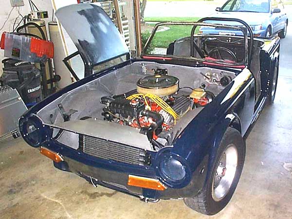

Date completed: the engine swap was completed in 1983 and the car was used as a daily driver until 1987, when it was completely disassembled, painted and updated with the Ford 9" rear axle. It was back on the road in 1999, and has been driven 20,000 miles since then (as of December 2007).

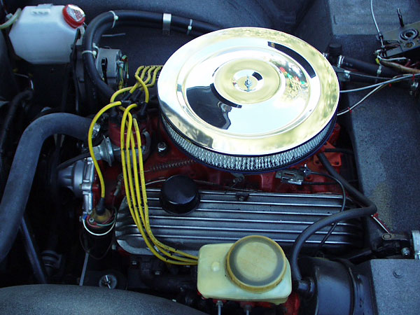

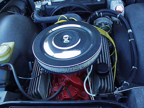

Ford 302 in a carefully detailed engine bay

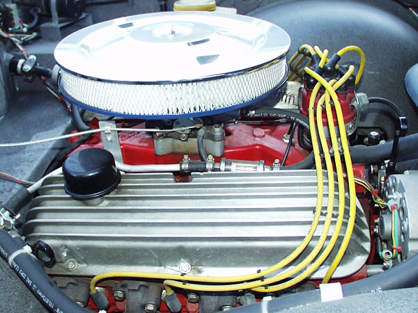

Mallory distributor

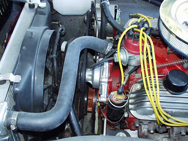

Griffin aluminum radiator. Moroso water pump.
Ford alternator

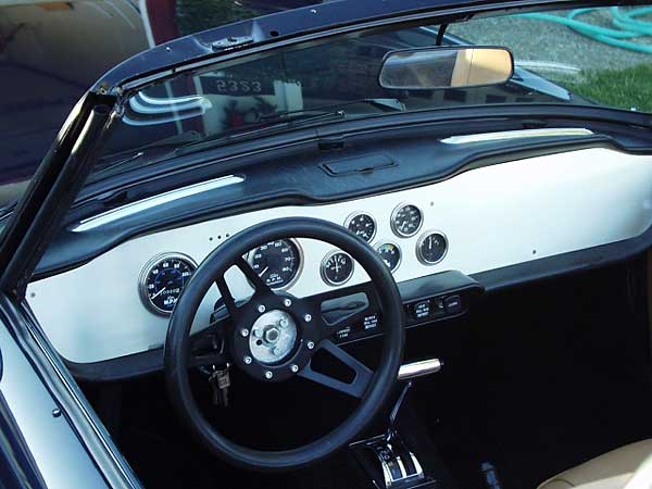

Stewart Warner gauges in a custom aluminum dashboard

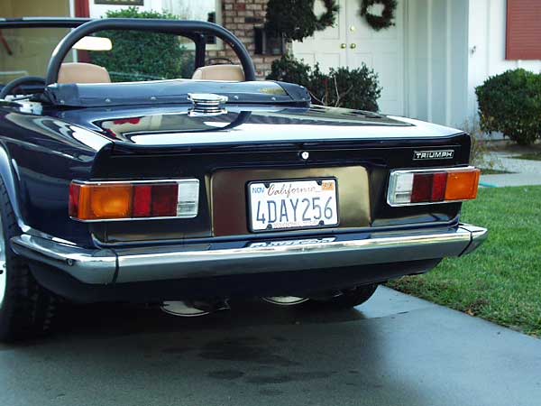

California 4DAY256
Quiet dual exhaust with 2 small stock-type mufflers

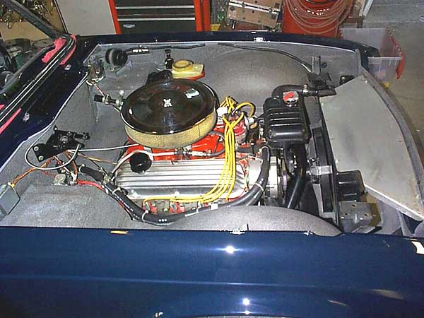

header tank
reassembly after painting
