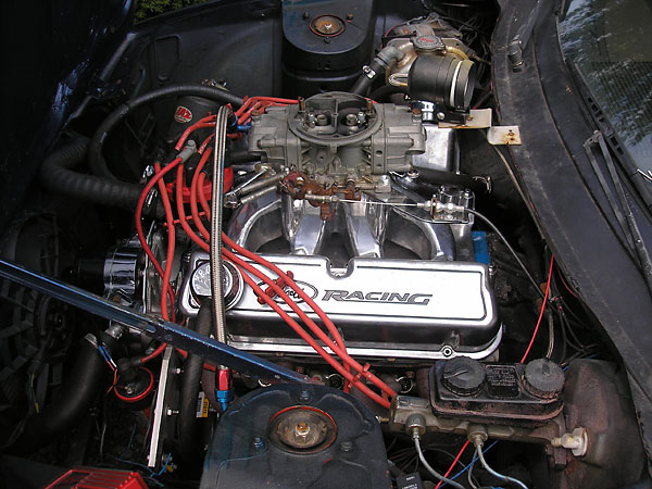

Engine: Ford 302 stroked to 349
Engine: Ford 302 stroked to 349. Parker Funnel web intake and Holley 830cfm. Comp solid flat tappet cam. (0.592, 0.592 lift.) MSD ignition.

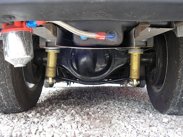

Suspension: Ladder bars and coil overs.

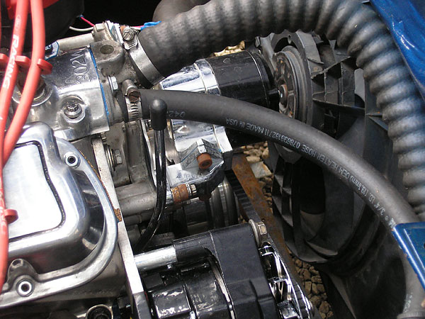

water pump and cooling fan

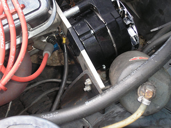

alternator

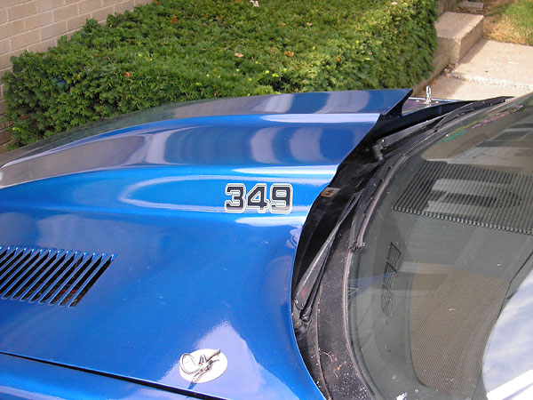

hood

coil overs

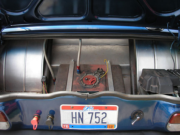

fuel cell

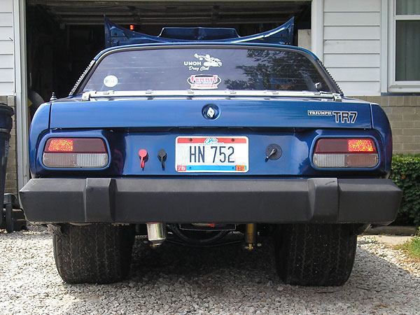

jump start studs
