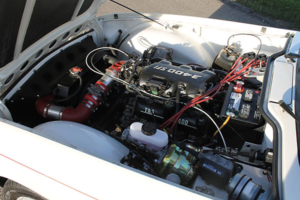

Engine: GM P3400 SFI V6
Conversion by: Bill Sinclair of British Restorations
How It Was Done

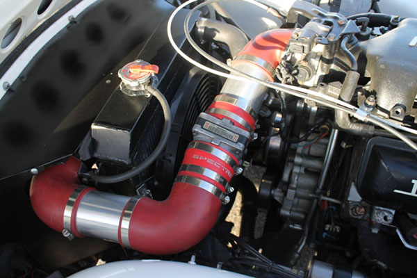

Engine: General Motors 3.4 Litre SFI V6 from early 2000's Impala. FWD to RWD conversion. British Car Conversions motor mounts. Intake manifold rotated to orient throttle body forward. K&N air filter.

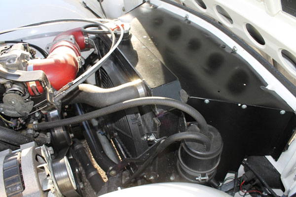

Cooling: Ford Mustang style aluminum radiator. High cfm 16" electric fan (pulling).
Exhaust: custom ceramic coated headers. Dual mufflers. 2.25 inch single exhaust.
Transmission: Borg Warner T5 5-speed manual gearbox from an IROC Camaro.

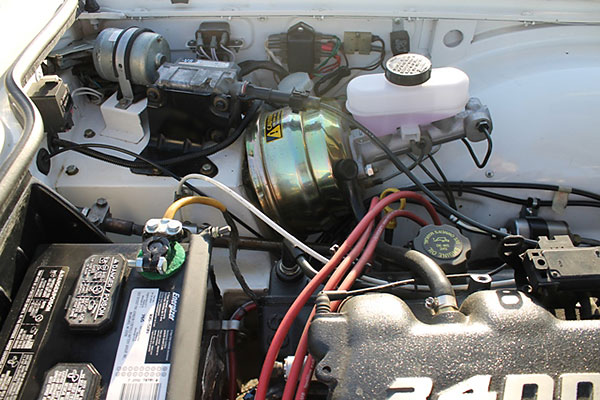

Brakes: (master) Ford Mustang master cylinder with vacuum booster. Wilwood proportioning valve.
(front) Toyota disc brakes.

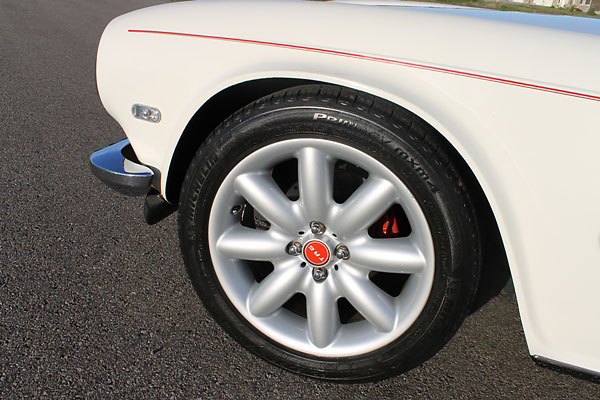

Wheels/Tires: Mini Cooper 17-inch alloy wheels. Michelin Primacy P215/50R17 tires.

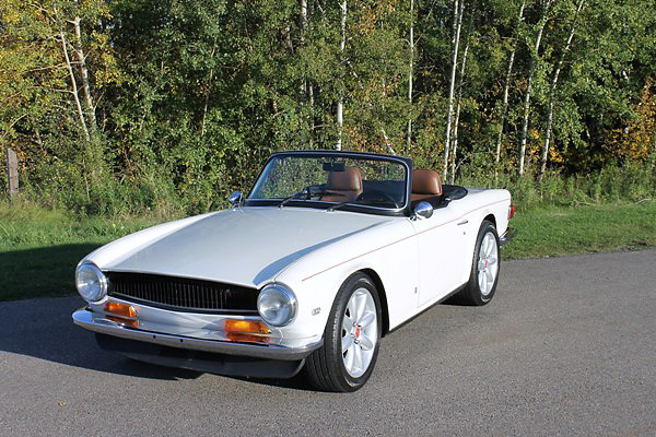

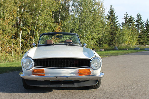

Body: new paint (in a General Motors white.) Powder coated front grille. Upgraded front lip spoiler. Audi front side marker lamps.

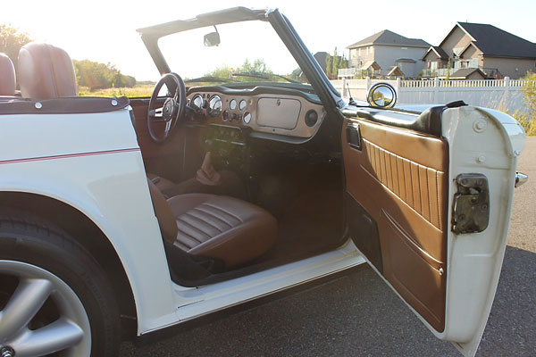

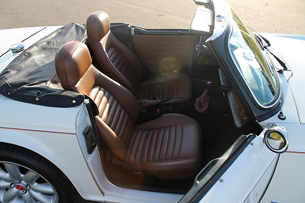

Interior: Mountney leather wrapped steering wheel. Pioneer AM/FM/CD/MP3 stereo. Tweeters in vent holes in dash. Mazda Miata seats with stereo speakers in headrests and electric seat heaters. Electric power windows. Custom door trim panels. MGB interior door latches. Modified carpeted trunk area.

GM P3400 SFI V6
GM P3400 SFI V6
Cold air intake hose routing, and mass airflow sensor installation.
Ford Mustang style aluminum radiator and 16
Ford Mustang style aluminum radiator and 16" electric fan (pulling).

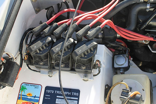

Three dual-tower ignition coils installed atop a GM Ignition Control Module.

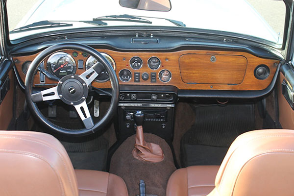

Mountney steering wheel. Dolphin electronic tachometer and speedometer.

Miata Seats: with electric heaters, headrest mounted speakers and custom lumbar supports.

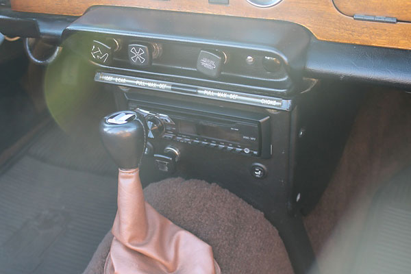

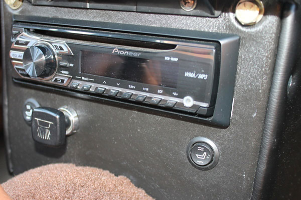

Pioneer AM/FM/CD/MP3 head unit. Heated seat switches.

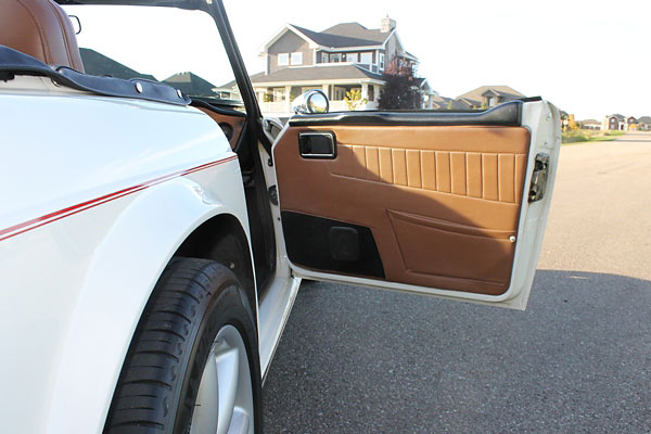

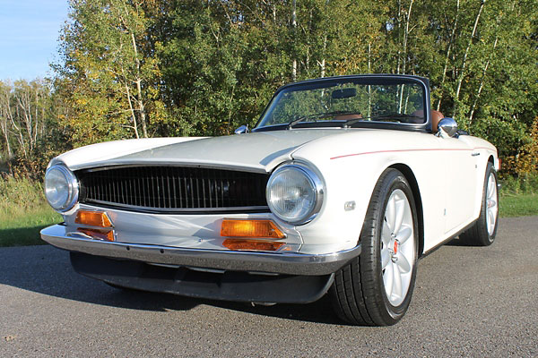

Upgraded front lip spoiler. 55W HID headlights.
Powder coated Triumph TR-6 grille.
This shade of white was selected from General Motors' offerings.

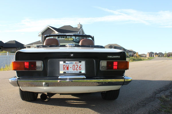

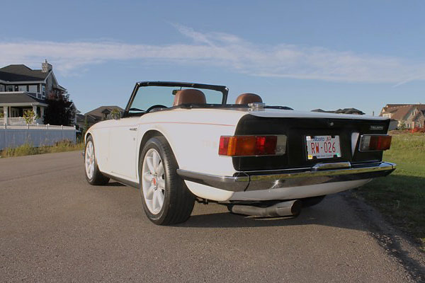

Dual mufflers followed by a 2.25 inch single exhaust.
