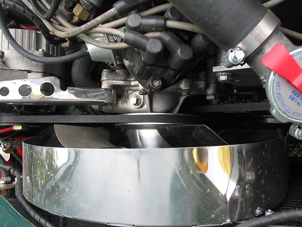

Cooling: stock radiator. 16" Permacool electric engine fan. 15" Permaflex engine fan and shroud. Undersized water pump pulley.

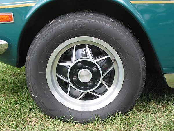

Wheels/Tires: stock 5-spoke alloy wheels. Yokohama Avid H4 195/70R14 tires.

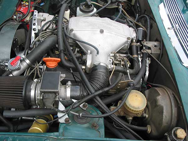

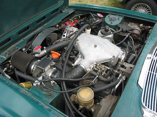

Rover SDI 3.5L V8 engine
Rover 14CUX electronic ignition system

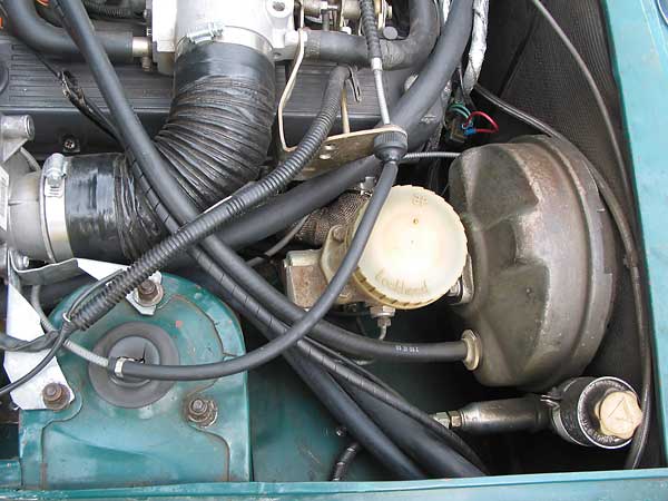

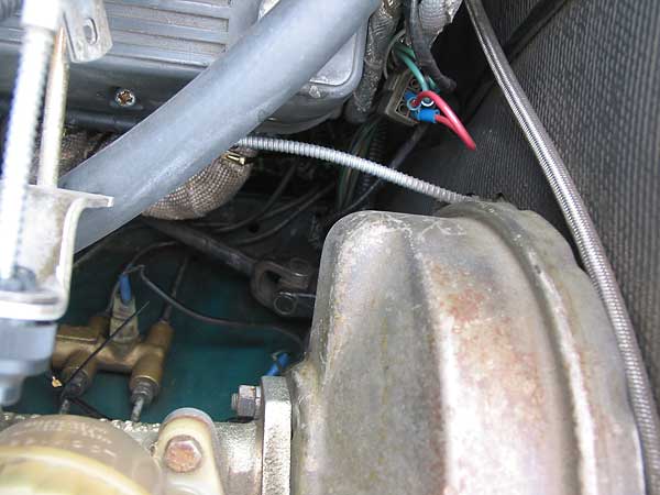

master cylinders and brake booster servo
steering linkage
k&n air filter and Lucas/Hitachi mass air flow sensor
15 inch mechanical flex cooling fan

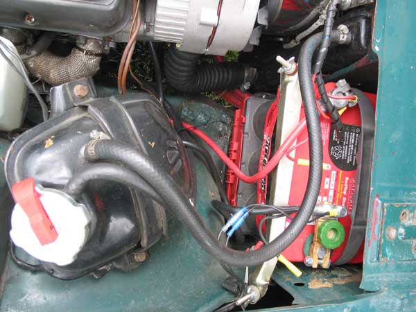

a box of lead and acid? let's put it as far forward as possible!

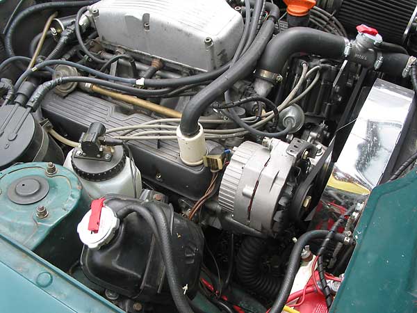

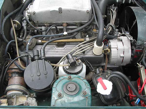

AC Delco 90 amp alternator
relax, it's just 16 hoses

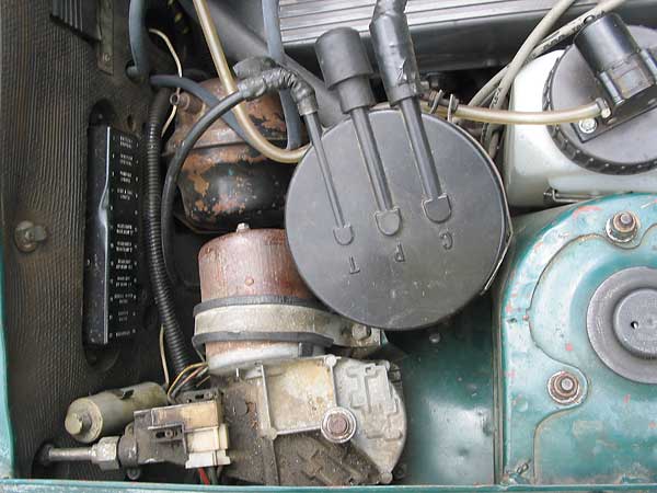

wiper motor

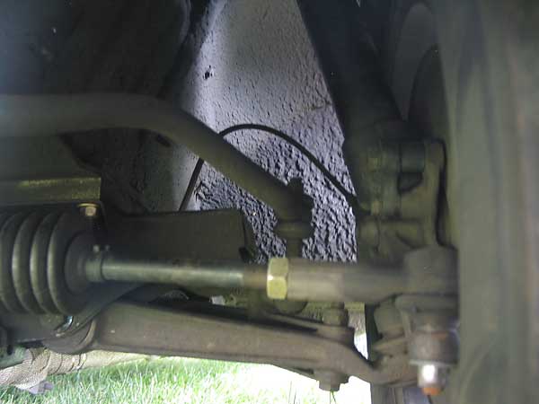

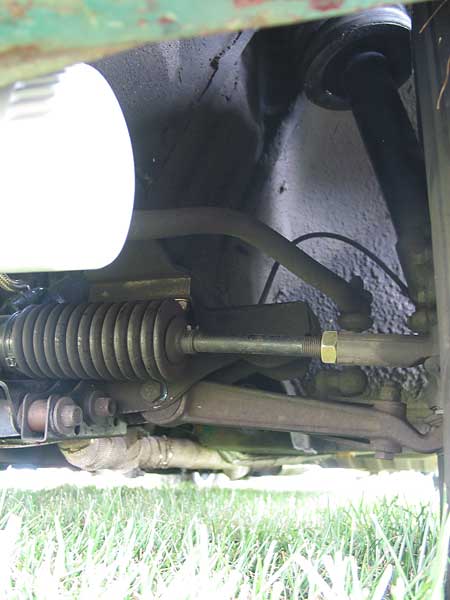

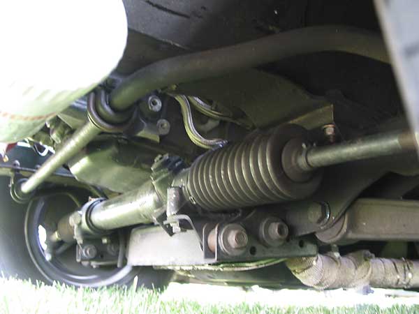

remote oil filter, steering rack and anti-roll bar

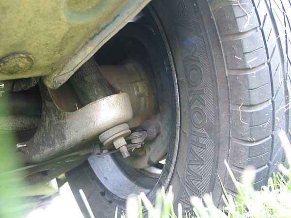

MacPherson strut independent suspension
MacPherson strut front suspension

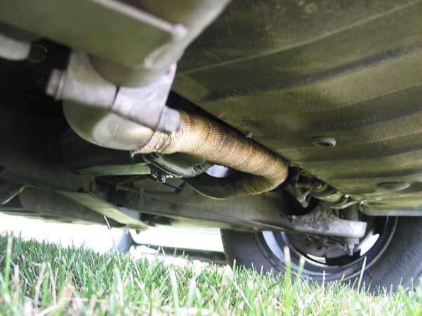

the exhaust wraps around the differential

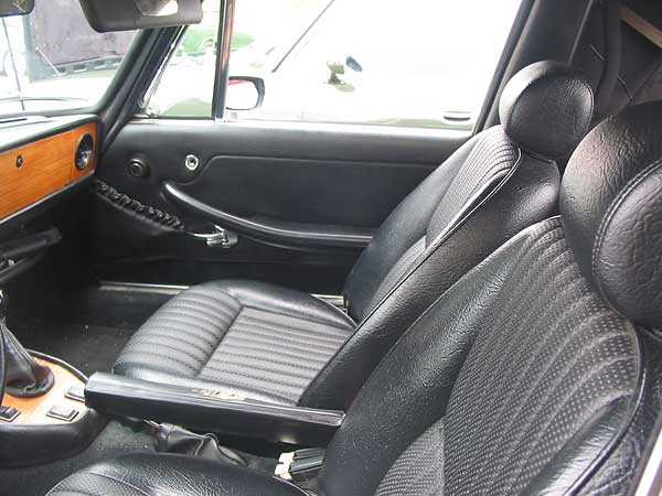

Triumph Stag seats and door panels
