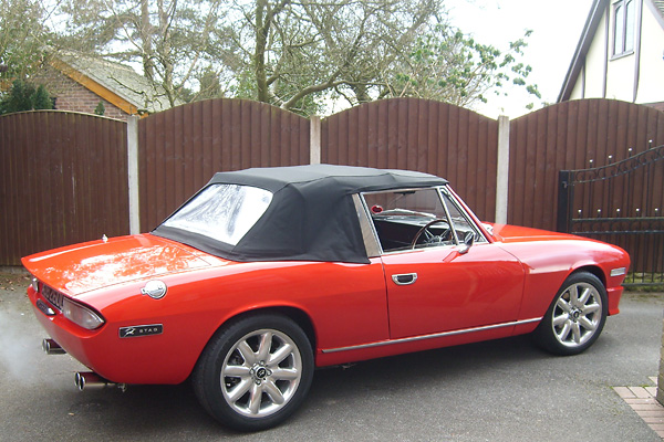

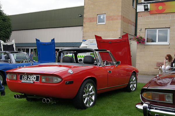

Gary Stanfield's 1972 Triumph Stag / Rover 3.9L V8 Conversion
Owner: Gary Stanfield
City: Staffordshire England
Model: 1972 Triumph Stag
Engine: Rover 3.9L (EFI)
Engine: Rover 3.9L with 14CUX (1992 hot-wire type) electronic fuel injection. Viper Cyclone camshaft.

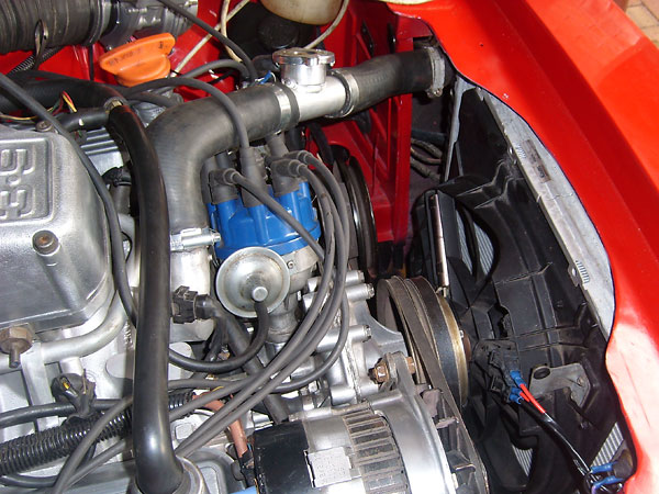

Cooling: Volvo 740 crossflow aluminum radiator. Saab 900 two-speed electric fan.
Exhaust: Phoenix tubular manifold. 2" custom dual exhaust.
Transmission: Rover LT77 5-speed. 9.5" clutch. BMW driveshaft.
Rear End: BMW 3.09:1 gears and open differential.
Front Suspension: lowered Triumph 2000 crossmember and steering rack. 1.5" lowered springs.
Rear Suspension: BMW 325i E30 transplant.
Brakes: (master) BMW E30 servo,
(front) Wilwood four-pot calipers and vented rotors,
(rear) BMW calipers and solid rotors.
Wheels/Tires: BMW Mini 17" aluminum wheels. 205/50/R17 (front) and 215/50/R17 (rear) tires.
Instruments: stock.
Interior: stock.

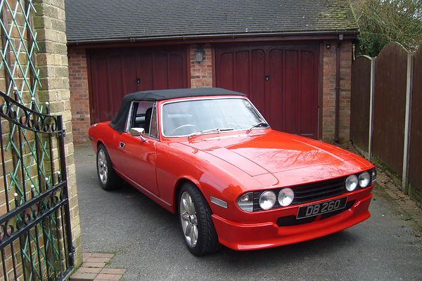

Body Mods: bumpers removed. Front and rear fenders (a.k.a. "wings") replaced. Chrome trim shaved. Body seams filled.
Electrical: stock, except 14CUX engine electrical controls.
Completed: March 2009. Driven 4500 miles so far, as of July 2011.

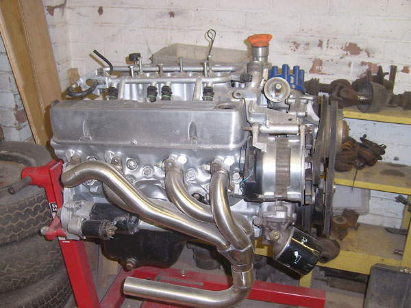

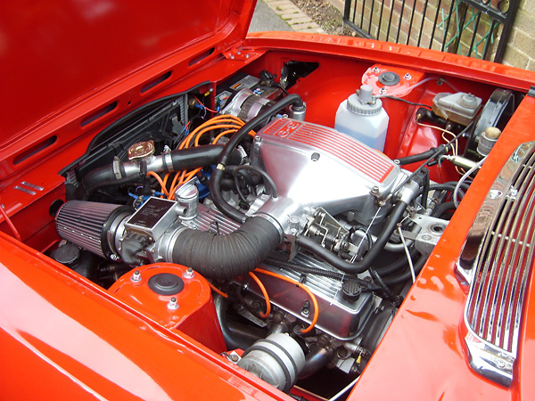

Phoenix tubular manifolds.

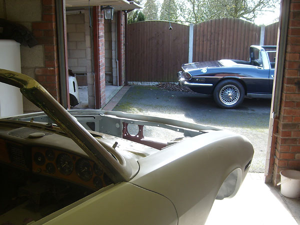

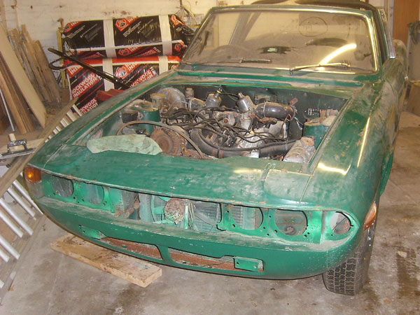

Preliminary Bodywork
The before picture.
The before picture.

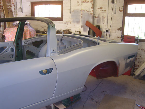

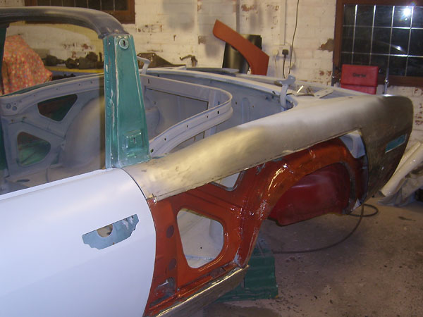

Installing new rear fenders on a Triumph Stag.
Triumph Stag rust repair.
After carefully smoothing the fenders, Gary left original chrome side trim off.

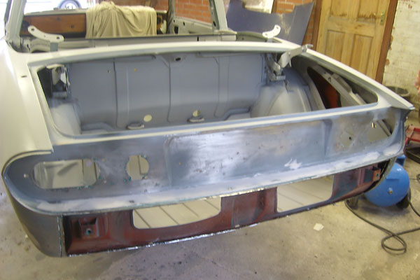

Triumph Stag rear end

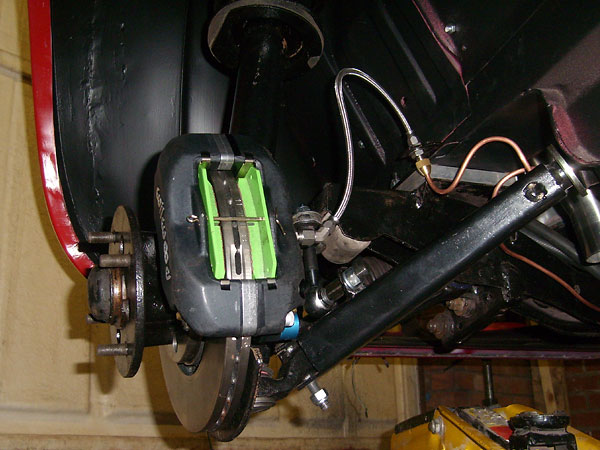

Wilwood four-pot calipers and vented rotors.

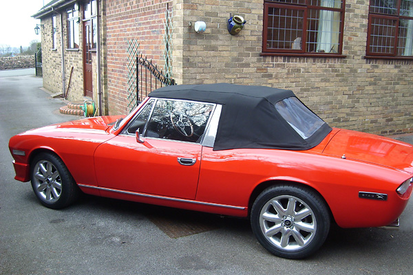

Lowered front springs plus modern wheels and tires give this Stag its aggressive stance.
