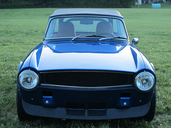

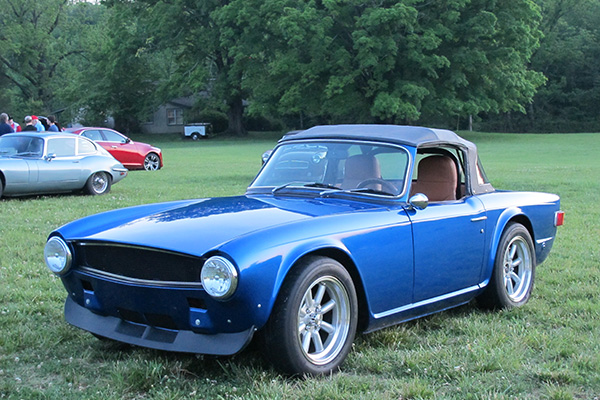

Ed Peppard's 1975 Triumph TR-6 with Ford 302cid V8 Engine
Owner: Ed Peppard
BritishV8 UserID: epeppy
City: Woodlawn, Tennessee
Model: 1975 Triumph TR-6
Engine: Ford 302cid V8
Conversion by: owner

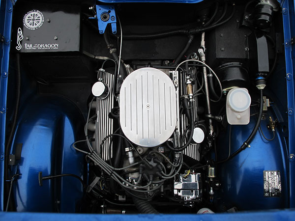

How It Was Done

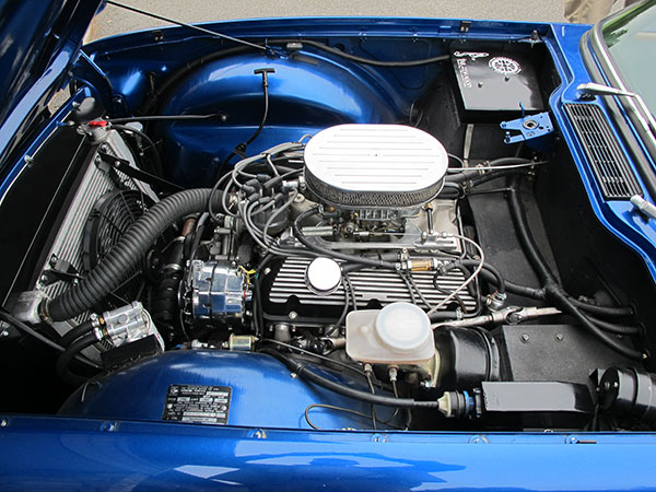

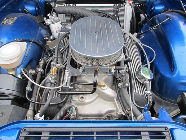

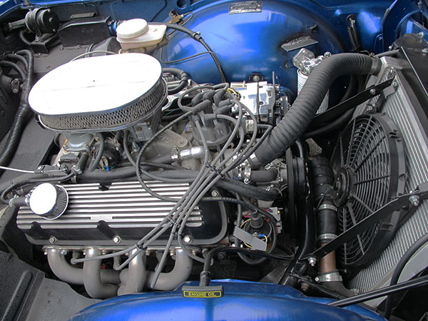

Engine: 1972 Ford Bronco 302 cubic inch V8, bored 0.040" over. Stock cylinder heads. Comp Cams street cam. Stock valve train. Edelbrock Performer intake manifold. Holley 600 CFM carburetor with electric choke. Spectre oval aluminum air cleaner. Pertronix Ignitor breakerless ignition module within stock Ford distributor. Accel ignition coil. Rear pickup oil pan. Motorcraft FL-1A oil filter, remotely mounted.

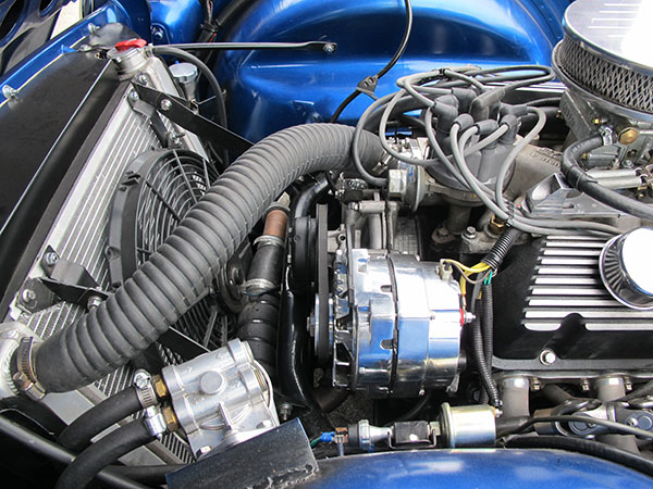

Cooling: KMJ Performance aluminum radiator. Short nosed water pump.

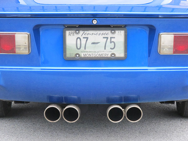

Exhaust: Ceramic coated blockhugger headers. X-pipe just ahead of T-shirt. Flowmaster Series 40 mufflers. VPE exhaust tips. 2-1/4" diameter exhaust pipe.
Transmission: Tremec T5 World Class transmission. Ford Motorsports bellhousing. 10.5" F1 clutch, cable operated. (Fabricated a quadrant for the clutch pedal and a housing for the firewall adjuster.) Custom driveshaft with Spicer u-joints.

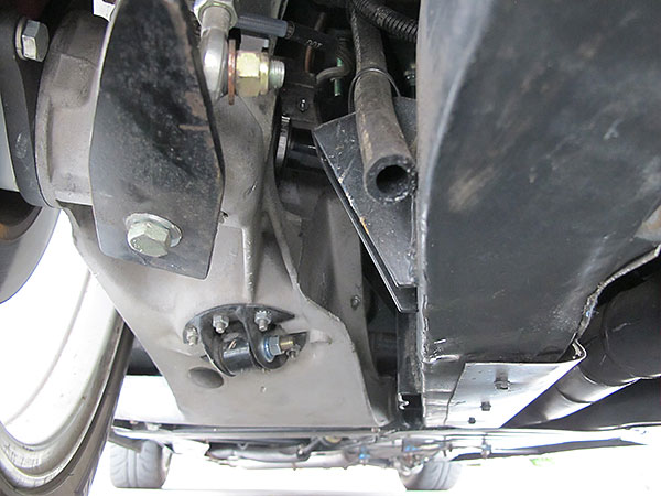

Rear End: R200 differential from an Infinity Q45, VLSD. Good Parts differential mounting kit. Good Parts constant velocity jointed halfshafts.

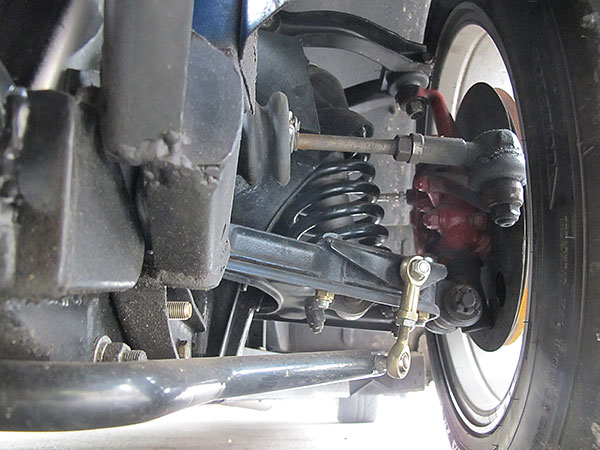

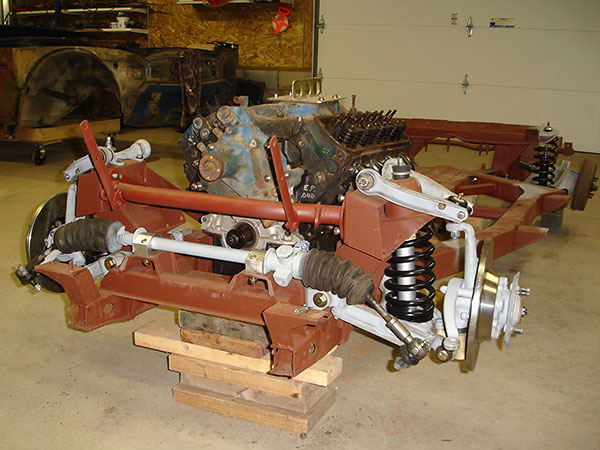

Front Suspension: 1" lowering springs. Good Parts nylatron bushings. KYB shocks. Good Parts aluminum steering rack and sway bar mounts. Steering u-joints, splined stubs, and DOM tubing from Woodward.

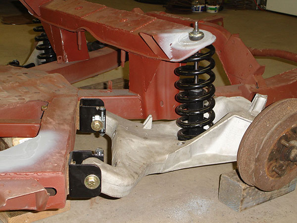

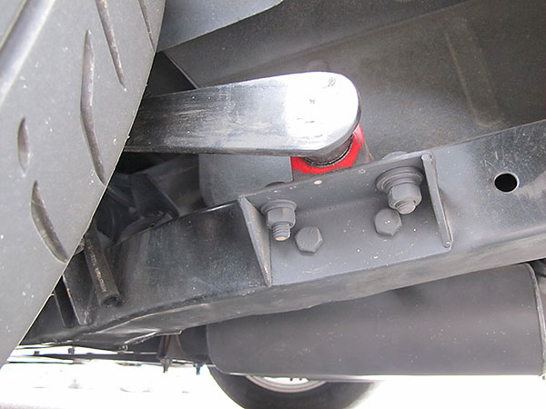

Rear Suspension: Good Parts adjustable trailing arm brackets. 1" lowering springs. Monroe shock absorbers mounted through the springs. Custom 3/4" anti-sway bar with 8.5" arms. Energy Suspension polyurethane anti-sway bar bushings.

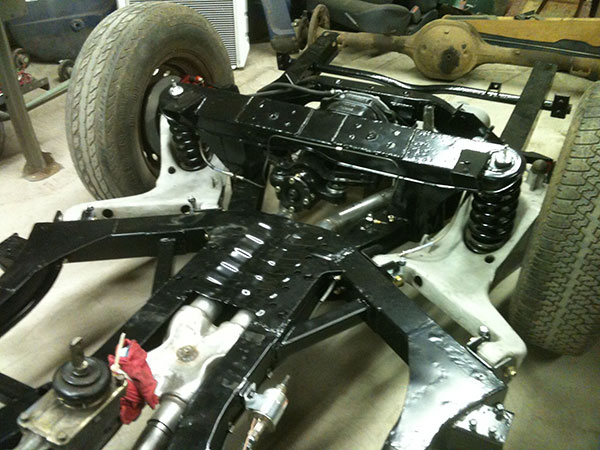

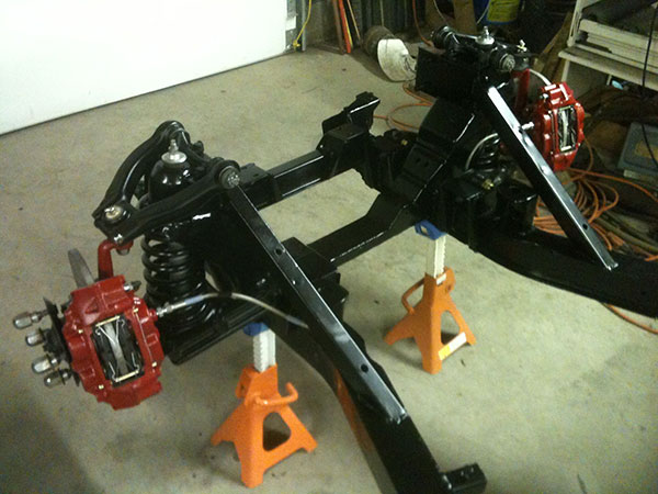

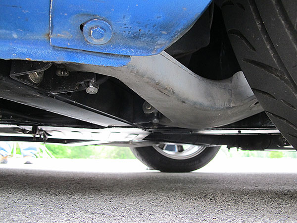

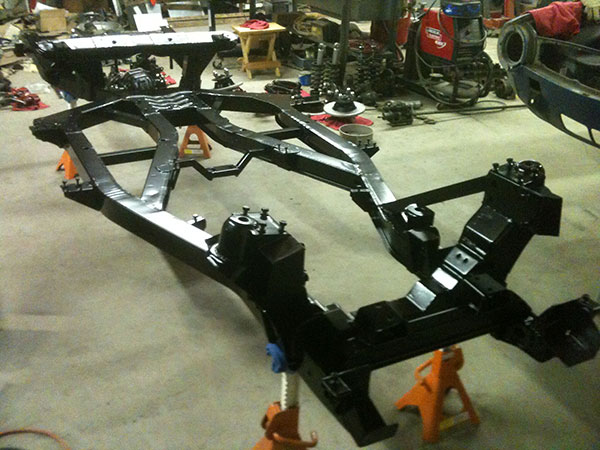

Chassis: modified front crossmember. Various modifications for wider radiator. Dan Masters style motor mounts. Boxed rear differential crossmembers. Fabricated transmission mount. Replaced trailing arm framework with 3" square tubing. 1" square-tube structural members. Additional frame plates at trailing arm mounts.

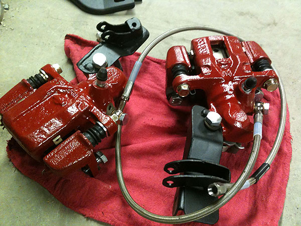

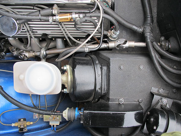

Brakes: (master) Stock master cylinder.

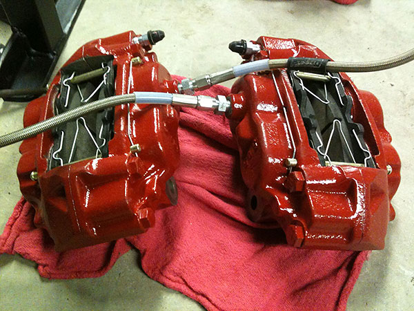

(front) Toyota 4X4 front calipers.
(rear) Maxima rear brake calipers, Nissan 240SX rear rotors. Don Watson brake caliper bracket design, fabricated from 1/2" steel by Butch Walla.

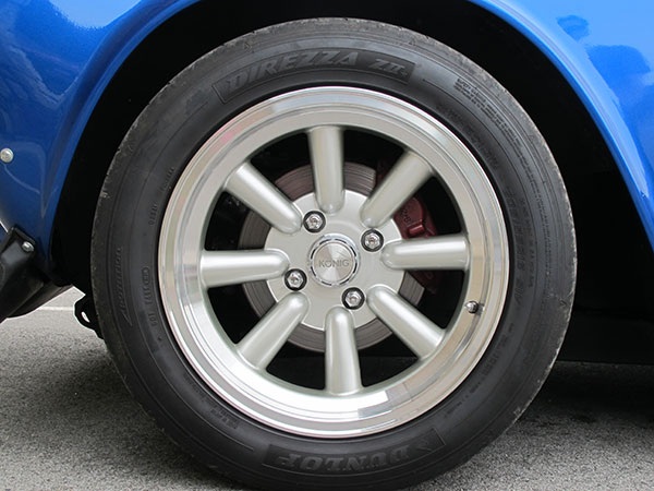

Wheels/Tires: Konig Rewind 8-spoke aluminum wheels. Dunlop Direzza Sport ZII tires, size 205/55R16.
Body: powdercoated wire mesh grille. Removed front side marker lamp openings in fenders. Replaced rocker panels, both sides. Replaced driver's side floorboard. Custom fabricated transmission tunnel. Lizard Skin sound deadening. Ceramic insulation sprayed on underside and interior. Dodge Viper Blue colored exterior paint.

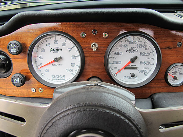

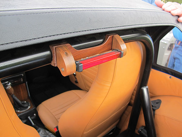

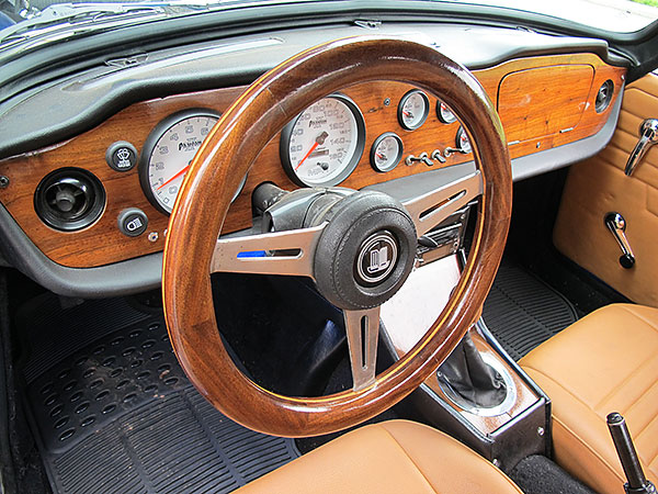

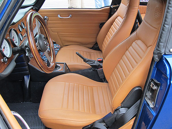

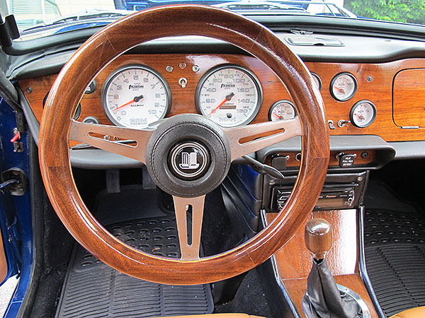

Interior: custom walnut dashboard. Autometer Phantom II gauges. LED dashboard indicator lamps. Custom walnut and oak steering wheel rim on original steering wheel ring. Custom walnut center (radio) console. Custom walnut shift knob. Custom walnut pull knob for hood release. Miata seats with new headrest speakers. Mr Mike's seat covers. BobbyD interior panels. Custom mount for Center High Mounted Stop Lamp (CHMSL) on roll hoop.

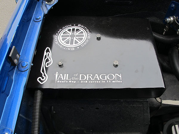

Electrical: Advance Auto-Wire wiring and fuse/relay center. Battery relocated to trunk. Second solenoid in trunk. Single wire alternator with warning light and voltage sensing connections. Pioneer DEH8400 stereo head unit.

1972 Ford Bronco 302 cubic inch V8, bored 0.040 over.
This car features a cable-operated clutch mechanism.
NCM Motorsports Park (Bowling Green, KY) track map sticker.
www.BritishV8.org / www.BritishRacecar.com toolbox sticker.
Tail of the Dragon - Deal's Gap - 318 curves in 11 miles sticker.
Front Suspension
KYB shock absorbers. 1 lowering springs.
KYB shock absorbers. 1" lowering springs.

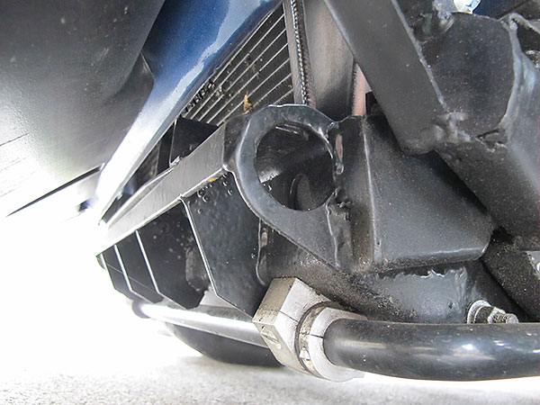

Modified front crossmember with various modifications for a wider radiator.
Rear Suspension

Custom 3/4 inch anti-sway bar with 8.5 inch arms.

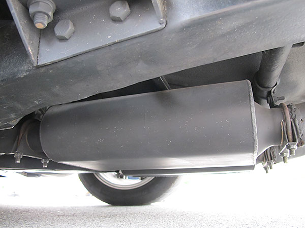

Custom walnut dashboard.
Autometer Phantom II gauges. LED indicator lamps for turn signals,
high beams, alternator warning light, and emergency flashers.

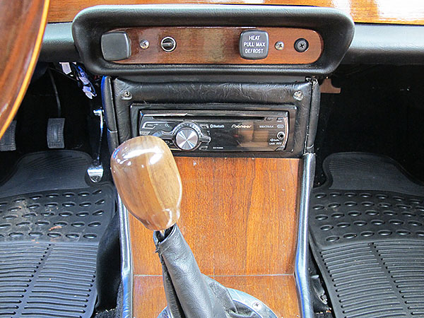

Custom walnut shift knob and center console. Pioneer DEH8400 stereo head unit.

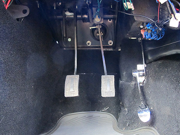

Stock Triumph TR-6 pedals.
Miata seats with Mr Mike's seat covers.

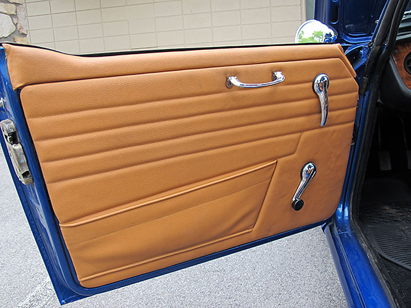

Custom mount for Center High Mounted Stop Lamp (CHMSL), on roll hoop.

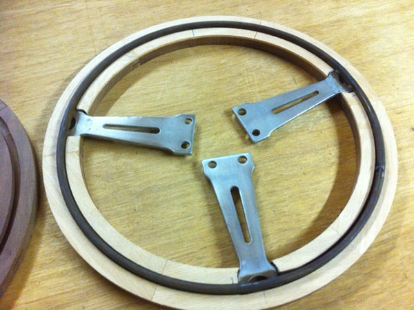

Building the custom walnut and oak steering wheel.
Building the custom walnut and oak steering wheel. See more close-up, in-process photos here.

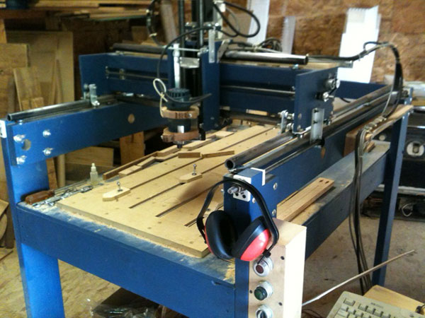

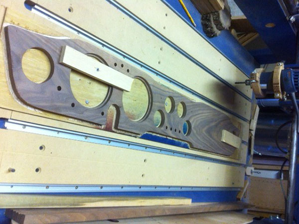

Ed built a CNC milling machine to enable cutting a custom dashboard.
Here's the custom walnut dashboard, being cut out!
Here's the custom walnut dashboard, being cut out! Learn more on our message board, here.
KYB shocks. 1 inch lowering springs.
KYB shocks. 1" lowering springs.
Boxed rear differential crossmembers. 1 inch square-tube structural members.
R200 differential from an Infinity Q45, VLSD. Boxed rear differential crossmembers.
Replaced trailing arm framework of 3 inch box tubing. Additional plates at trailing arm mounts.
Replaced trailing arm framework of 3" box tubing. Additional plates at trailing arm mounts.
Maxima rear brake calipers.

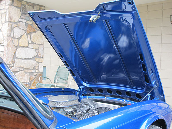

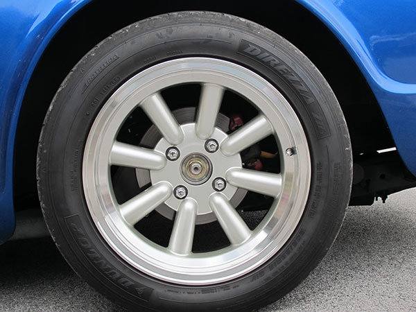

Stock Triumph TR-6 bonnet, from the bottom.
VPE exhaust tips.
VPE exhaust tips.
