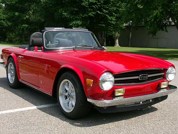

Conversion performed by: Dan Furey at Power Technologies
City: Columbus OH
Model: 1973 Triumph TR-6

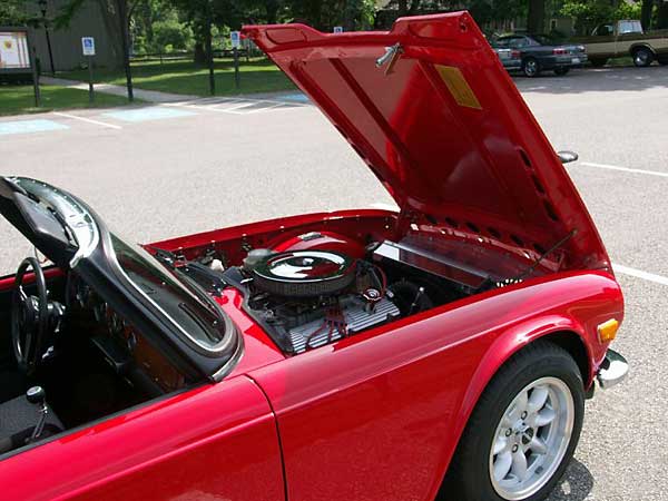

Engine: Ford 289 V8
Intake: high rise manifold and Holley 4bbl carburetor.
Exhaust: headers.
Transmission: Borg-Warner T5 and Ford SVO heavy duty clutch.
Rear axle: narrowed Ford 8".
Suspension: Adco front sway bar. Gas front shocks.
Other Chassis Mods: partial tube frame to mount axle. Reinforced chassis.

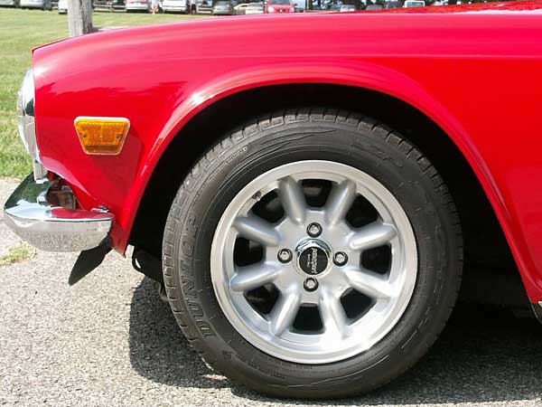

Wheels/Tires: Panasport 15 x 7 wheels (4-lug front and 5-lug rear). Dunlop tires.
Body/Interior: Corbeau seats w/Sparco seat belts. Custom 2-hoop roll bar.
Electrical: battery re-located to the trunk.
Note: this car sold at auction in July 2007

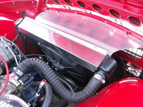

electric fan
modified TR6 cooling system

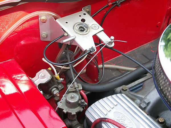

Ford starter solenoid

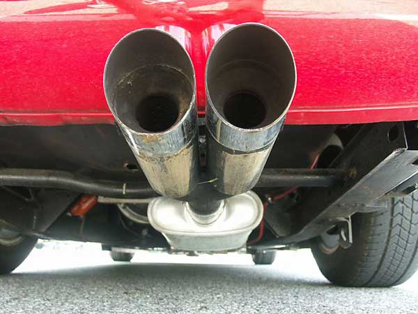

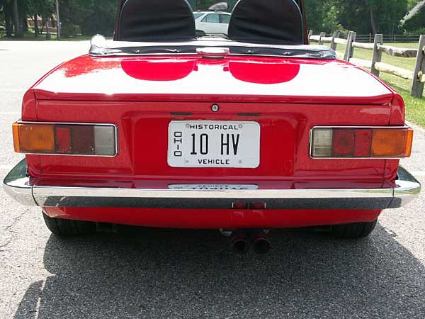

exhaust tips

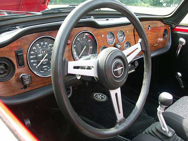

leather steering wheel

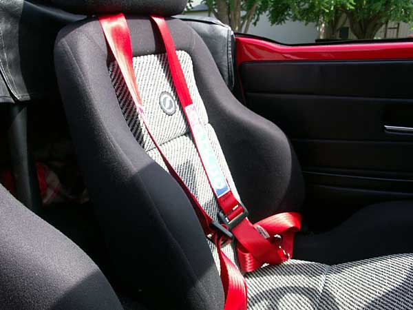

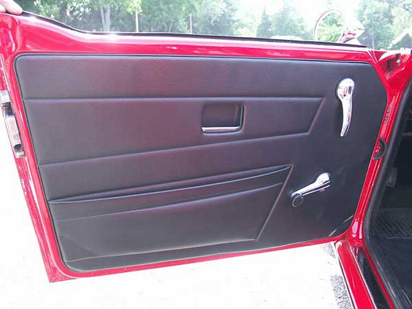

TR6 door panels

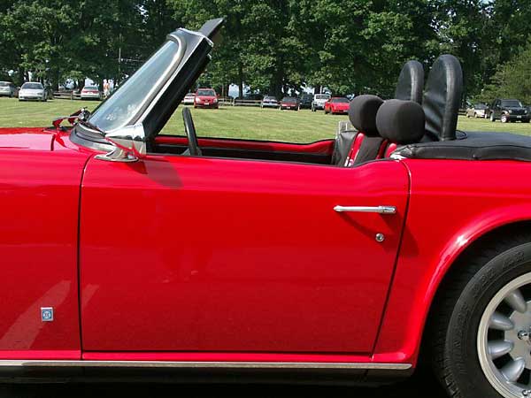

TR6 door

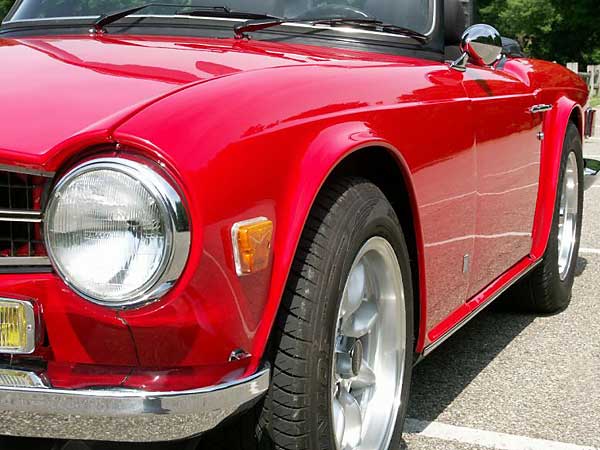

TR6 fender flares

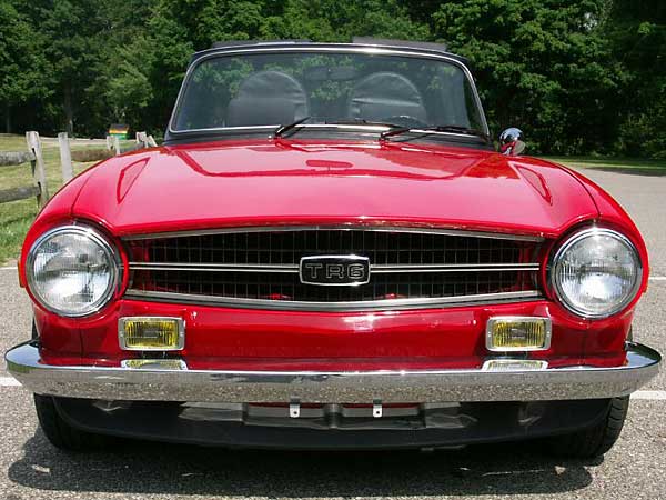

TR6 grille
De-badged TR6 rear

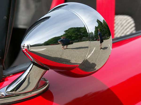

Talbot mirrors
Panasport wheels, Dunlop tires
