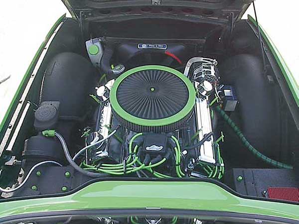

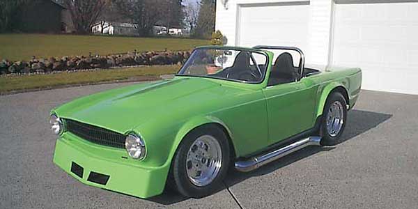

Engine Specification:
Archie Summers built 406cid small block Chevy
535 hp. 513 ft.lb.

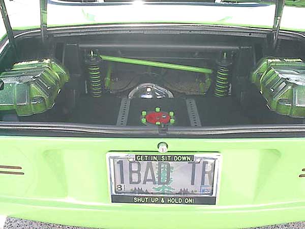

Rear Suspension:
Morrison 4-link coil-over suspension
Rear axle:
narrowed Dana 44 with 3.73:1 ratio
Transmission:
Chevy "350 Turbo", 3500 stall

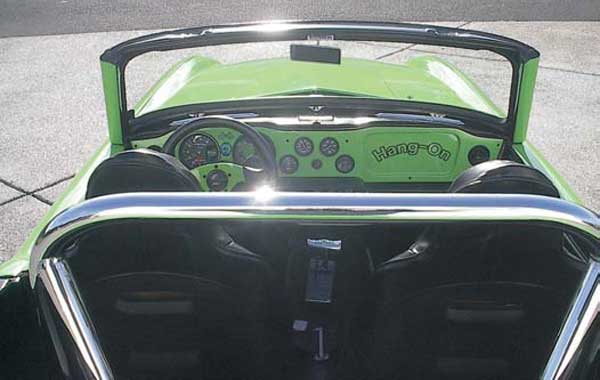

Electrical & Electronics:
Only thing stock are the headlights.

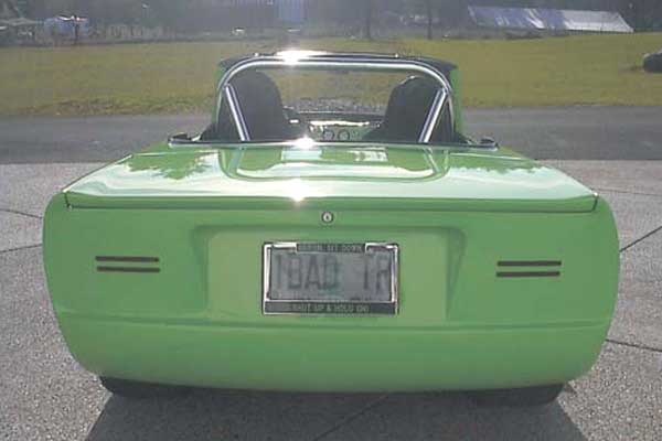

Rear lights have been removed, filled, and replaced with flush-mounted lights.

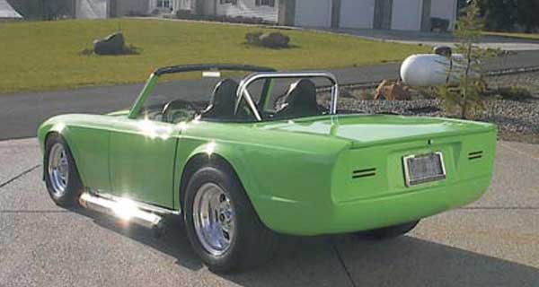

Body modifications:

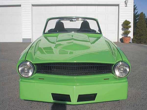

Windshield has been chopped 2" and laid back 4".
Top removed, windows and all seams filled, everything shaved and smoothed.
Hand made hood-scoop and front air-dam.
Stock fenders have been unrolled and dollied out for a clean flared look.
Car has been back-halved and tubbed.
Other special equipment:
15 gallon fuel cell.
Performance results:
10.70 second 1/4 mile (124 mph)
Comments:
This one of a kind TR6 gets 10 thumbs up per mile.
406cid Chevy V8
406cid Chevy V8
406cid Chevy V8
Triumph TR6 dashboard
