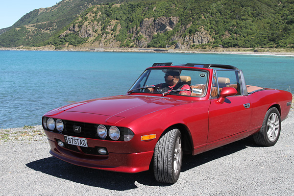

Stagzilla: Barry Ricketts' 1973 Triumph Stag with Hopped Up Triumph 3.0L V8
Stagzilla: Barry Ricketts' 1973 Triumph Stag with Triumph 3.0L V8

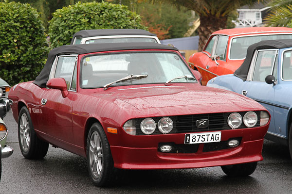

Model: 1973 Triumph Stag
Engine: Triumph 3.0L V8

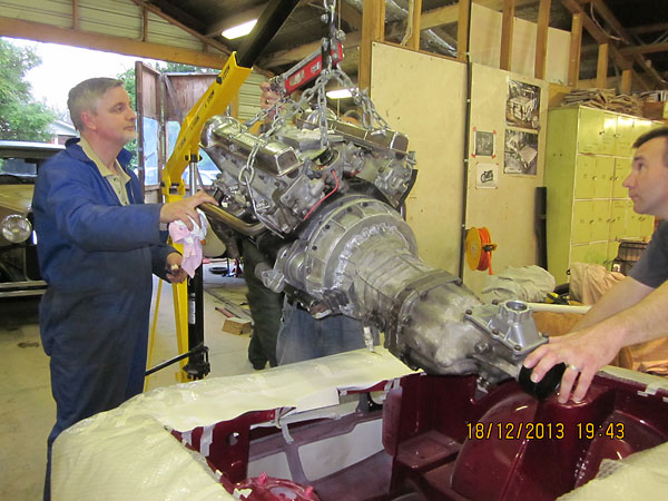

Engine: Triumph 3.0L V8 engine, rebuilt. Performance camshaft. John Parker intake manifold. Edelbrock 500 cfm carburetor. Edelbrock air cleaner. 123 electronic distributor. Bosch SU120RT ignition coil. Bosch spark plug wires. 70 amp alternator.
Exhaust: Rimmers stainless steel sports exhaust and manifolds.

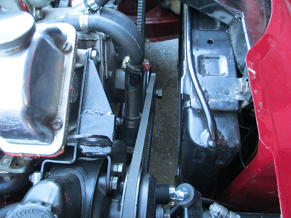

Cooling: stock radiator. Electric fan. Davies Craig EWP80 electric water pump.
Transmission: Toyota W57 5-speed. Lightened and balanced flywheel and clutch assembly.
Rear End: Nissan Sylvia R200 LSD. Datsun driveshafts.

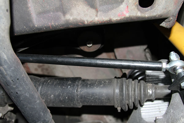

Front Susp.: Lowered standard springs. Spax adjustable shock absorbers. Monarch Stags uprated anti-roll bar.
Rear Susp.: Lowered standard springs. Spax adjustable shock absorbers. Monarch Stags control arms.
Brakes: (Nissan four pot calipers have recently been removed because they were too heavy. Wilwood calipers are being substituted.)
Wheels/Tires: Volvo V40 spec 16x7 (4 on 114.3 lug pattern) alloy wheels. Goodyear Eagle F1 205/55R16 tires.
Body: dechromed. Rimmers front spoiler. Modified/recessed grille. Daytime running lights added. Upgraded halogen headlights. Honda S2000 electric mirrors, painted body color. Dechromed and de-seamed hardtop. Lexus Cherry Red metallic paint.
Interior: Pioneer stereo. Electric seat heaters. Homemade wind deflector.
Comments: "The car is gorgeous to drive and handles far better than it could ever have in standard format."

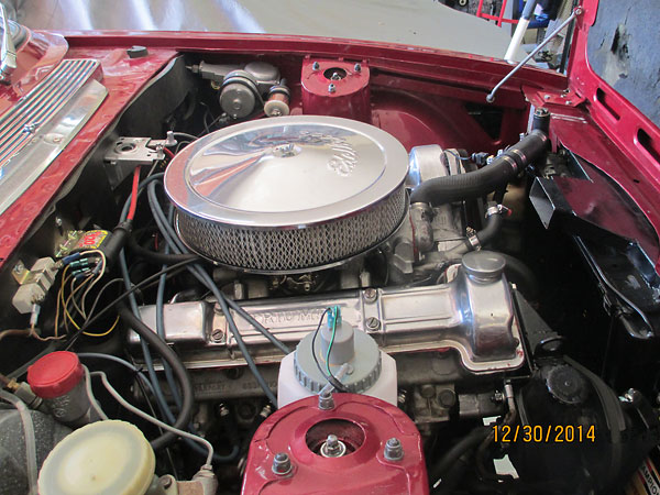

Triumph 3.0L V8 engine updated with Edelbrock 500cfm four barrel carburetor.
The intake manifold was part of a kit developed by local Kiwi, John Parker,
who for years was spares secretary of our local Triumph Stag club.
Alternator now relocated to make room for the electric water pump.
Alternator has been relocated to make room for an electric water pump (at bottom, RHS.)

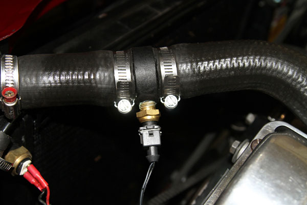

Custom fabricated temperature sensor housing for the electric water pump system.
Electric water pump is mounted below this stock power steering pump.

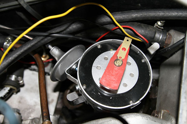

123 distributor
"Made in the Netherlands, this 123 distributor helps the engine
rev freely to redline without any misfire or vibration."

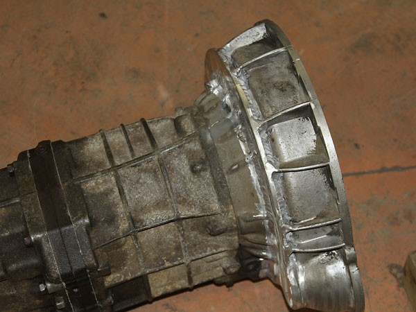

Bellhousing contructed by marrying cut-down Triumph and Toyota parts.
Toyota W57 5-speed.
Toyota W57 5-speed.

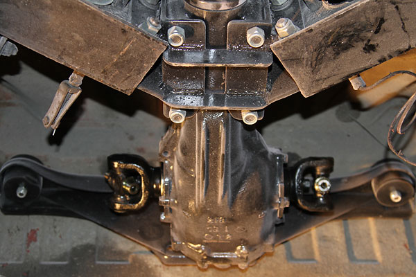

Nissan Sylvia R200 rear end, with limited slip differential.
Suspension

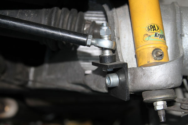

Monarch Stags uprated front anti-roll bar.

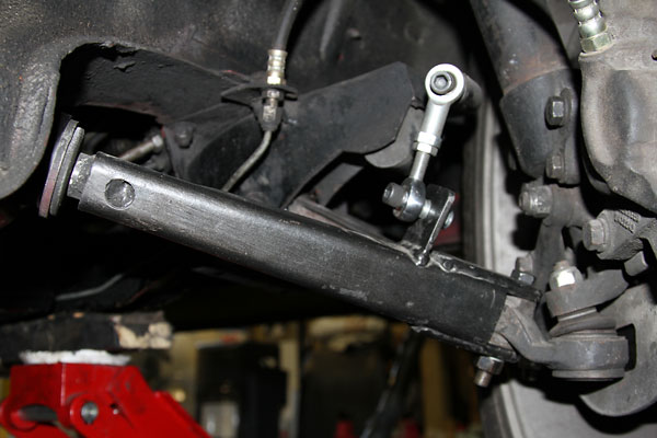

Monarch Stags control arms. Datsun halfshafts.
Nissan Sylvia R200 rear end.

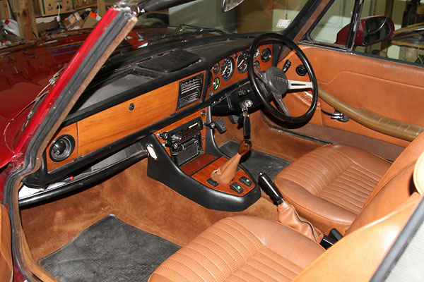

Interior looks standard apart from the center console.
"Interior looks standard apart from the center console, which has been tailor
made to house new electric window, electric fan, and heated seat switches."
Stock seats, but with electric seat heaters added.

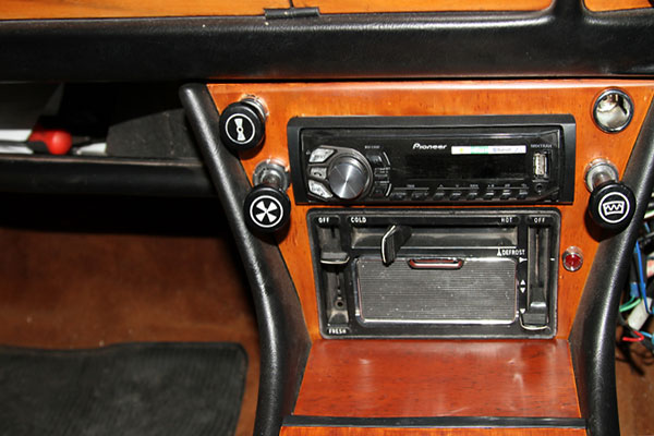

Pioneer stereo.
Pioneer stereo.

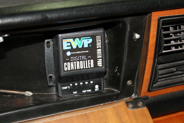

Davies Craig electric water pump control unit.
"This control unit came with the Davies Craig electric water pump. It can be programmed
to come on at various temperatures, but during the summer I use an override switch so
it runs full time. It also features a diagnostic capability."

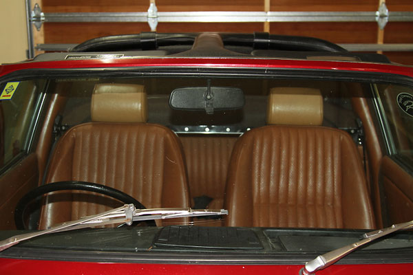

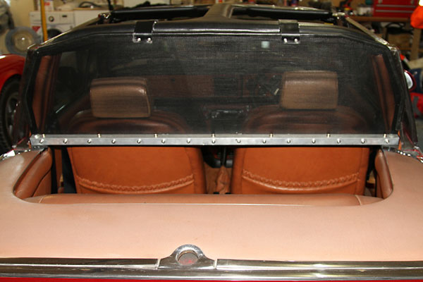

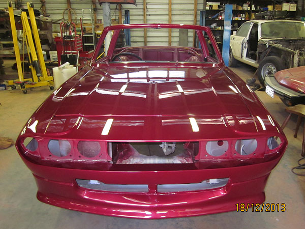

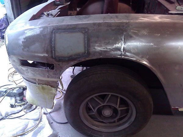

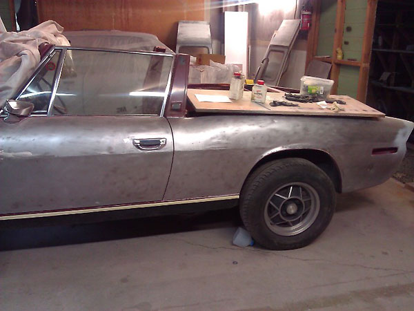

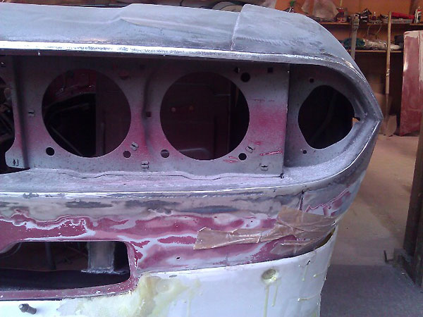

Bodywork - In Process
The spoiler was bought from Rimmers in the UK but was far from a perfect fit.
"The spoiler was bought from Rimmers in the UK but was far from a perfect fit."
The panel beater spent a week refabricating the unit to mate with the front cowling.
"The panel beater spent a week refabricating the unit to mate with the front cowling."

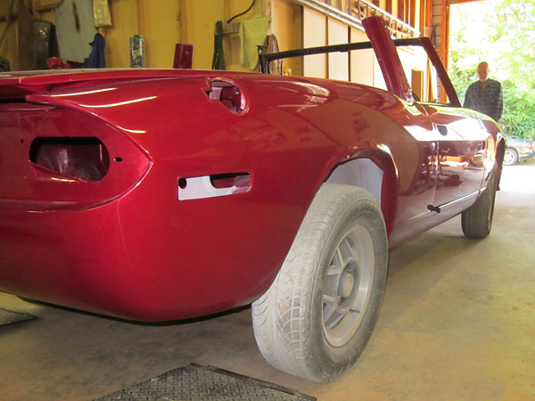

Lexus Cherry Red Metallic
In lieu of the car's original Triumph Carmine Red, this is Lexus' Cherry Red Metallic.
It's similar to original, except more pearlescent.

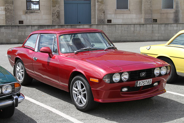

Here it's easy to compare Barry's largely de-chromed Stag with an unmodified example.
And here's a similar comparison of rear end treatments.

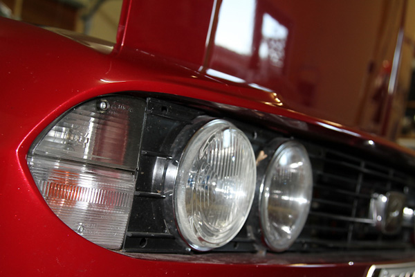

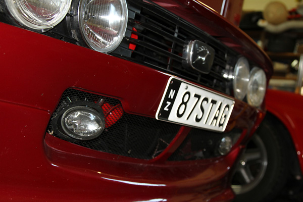

Close up of front grille, now recessed.
Close up of front grille, recessed about 30mm which is the maximum possible
without modifying or relocating the battery tray.
Registration plate is a special-order size to match the front panel.

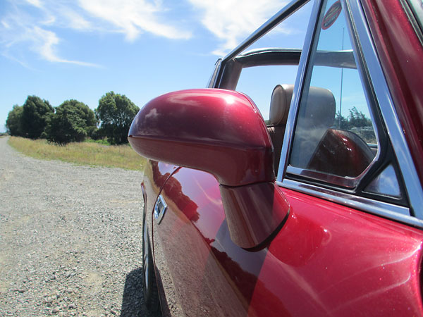

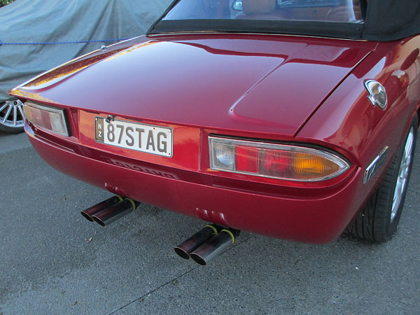

Stainless steel sports exhaust.
