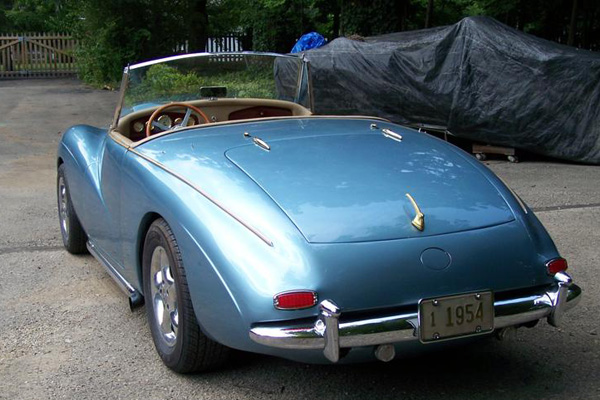

Wilfred Potter's Ford 302 V8 Powered 1954 Sunbeam-Talbot Alpine

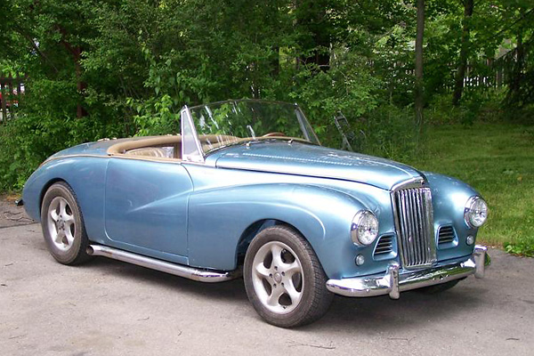

Model: 1954 Sunbeam-Talbot Alpine MkIV convertible

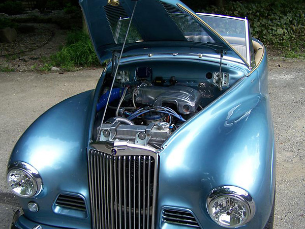

Engine: 1991 Ford 302 HO V8 EFI (Mustang)
Conversion by: Wilfred L. Potter, his son James M. Potter, & Sporty Car Garage

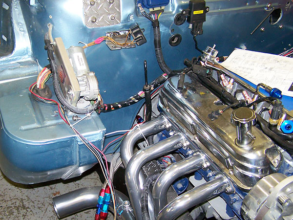

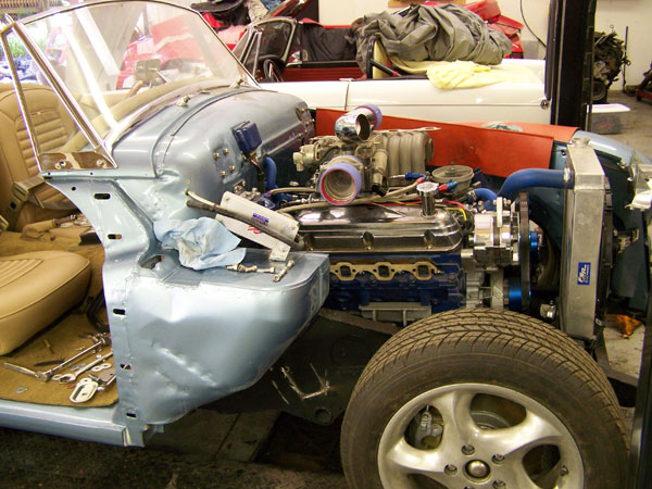

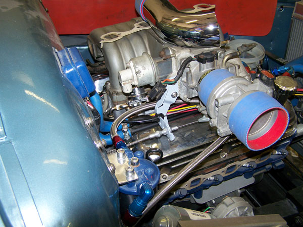

Engine: Ford 302 "high output) V8 with electronic fuel injection, sourced from a 1991 Mustang. Stock HO cylinder heads. Ford Mustang HO camshaft, Ford roller lifters, and Ford roller rocker arms. Polished and ceramic coated Ford HO EFI intake manifold, both upper and lower. Mass Airflow sensor mounted in passenger-side wheel well. Special fresh air vent inlet. Chromed Ford aluminum valve covers. Ford alternator. Stock Ford TFI Distributor. Ford Racing spark plug wires. Ford high torque starter.

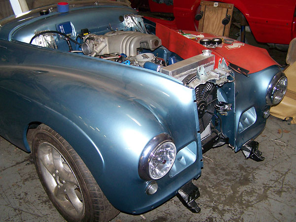

Cooling: aluminum "FSR" Chevy radiator, turned on its side. (Ford outlets added.) 16 inch electric fan.
Exhaust: custom fabricated four-into-one headers made from a Speedway Motors kit. 3" stainless steel tubing turn-outs. Speedway side pipes. (All ceramic coated.)

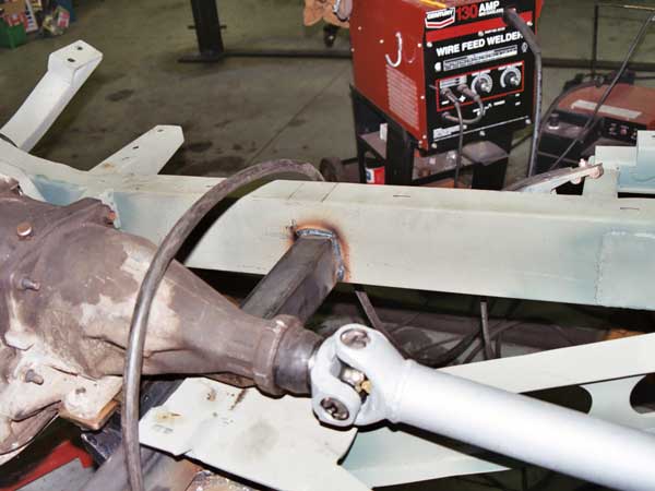

Rear Axle: Ford 9" narrowed 3.08:1 with Traction Loc differential.

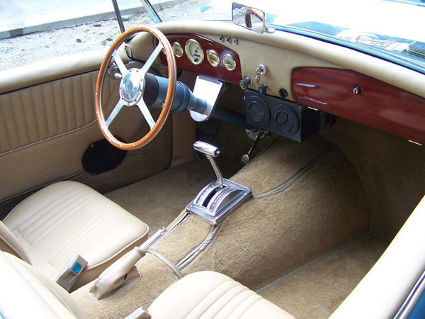

Interior: Speedway low back bucket seats. Over the shoulder seat belts. Hardwood instrument & glove compartment inserts. Sony FM-CD player, mounted in glove box. Flex drive windshield wipers. Mojave heater and defroster. 4-spoke wood steering wheel. Painless wiring harness kit (for Ford Alternator and Ford EEC-IV ECU-48).

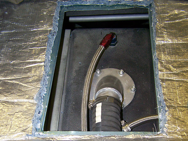

Fuel System: 16 gallon fuel cell. Ford Mustang high pressure fuel pump, mounted inside the tank. Hagans fuel filter.

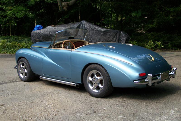

Completed: March 2010. (Driven approximately 1000 miles as of January 2011.)
Comments: Very involved projects like this inevitably include temporary setbacks. For example, we had to make two sets of exhaust headers. We had to relocate the brake master cylinder from the firewall to under the floor, which required remaking the pedals, because of packaging issues with the EFI. The first set of rear tires rubbed, so we had to install smaller diameter tires. We raised the car lift with a door open and crushed one of the doors. We dropped a Mustang seat from the loft above the car and dented a front fender. We forgot to fill diffential, and ruined its bearings. We had to replace GM fuel level sending unit in the gas tank with a Ford sending unit. We initially used hard rubber body mounts that weren't hard enough, and had to replace them with polyurethane mounts. We're still working on the seat belts to get them to work correctly.
On the plus side, the car drives very well and has excellent brakes. With its Mustang II front suspension, it handles as well as my Sunbeam Tiger, and it turns without effort. With EFI,the engine starts immediately and will idle all day at 180 degrees. I'm very pleased with the way the car has turned out!

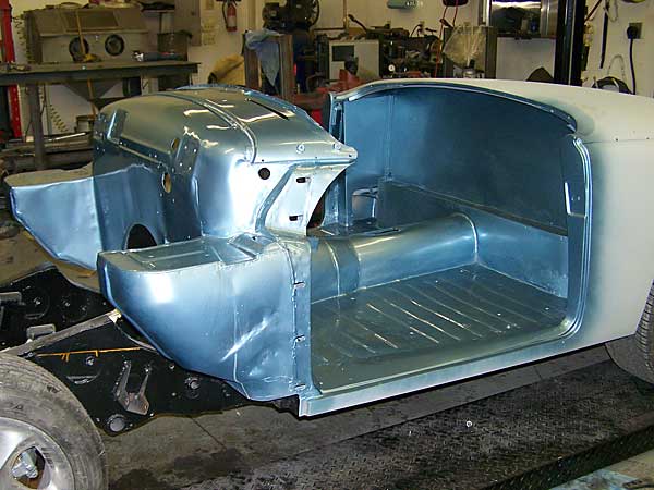

My son Jim and I completely disassembled the car and discovered it needed all new floors (including trunk, door bottoms and a new firewall.) The original "fabrication" consisted of metal screws and sheet metal sign pieces screwed together (no welding), and then everything covered with body putty. We removed the body from the frame and sent it to the dip strippers to take the body to bare metal. While the body was at the strippers, I completely modified the frame.

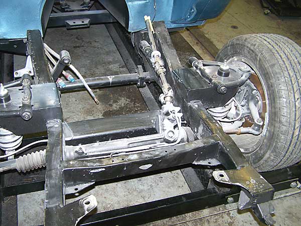

I removed the stock front end assembly and installed a Ford Mustang II crossmember, tubular A-arms, coil over shocks, Mustang II spindles, 11" disc brakes, and a power rack & pinion from "Fatman". An "Ididit" tilt steering column controls the new front end. Ford V-8 mounts were added and the stock frame x-member was removed. A new transmission mount for the Ford AOD ("automatic overdrive" four speed) was fabricated. New early-Mustang leaf springs replaced the nine leaf stock units. A new rear shackle mount had to be made for the springs. They carry a narrowed 9" Traction-Lok (3.08:1) rear end, with drum brakes. Since the stock frame is underslung, a hoop shock mount was made for the rear. A fuel cell, electric pump and braided stainless fuel lines were added including a return line for a (future) fuel injection system later.
Upon return of the body, a setback firewall and new floors (including trunk) were made from 16 gage steel and welded in. A power-boosted brake system was hung on the fire wall and new steel lines w/ residual valves were installed. Other replaced parts include: aftermarket wiring (all wiring is done by my son, Jim), taillights, 66 Mustang seats, a Mustang floor shifter, and a Lokar emergency brake lever system. After replacement of the structural panels, the car was assembled with the new parts to finish construction before painting.

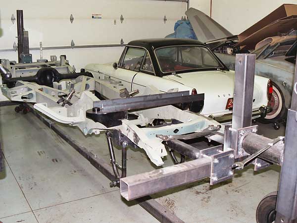

This Alpine needed to be stripped all the way down and put back together right.
auto body rotisserie
A rotisserie facilitated substantial chassis modifications.

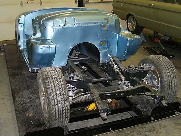

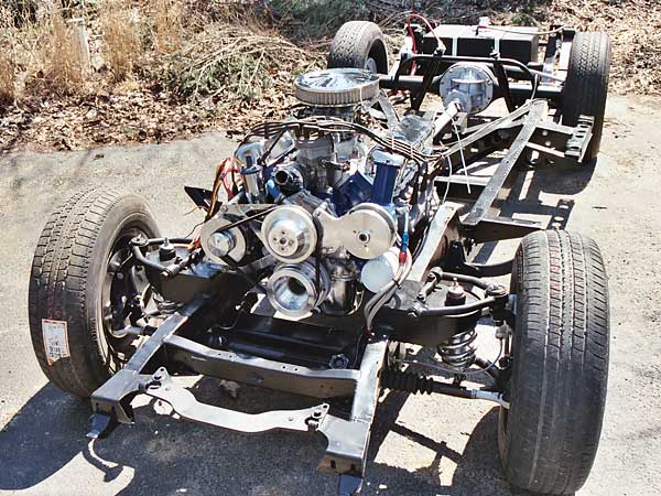

Installation of the Mustang II crossmember and spring perches.

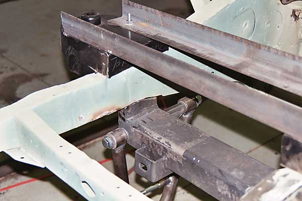

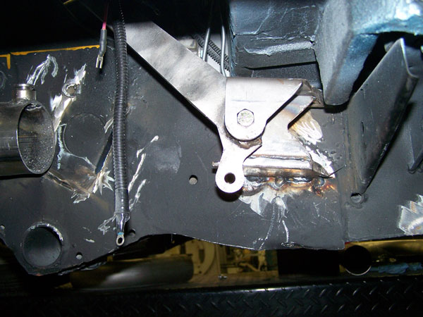

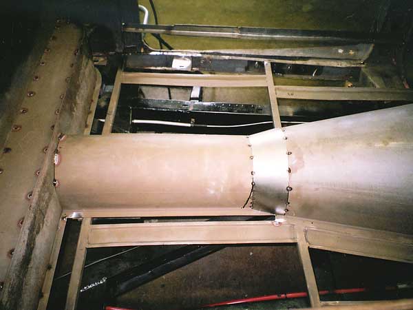

transmission, u-joint and driveshaft

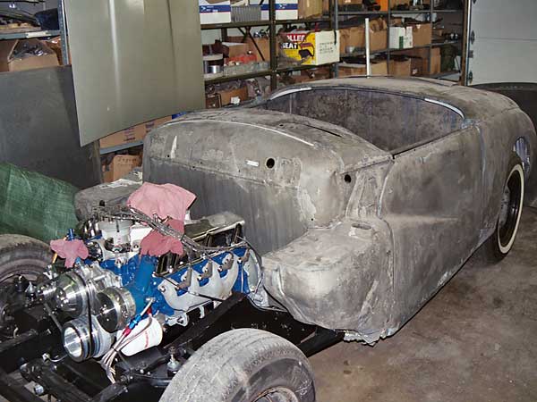

1991 Mustang 302 V8 in a Sunbeam Alpine
1991 Mustang 302 V8 engine, shown here with aftermarket intake manifold and carburetor.

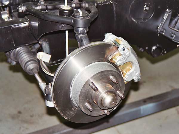

Mustang II spindle and disk brakes
11" disc brakes with vented rotors,

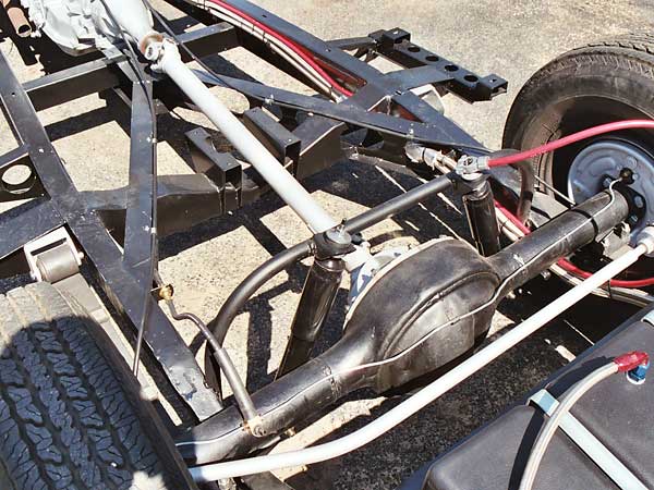

9 inch Traction-Lok rear end
Narrowed 9" Traction-Lok (3.08:1) rear end, with drum brakes.

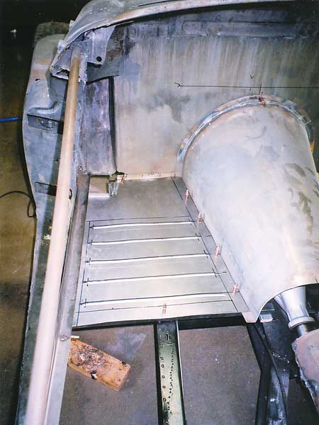

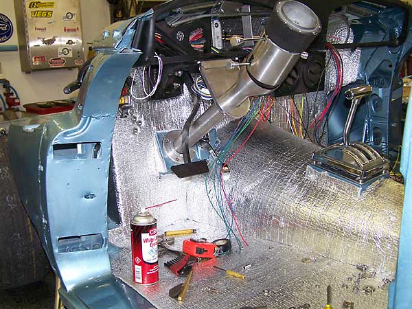

New fabricated steel transmission/driveshaft tunnel.
Embossments will stiffen the new floor and help reduce noise.

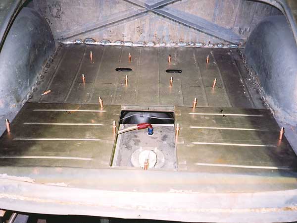

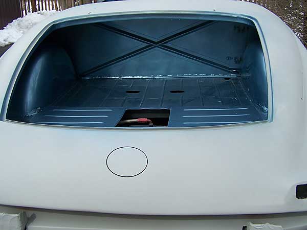

Similar floorboards were installed in the trunk area.
New power steering rack and pinion from Fatman Fabrications.

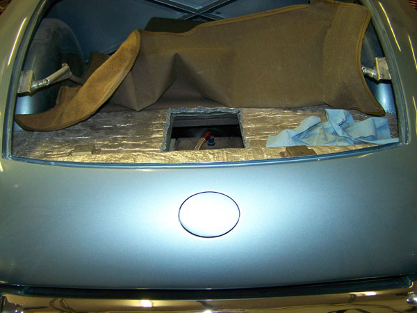

A flush-mounted fuel filler lid is part of the streamlining of this Alpine.
A removable panel will facilitate fuel system service.

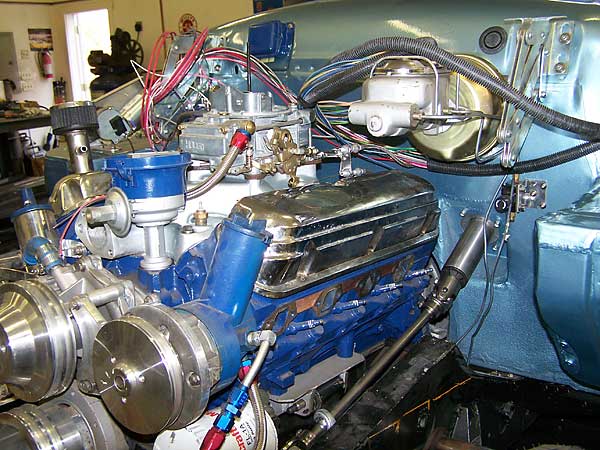

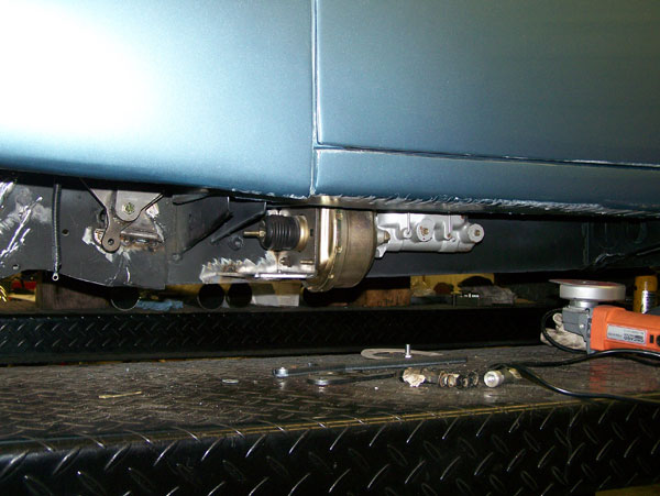

A dual-circuit master cylinder and power brakes were initially installed.
A dual-circuit master cylinder and power brakes were initially installed in the stock location.

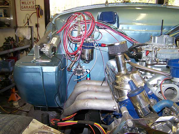

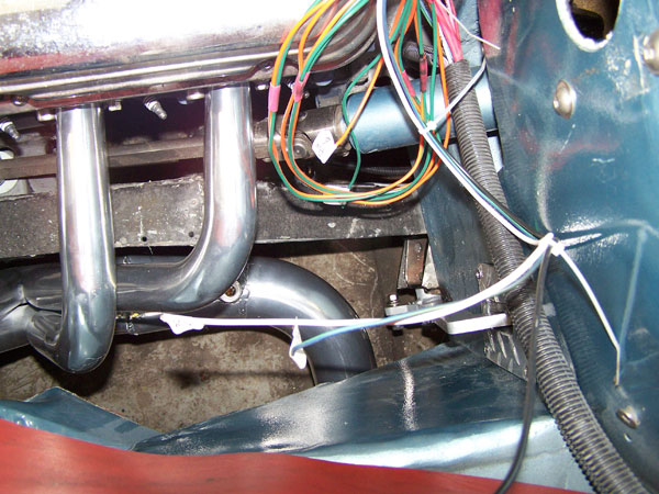

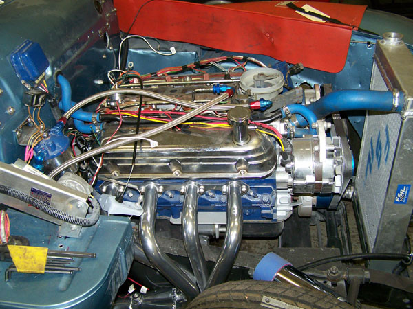

Headers were built from a nifty Speedway Motors kit.
Custom made to clear the Alpine's frame, the headers were built from a nifty Speedway Motors kit.

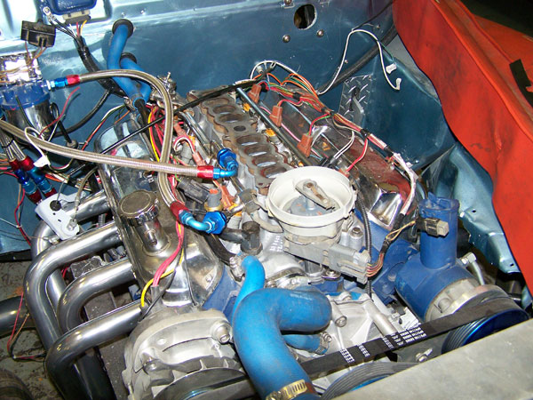

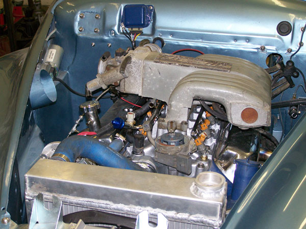

Headers come off... an entirely different induction system goes on.
The throttle cable hookup, and also the throttle valve cable for the Ford AOD tranmission.
The custom headers were ceramic coated by Esthetic Finishers in Piqua, Ohio.
FSR Racing Products (of Memphis TN) provided the custom aluminum radiator.

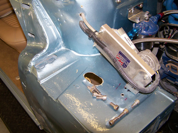

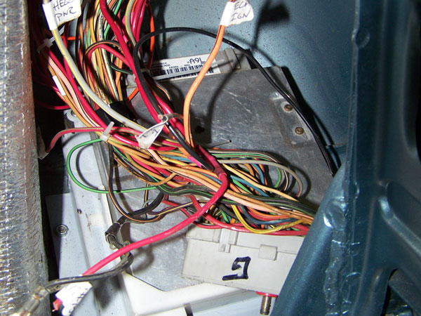

The engine control module is located in the cabin. Wiring passes through a grommet under the wiper motor.

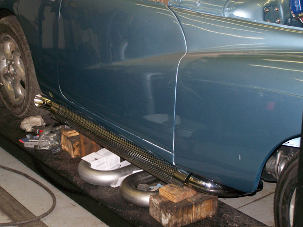

The chrome sidepipes also came from Speedway Motors.

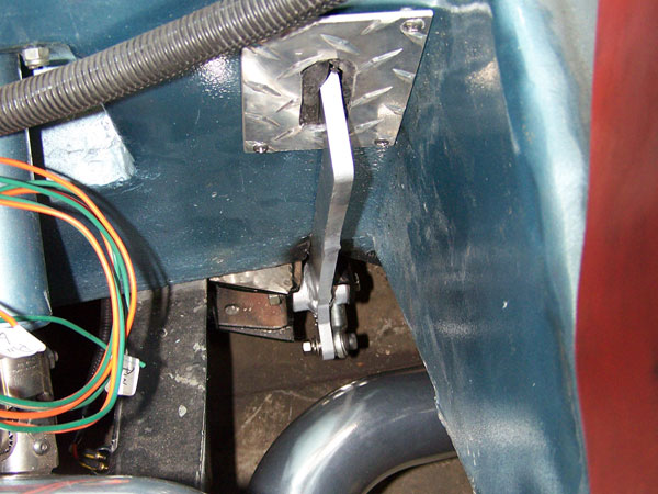

Brake System
Brake pedal linkage.
Remote brake master cylinder and power brake booster.

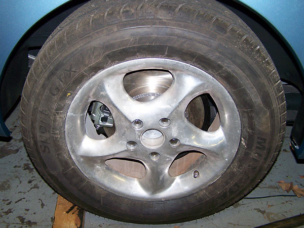

Ford 11 inch disc brake
The rear axle has now been upgraded to a Ford 11" disc brake set up.

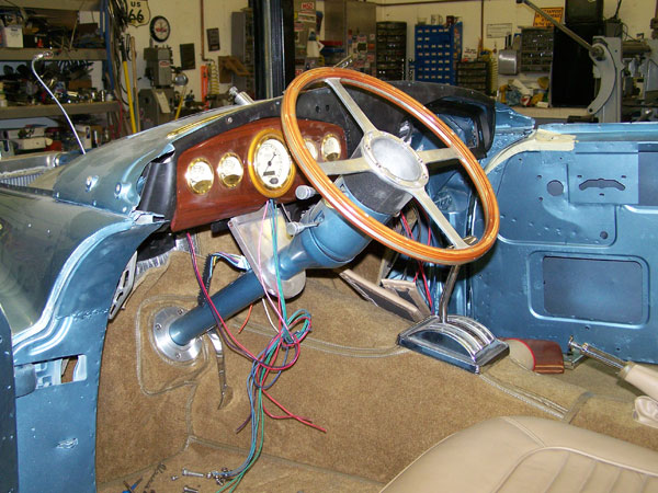

Ididit tilting steering column
Other essential components: a gear selector and an Ididit tilting steering column were fitted.

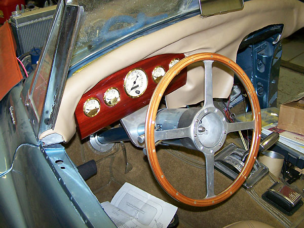

aftermarket speedometer in the original instrument panel
To fit a modern aftermarket speedometer in the original instrument panel, an adapter was required...
new Rosewood instrument panel with smaller speedometer hole
...so I made a new Rosewood instrument panel with a smaller speedometer hole.

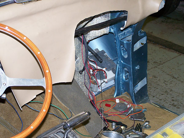

The engine ECU is tucked away into a compartment off the passenger-side footbox.
Close-up view of the engine control module.
(Close-up view of the engine control module.)

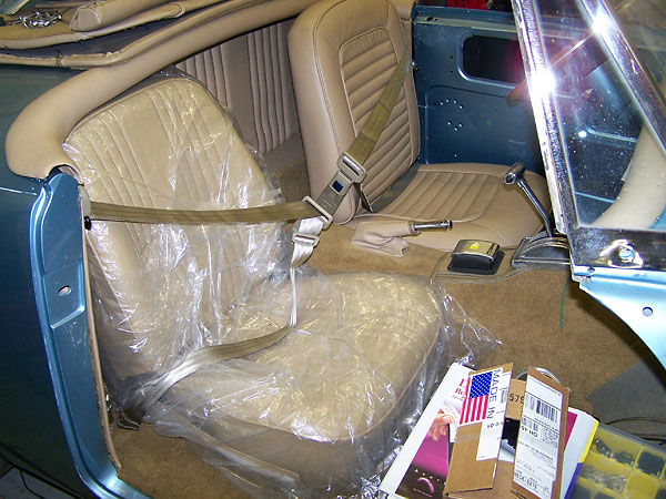

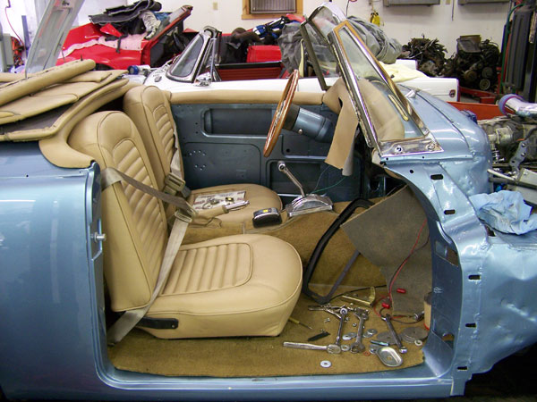

Ford Mustang seats
We considered Ford Mustang seats (shown here), but now plan to use Speedway Motors low-back bucket seats.
A Speedway low-back bucket seat is shown in this view.
Trunk insulation, and access hole for fuel tank connections.
Custom interior of Wilfred Potter's 1954 Sunbeam-Talbot Alpine
Test fitting a convertible top.
