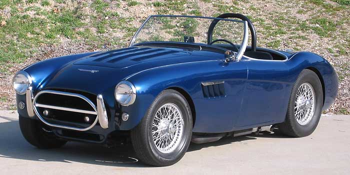

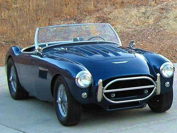

Model: 1954 Austin Healey 100
Engine: 1959 394/418ci Big Block Olds Rocket
Notice: Golden Anniversary!   This well-engineered conversion was originally completed in June 1957.
Engine: 1959 Big Block Olds "Rocket" V8 (394 cubic inch, bored to 418cid), 11:1cr, 2.1" intake valves. Polished chambers, and slight porting.
Cam: Dempsy Wilson solid lifter, 274 degree (adv), 0.490" lift at valves.
Induction: Holley 750cfm four-barrel on stock cast-iron intake manifold.
Ignition: MSD electronic.
Exhaust: 3 inch pipes into tiny Spintech mufflers, with outlet ahead of the rear wheels.
Cooling: 1954 Chrysler Imperial radiator. 16" electric fan (pushing).
Transmission: 1937 3spd La Salle toploader (1:1 high). 11 inch clutch with 2300lb pressure plate.
13" driveshaft (half Cadillac, half Chevy, with Cadillac U-joints).
Rear End: Narrowed '56 Chevy, 3.54:1, '57 Positraction.
Front Suspension: Stock double A-arm with added telescoping shocks.
Rear Suspension: Stock leaf springs, Panhard rod, rearward traction arms.
Wheels: Original (but reinforced) 15" 48-spoke knock-offs, 70 series tires (205 front, 225 rear).
Brakes: Stock drums all around. Porterfield carbon Kevlar front shoes.
Curb weight: 2486 lbs (Full 12 gallon fuel tank. No driver.)
Instruments: Stock oil/water, fuel, front-wheel timer/speedometer. Auto Gage tachometer.
Performance: Quarter mile at 118mph in 13.1 seconds on street tires.
0 to 30mph in 1.4 seconds. 0 to 60mph in 3.8 seconds.
Date Completed:
Engine installed in 1957. Body mods in 1964. Restored in 2000.
Comments : This car was probably the first big-block V8 Healey ever constructed!
The original engine swap was completed in early 1957 with a 1949 303cid (bored to 348cid) big-block Oldsmobile engine. The present 1959 Oldsmobile engine is nominally a 394cid, but it was bored to 418cid. It was installed in 1964. The oval nose extension and all other body modifications were also performed in 1964.
My advice is to get the biggest engine available and mount it back as far as possible. A stock 1954 Healey has a curb weight of 2300# with 50/50 front-to-rear weight distribution. My car, with its big-block Olds engine has a curb weight of 2486#, with 47/53 front-to-rear weight distribution. The engine setback is 23.3 percent. (In other words, the engine's number 1 spark plug is 21" back along the car's 90" wheelbase.)
Don't be intimidated. Everything is learned by doing, and by fixing things when they break. Make things as light as possible, then strengthen them slightly when they break.

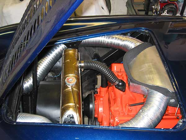

Austin-Healey 100/4 V8 conversion engine

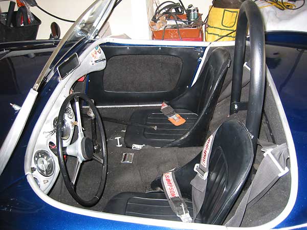

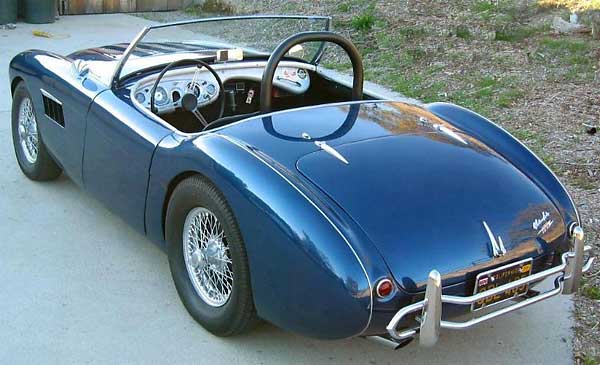

Austin Healey interior

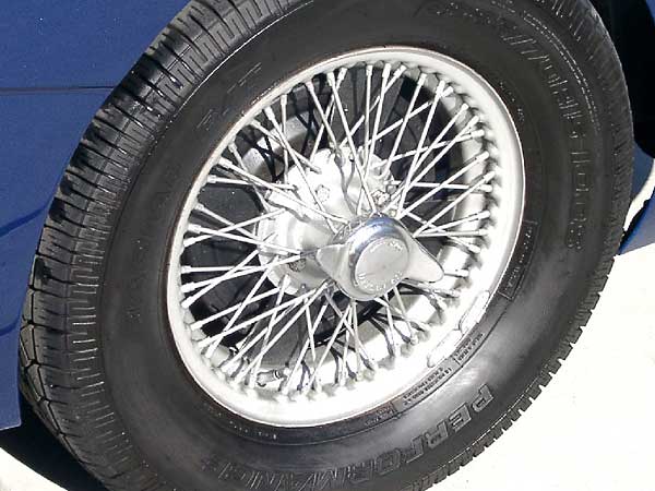

Reinforced spoke wheel

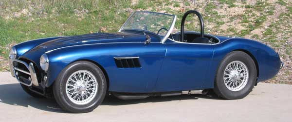

Austin Healey side view
Austin Healey front view
Austin Healey rear view

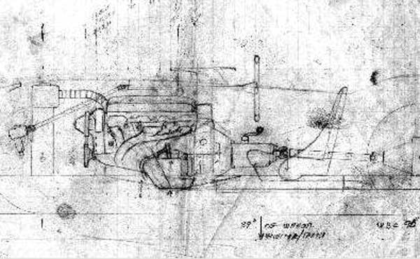

The Olds engine/tranny weighed 120 pounds more than the stock Healey. The narrowed Chevy rear axle added another 60 pounds, but was all in back so it lessened the required setback. This meant the Olds would have to be moved back from the Healey engine location some 15 inches to obtain the desired 47/53 weight distribution. Since the Olds and Healey engines were roughly the same length, almost half the Olds would be under the cowling!

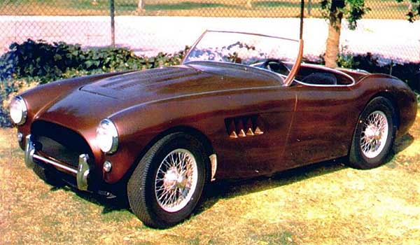

After V8 install, but before the body mods of 1964. (Note the original grille)
1957: After V8 install, but before the body mods of 1964. (Note the original grille).

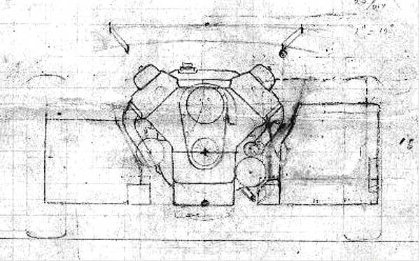

Original sketch to determine hood clearance and calculate weight distribution
1957: Original sketch to determine hood clearance and calculate weight distribution.
Further verification of hood clearance
1957: Further verification of hood clearance.

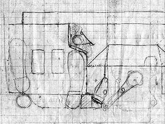

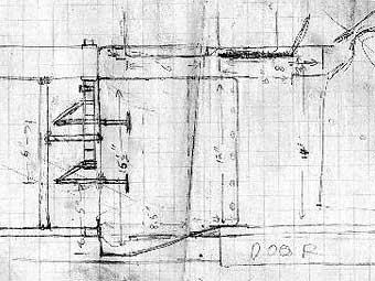

Modified Austin-Healey pedal box   Planning of the pedal box
1957: Planning of the pedal box.

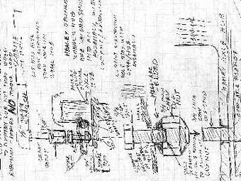

Initial sketch of the flywheel shield and plans for wheel modifications   Reinforcement of the spoke wheels to handle V8 torque
1957: Initial sketch of the flywheel shield and plans for wheel modifications.

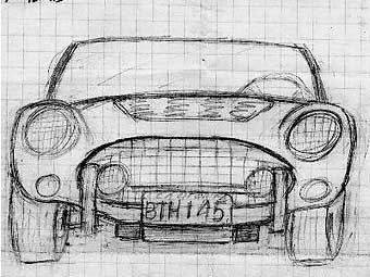

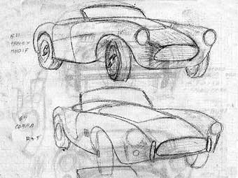

Cobra-style fish mouth grille   Concept sketches of the Cobra-inspired new front grille
1964: Concept sketches of the Cobra-inspired new front grille.

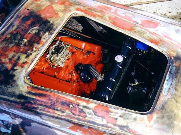

In-process photo taken during the restoration
2000: In-process photo taken during the restoration.
