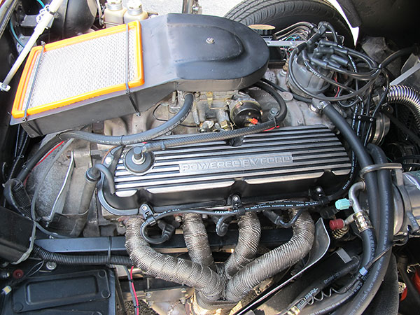

Engine: Ford 302 cubic inch engine. Edelbrock Performer intake manifold. Edelbrock carburetor with electrical choke. Custom fabricated air cleaner housing. Taylor Pro Wire 8mm spark plug wires. Sanden air conditioner compressor. "Powered by Ford" aluminum valve covers. Electronic cruise control.

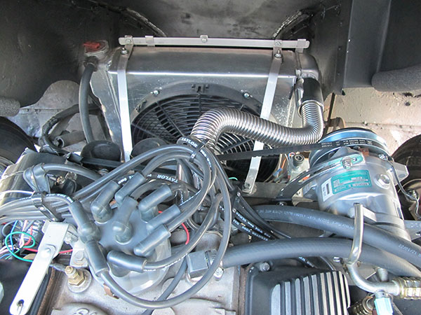

Cooling: aluminum radiator. Electric fan. Adjustable thermostatic fan controller. Custom fabricated aluminum fan shroud.

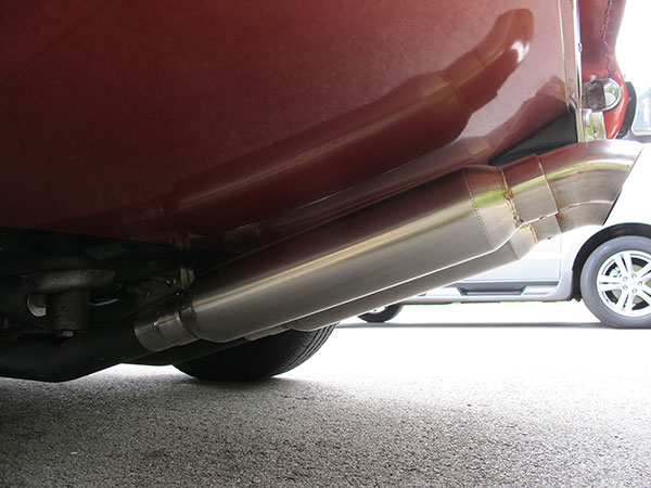

Exhaust: four into one headers, wrapped. 2-1/4" exhaust pipes. Magnaflow mufflers and resonators.

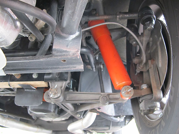

Front Suspension: stock Jaguar

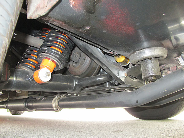

Rear Suspension: stock Jaguar.

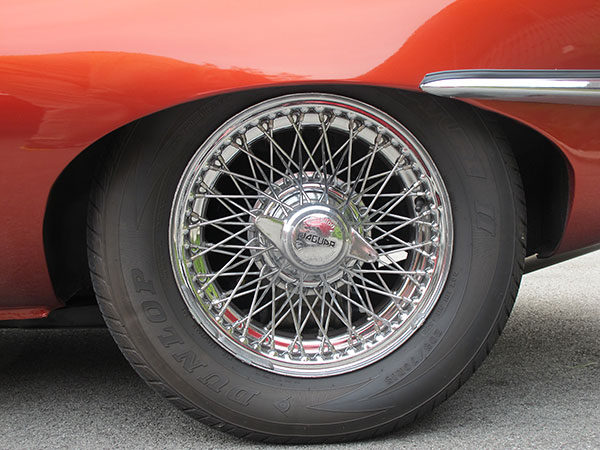

Wheels/Tires: stock Jaguar 72-spoke wire wheels. Dunlop Signature II tires (size 205/70R15).

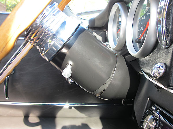

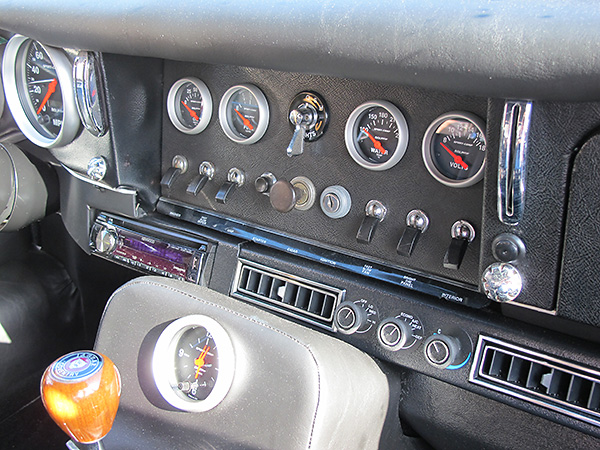

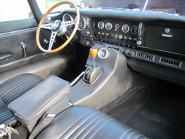

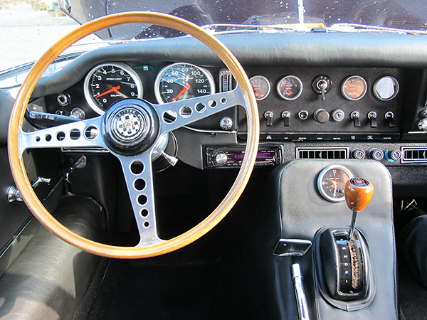

Interior: Kenwood AM/FM/CD stereo (model KDC-355U). Cruise control. Vintage Air HVAC unit. Ididit tilt-adjustable steering column. New seats. Custom center console and armrest.
Instruments: (left to right) Autometer Sport-Comp tachometer (0-10,000 RPM), GPS speedometer (0-160 MPH), oil pressure (0-100 PSI), fuel level (E-F), coolant temperature (0-250 F), voltmeter (0-18 V), and clock.

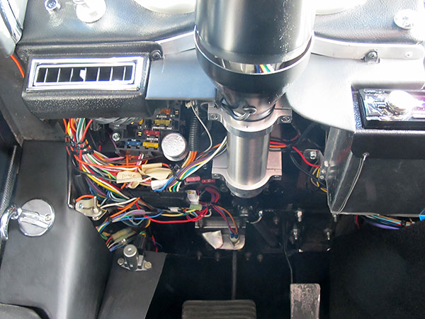

Electrical: 22-circuit, GM-style, color-coded wiring harness. Duralast Gold battery (size 75-DLG, 770 CCA). X Scorpion 150A main fuse.

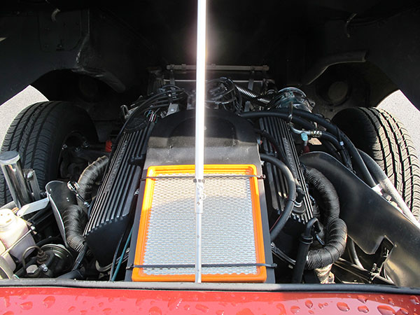

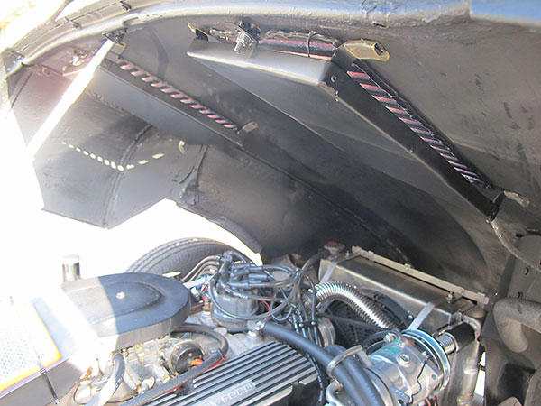

Engine Bay
This was the second V8 installed...
Tim wrote: "This was the second V8 installed, with the first in the early 1970s.
It wasn't running when I bought it, but the bones were good."
Tim fabricated new alternator and AC compressor brackets, a fan shroud, and a custom air cleaner.

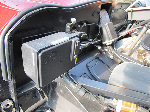

Air reservoir for electronically controlled, pneumatically actuated cruise control system.

Powered by Ford aluminum valve covers.
Aluminum radiator and custom fabricated fan shroud.

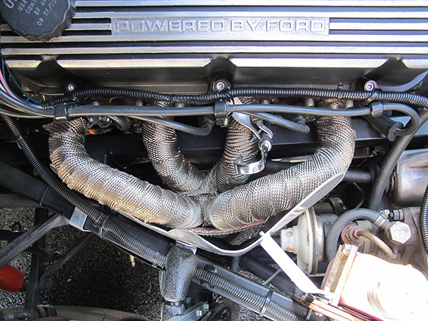

Four into one headers, wrapped.
Electronic cruise control module.

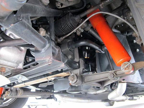

Suspension
Jaguar E-type bonnet hinge and support structure.
Stock Jaguar front suspension.
Stock E-type front suspension, with uncommonly low unsprung weight for its era.
(Torsion springs are difficult to see or photograph with the car on the ground.)

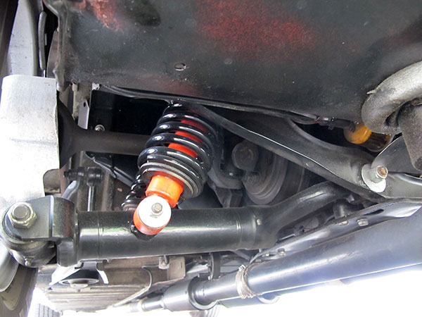

Stock Jaguar rear suspension. Note inboard disc brakes.
Stock Jaguar rear suspension. Note dual coilover shock absorbers per side.

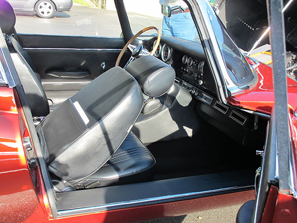

1967 Jaguar XKE dashboard, with well integrated air conditioning duct, vents, and controls.
Autometer Sport-Comp instruments.

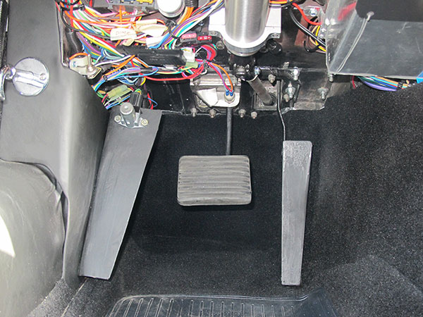

Dead pedal and highbeam/lowbeam selector switch.
New seats.
New seats.
Gear selector for Ford (Lincoln) AOD transmission. Custom center console and armrest.

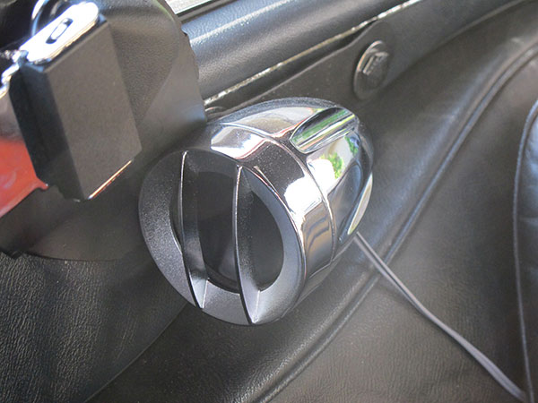

Vintage speakers.
Vintage speakers.
Vintage speakers.
Vintage speakers.

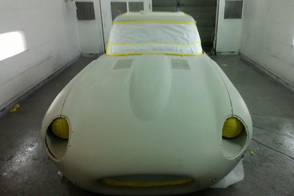

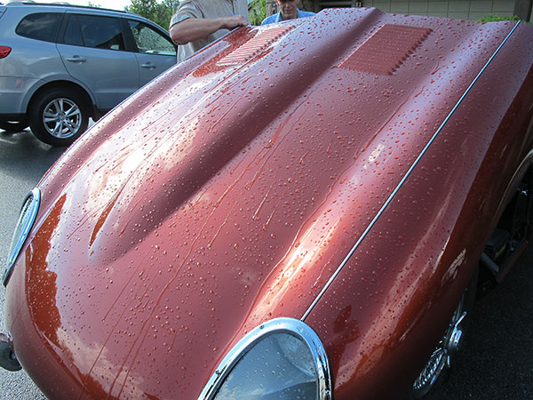

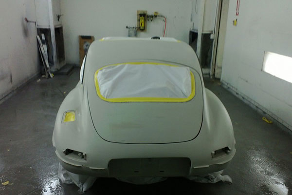

Body Work
Tim did the body repairs himself, and then had the car stripped and repainted.

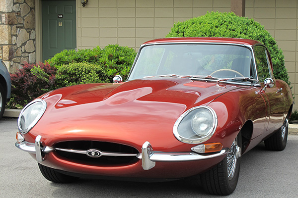

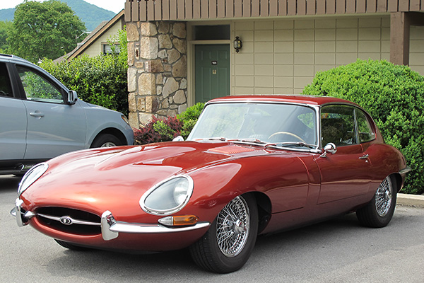

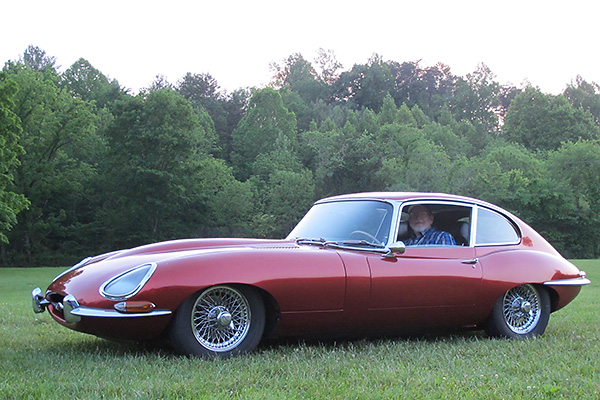

Jaguar XKE 2+2 (front 3/4 view)
1967 Jaguar XKE 2+2.

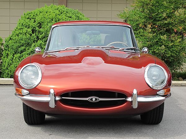

1967 Jaguar XKE 2+2 (front view)
1967 Jaguar XKE 2+2 (front view).

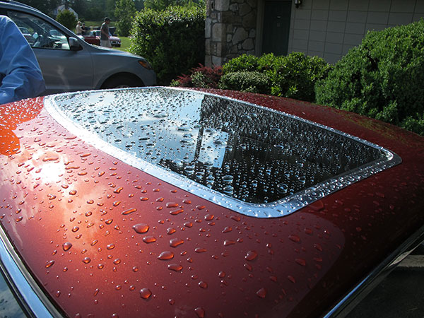

Sunroof.
Sunroof.

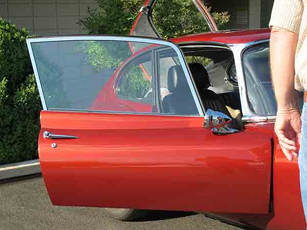

Jaguar XKE 2+2 door (exterior).

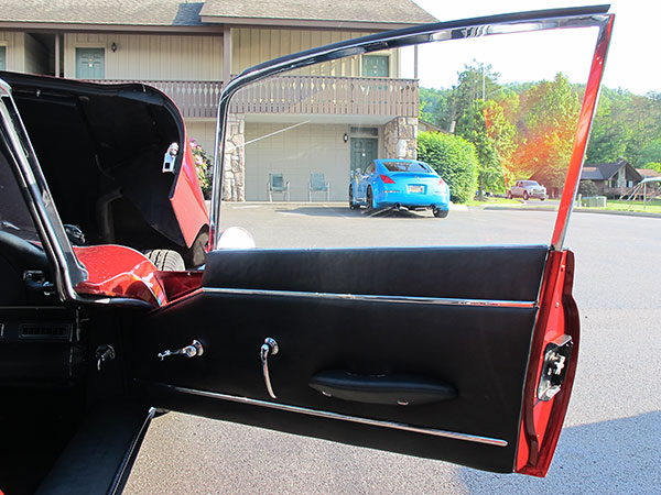

Jaguar XKE 2+2 door (interior).

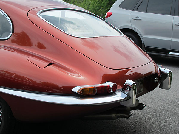

Jaguar XKE 2+2 tailgate (closed).
Jaguar XKE 2+2 tailgate (open).
Magnaflow resonators.
Stock Jaguar 72-spoke wire wheels.
