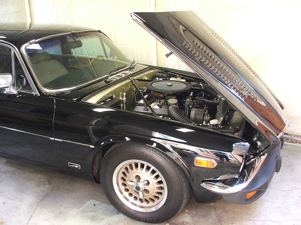

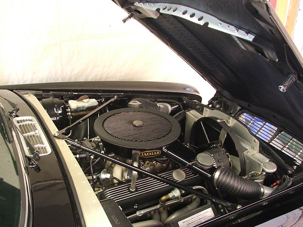

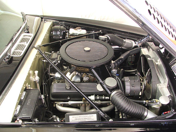

Engine: Chevrolet 383 stroker V8

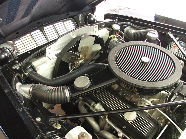

Engine: Chevrolet 383 stroker V8. Balanced. ~9.5:1 static compression ratio. Comp' Cams #12-235-2 camshaft (0.447"/0.462" lift, 210°/218° duration, 111° separation.) World Products S/R Torquer cylinder heads. 2.02" intake and 1.60" exhaust valves. Z28 springs. Edelbrock Performer EGR intake manifold. Edelbrock Performer 600cfm carburetor. Delco HEI ignition, augmented with MSD6AL capacitive discharge system.
Cooling: 4-row GM radiator. Perma-Cool oil cooler with 180° thermostat.

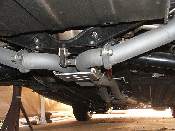

Exhaust: Sanderson CC2 headers with air injection added. 2.5" exhaust system with mandrel bends and a crossover pipe. Magnaflow mufflers.

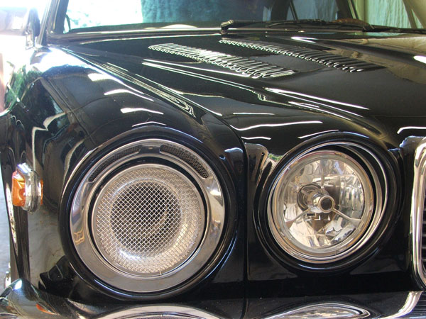

Other: Louvered hood. Outer headlights converted to ram-air intakes.

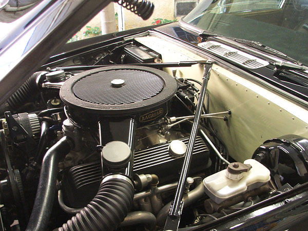

Chevrolet 383 stroker V8 with World Products S/R Torquer cylinder heads.
MSD6AL capacitive discharge ignition system, mounted on the passenger side inner fender.

Outer headlights have been replaced with ram-air intakes.

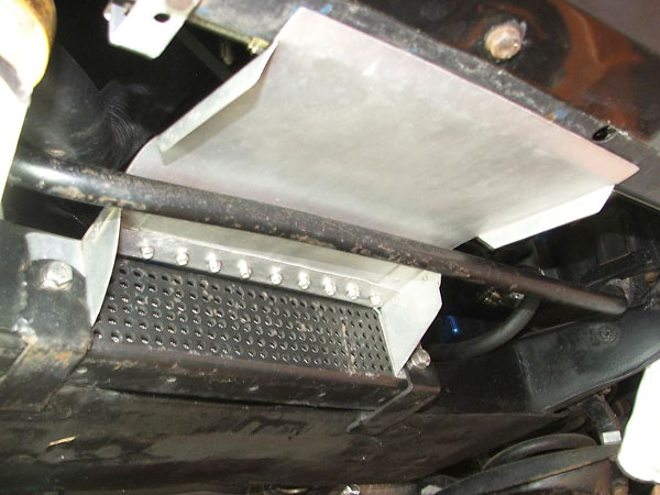

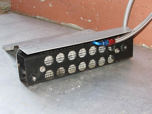

Fuel cooler duct and protective grille.

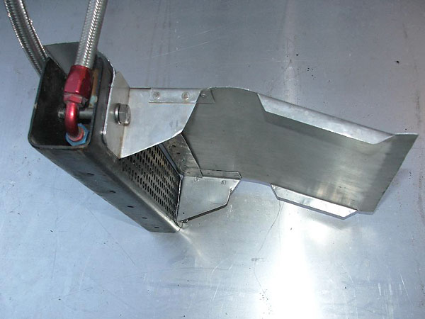

Rear view of the fuel cooler, and of its protective bracket.
Fuel cooler, installed.

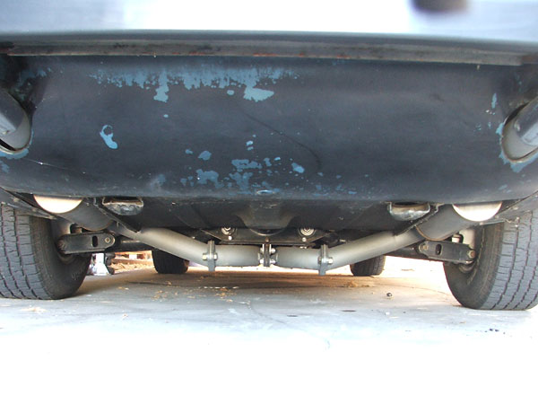

2.5 inch exhaust system with mandrel bends and a crossover pipe.
Dual Magnaflow mufflers.

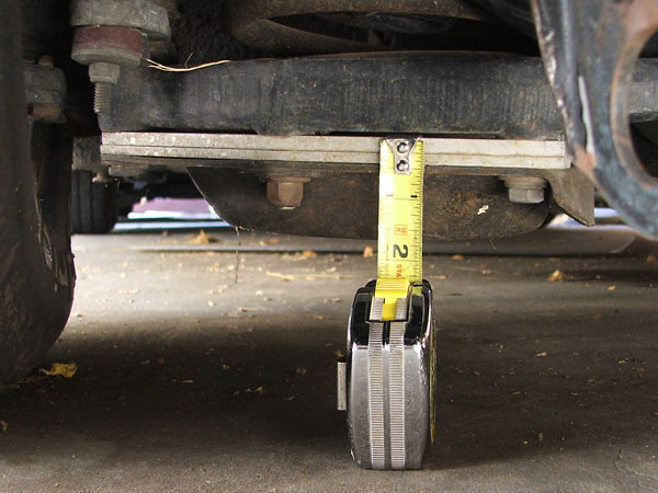

The front suspension has been lowered approximately two inches.
