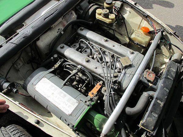

Engine: stock 1974 Alfa Romeo 1962cc, dual overhead camshaft, inline-four. Stock SPICA (Societˆ Pompe Iniezione Cassani & Affini) mechanical fuel injection system.
Cooling: stock 1974 Alfa Romeo Spider copper and brass radiator. Engine driven six-blade plastic fan, without shroud. Finned aluminum oil pan.
Exhaust: stock 1974 Alfa Romeo Spider cast iron exhaust manifold.

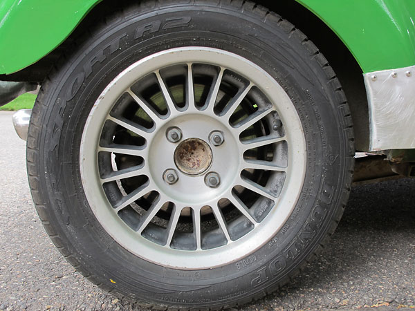

Wheels/Tires: Made in Britain, 14x6, 12mm offset, aluminum wheels. Dunlop SP Sport A2 tires, size P195/60R14.

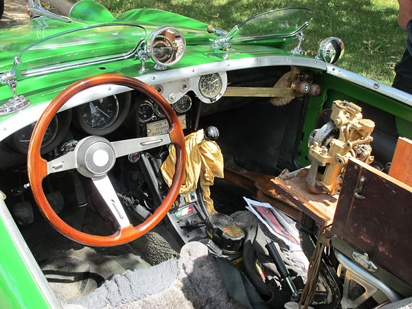

Interior: stock Alfa Romeo Spider "Personal" steering wheel.
Instruments: stock 1974 Alfa Romeo Spider instruments, left to right: tachometer (0-8000rpm), speedometer (0-140mph), coolant temperature (100-260F), fuel level (0-1), and oil pressure (0-114psi). Artificial horizon, air speed indicator, and altimeter. (All are functional.)

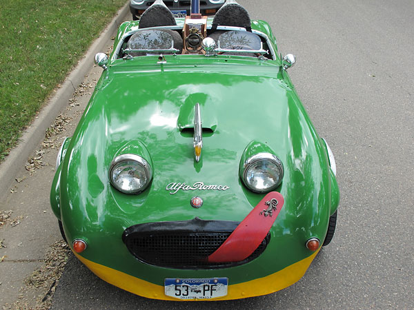

Body: 1959 Austin Healey Sprite body. Custom air dam. Custom tongue-shaped front nerf bar. 1953 Pontiac Chieftain hood ornament. Custom hood scoop. Dual Brooklands-style windscreens. Custom front and rear fender flares. Custom headrest cowls. Custom tail fin with functional rudder.

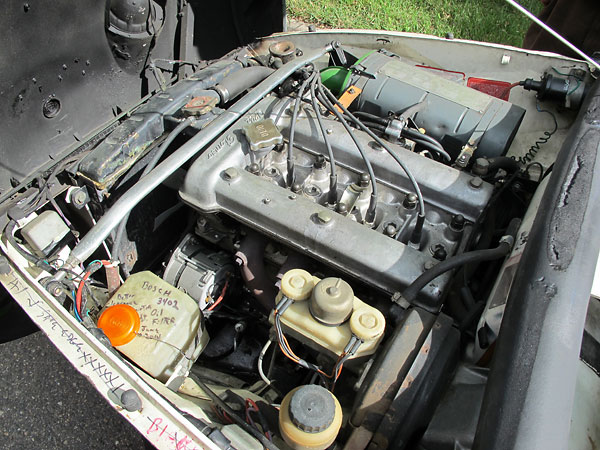

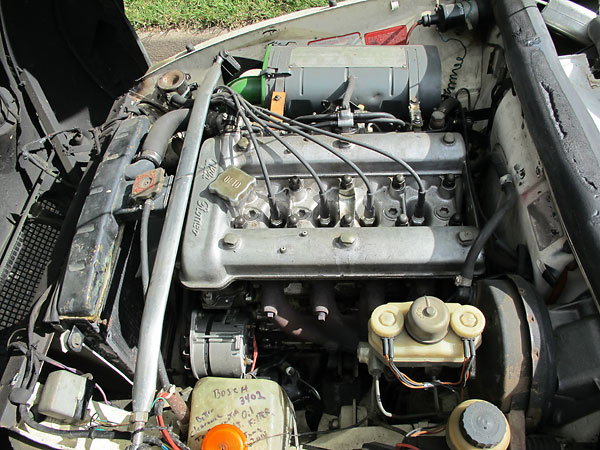

Aluminum engine blocks with cast iron liners.
Good things about Alfa Romeo Spider engines: aluminum engine blocks with cast iron liners, forged
steel crankshafts with five main bearings, aluminum cylinder heads with hemispherical combustion
chambers and centered spark plugs, and dual overhead camshafts driven by double-row timing chains.
Large, finned, 7-quart capacity oil pan.

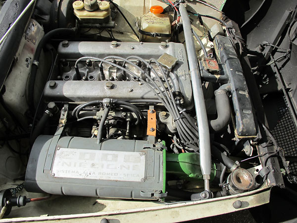

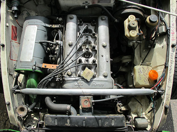

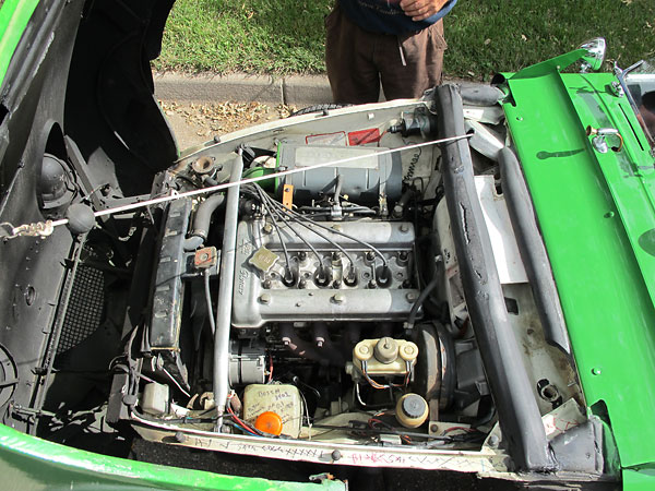

There was no need to upgrade this car's radiator or cooling fan. Alfa Romeo Spider engines
feature a large, finned, 7-quart capacity oil pan. They have a reputation for running cool.
Monte Carlo bar.
The stylish aluminum brace across this engine bay would tie together the strut
towers, if only there were strut towers. It was adapted from some other car.

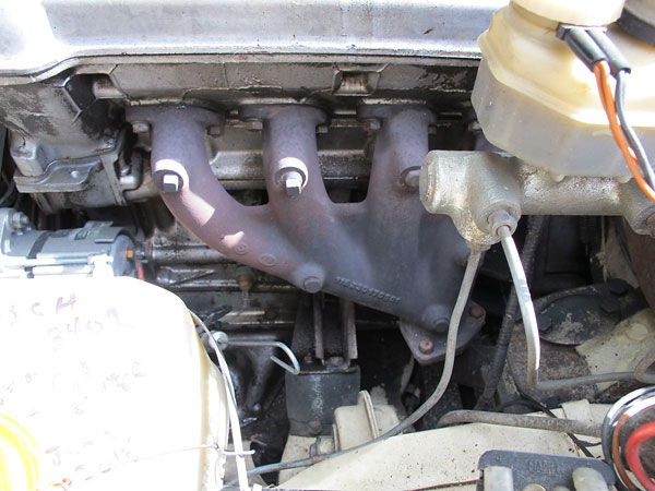

Stock 1974 Alfa Romeo cast iron exhaust manifold.
SPICA (Societˆ Pompe Iniezione Cassani & Affini) mechanical fuel injection.
2000 Iniezione Sistema Alfa Romeo - Spica, Patented 3146770 - 3312208 - 3577978
Decal: "2000 Iniezione Sistema Alfa Romeo - Spica, Patented 3146770 - 3312208 - 3577978"
A clothesline reel is used to limit travel of the front clip.

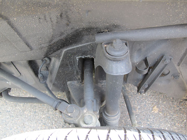

Suspension and Brakes
Stock 1974 Alfa Romeo Spider wishbones, coil springs, and telescopic dampers.

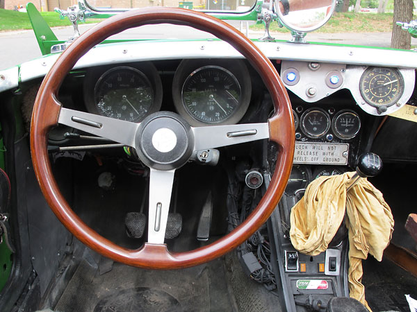

Alfa Romeo - Personal - steering wheel.
Alfa Romeo "Personal" steering wheel.
Stock 1974 Alfa Romeo instruments.
Stock 1974 Alfa Romeo instruments, left to right: tachometer (0-8000rpm), speedometer (0-140mph),
fuel level, oil pressure, and coolant temperature gauges plus an air speed indicator gauge,
an artificial horizon, and an altimeter. (All these guages are functional.)

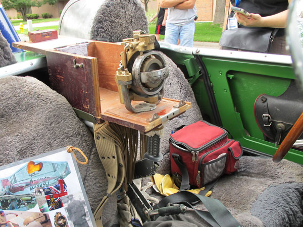

At right, a graduated brass lever from a Fairbanks Scale.
Plate in center says: "Lock Will Not Release With Wheels Off Ground".

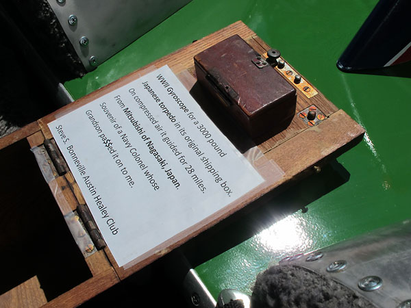

18-pound brass gyroscope off a Japanese WWII-era 3000 pound torpedo.
Manufactured by Mitsubishi in Nagasaki Japan.
Manufactured by Mitsubishi in Nagasaki Japan, it's still in its original wooden shipping box.
A U.S. Navy Colonel brought it home as a souvenir.

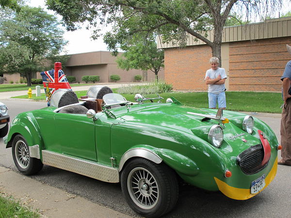

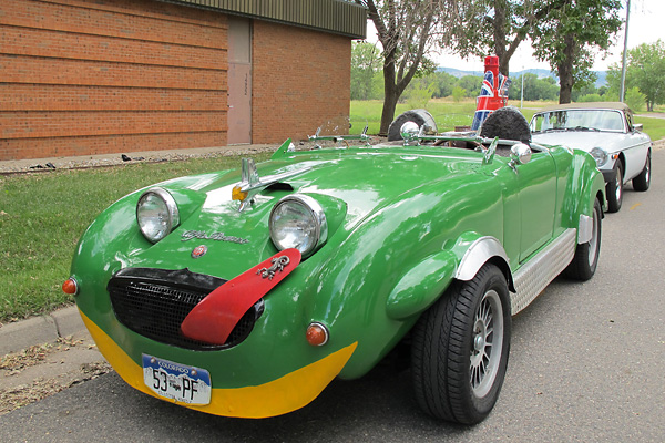

600 pounds less than an original 1974 Alfa Romeo
Steve's Tadpole - "a little frog with a tailfin" - weighs about 600 pounds less
than the original 1974 Alfa Romeo Spider did before the body transplant.
It's amazing how much rubber bumpers and roll-up windows weigh.
Steve commented: "It's amazing how much rubber bumpers and roll-up windows
add to the weight of a sports car."

Italian Spider mated with British frog.
"Yes, I mated an Italian Spider with a British frog. Foreplay took 4 years."

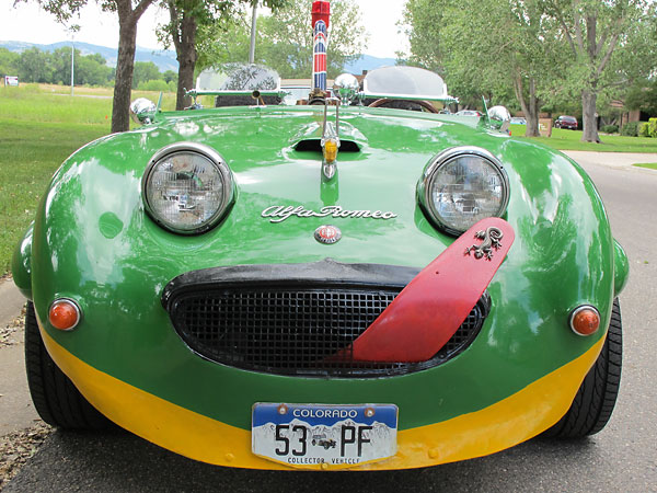

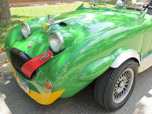

Nerf bar.
The red tongue is a bent propeller tip. Steve notes that it serves as a
nerf bar and "it's stronger than the plastic bumper on any new car."

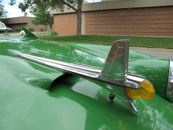

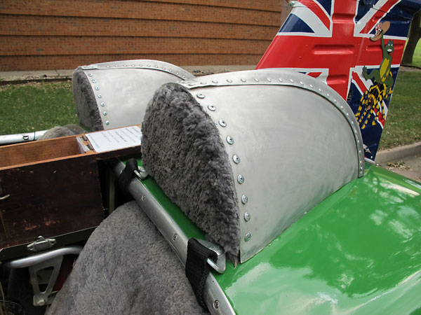

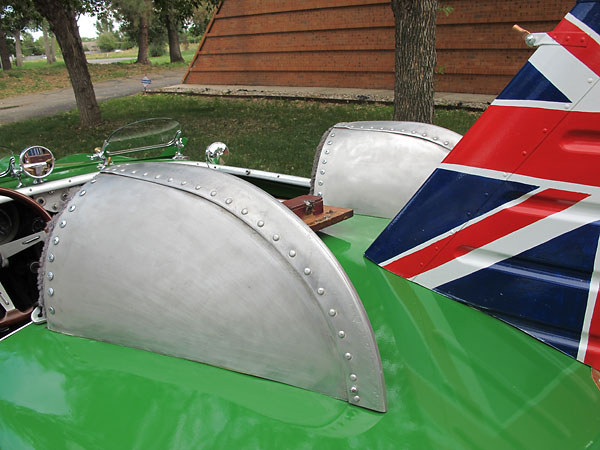

Steve made headrest fairings out of the tips of an aluminum canoe.
Steve purchased the canoe for the price of the scrap aluminum.

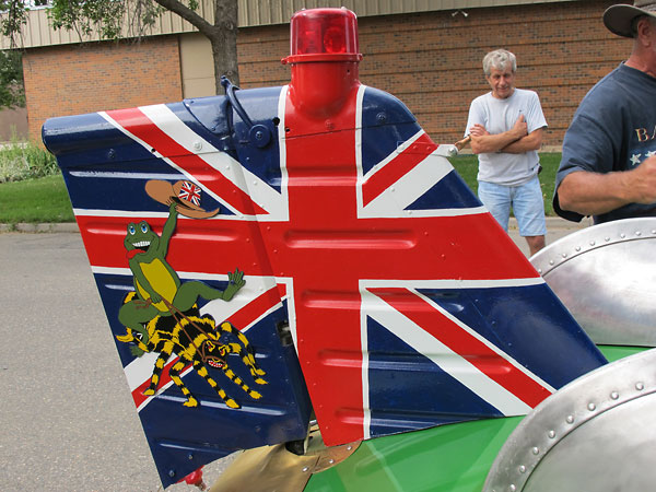

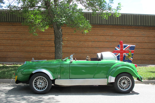

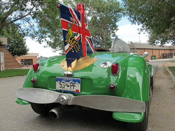

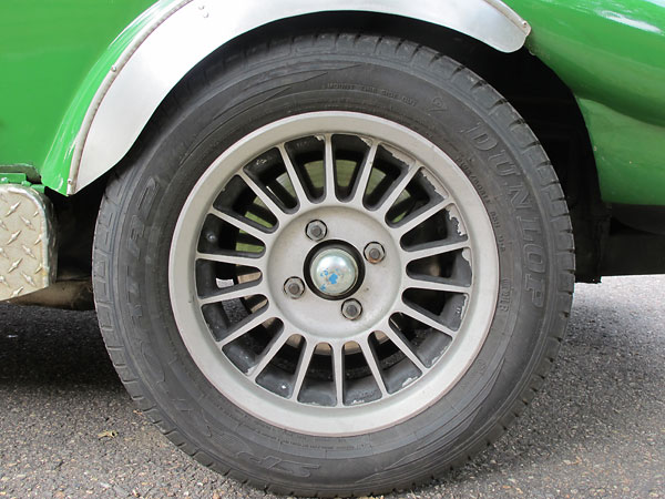

Tailfin from a Piper Cherokee.
The tailfin is off a Piper Cherokee from North Dakota that died when a tornado destroyed its hanger.
It swings left and right with the turn signal indicators, via Mercury outboard motor choke solenoids.
The strobe atop the tailfin runs on a separate 18-Volt DeWalt battery. 12 Volts proved insufficient
