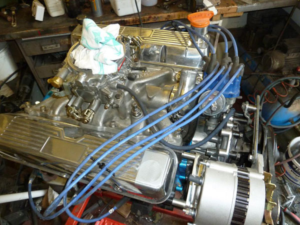

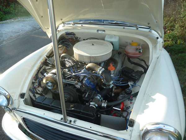

Engine: Land Rover Discovery 3.5L V8. Standard Rover cylinder heads. Edelbrock Performer 2198 intake manifold. Edelbrock 500cfm four barrel carburetor (p/n 1404). Edelbrock air cleaner. Lucas distributor. Electromotive breakerless ignition module.
Cooling: MGB GT V8 radiator. Electric fan.
Exhaust: four-into-one block hugger headers. Home made exhaust pipes.

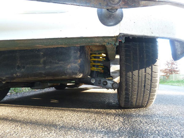

Rear Suspension: Jaguar independent rear suspension. Four Monroe (coilover) shock absorbers.

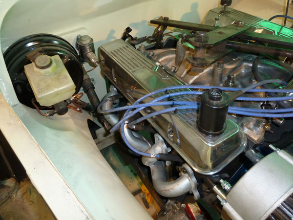

Brakes: (master) modified Land Rover Discovery pedal box and servo.

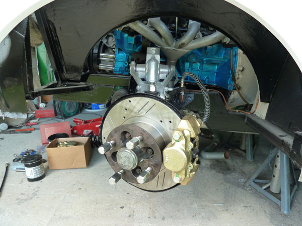

(front) MGB calipers. EBC drilled/slotted rotors.

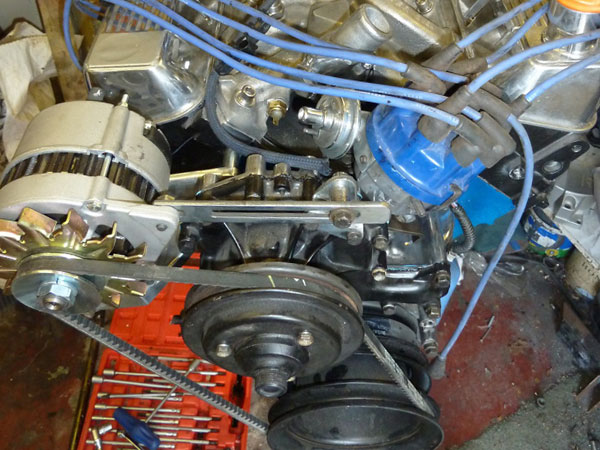

Fan belt, pulleys, and accessory installation.
Edelbrock Performer 2198 intake manifold and Edelbrock 500cfm four barrel carburetor (p/n 1404).

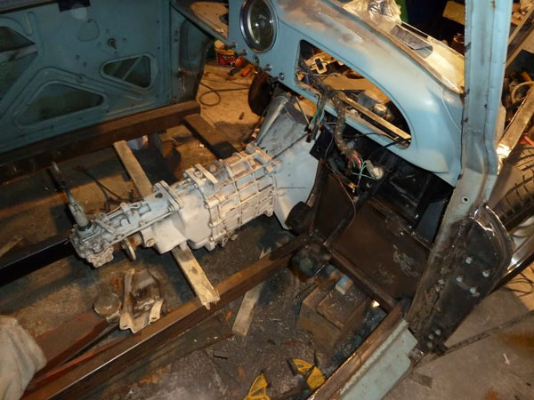

Trial fitting the Rover LT77 5-speed manual transmission.

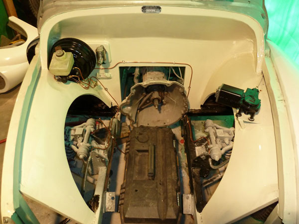

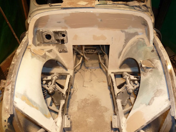

Steve: "The left inner wing was made by using the wheelarch section of the righthand wing and
the right inner wing was made by using the lefthand wing. These were then welded into place.
Modified Land Rover Discovery pedal box and servo.

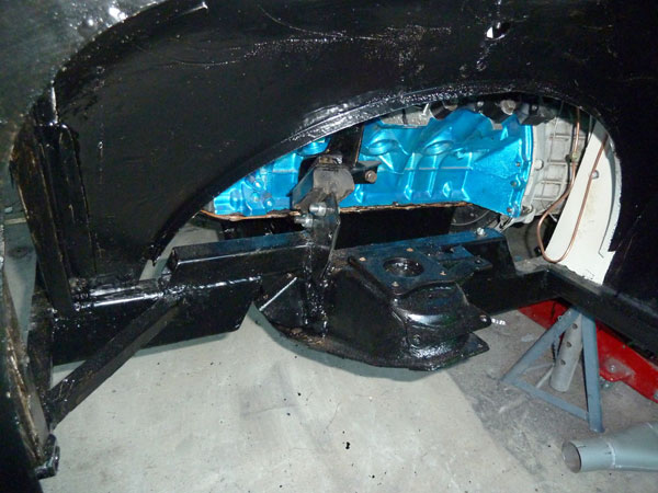

Steve: "I initially installed a Jaguar front suspension, but I found that the steering geometry
was unworkable. After a chance conversation with an MGB owner, I decided to cut off the
Jaguar unit and weld on an MGB crossmember. It turned out to be a much better solution."
Note also: modified Land Rover Discovery pedal box and brake servo.

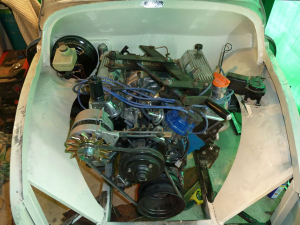

Trial engine installation.
Trial engine installation. (Note that Jaguar front suspension has been removed.)
Four-into-one block hugger headers.
Another shot of the engine, this time with the MGB crossmember in place.
Front Suspension
MGB front suspension crossmember welded into place in a Morris Minor.
MGB front brakes, slightly upgraded with drilled and slotted rotors.

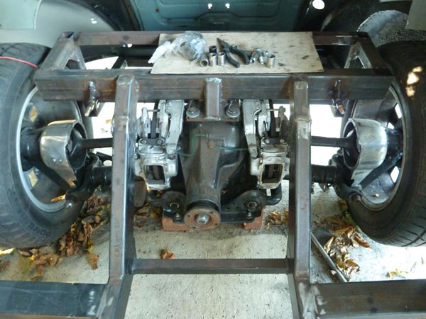

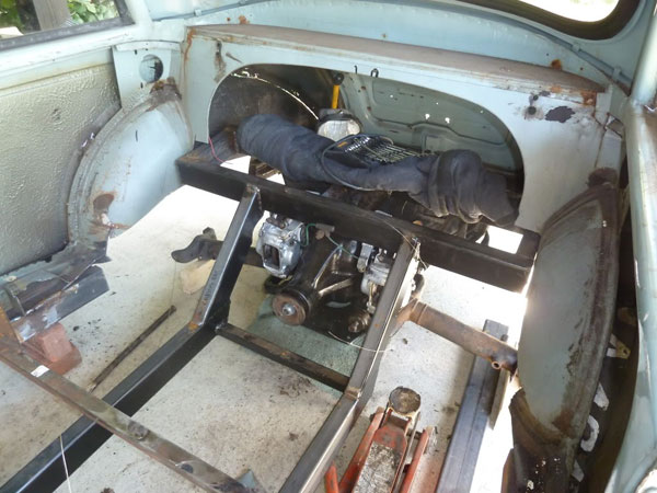

Rear Suspension
3x2 steel box-section tubing in place of original framerails. Cross-bracing extends to outer rails.
3"x2" steel box-section tubing in place of original framerails. Cross-bracing extends to outer rails.

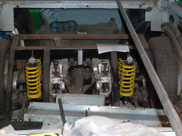

Jaguar inboard mounted calipers and rotors.
Jaguar inboard mounted calipers and rotors. Note also narrowed control arms.
Plenty of room for wider rear wheels and tires.

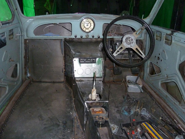

New floorboards and custom fabricated transmission/driveshaft tunnel.

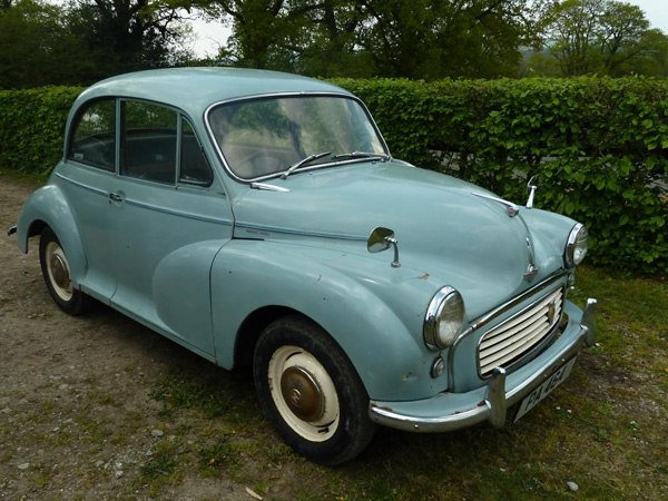

The Before Picture: a stock 1963 Morris Minor 2-door.
The Before Picture: a stock 1963 Morris Minor 2-door. Steve wrote: "I paid £800 for it,
as it was a runner and still had 6 months (to go on the) MOT certificate."
The Morris Minor model was tremendously successful, so replacement panels are available.
The Morris Minor model was tremendously successful, so replacement panels are still available.

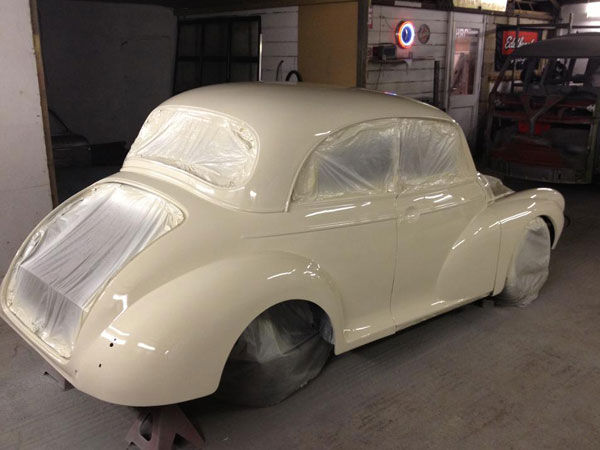

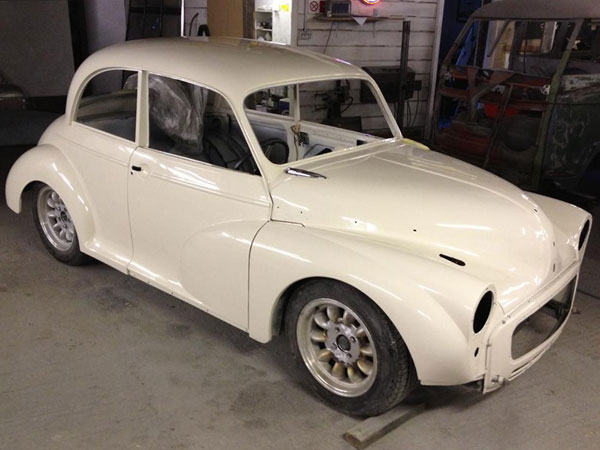

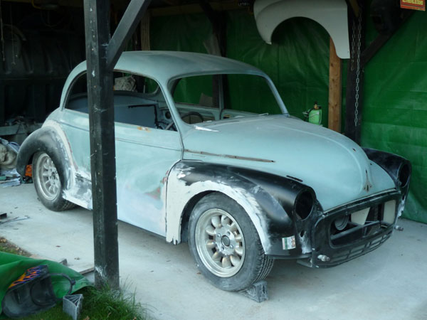

Steve reprofiled the front wheel arches to suit larger tires better.
Rear wings have been welded into the body.
For a seamless look, rear wings have been welded into the body.

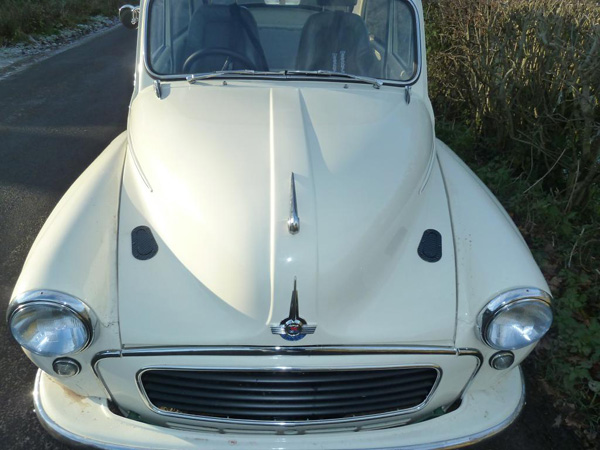

Old English White.
Old English White.

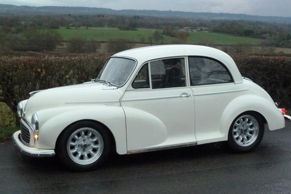

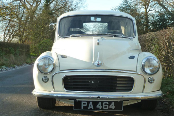

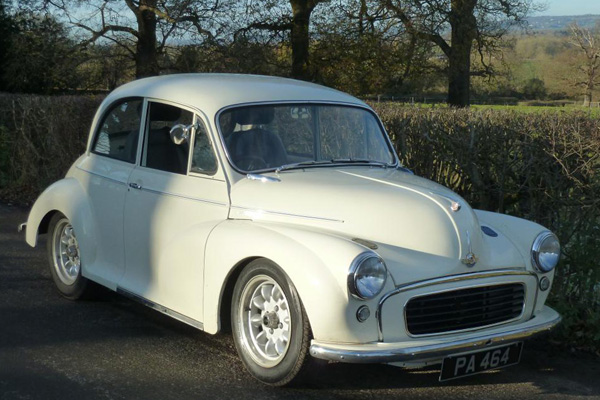

Finished Exterior
Performance 15x7 10-spoke aluminum wheels.
Steve is considering adding a little more front ground clearance.
Aerocatch hood pin latches.
